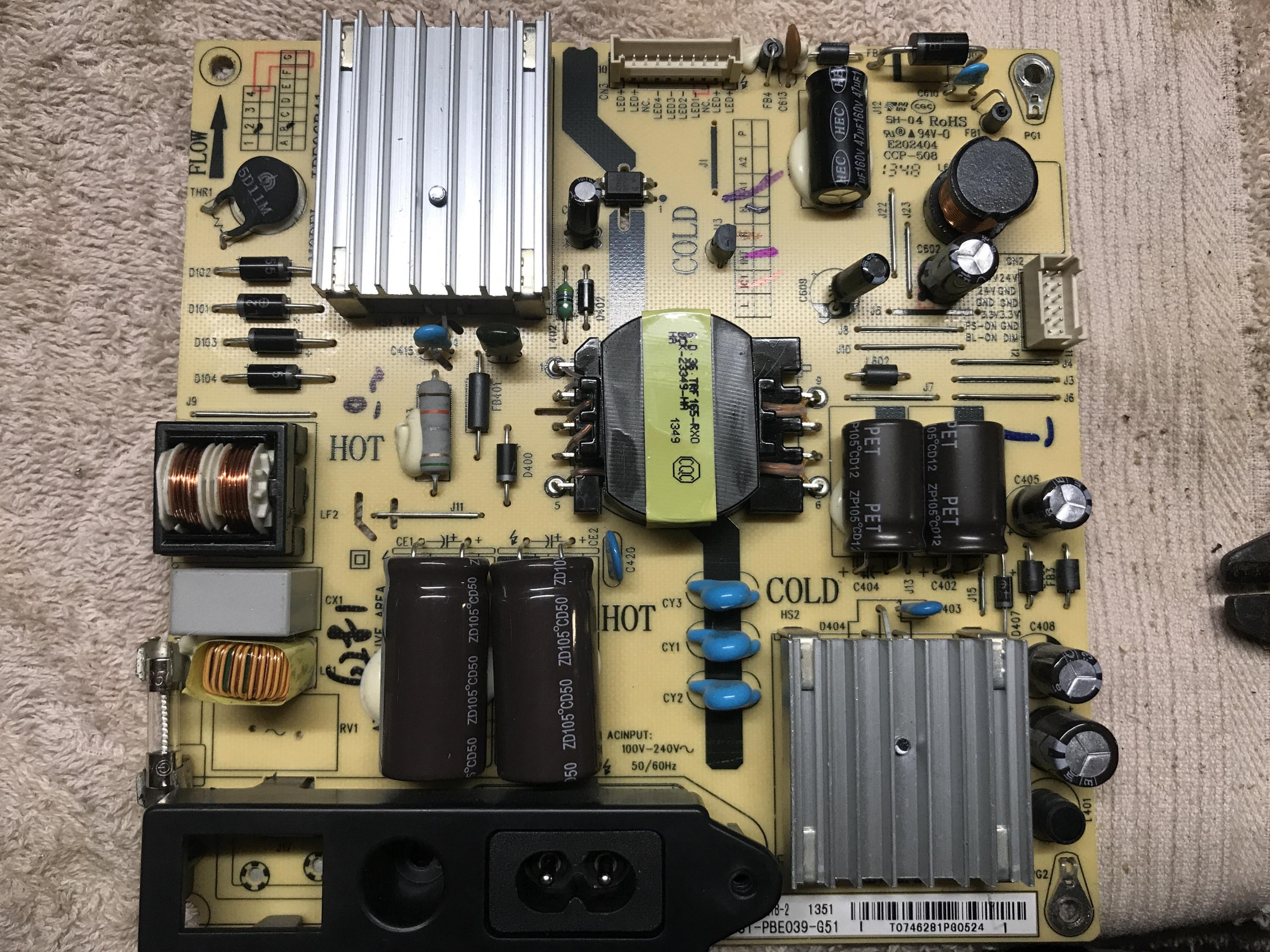

    Hey guys and gals quick warning I'm quite movie and have 3 LCD tvs I wish to learn this new skill on. I appreciate very much any help anyone can give me. That aside here are my symptoms.
    1. The tv does not turn on, no standby led etc
    2. The fuse was blown I have replaced and it has not blown again
    3. I have taken voltages on different places and it appears I'm not getting voltage across to the cold side
    4. No caps appear to be bulging or leaking
    5. No other signs or burnt components or damage apart from pictured below slight deformed frame.
    I'm thinking the problem lies somewhere at this transformer.I get voltage to the hot side but not out the cold side.
    I appreciate any help anyone has to offer I'd like to learn the skills to repair this stuff instead of it ending up in a landfill. The worlds already full of too much waste
    Re: No voltage cold rail. TCL L39B2610
    if your fuse failed then it is most likely that you have other bad components.

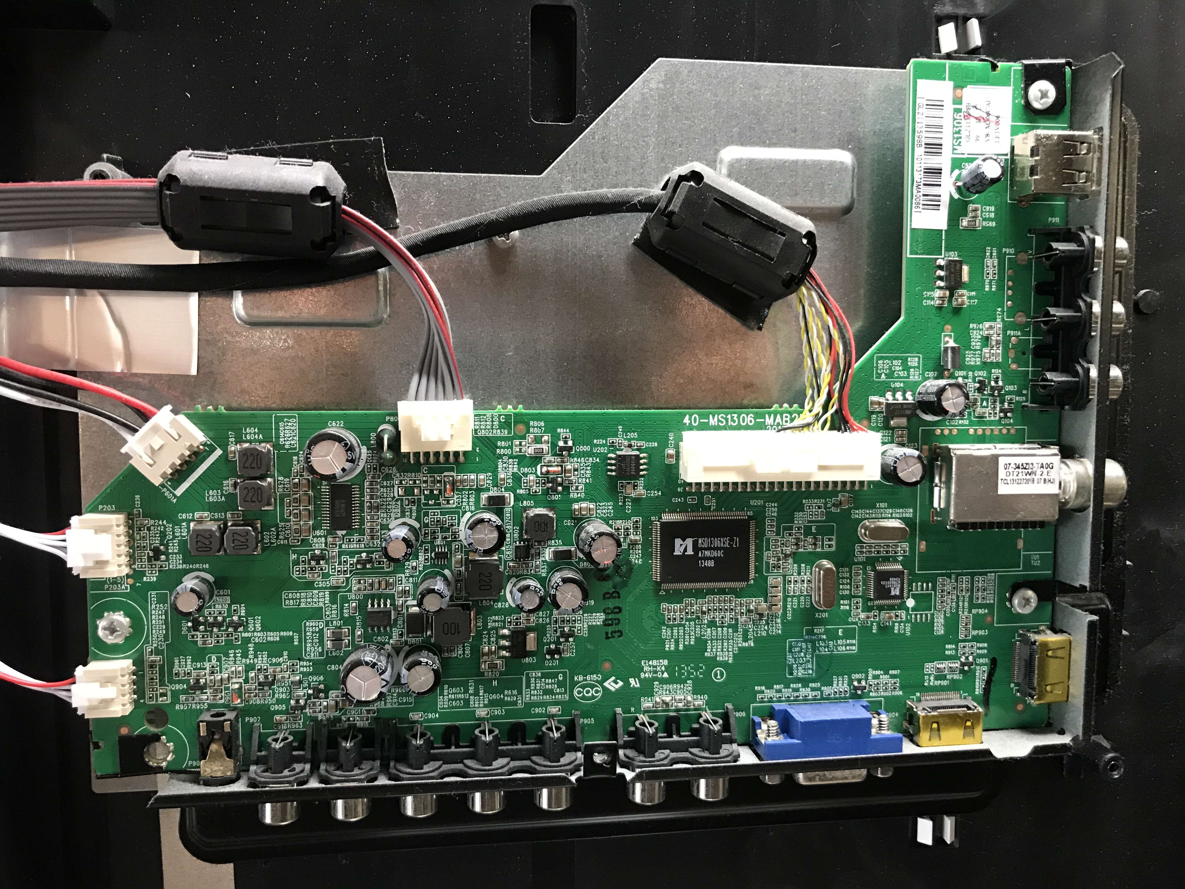

    first, we need pics of the entire back of the tv and a straight on pic of the whole ps.
    you also need to check what voltages are present on the harness that goes to the main board. list as pin no, pin desc, v in stby, v when on.

      Thanks for your reply attached are 3 photos one of while back of tv, main power board and then main board

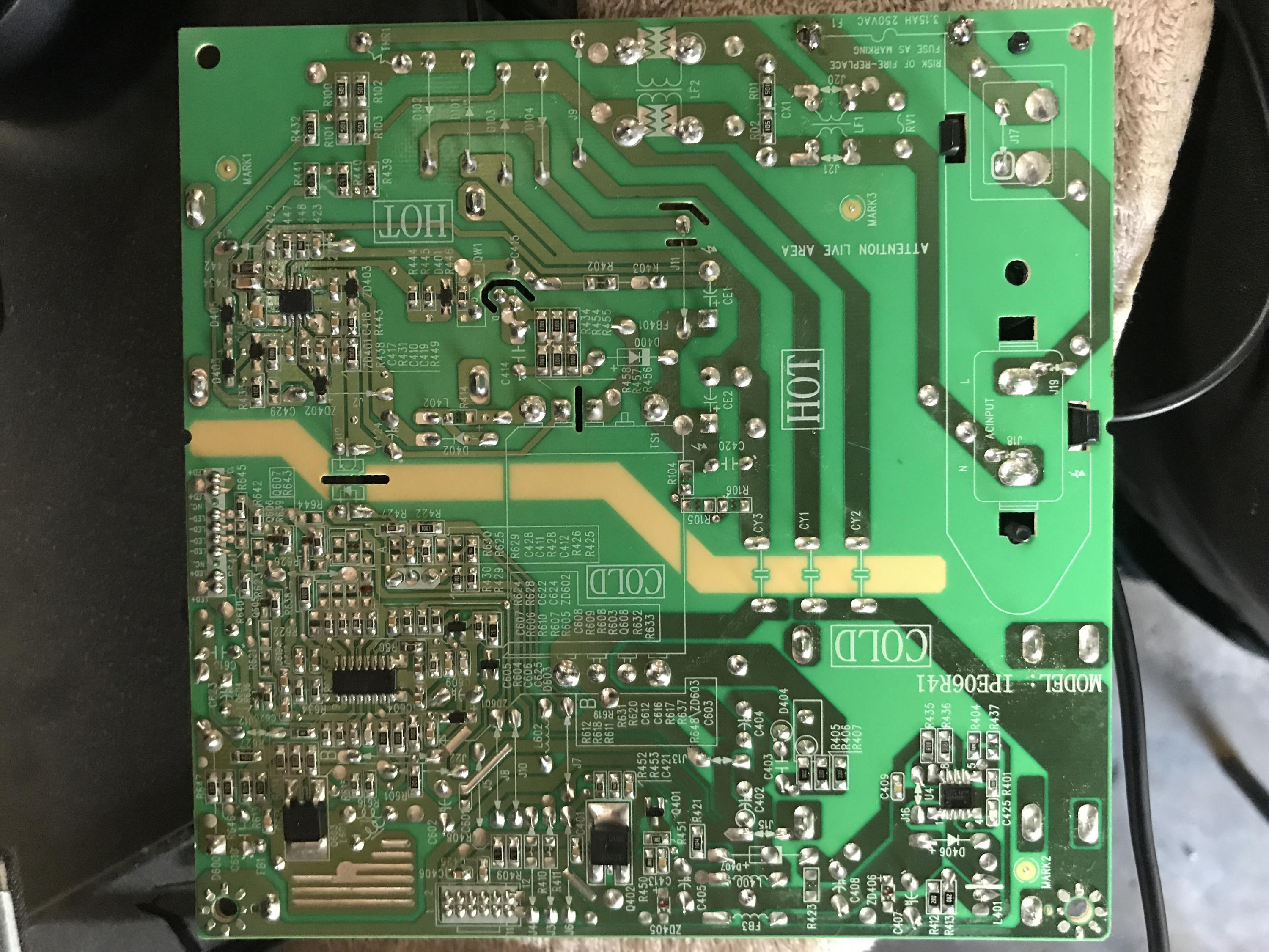

        We also need clear straight shot high res of the whole top and bottom side of the board so we can trace out the connections.

          a picture of the underside of the ps will be required too.
          if you can add pics as attachments, (by clicking on advanced then add attachment,) will make things easier to view in the thread and not slow down the loading of page.

            With cables plugged in voltages are 0 pushing power button does not change state or anything. Attached is a photo. The red circled section is the high voltage side which also has voltage. The green circled area is the low voltage (cold) side it has no voltage anywhere. The blue circled section starting form the top are as follows.
            All tests on hot side used hot ground
            All tests on cold side used cold ground
            Voltage regulator
            Hot side. Cold side
            Pin 3 =0v. Pin 1 =0v
            Pin 4 =0v. Pin 2 =0v
            Transformer ? (Centre blue circle.
            Hot side. Cold side
            Pin1= 0v. Pin9= 0v
            Pin2= 0v. Pin8= 0v
            Pin3= 321v. Pin7= 0v
            Pin4= 321v. Pin6= 0v
            Pin5= 321v
            3 blue caps
            Hot side Cold side
            Cap1= 0v Cap1=0v
            Cap2= 104v Cap2=0v
            Cap3= 104v Cap3=0v
            Last edited by keshin; 08-30-2017, 10:29 PM. Reason: Corrected readings using DCV readings, and main filter cap negative leg

                          https://www.badcaps.net/forum/attach...2&d=1504152366
                          Can you read the P/N of that 8-pin SMPS IC on the top left of the picture?
                          Check resistance of the MOSFET QW1 (attached to the heatsink) Source pin resistor R403 to see if it still shows < 1 Ohm or not, it looks like it has blown.
                          Also check the capacitance and ESR of the startup/running cap C424.
