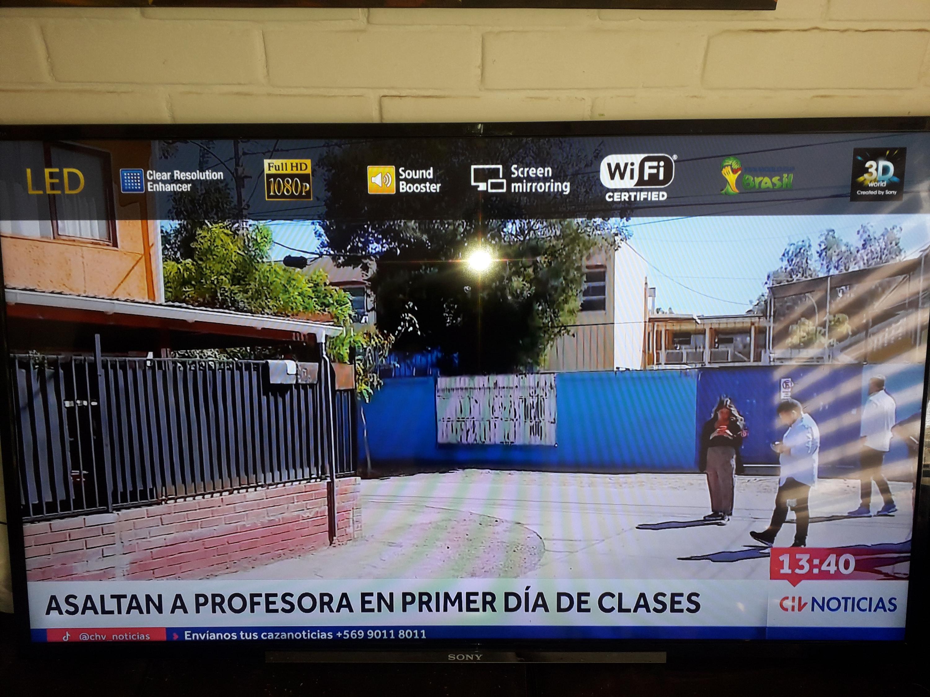

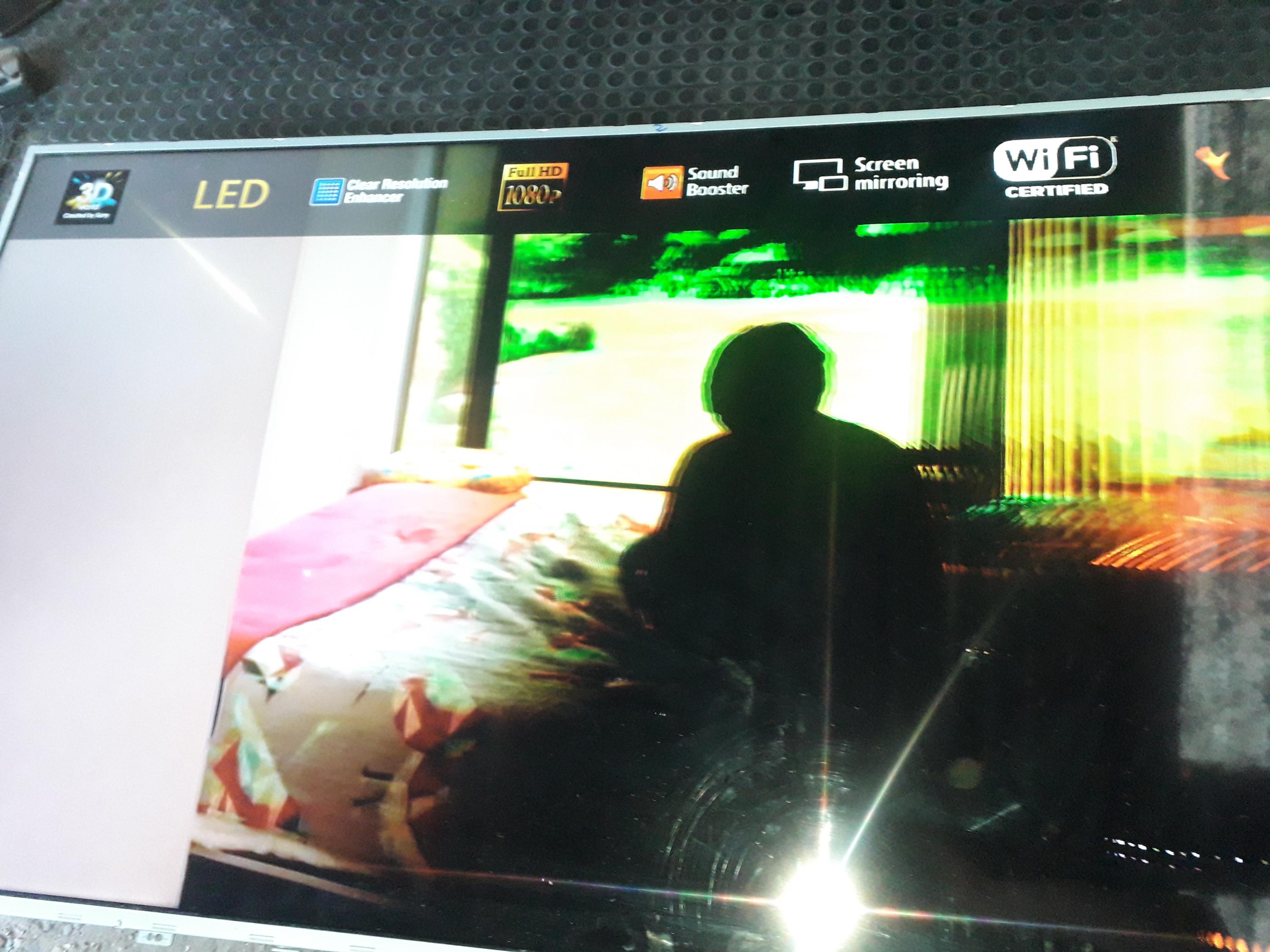

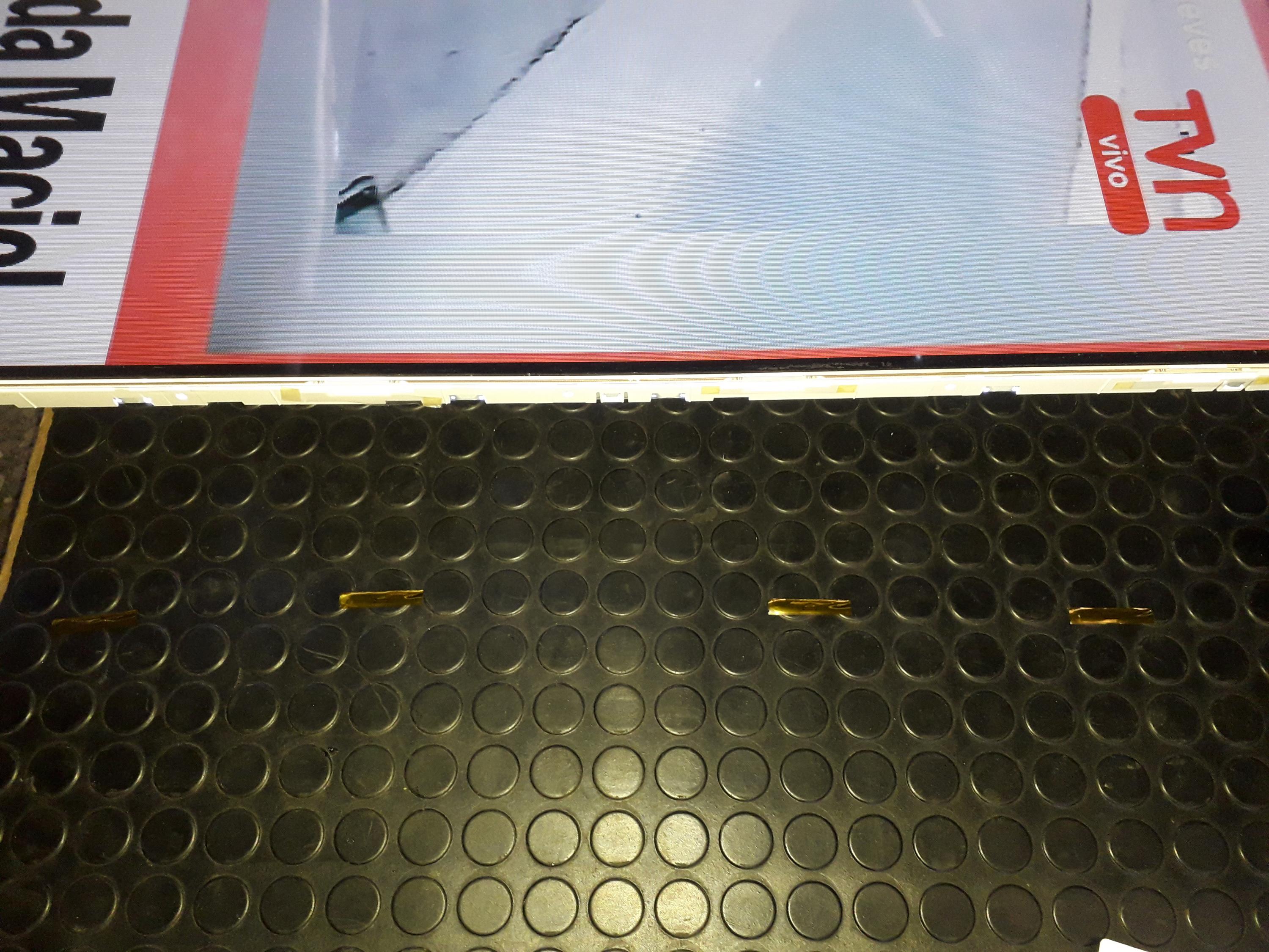

                  Alright guys, I'm going to update you.
                  I disassembled the frame and when verifying the side COF Chip none shows a noticeable heating, but when assembling the frame it fails after a few minutes. This makes me think that when the TV has the metal frames (which hold the panel) and also the plastic frame (where the TV brand comes out). As there is no ventilation, the COF Chip collapses and shows the fault.
                  It was a risky move on my part, but since many had reported simply removing the side COFs that present the issue, I just took the risk and removed them. Fortunately in my case, this fixed the root problem.
                  The TV has already been running for several hours without showing the blurry image that I attached in post #40.
                  I only have to thank everyone in the forum for contributing with their help and knowledge that allows us to rescue (at least for a while longer) a TV that does not stop costing good money in my country.
                  The first image shows the TV with the fault.
                  In the second, the retired Chip COF side.
                  In the third, the TV in its current state.
