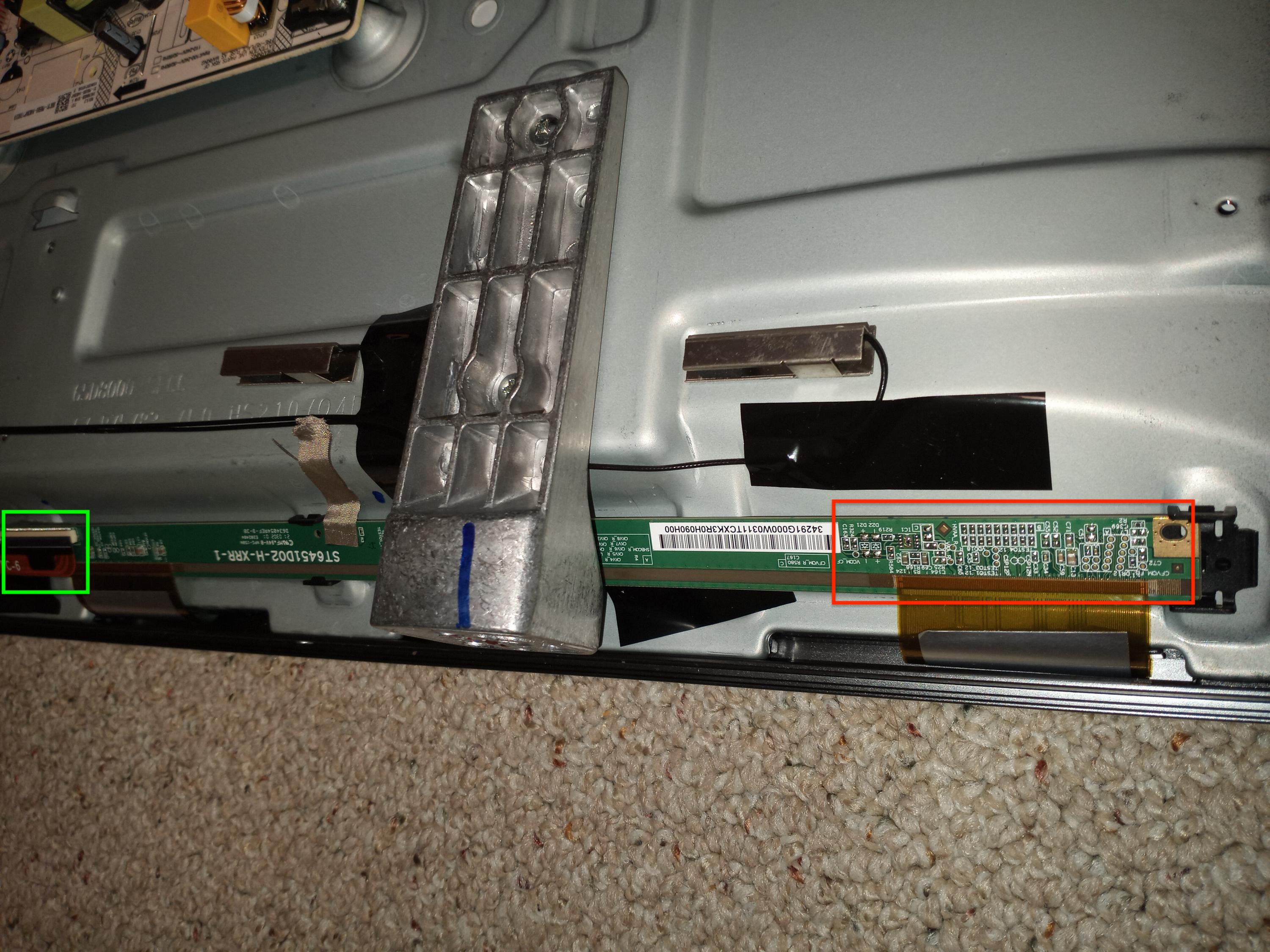

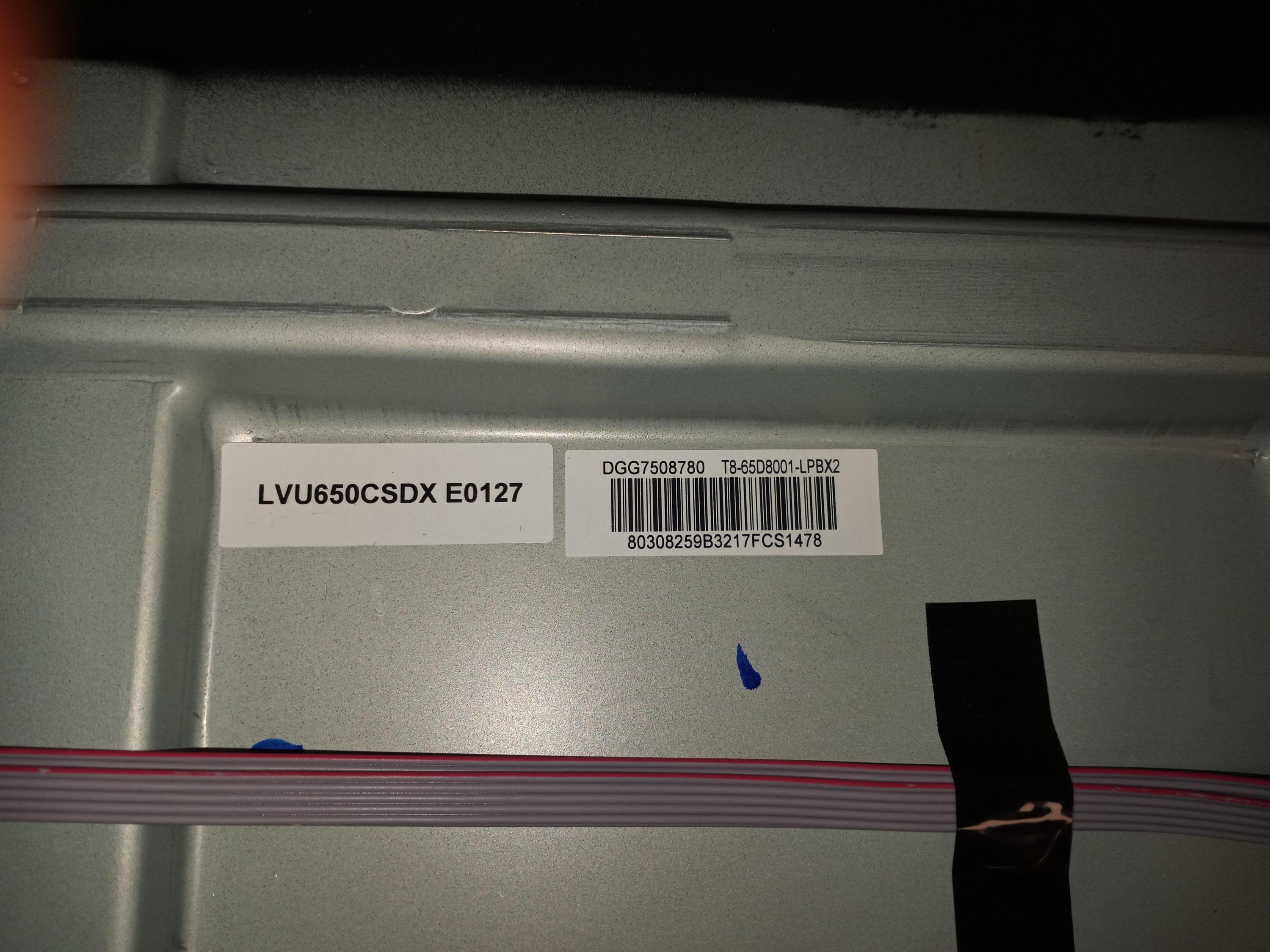

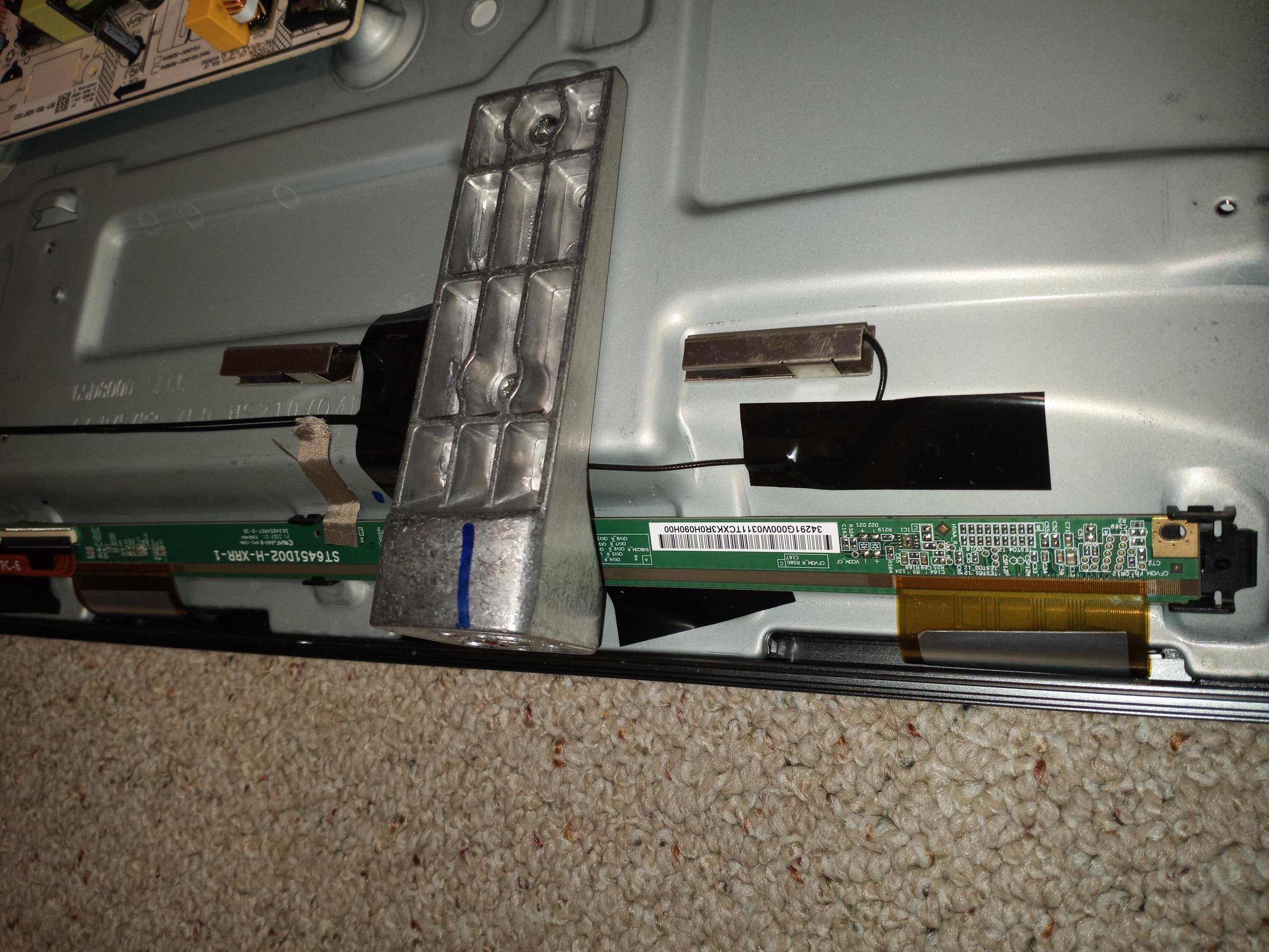

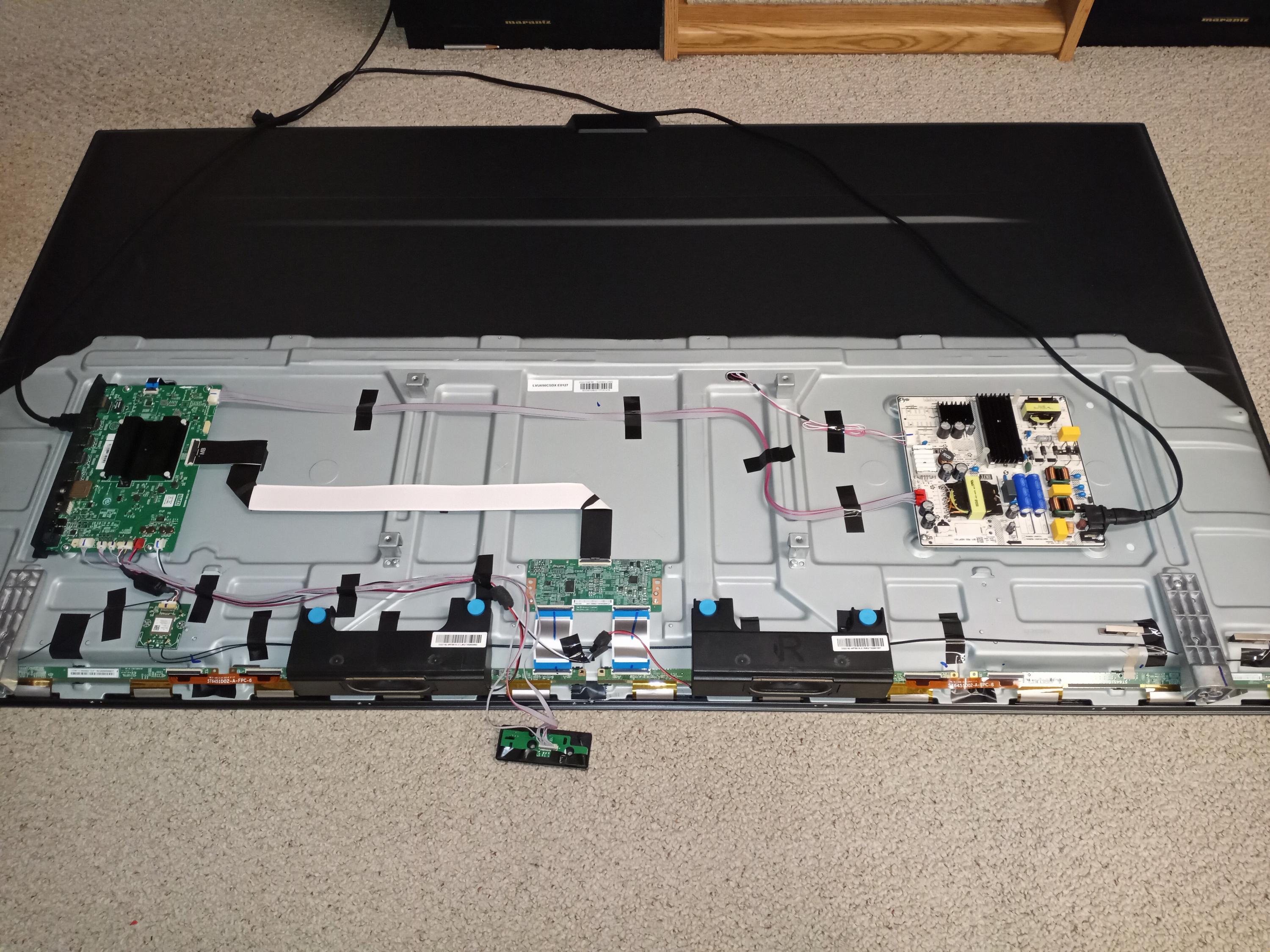

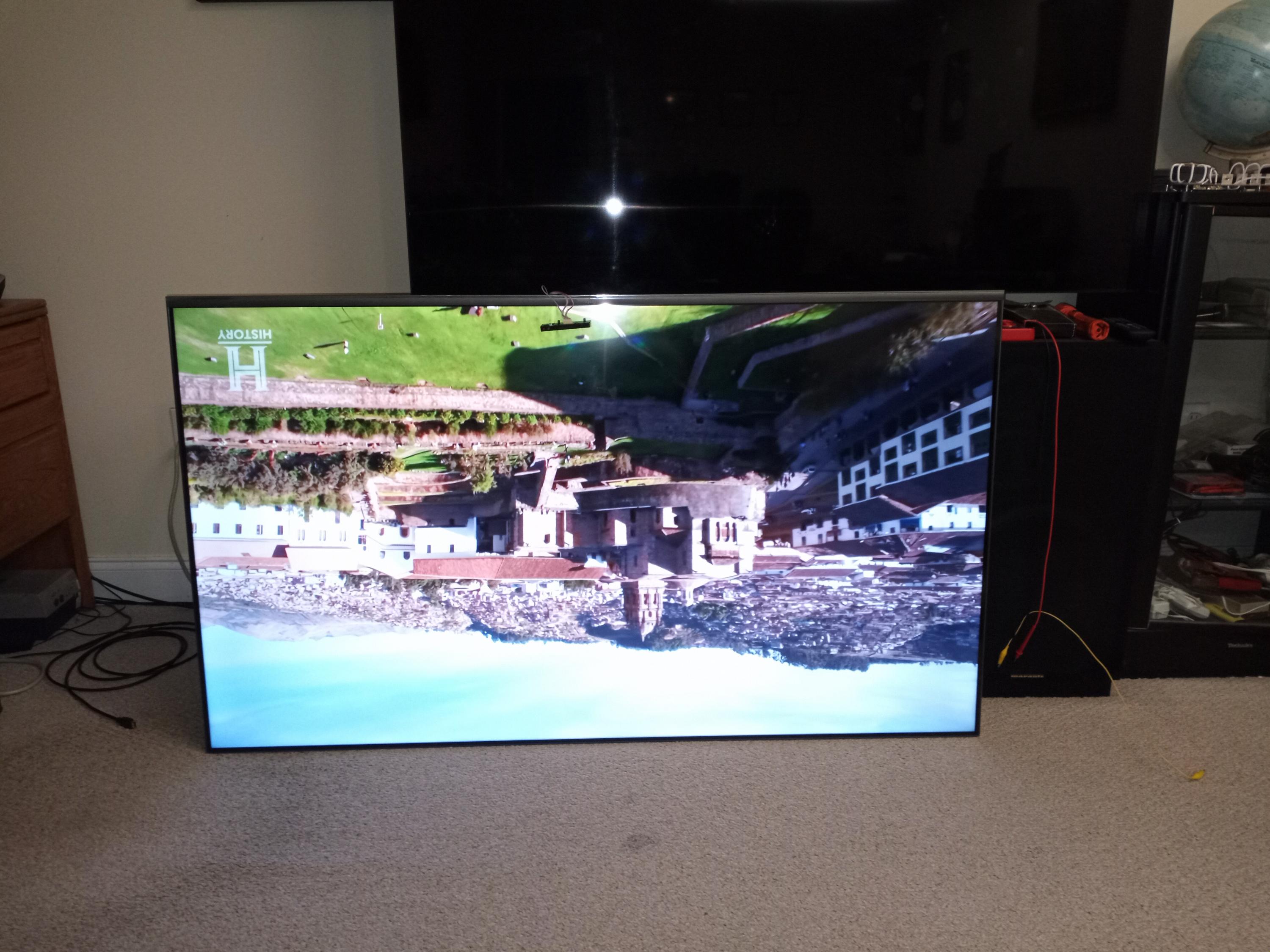

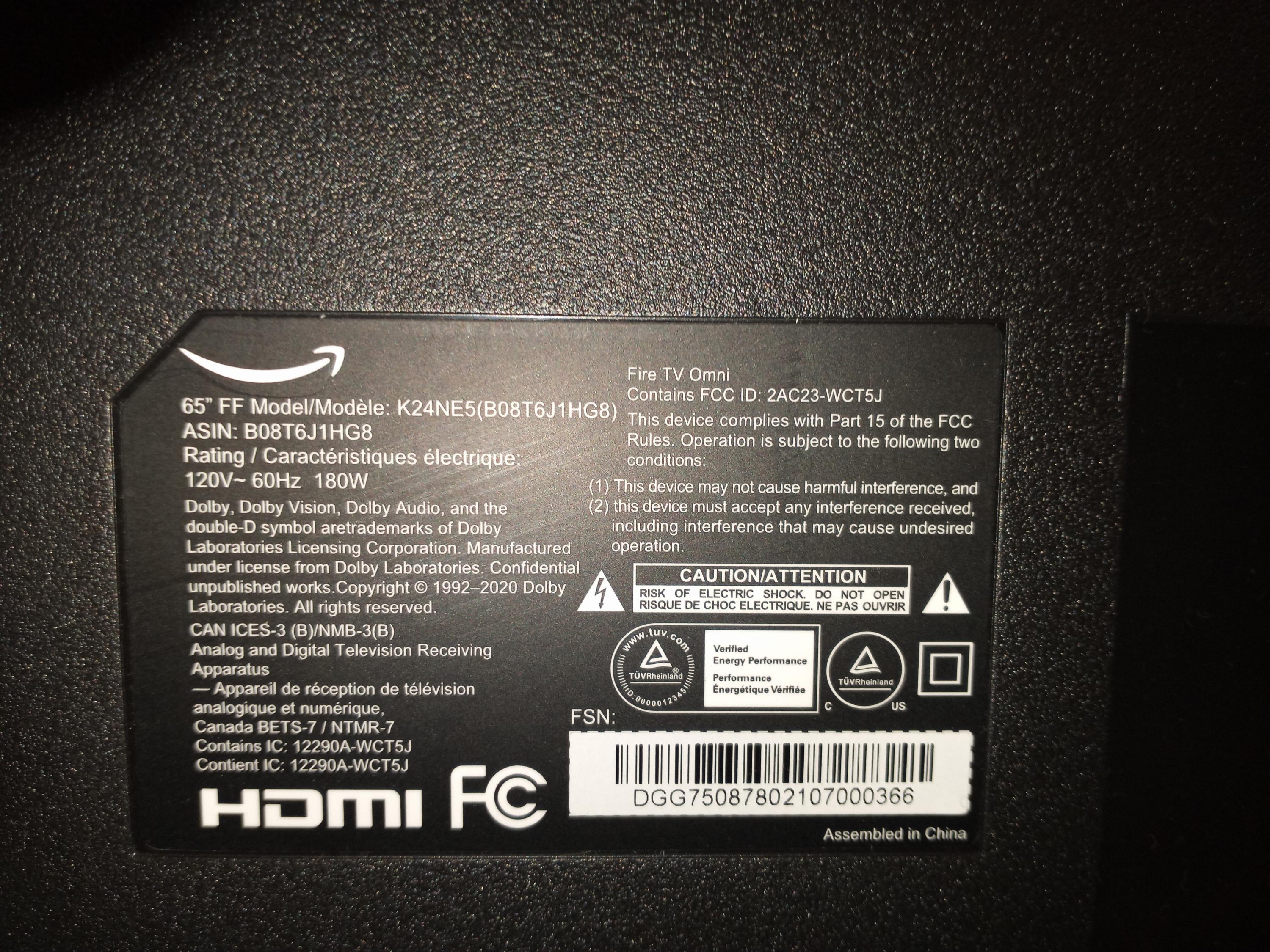

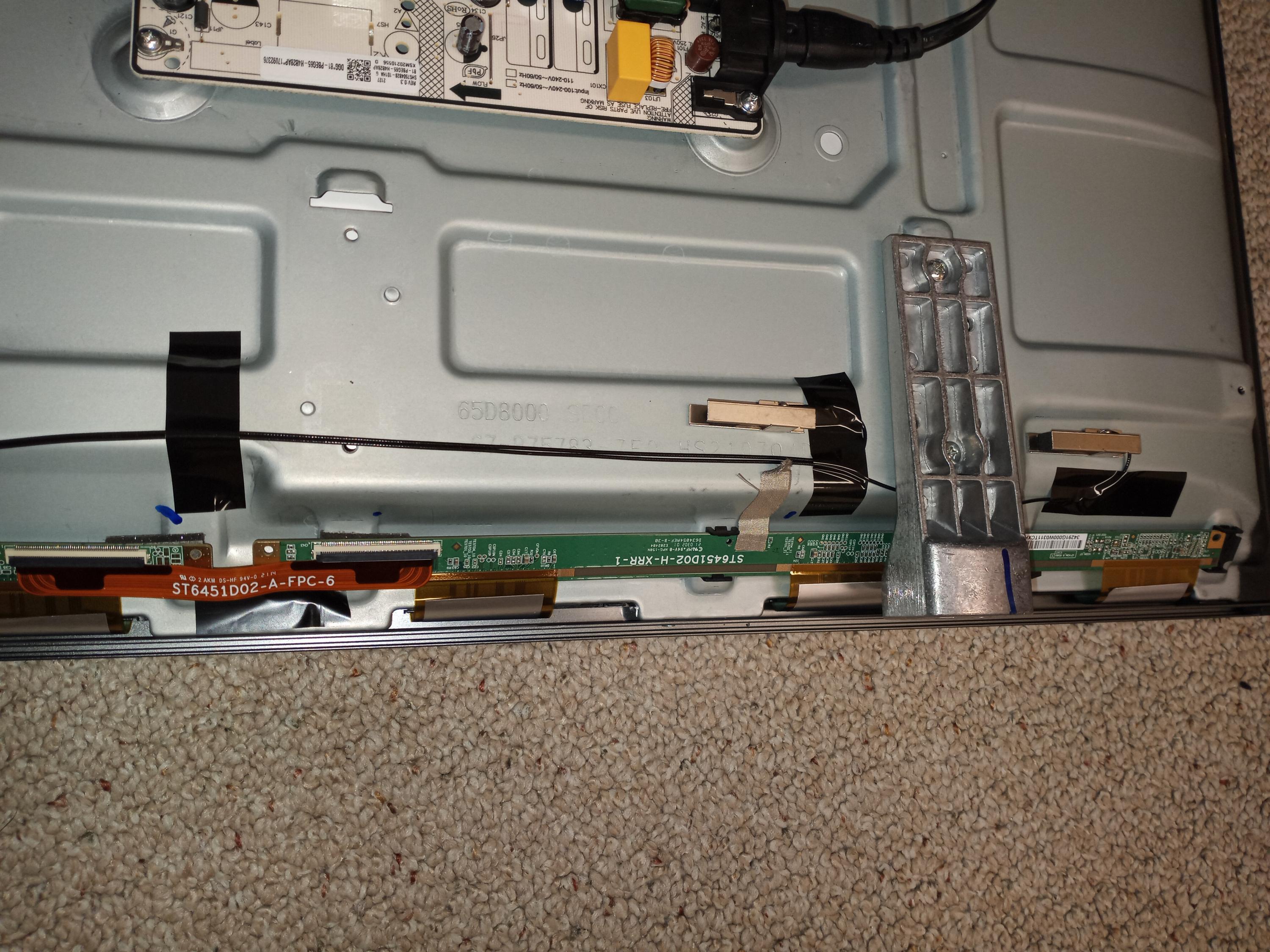

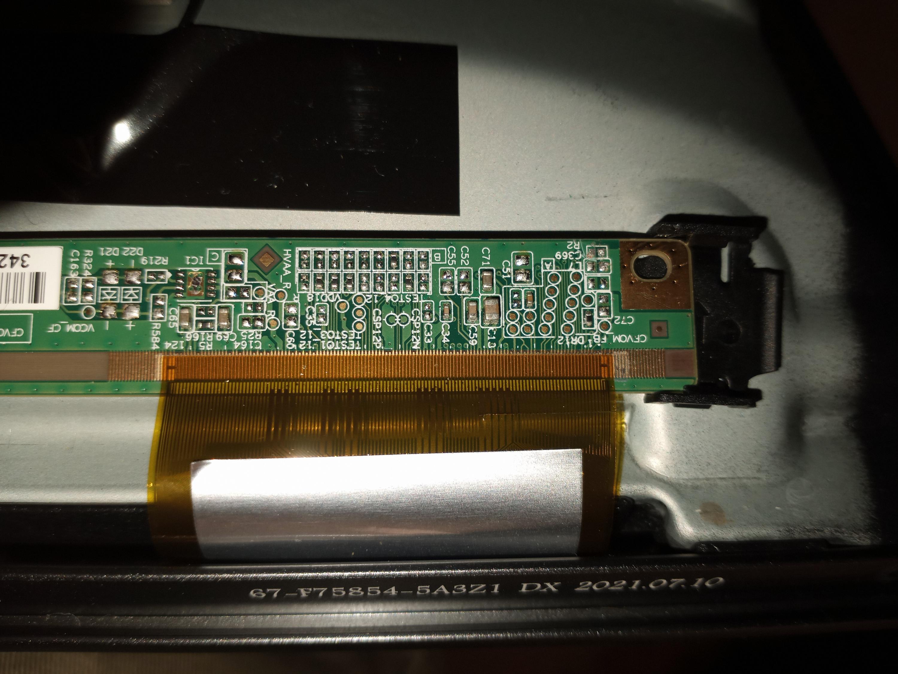

Amazon Fire TV Omni K24NE5 tcon or panel bad?
  • Lee M.
    • Nov 2021
    • 35
    Amazon Fire TV Omni K24NE5 tcon or panel bad?
    TV came on with BL on but blank screen. Disconnected one of the ribbon cables from tcon to panel driver board and now I have half of the screen working normally. Any way to tell if the problem is with the tcon or the panel driver board or the panel itself? Should I just replace the tcon and see what happens?
  • Storyteller12
    • Jun 2020
    • 625
    Re: Amazon Fire TV Omni K24NE5 tcon or panel bad?
    It could be the tcon. Does the tv restart/ reboot when turned on with both ribbon cables installed? If it does reboot it probably panel issue but without further test it’s hard to say for certain.
    Tcon is cheap. Give it a shot
    • Lee M.
      • Nov 2021
      • 35
      Re: Amazon Fire TV Omni K24NE5 tcon or panel bad?
      With both ribbon cables connected it turns on but it's just a blank black screen with the BL's on. With only the "bad" cable connected it does the same, blank black screen with BL's on. With the bad cable disconnected and the good cable connected I get half screen video with the other side of screen black. Sound and remote functions are normal.
      • Lee M.
        • Nov 2021
        • 35
        Re: Amazon Fire TV Omni K24NE5 tcon or panel bad?
        Update: I noticed that the right and left driver boards are split in two and have a ribbon cable connecting them. So I unplugged the ribbon cable connecting the two driver boards on the bad side and now I have 3/4 of a picture. I think this eliminates the tcon board as the problem. I'm going to check for a shorted cap on the disconnected bad half of the driver board.
        • Lee M.
          • Nov 2021
          • 35
          Re: Amazon Fire TV Omni K24NE5 tcon or panel bad?
          I checked the driver board for shorted caps and couldn't find any. Is it possible that the panel itself has a short?
          • howardc64
            • Jun 2017
            • 654
            Re: Amazon Fire TV Omni K24NE5 tcon or panel bad?
            Pictures would be helpful. But I guess you have 4x buffer boards from your description and 3 are connected to form 3/4 picture leaving the problem on the single buffer board + panel region.
            I'm assuming the 1/4 failure is on the outer edge of the panel. The 2 outer buffer boards need to send row control signals up both side of the panel. If one of these row control signals have failure, can disabled it and TV will work fine with row signal from the other side. Furthermore, left and right most buffer board will have similar circuitry for comparison diagnostics.
            I recently fixed s LG that had slight COF burn marks on one edge of the panel. Had no full shorts but a bank of resistors responsible for the row signal on the bad side behaved differently than the good side in diode mode. This gave clue to the problem and fix.
            https://www.badcaps.net/forum/showthread.php?t=116761
            Fix is in post #8 and explanation of process in #18. You may have similar issues. Take pics of the buffer boards and the panel sticker (so we know who makes the panel)
            Last edited by howardc64; 05-23-2023, 10:50 PM.
            • Lee M.
              • Nov 2021
              • 35
              Re: Amazon Fire TV Omni K24NE5 tcon or panel bad?
              here's some pics.
              • howardc64
                • Jun 2017
                • 654
                Re: Amazon Fire TV Omni K24NE5 tcon or panel bad?
                Originally posted by Lee M.
                here's some pics.
                I'm assuming this is the end thats failing and if you disconnect the flex in the green rectangle, 3/4 LCD will display. Please correct if this is wrong guess.
                Try the following
                1. block out some pins (thin piece of paper is easiest while trial n error) on the green rectangle. Cut various lengths and try various places and see if LCD displays. Start with wider and if LCD displays, gradually go smaller until finding out which masked pins enable LCD to display.
                2. diode check various components in the red rectangle against the similar circuit on buffer board on the other end of the panel. See what behaves differently.
                If you can find the masked pins that enable LCD display. Maybe can continuity trace to the component / probe point they connect to (no always true, sometimes it goes to the panel) There might be labels which will give a clue on what circuit is affected.
                • Lee M.
                  • Nov 2021
                  • 35
                  Re: Amazon Fire TV Omni K24NE5 tcon or panel bad?
                  It's fixed!!! But it's pure dumb luck. I checked everything on the board with the meter in diode mode and could not find anything. I tried covering connector pins with a piece of thin plastic from a Walmart bag but never could get the TV to display a picture. I gave up on fixing it and out of curiosity decided to find where the short was by cutting the ribbon cables to the panel. I started by cutting about half an inch into the outermost cable. I plugged in the TV, pressed the on button and the TV came right up with a full screen picture! I have no idea why this TV is now working. I would love to hear any ideas and comments.
                  • howardc64
                    • Jun 2017
                    • 654
                    Re: Amazon Fire TV Omni K24NE5 tcon or panel bad?
                    Congrats on the fix. You probably cut the shorted gate driver connections. I made a document on Samsung panels below. Most LCD panels are similar but use different signal names depending on manufacturer and some provide 0 ohm resistors for easy removal instead of cutting. Yours unfortunately doesn't provide many signal label names and of course no schematics...
                    https://www.badcaps.net/forum/showpo...44&postcount=5
                    • kca
                      by kca
                      Hello all ~
                      08-31-2025, 06:38 AM
                    • netgearnetgear
                      TCL 43S423 TCON OR PANEL FAULTY???
                      by netgearnetgear
                      Good day, I have a TCL TV: Model 43s423. After turning ON the TV, the ROKU TV logo appears with fine lines over the whole screen, then after a while there are vertical bands in the middle of the screen top to bottom and the TV tries to update its firmware but I do not have the remote to connect it to my new network connection. Also the Power ON light blinks 2 times in quick succession. When I remove the ribbon on the right of the tcon board the left side of the screen shows but with fine lines. If I remove the left side ribbon and connect the right side ribbon the whole screen is blank with...
                      08-20-2025, 06:04 PM
                    • x_orange90_x
                      by x_orange90_x
                      03-29-2025, 11:02 PM
                    • advant
                      by advant
                      02-03-2020, 12:25 AM
                    • rimwall
                      Sony KD-65x7500D - double image - Tcon or Panel?
                      by rimwall
                      This TV was showing a fine image and pulsing with a partial double image (offset vertically) every few seconds. I taped 8 clock pins on one ribbon cable from the Tcon to the panel. It stopped the double image, but some pulsing in intensity was still visible. I then taped another 8 clock pins on the same ribbon cable and the image is now ‘fixed’. Although I understand this results in some loss of resolution, presumably because the clock signal degrades as it passes horizontally across the screen.
                      I am wondering - do these symptoms and ‘fix’ mean that it’s a Tcon fault or...
                      11-18-2025, 02:09 AM
