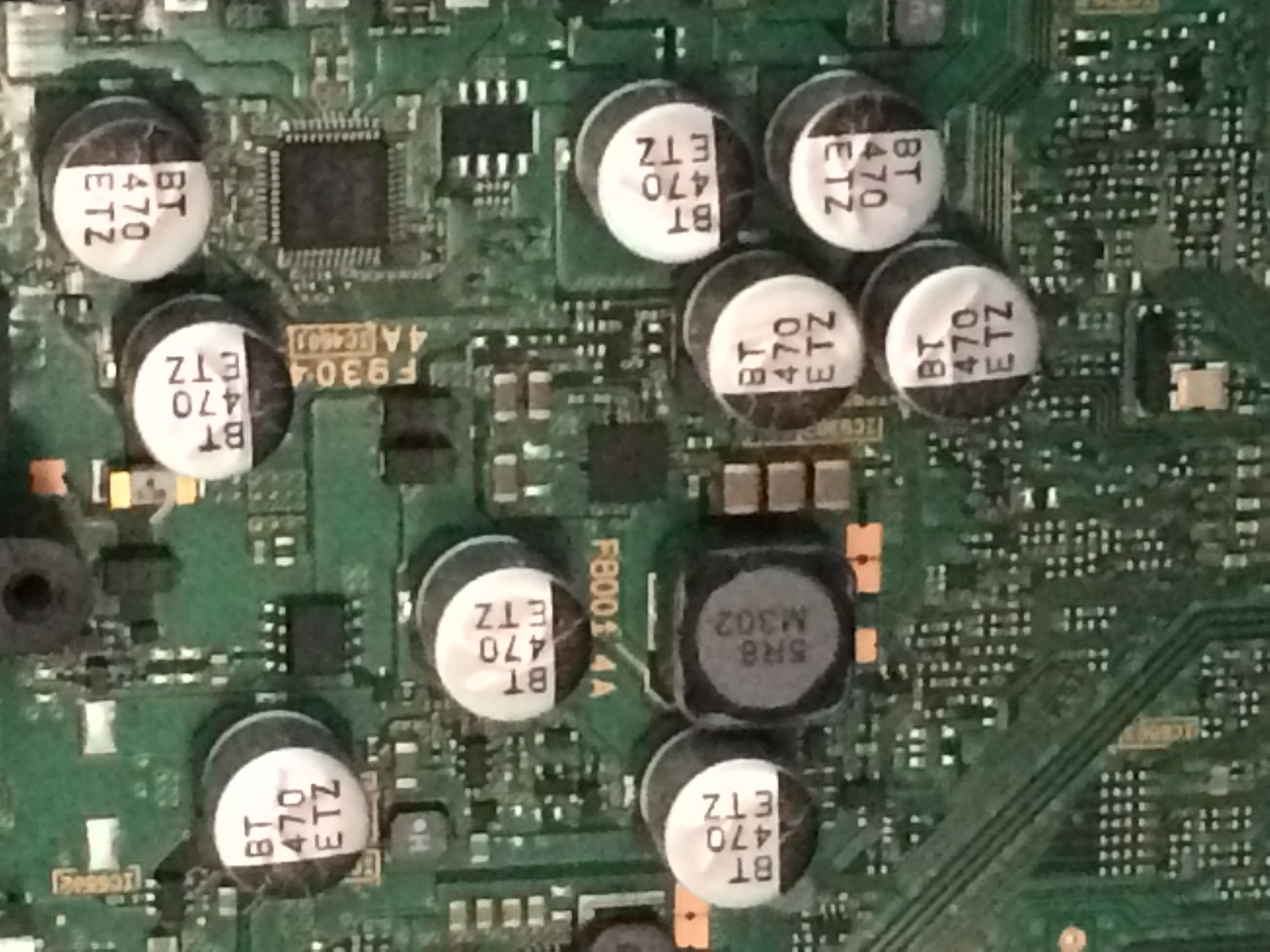

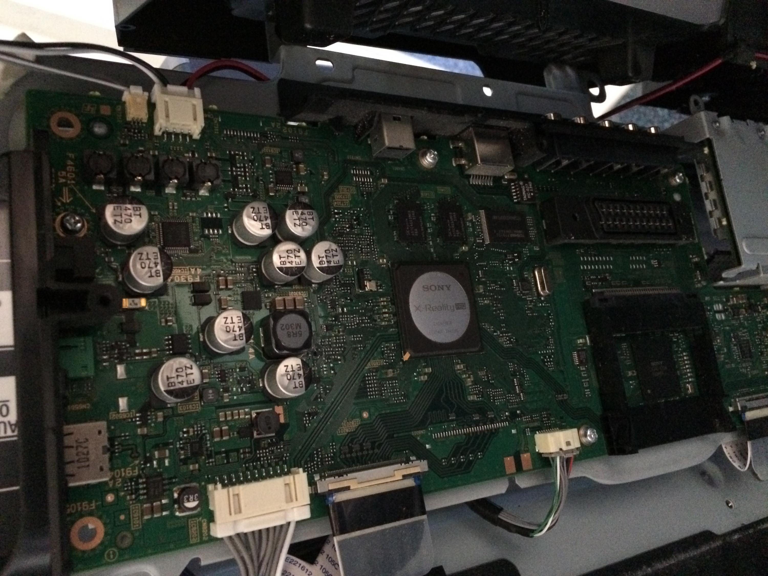

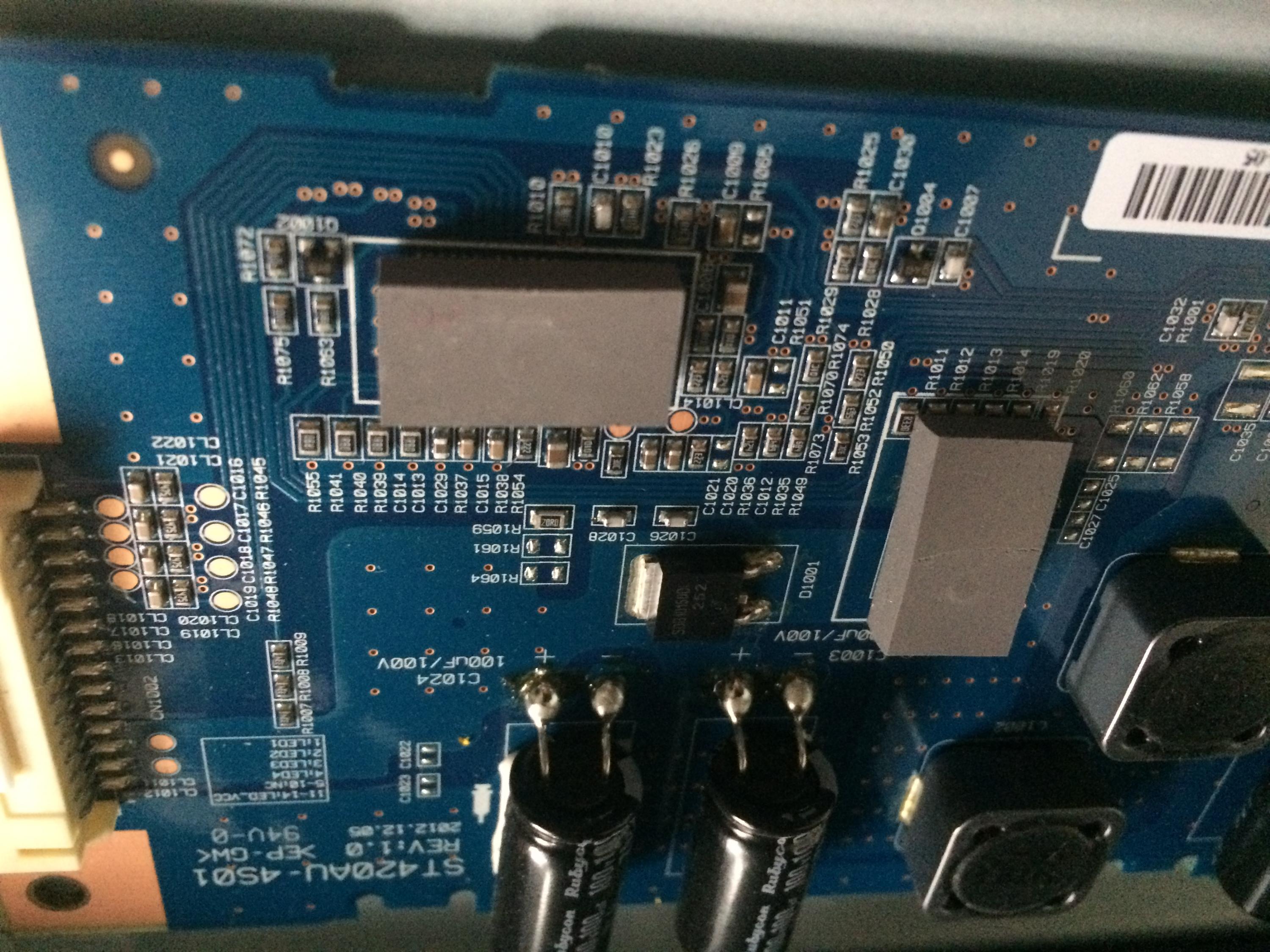

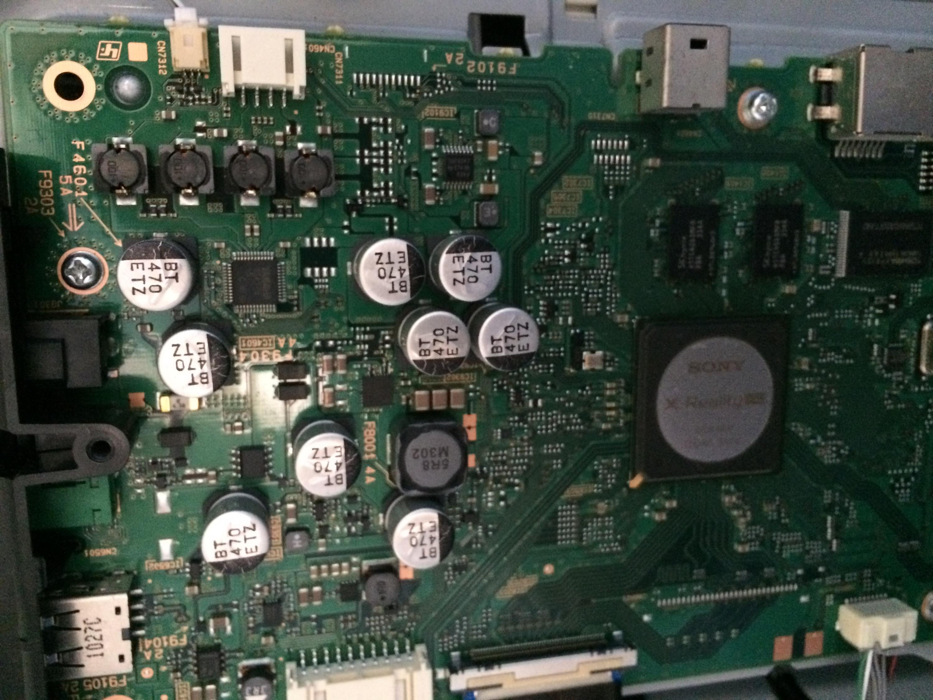

    Sony 42w653a I have is blinking three times then a another three times,been told may be the drivers is this correct or a power board fault ? All I know is the tv will not switch on

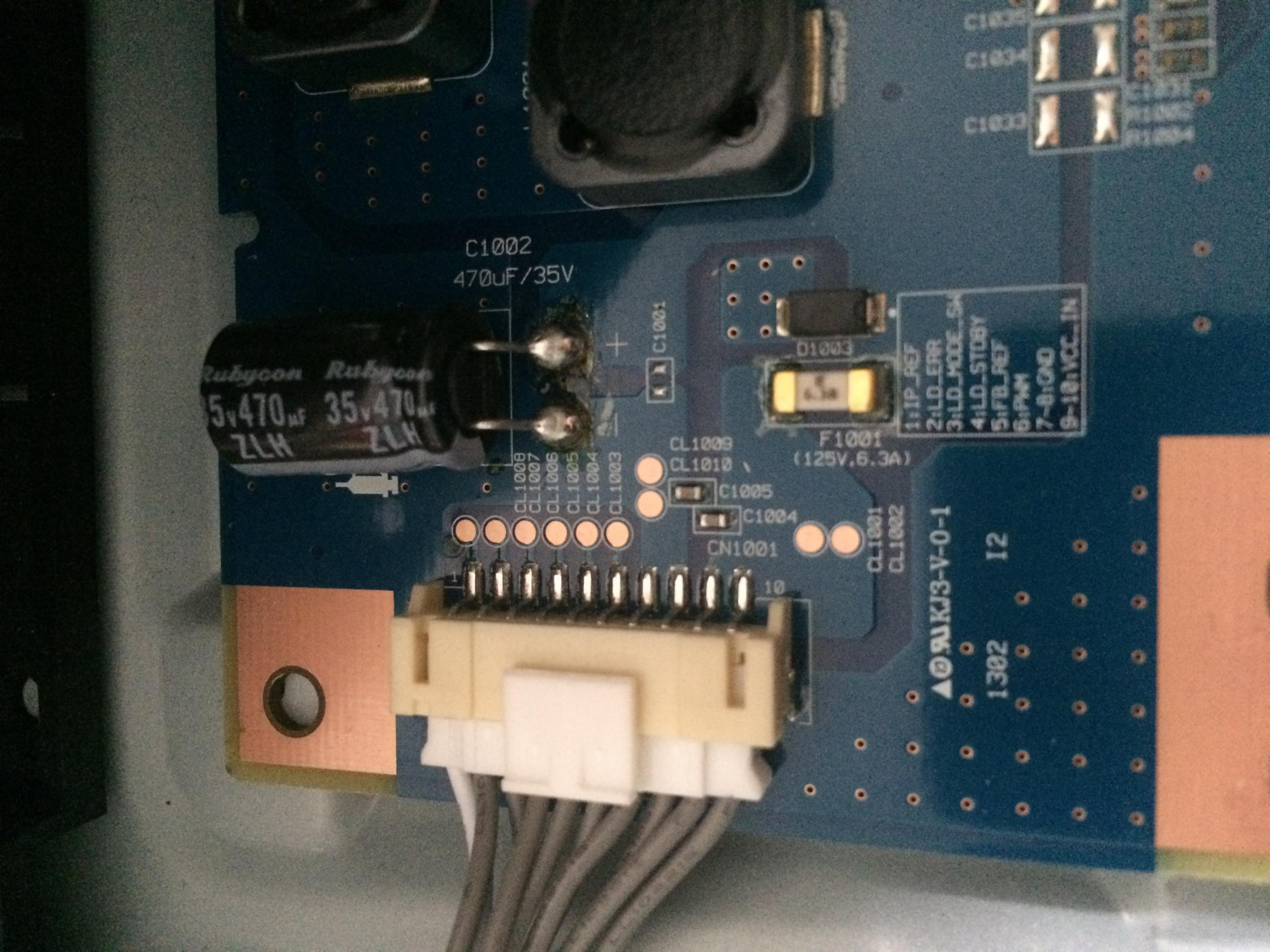

              Do measure the voltage on the 10 pin connector ?
                Re: Sony 42w653a
                So it uses an external power supply to power the internal combined mainboard/power supply.
                There appear to be a number of fuses marked on the board. Have you located and checked each one.
                Have you checked the incoming voltage from the external power supply is 19.5V when connected to the tv.

                  It uses a power supply similar to a laptop,I have not checked as wanted some advice how do do this,I'm armed with a multimeter,I know you ground the black and test with the red,set to dc volts ? So little bit of help I am a quick learner...
                    Re: Sony 42w653a
                    That's correct.
                    To test the fuses, set switched off and meter set to ohms, place your red and black probe on each side of the fuse and it should measure 0 ohms or close enough for a good fuse.

                              Tested c1004 fuse nothing,on the board 4.ld standby does that equal to this fuse maybe ?
