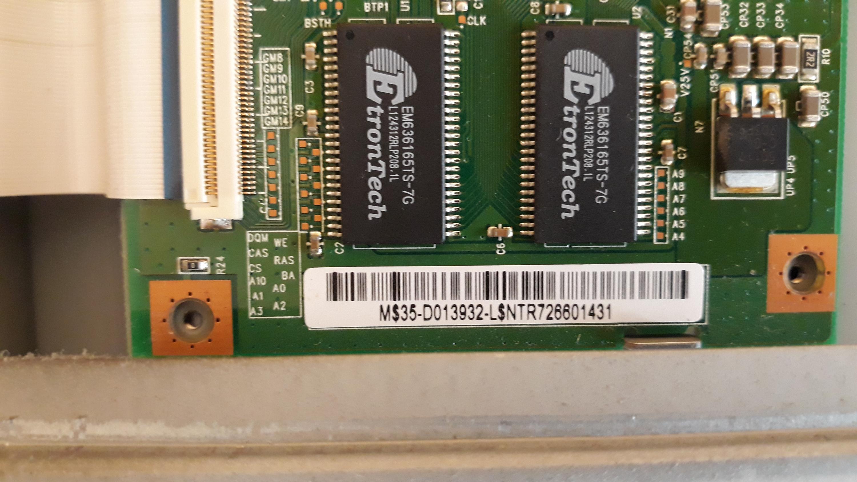

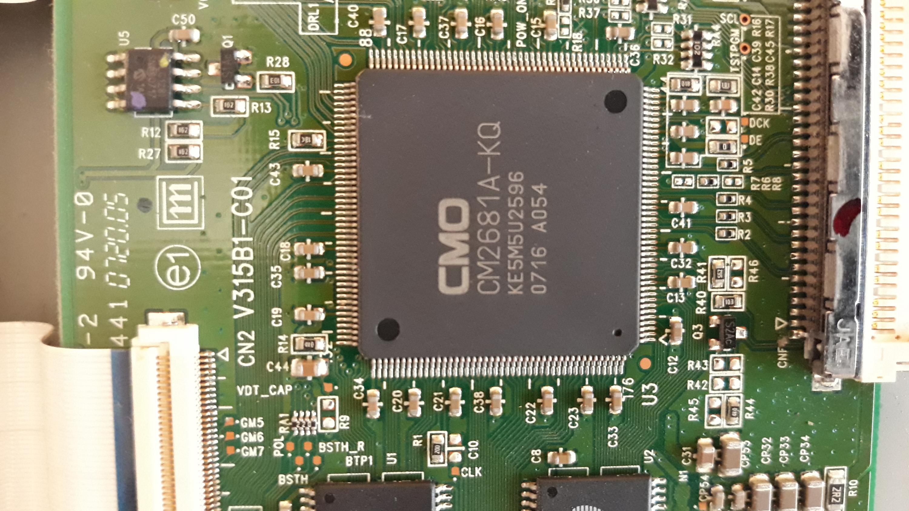

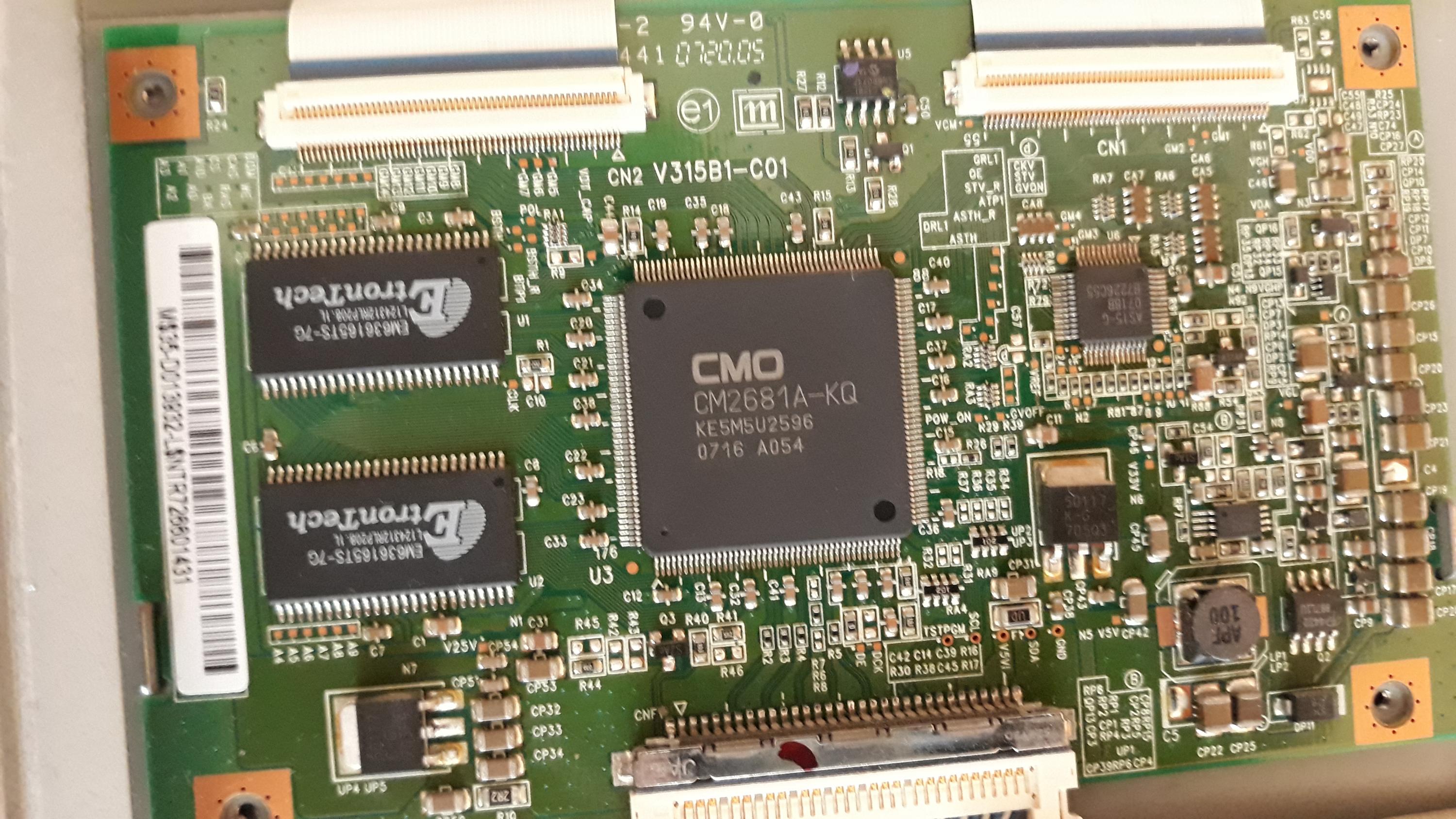

                Factory reset not work, less backlight either, when i select dinamic or film instead of standard mode i get image with colour mixed and edges with high contrast. I manage to adjust video settings in standard mode and set of colours "cold1" and get a verry foggy picture.
                I think to change the T-con board.
                Can anyone tell me what series of t-con is in this pictures?

                  Re: Le32r88bd
                  did you see this video is this the symptoms your seeing?
                  https://www.youtube.com/watch?v=nK8_p7FU9-M

                    Re: Le32r88bd
                    Should be able to find it on that page, just make sure you match up the numbers on your white sticker, don't know if you have ebay in Romania, maybe go to a similar site: https://www.google.com/search?client...M%2435-D013932

                      Re: Le32r88bd
                      Thx for your quick answers.
                      All is the same like in the video.
                      I make order for this part, and and let you know here for result.
                      Thx again.
