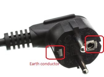

    Hello to all,
    I have just seen this YT video about solving flickering issue on SAMSUNG TV. Reading many comments it seems this works.
    But I wonder what is done here and how this solved the issue. I'm not able to find the schematics so cannot explain to myself.
    Few years ago I had a flickering problem on one monitor in some factory which I managed to solve by inserting UPS between monitor and power outlet. I also notice on this occasion the flickering was gone if I put insulation tape on the power plug like shown in the attached picture to remove connection with the PE conductor in the power outlet.
    I wonder maybe this is something similar with this type of TV
