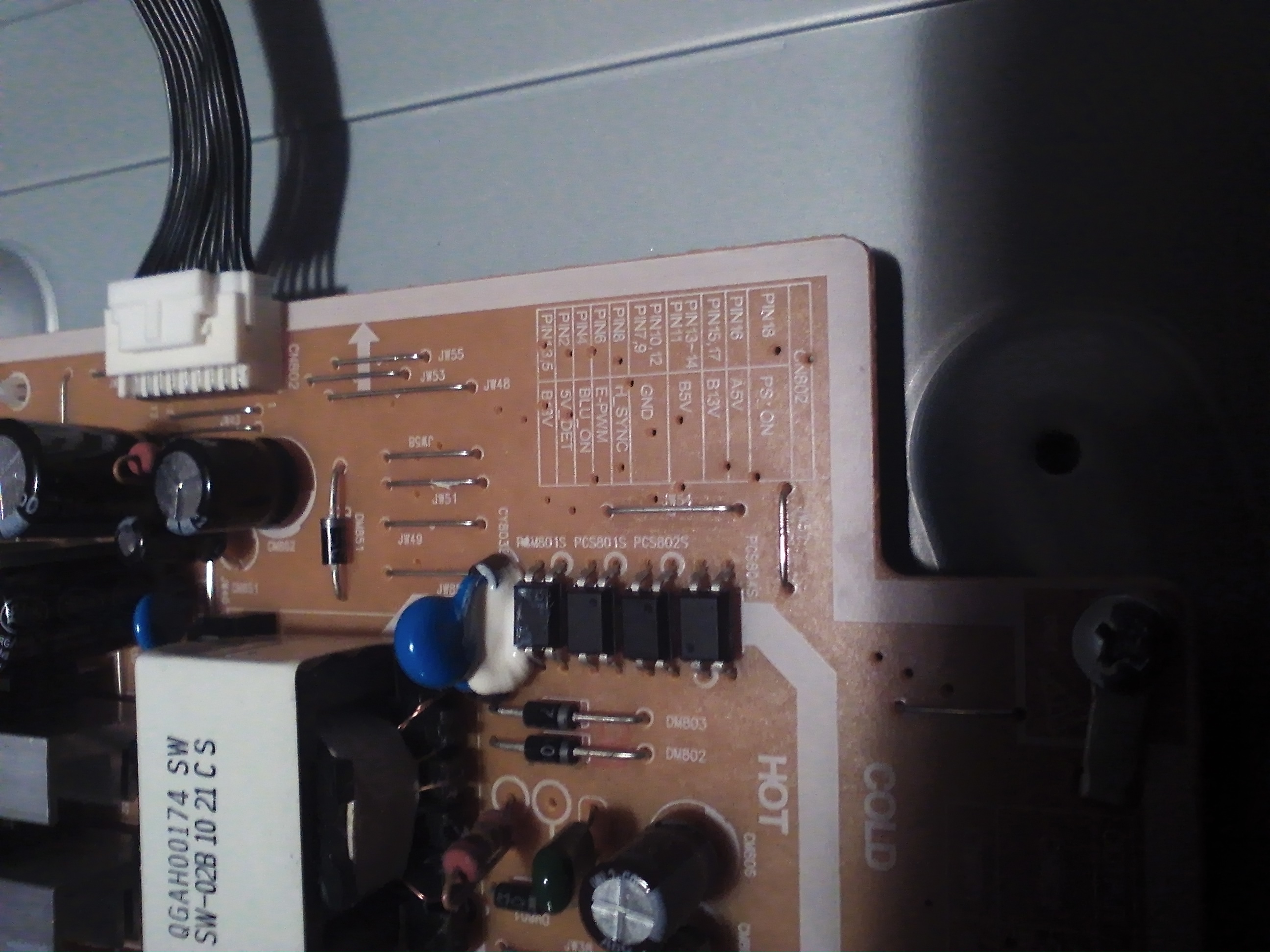

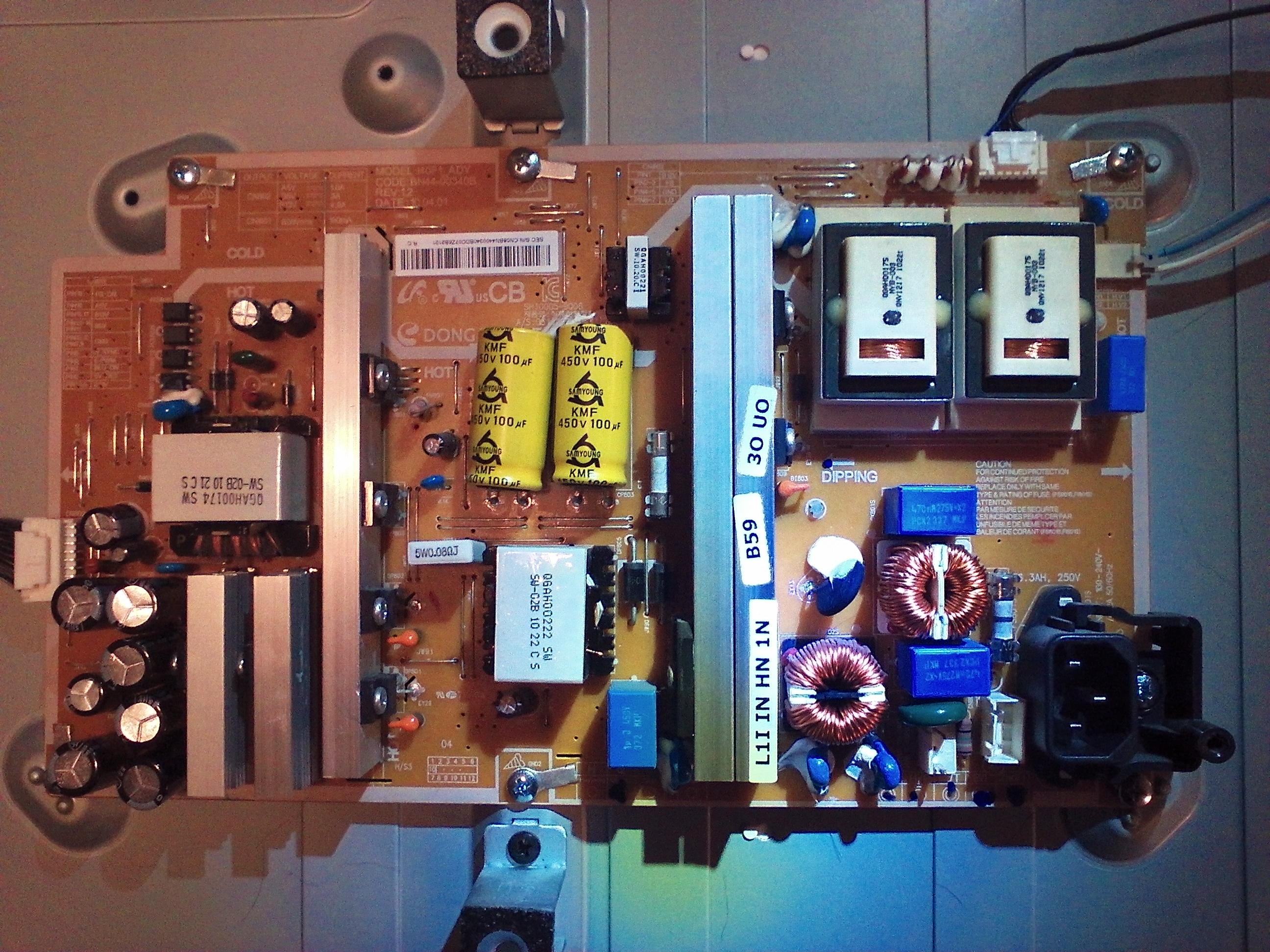

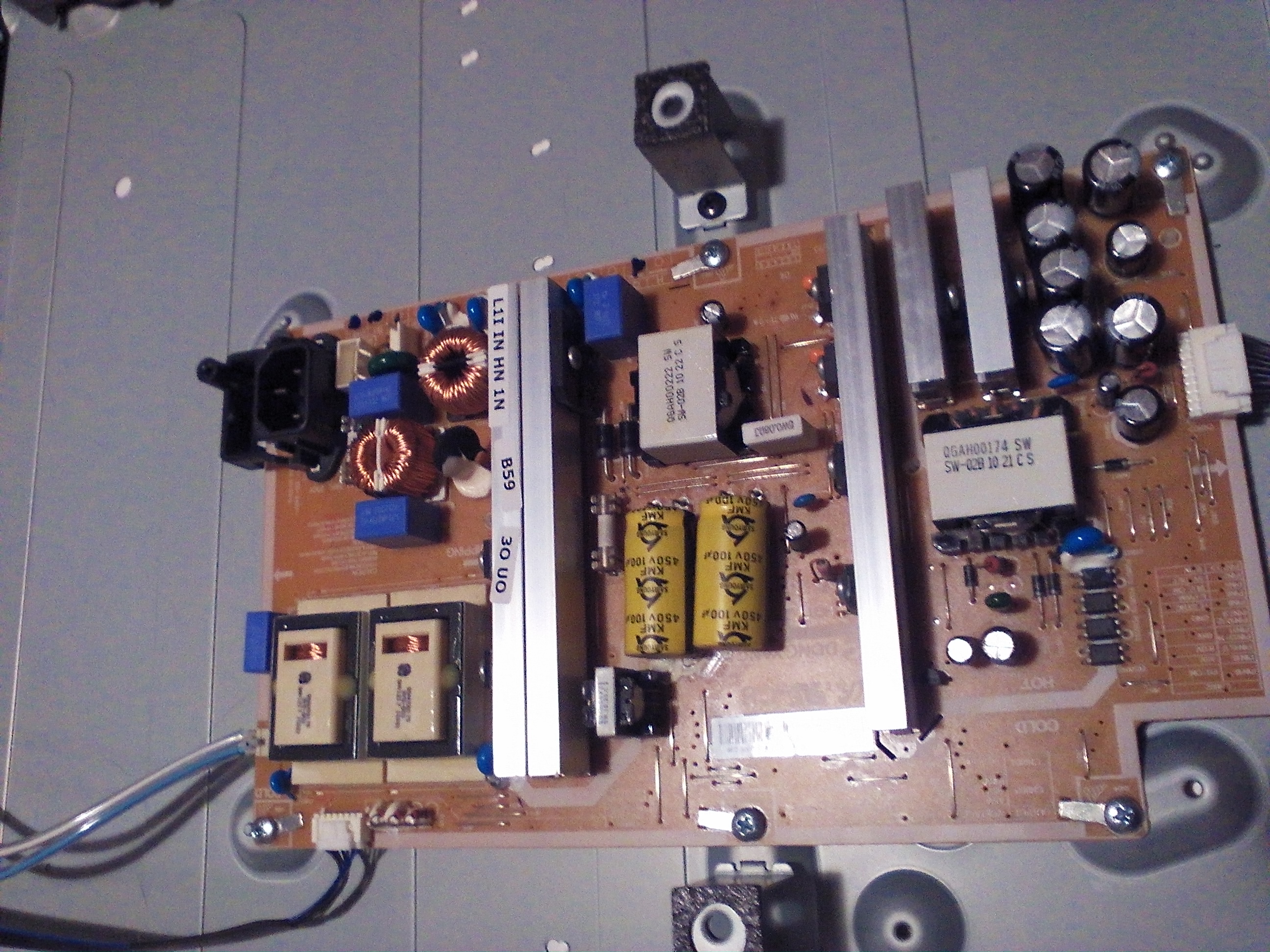

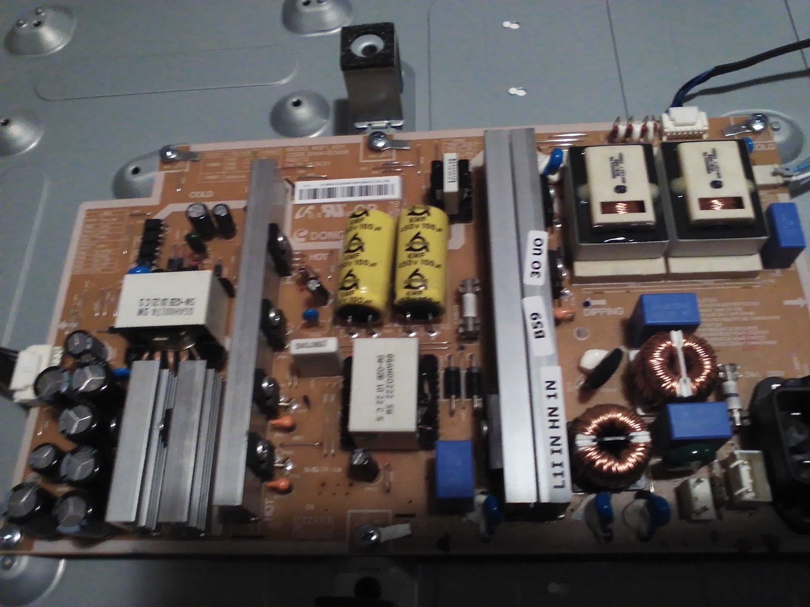

      Thank you for the reply. Power Supply Model is I40F1_ADY. Code is BN44-00340B.
      Please see the attached photos. The caps I've already replaced are the 9 in the lower left corner of the 1st and 3rd pics and the upper right of the 2nd pic.

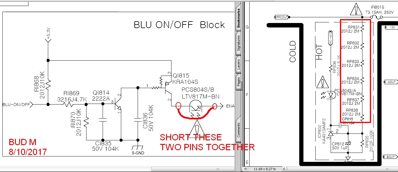

                OK, so the boosted Voltage is OK, one thing we can try is to bypass the PFC Under Voltage protection, see the picture attached.
                You can short out the photo transistor of the Opto PCS804S to see if that will allow the Inverter circuit to come on or not, we know that the PFC Voltage is normal so it is OK to bypass the protection just to be sure that we do not have faulty protection circuit due to bad Opto or resistors that drifted their values. Make sure to look at the diagram really well to make sure you do that to the correct Opto on the board.

                      OK. I shorted the pins you mentioned together - still nothing. Not sure if this helps but I took voltages at the 4 pins of the photo coupler and they are as follows (using the pin numbers found on the photo coupler data sheet):
                      1 -54.7 V
                      2. -55.8V
                      3. -6.9 mV
                      4. -7.2 MV
                      Note that all voltages are negative with regard to ground.

                        to measure the voltage correctly, pin 1 & 2 are reference to HOT ground (ie black lead of meter on negative of cp801/803) Pin 3 & 4 you can use the chassis as ground
                        If you disconnect the main board from the power board (cn802) and plug in the power, do the back lights come on? (not sure if this works on this model but worth a try)

                          Thank you for your help RJ. Using the - of CP801/803 as hot ground
                          Pin 1 = 3.0 V
                          Pin 2 = 1.9V
                          Using chassis ground
                          Pin 3 = -6.9 mV
                          Pin 4 = -7.2 mV
                          I've tried disconnecting the main board from the power supply but it doesn't light.

                            That cannot be right, pin 3 and pin 4 per spec sheet of the opto are the Photo Transistor side which are in the cold side of the circuit, and it is fed by 5.2 power supply through QI815 (KRA104S) which should be on to supply about 5V to the EN pin of the backlights PWM IC.
                            So to have mV at pin 3 and pin 4 it can either be that QI815 (KRA104S)is bad or it is not turned on by QI814 (2N2222, NPN).
                            Start checking DCV on those two Transistors when BL-ON is present.
                            Notes: those pin number assignment in the diagram may not match the spec sheet of the Transistors.
                            You do have 5.3V in that section of the circuit, right?
                            See schematic for more details.
                            BTW, I see that the power supply has pull-up resistors RS861 for the PS-ON and RI868 for the BL-ON which means you can self-test the power supply board by itself without having the cable connected between the power supply board and the main board.
