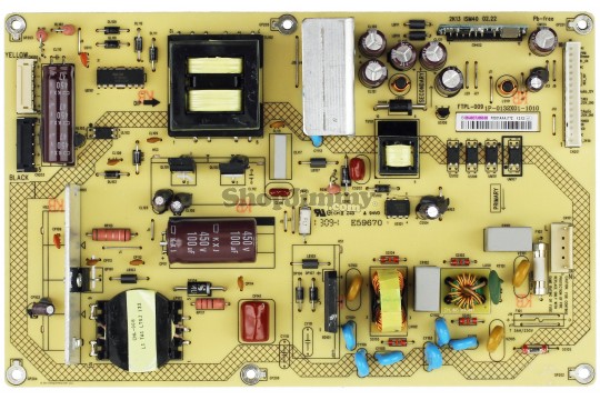

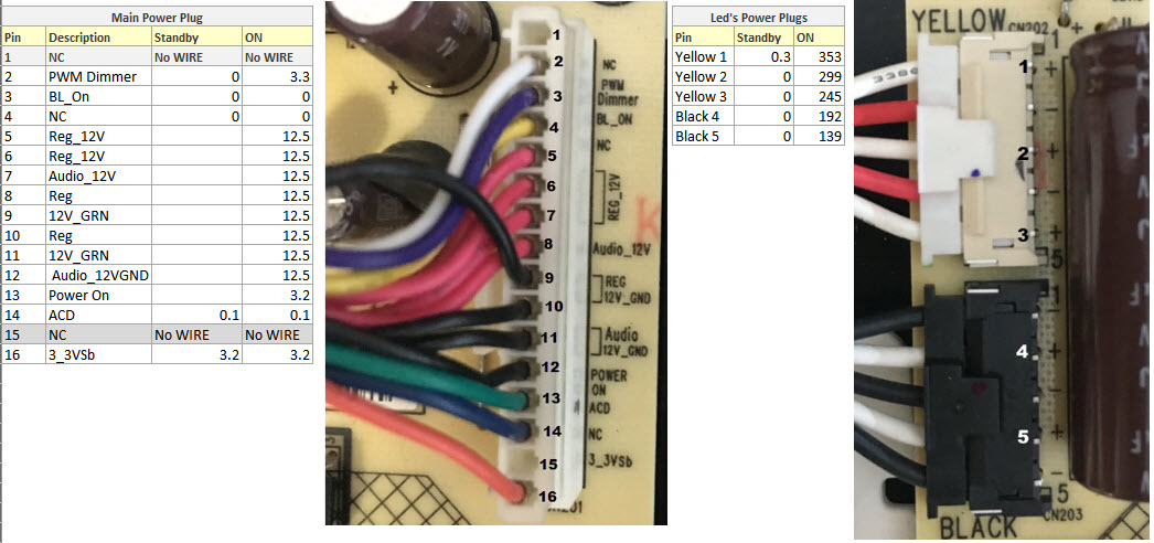

    So far I've tested the power supply and the main board.
    but I'm I need help on what these Voltages mean. First time
    Power supply model: Sharp 9JY0940CTJ05000 (FTPL-009) Power Supply Unit.
    please see attachments for data.
    Thank you.
    Re: Sharp LC-40LE550U No Sound,Video and Blacklight
    Your main board is not sending out BL-ON signal to turn on the Backlights circuit, this can due to ACD (AC DETECT) which monitor the AC feeding the TV to see if it is within the operating range or not, if it is not, the the ACD signal will be <1 V, if AC is good the ACD signal will be >3V.
    The ACD circuit does fail a lot in Sharp TV due to bad Opto Isolator or the resistor feeding the Optoisolator have drifted in value so the Opto is not fully turned on.

          OK, disconnect all the cables to the power supply board except the power cord, but do not plug the power supply cord to the outlet yet.
          Short pin 3 and pin 4 of the Opto UM107 together.
          Attach DCV meter with black probe on the chassis, red probe on the ACD pin then plug in the AC cord to see if the ACD pin will now show around 3VDC or not.

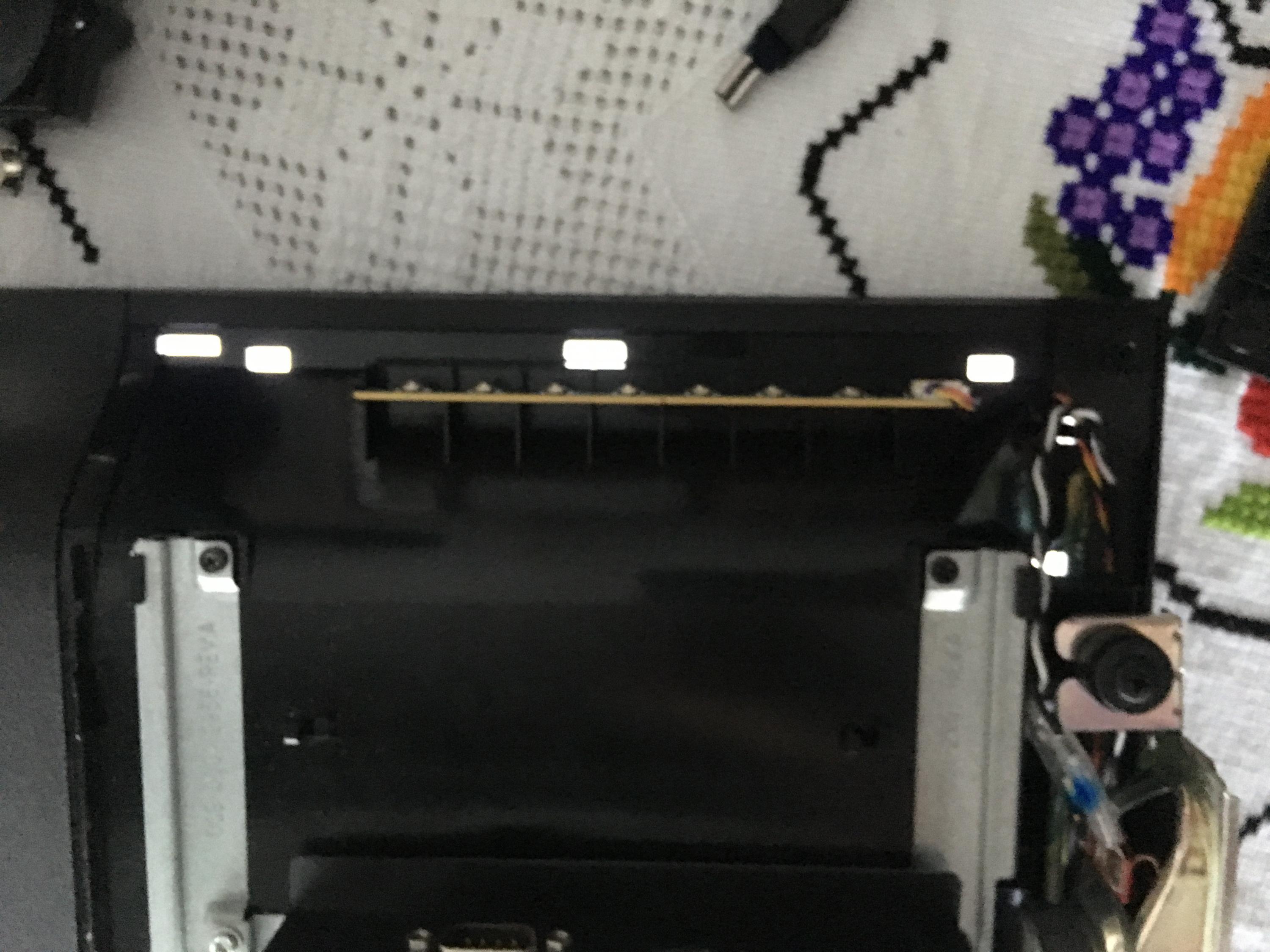

                You can try forcing on the backlights circuit by first disconnecting the BL-ON wire going back to the main board then use 220~510 Ohms resistor between BL-ON pin of the power suply and the 3.3V standby pin to see if you can get the backlights to come on and able to see the pictures on the screen or not.

                      Ok I got the resister and follow what you told me. And I was able to get the back lights on.
                      But I still don't get any image or sound. I also checked the fuse on the T-CON board and read 0. I think that I need to replace the main board. What do you think?
                      Or what do you recommend going forward.
                        So not only that the main board is not sending the BL-ON tO turn on the backlights, it also has other problems as well since if we only have only problem with BL-ON then other functions of the TV should be fine but they are not, so you need new main board at this point.

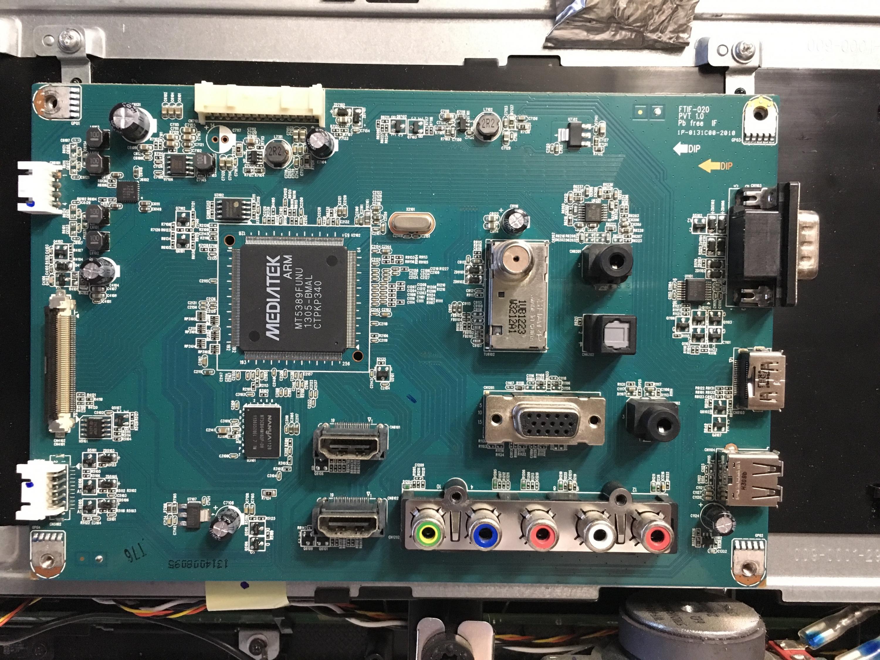

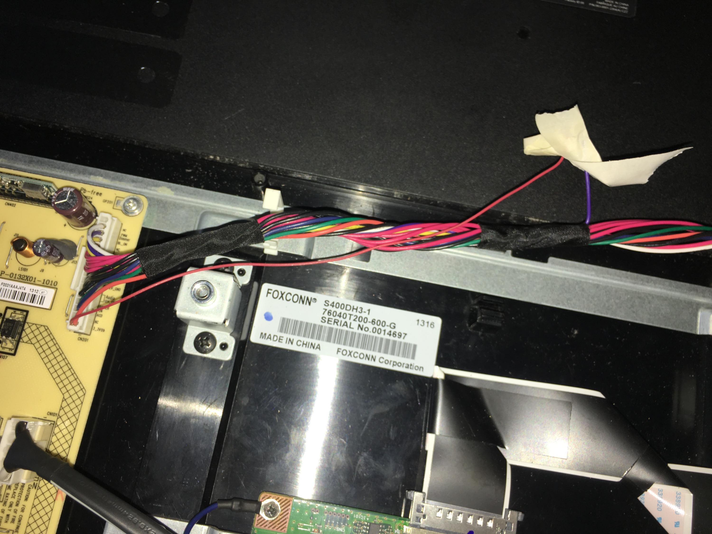

                          Here are some pic.
                            I see at least two 3-pin regulator IC's, u7102, 7107 taht you may want to check the Voltages on all 3 pins.
                            You may also try heating and cooling the board too to see what will happen.
                            The board is about $90 at shopjimmy but he is out of stock right now, it may be common failure board. It is not to spend $90 on this 40" TV since we also know about the possibility of bad connectors for the LCD strip also in the other thread.
