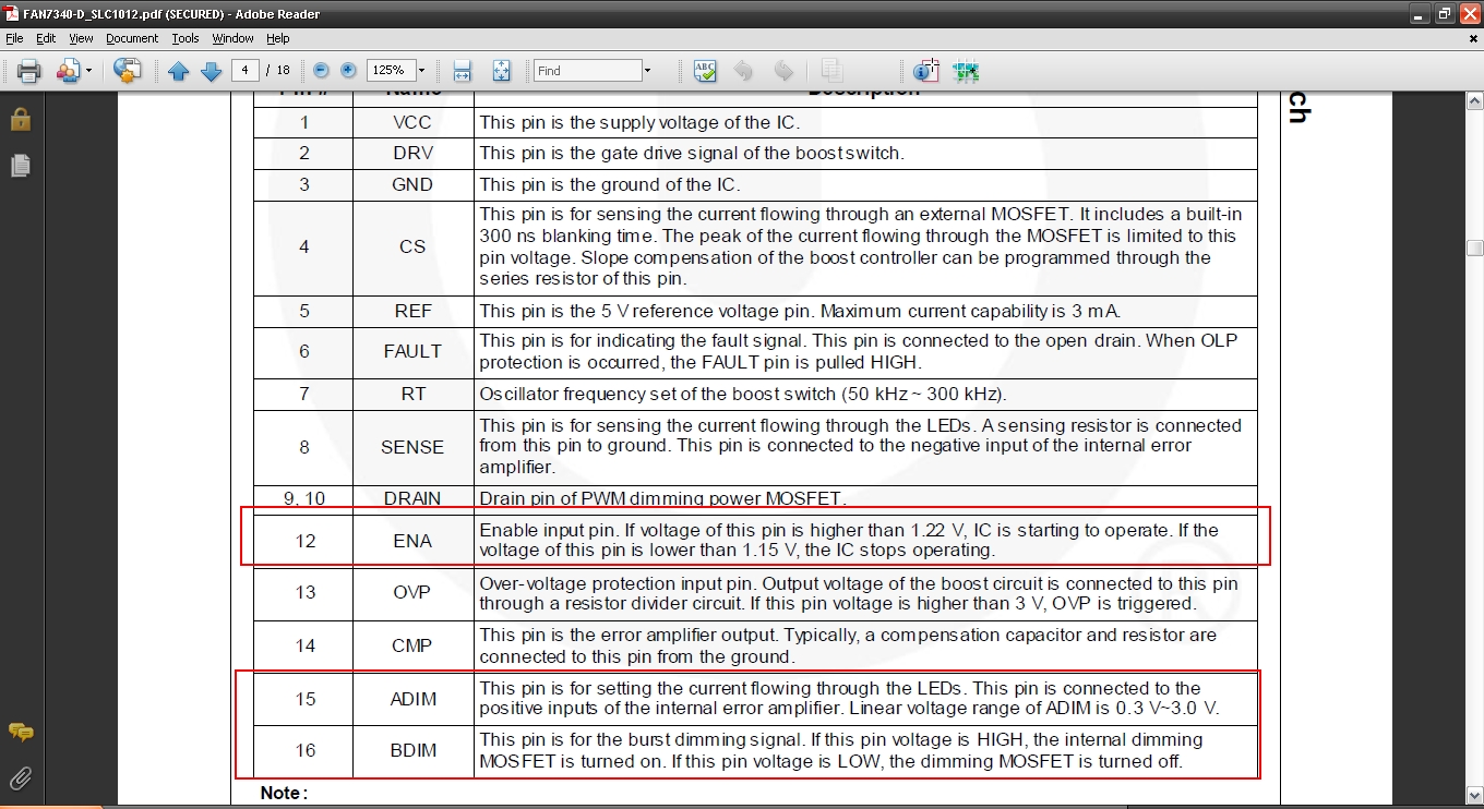

    checked those voltages. im now suspecting failed IC ?
    Pin 1 - VCC 13v
    Pin 12 - ENA 0v
    Pin 15 - ADIM 0.8v
    Pin 16 - BDIM 0.8v

          Re: backlight issue Samsung UE32EH5000
          ENA needs to be 1.22V or greater to operate and switches off if less than 1.15V

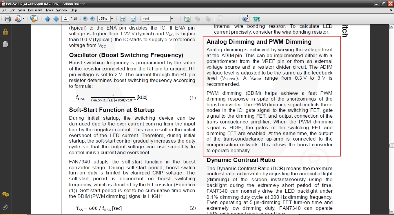

                    That is because it is either the Internal MOSFET for the Catode LED current return line inside that IC is bad or it is not being driven so the LED will not light up. That is why you cane take a chance replacing the IC and see what happen.
                    Spec sheet page 11: Analog Dimming ( ADIM, the range is between 0.3~3V, so 0.8V is OK. BDIM (PWM dimming) must be OK otherwise the boost converter will not be working.
                    Also look at this thread:
                    https://www.badcaps.net/forum/showth...FAN7340&page=2
                    Also check the current sensing resistor on pin 8 to make sure it is OK.
