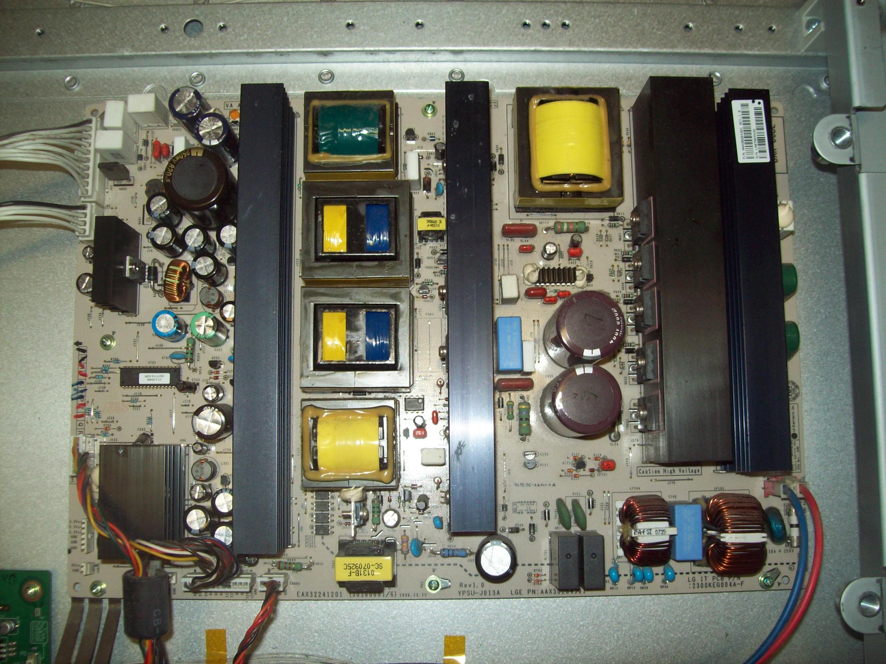

    The set has distortion like the text showing the channel is in a slight zig-zag patter, also an occasional flickering on the entire screen.
    There are 12 capacitors bulged on the power supply board and in testing the voltage it was low from 1 -2 volts below what it should be on all but the 24 volt. Could that cause the issues I'm seeing on the screen?
  • attainteddragon
    • Apr 2013
    • 764
    • australia
    Re: VIZIO P50 HDTV20A Plasma Distortion on Screen
    we can't see any issue!
    replace all of those caps and see if that changes your fault.
        The answer is most likely the caps are causing ripple feeding into your control boards and creating problems with picture

                I replaced 12 obviously bad caps. The voltage is 4.56 for 5, 11.1 for 12 and 22.2 for 24. Not as good as I had hoped. The picture is no better either. I've uploaded a video because the issue is hard to describe. The bright and dimming you see is actual and the close ups show the distortion and blur.

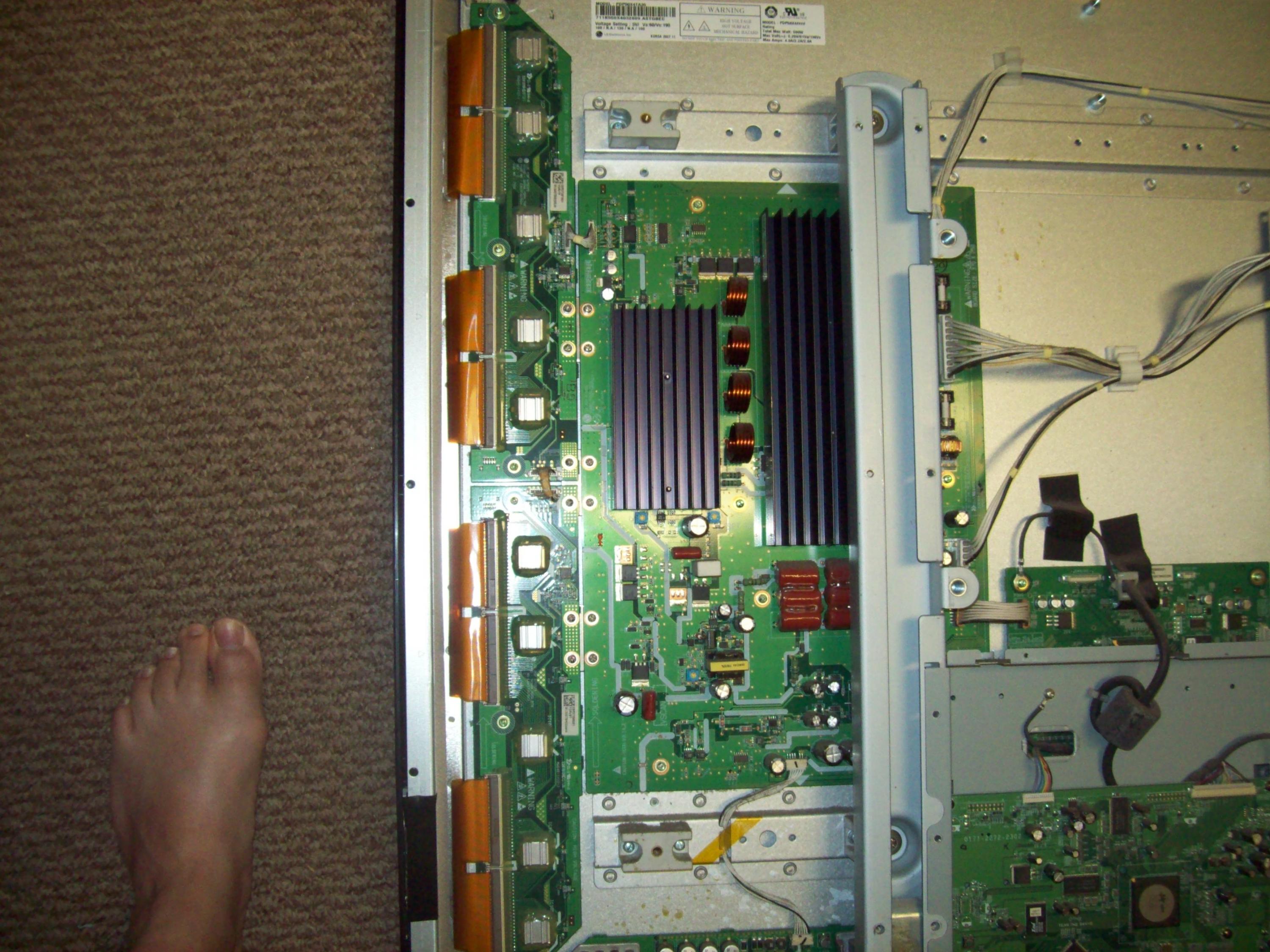

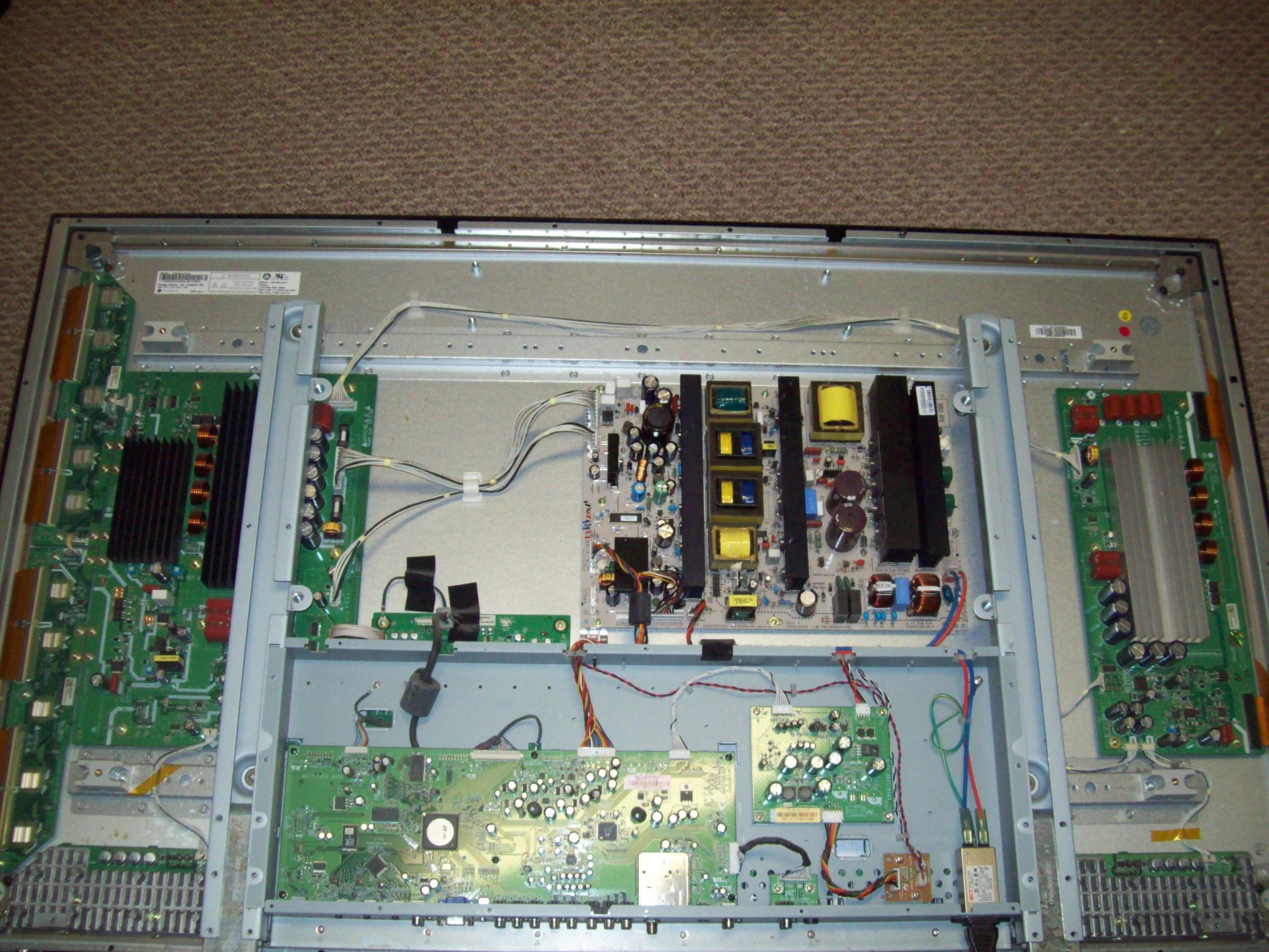

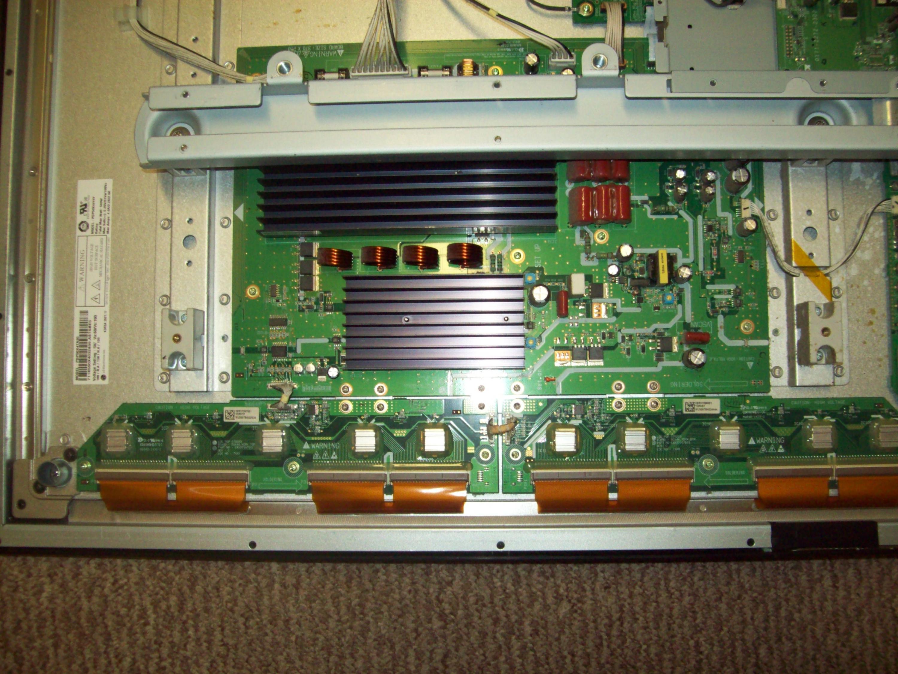

                  post pics of the whole back of the set and of each board. in particular, pic of control board.
                  hopefully we can run the test patterns and narrow it down.
                  WHY CAN'T PHILIPS USE PHILLIPS HEAD SCREWS?

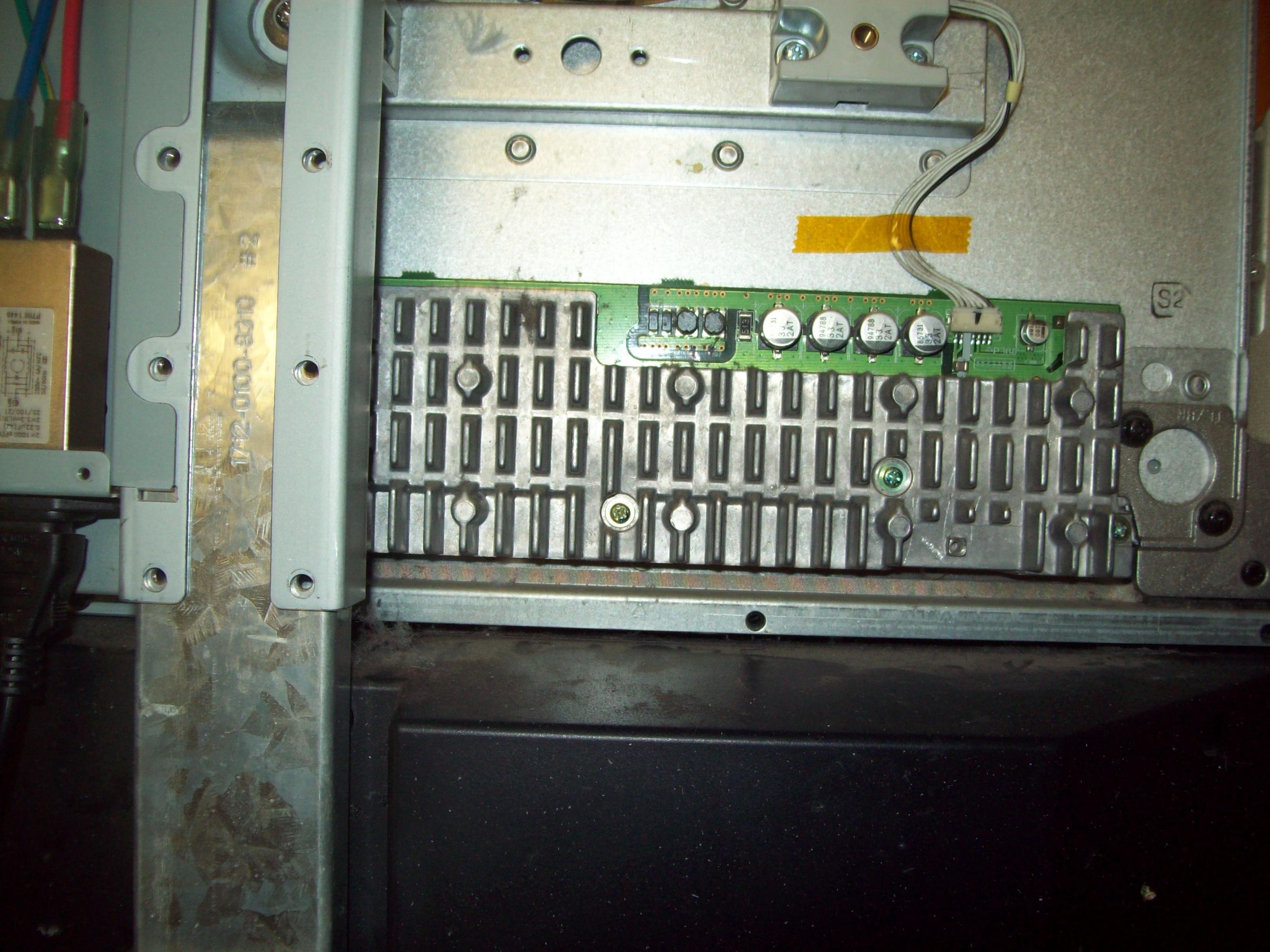

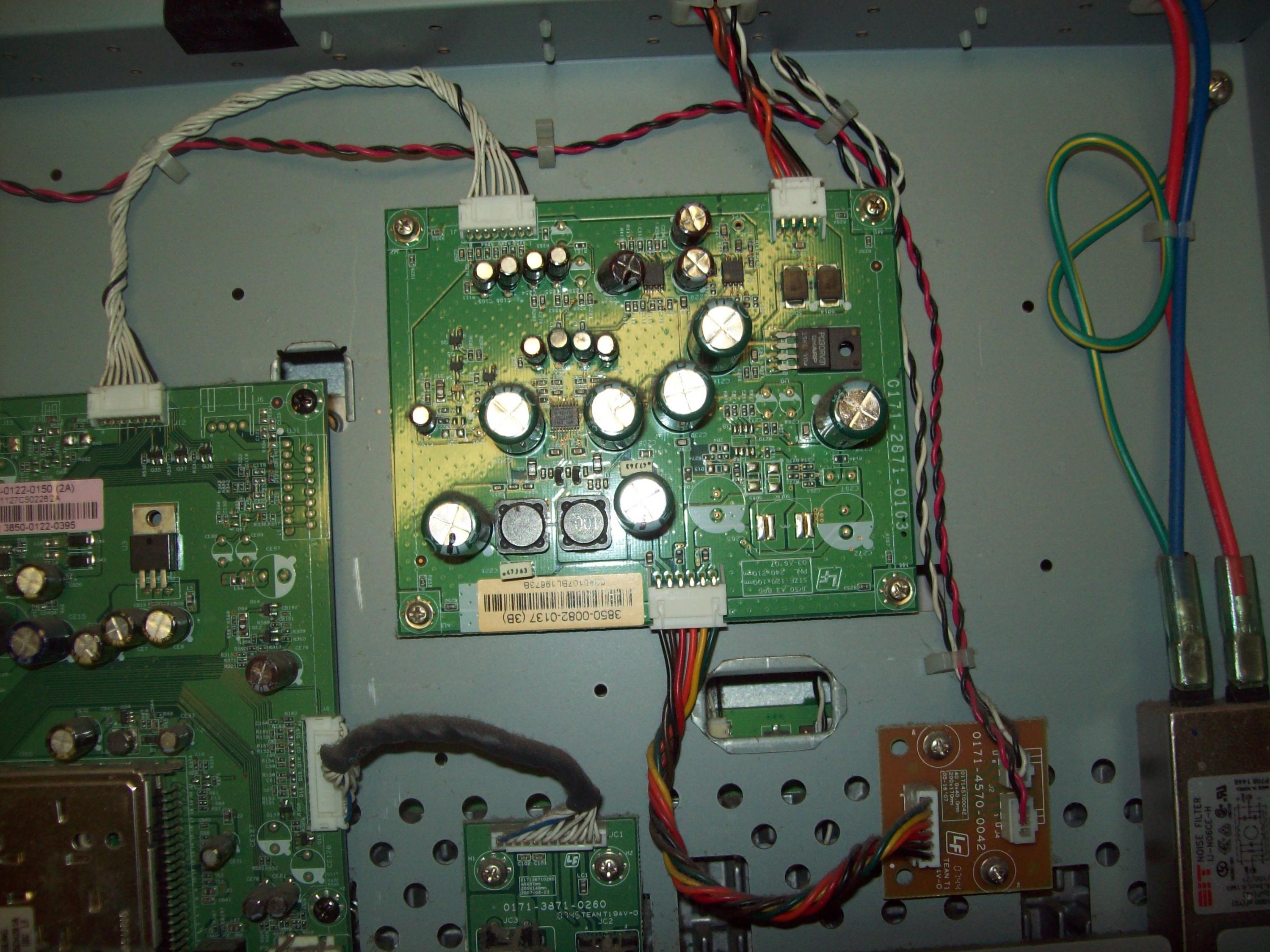

                  • CSF
                    • Jul 2017
                    • 28
                    Here the pictures. Part of 2 boards are under the sheet of steel. I can remeove it if need be. Thanks.
                    • CSF
                      • Jul 2017
                      • 28
                      The board in 100_6061 has been replaced.

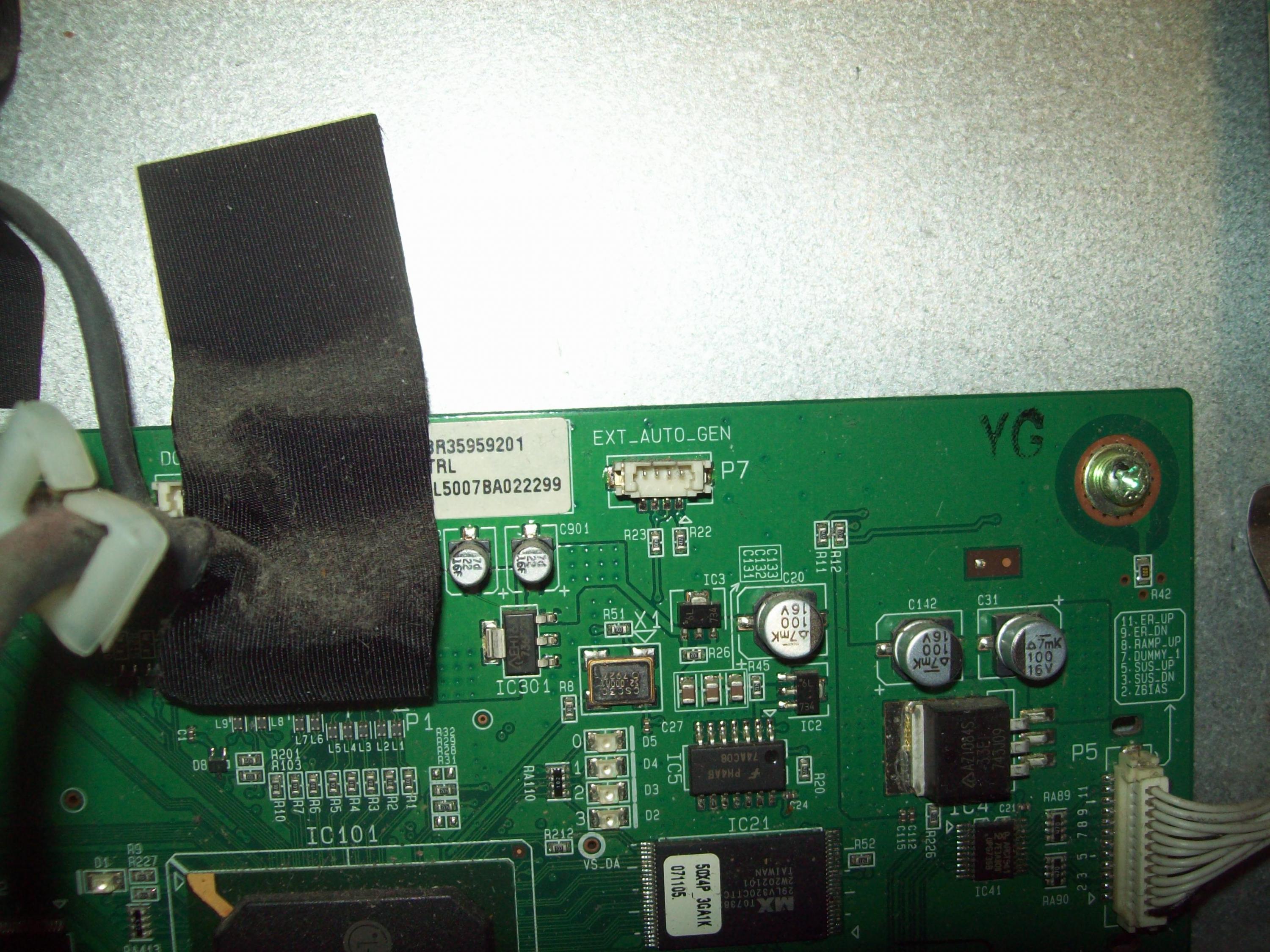

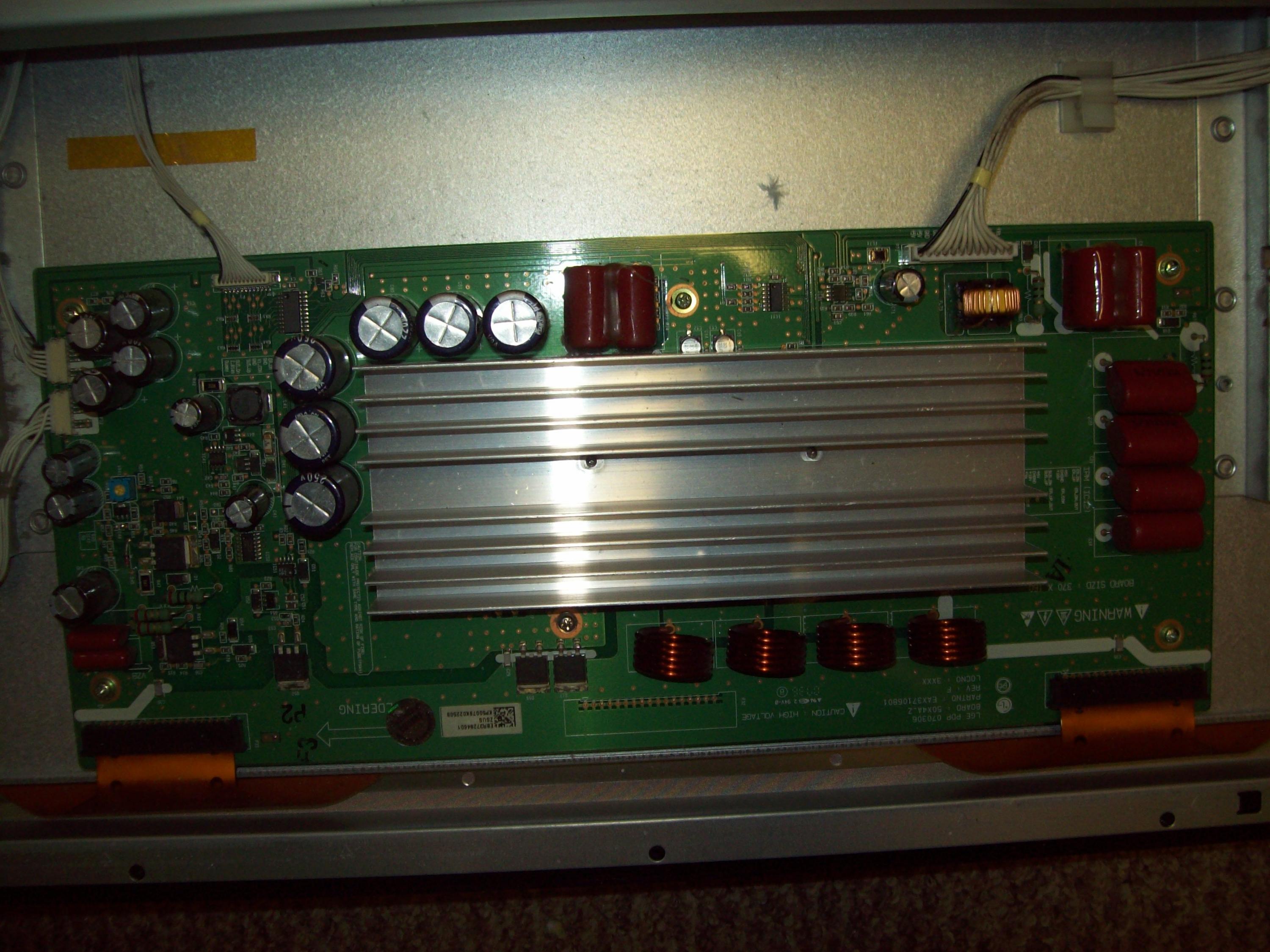

                      • attainteddragon
                        • Apr 2013
                        • 764
                        • australia
                        which board is that?
                        the control board is the one in the last pic. you normally jumper auto-ext-gen
                        (but i'm unsure of the way it is done on this board), and remove the lvds cable. that is the one that goes from the control board to the main board. then apply power and you should get test patterns. if the fault is still present, then it is most likely your control board and if it has a clean picture, then it is your main board causing the picture issue.
                        hopefully someone that knows this control board and let us know of the jumper set up.
                        • CSF
                          • Jul 2017
                          • 28
                          This one, I think its called the Z board sometimes.
                          I'll look auto-ext-gen and see if I can do that diagnostic. It would be very helpful if some one knew that control board. Thanks for your help.

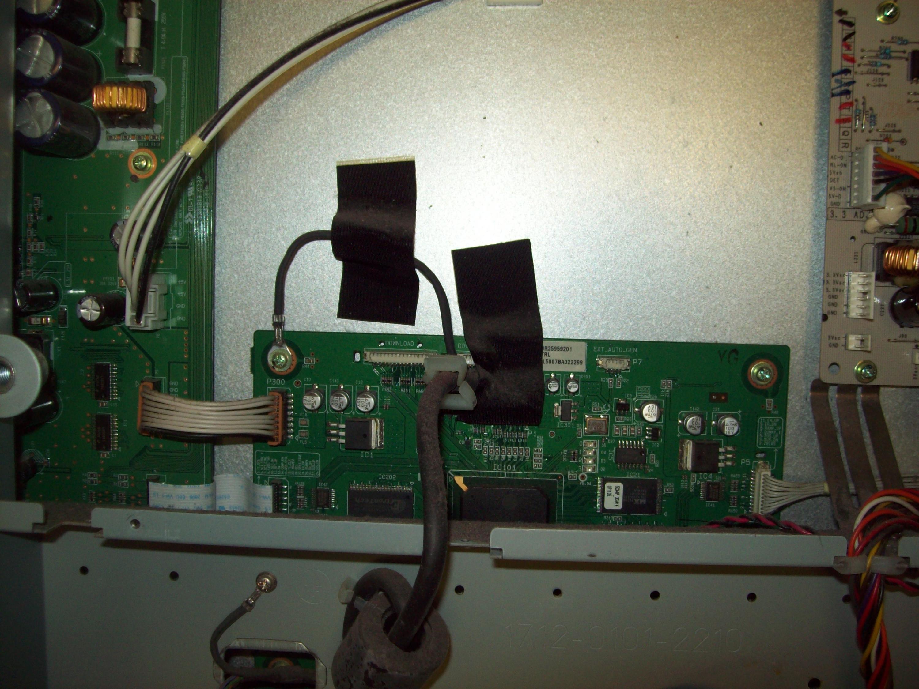

                            I see it the EXT_AUTO_GEN. It has 4 pins on it, so I don't want to go poking around without a map. Here is a picture.

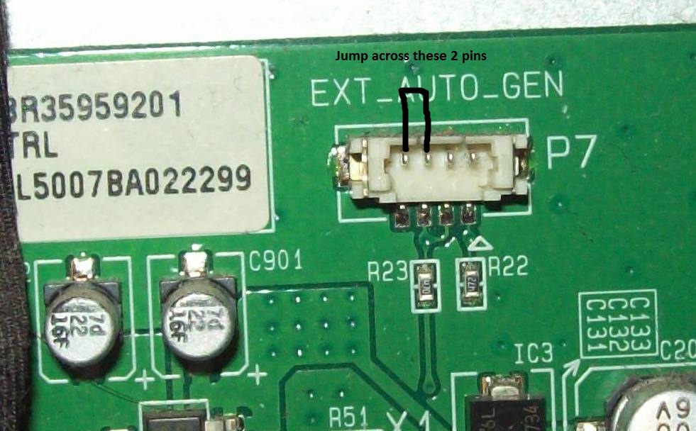

                              Okay I found this thread that told me how to jump EXT_AUTO_GEN and get a test pattern.
                              https://www.badcaps.net/forum/showthread.php?t=57818
                              I took a video of the test. The pattern was snowy and the bright flashing was still there on some patterns although not as bad. Near the end of the video notice the text in the corner of the screen. It is from a local TV station WSBT and it's like it was burned in, for lack of a better description. FYI I can get a good control board on ebay shipped for $6.99.

                              • attainteddragon
                                • Apr 2013
                                • 764
                                • australia
                                can you show a pic of how you did the jumper, so others that see this can have the information as well.
                                from the vid, i would say that the control board is good and you are looking at a main board issue.
                                the burn in can probably be reduced by running a white wash pattern over it for a while, but you will need to check your voltages since you have changed out the x-main. first, you will need to get a good pic though.

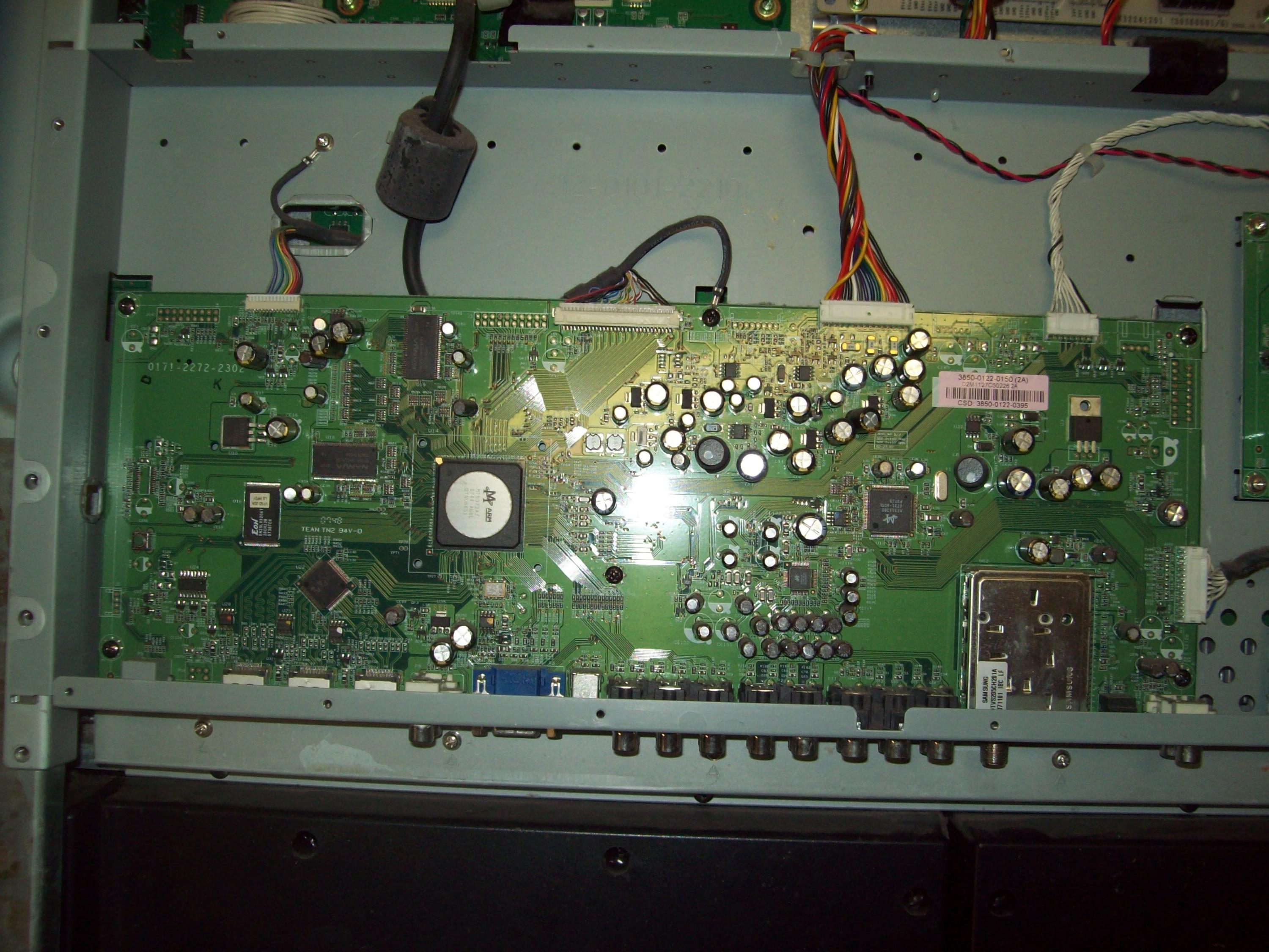

                                  I'll edit a picture to show the jumper set up. From what you told me the test patter must have been okay? It wasn't as clear as I expected it might be.
                                  So the board in this picture is the main board correct.
                                  • CSF
                                    • Jul 2017
                                    • 28
                                    To jump the EXT_AUTO_GEN for a test pattern see picture.
                                      As for the x-main, I could put the other one back in. It didn't make any difference changing any how.
                                      • attainteddragon
                                        • Apr 2013
                                        • 764
                                        • australia
                                        the picture looked ok to me, but you get to see it first hand.
                                        the main is the one that you have indicated.
