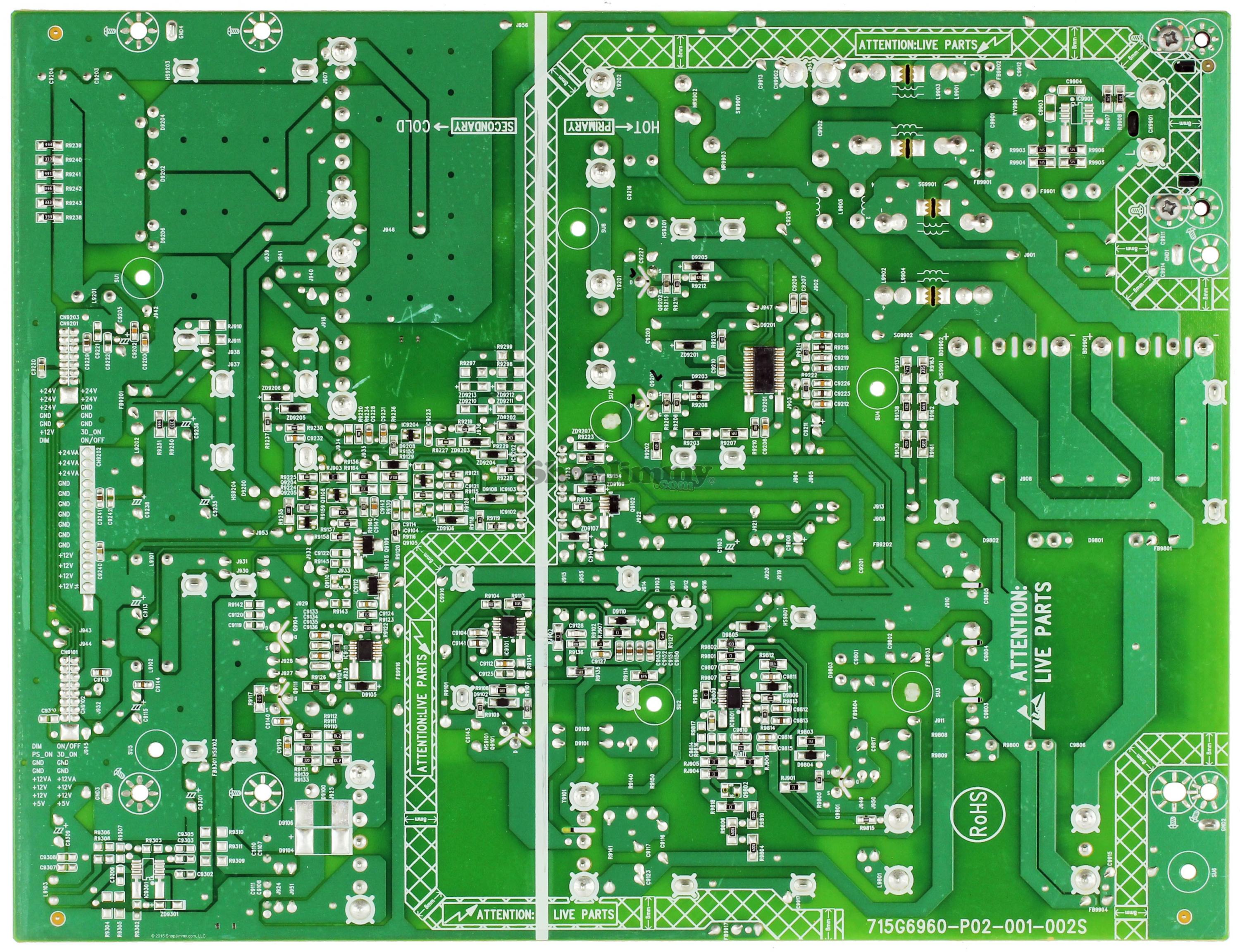

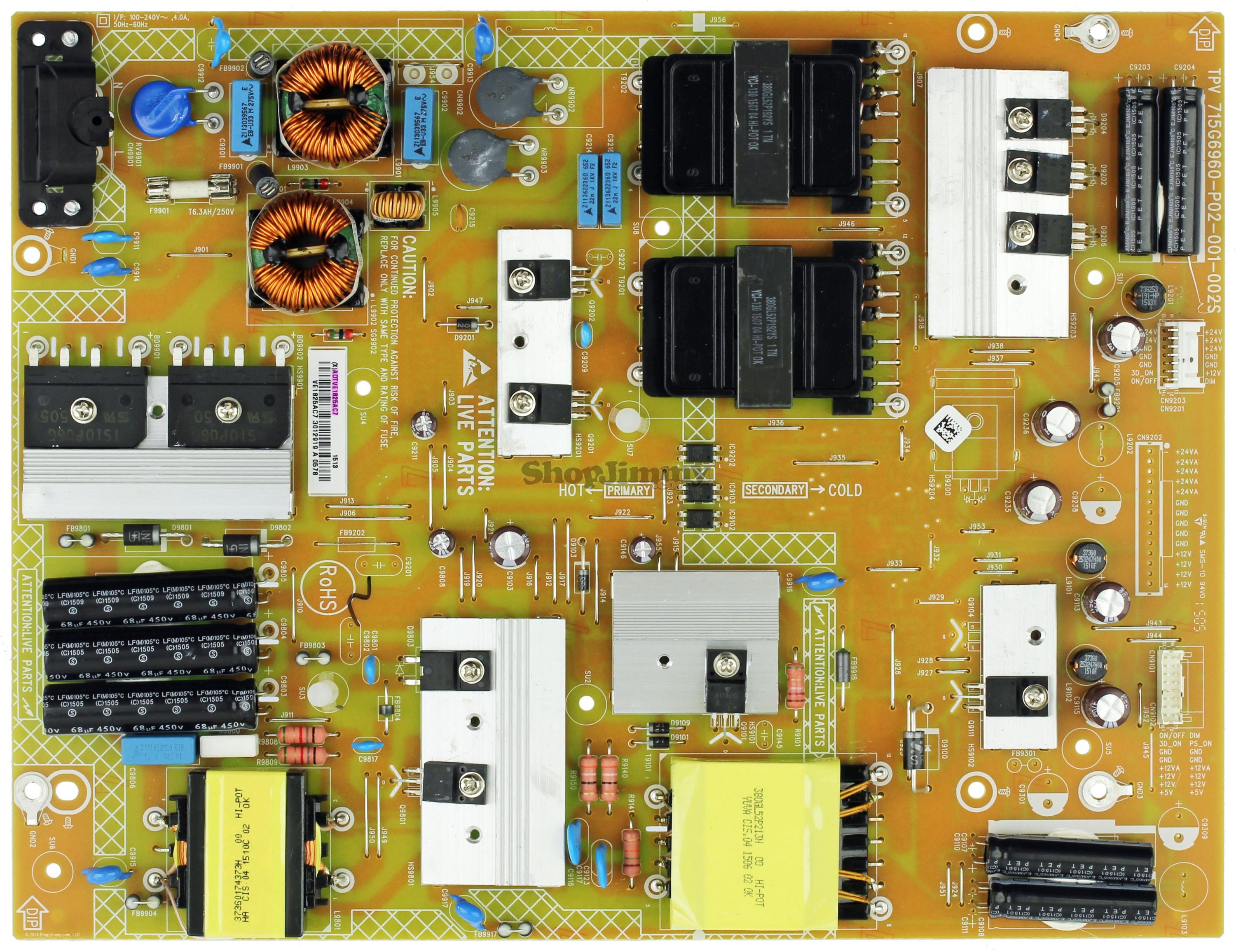

    FYI.. Vizio M49-C1
    Just an FYI.. The voltages labeled at CN9101/CN9102 on the power supply (ADTVE1825AC7) are incorrect. all the +12V are actually 19V. I spent hours trying to figure this out and even swapping out another PS that had matching pin outputs with the correct 12V. a pic of the board from shopjimmy attached
    Found this TV at the dump, new with stickers. the screen would work for a few minutes then go all white or red. Turns out the LVDS cable was not completely connected in the TCON causing it to act up. A strip of tape fixed all my issues, it's been running well since then.

      Re: FYI.. Vizio M49-C1
      Those 12V's look to done by Synchronous Rectification (MOSFET Q9111, IC9111), I wonder if there is problem in that section to make it output 19V instead of 12V. You may want to look up the spec sheet of that SMD IC9111 to see how it functions.
      http://citeseerx.ist.psu.edu/viewdoc...=rep1&type=pdf
      The MOSFET is on the low side on that board.
