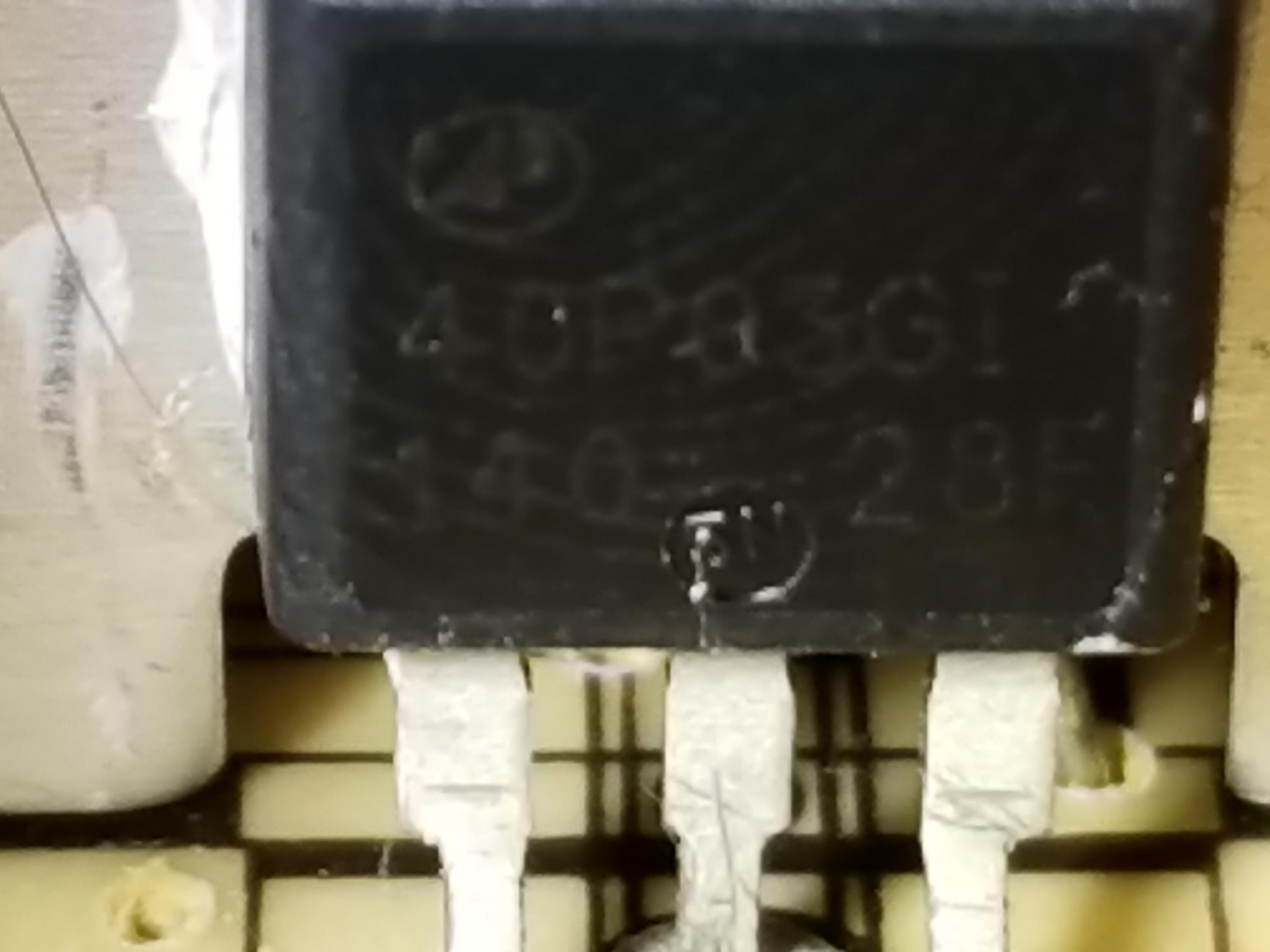

                    OK powering up the tv normally, both outer pins read 12v and when I touch the middle pin it starts at around 6v and immediately drops upon putting my lead on it. All this had to be done within 3 seconds due to the power board making the clicking noise and shutting down the tv which then it displays the flashing error codes on the front, I'm attaching a picture of the q7120 mosfet, best I can read it says 40P03G1 140 28F, Im going to a friend's tomorrow to get a resistor to try and jump the 2 pins as you suggested, I don't currently have one

                      Here is a clearer picture of q7120
                        https://www.badcaps.net/forum/attach...4&d=1500602551
                        The left pin is GATE, the middle pin is DRAIN, the right pin is SOURCE.
                        So if you leave black probe on the chassis and Red probe on the GATE pin and watch the meter to see if the GATE pin Voltage goes down to less than 10V or not, if it does not change at all then it may be that the circuit is not getting the PNL-POW signal from the main board so you need to move the red probe to the PNL-POW pin and watch the meter to see if PNL-POW goes to>2V or not when the TV is turned on.
