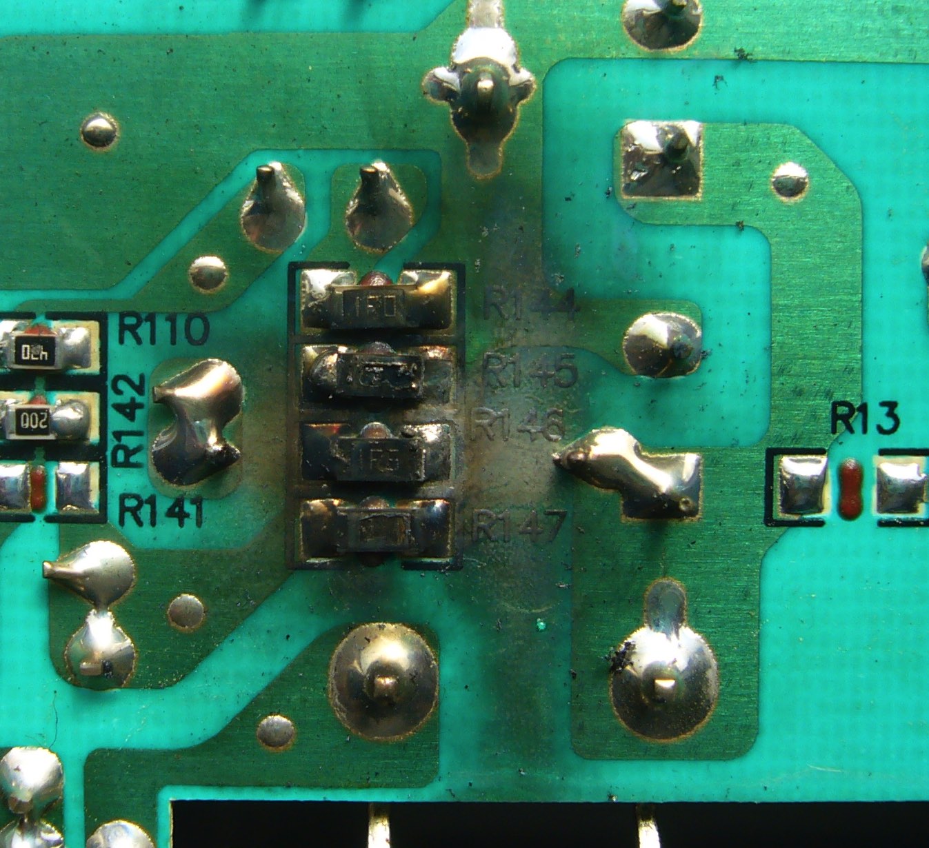

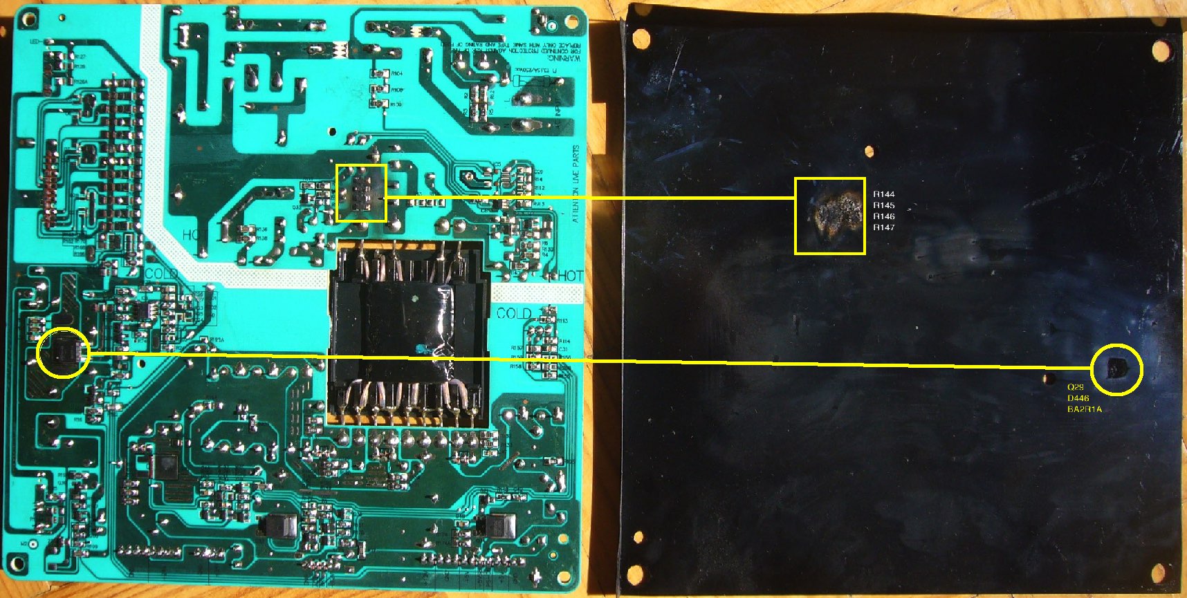

    Bottom side of the pcb is where the action has taken place and 4 surface mount components (resistors) have experienced some action and blackened the immediate area.

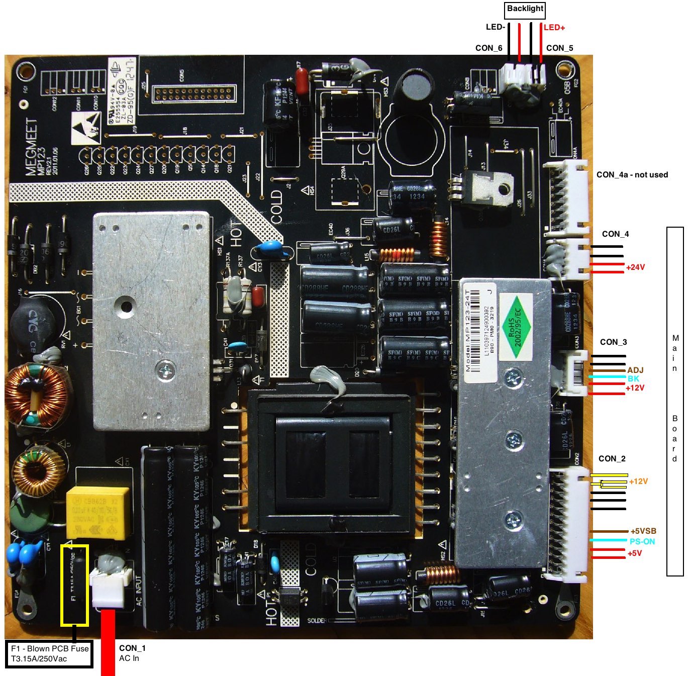

    PSU markings;
    PCB: MEGMEET MP123 REV:2.1 2011.01.06
    Label: Model MP123-24T
    Pictures:
    TOP - I have drawn in the connections (I reassembled the tv and put it in the garage) and pcb markings. Connectors 2/3/4 go to the main board & 5/6 go to the backlight.
    BOTTOM - this is where the frazzling has taken place. On the black plastic shield shield there is the main area where something has happened and then another patch which corresponds to component Q29 - this might just be a contact mark as Q29 looks pristine. (marking is;D446 BA2R1A).
    BLACKENED COMPONENTS - R144/R145/R146/R147 - I can't read the values:

    Try Google for the schematic, but it seems to be different, the resistors look like 1R0, 1 ohm and most likely are in the source of the fet that would also be shorted
    The similar power supply on shopjimmy uses 1-1R5 and 3-1R0 in parallel

      They look to be 1 Ohm (1R0) resistors connected in parallel to form 0.25 Ohm current sensing sensor, one end are connected to primary circuit Ground, another ends should be connected to the Source pin of the MOSFET Q31 that drive the power transformer.
      Are the resistors showing open circuit right now?
      More likely the MOSFET has shorted out and it probably took out the SMPS IC that drives the Gate of the MOSFET also.

        Non of the resistors give a consistent reading.
        For example R147 starts on 0 jumps to 20m then drops down to 130k then jumps up to 300k then 1m and starts going up.
        Measure it a second time and it behaves similarly but in different intervals.
          Re: Dumpster find LCD with Megmeet MP123 PSU with frazzled components - ideas please.
          Try removing the resistor and measure it off the board.
            The resistors have been blown apart! what did you think you would measure? your measuring the carbon thats left over after they burnt.

                Off the board;
                R144 - OL
                R145 - 1.345M
                R146 - OL
                R147 - OL

                  I might have one of those boards in the workshop, or a very close relative, those particular PSU's are very expensive and difficult to obtain.
                  Found it,
                  R144 1R00
                  R145 1R00
                  R146 1R00
                  R147 2R20
                  Hope this helps
