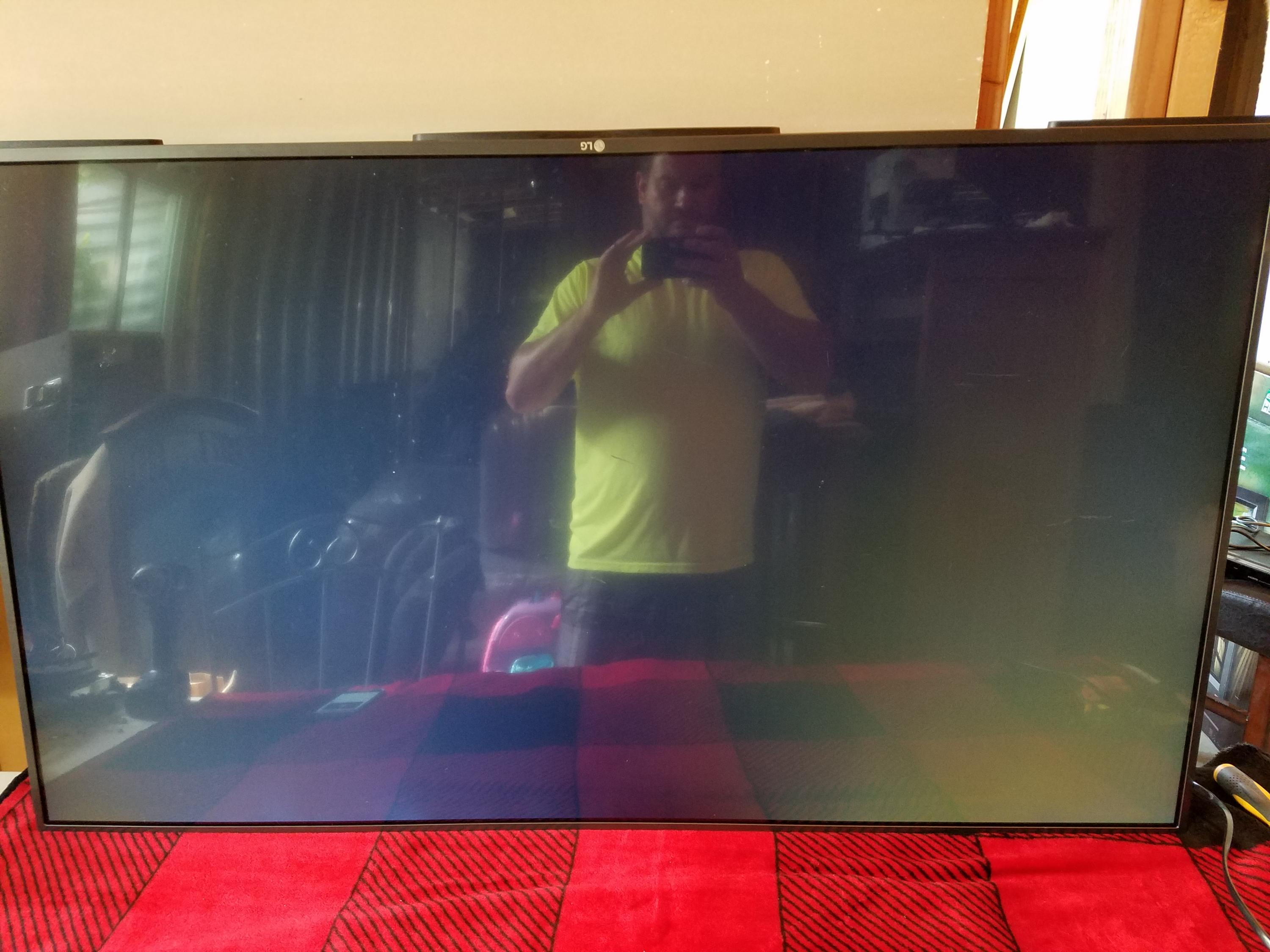

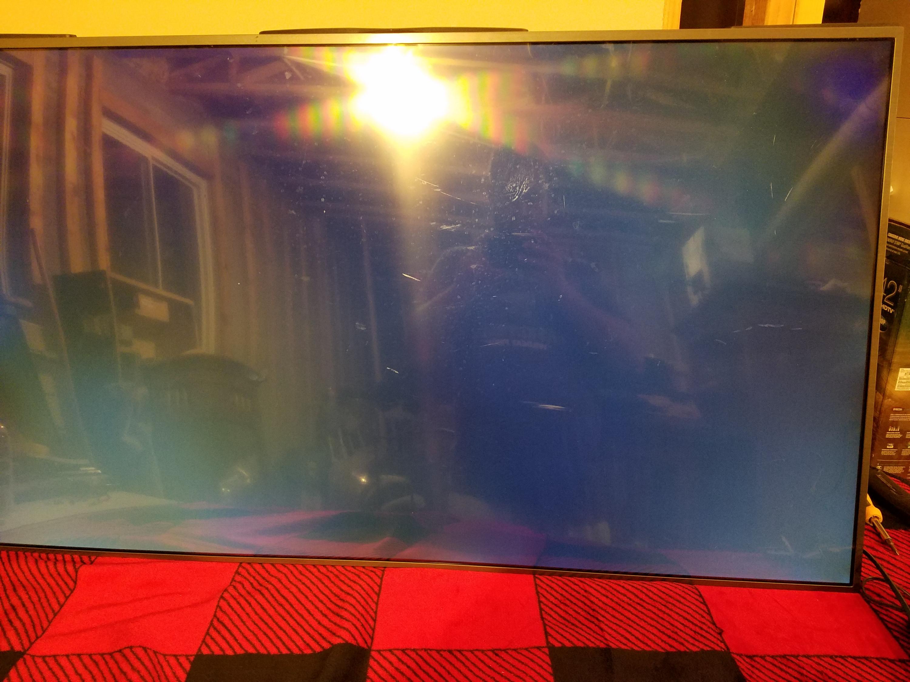

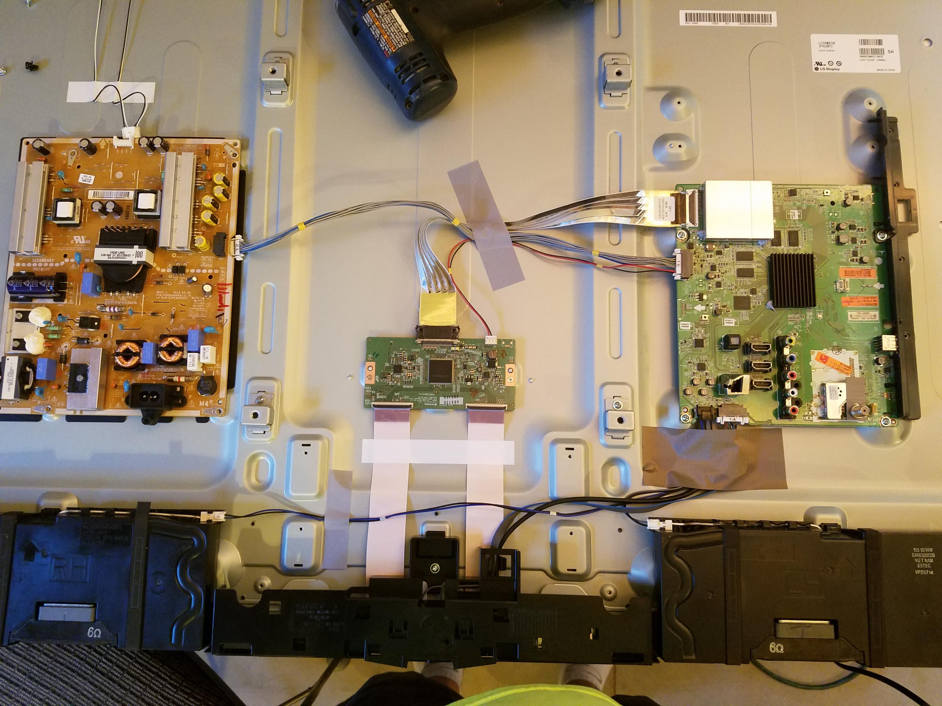

    I have a LG 55UF6450-UA that when I turn it on it is just a white screen that does not show any menu or volume text on the screen and is unresponsive to remote commands except power on and power off. What are some things that I should test to try to narrow down the problem?

    Re: LG 55UF6450-UA with white screen

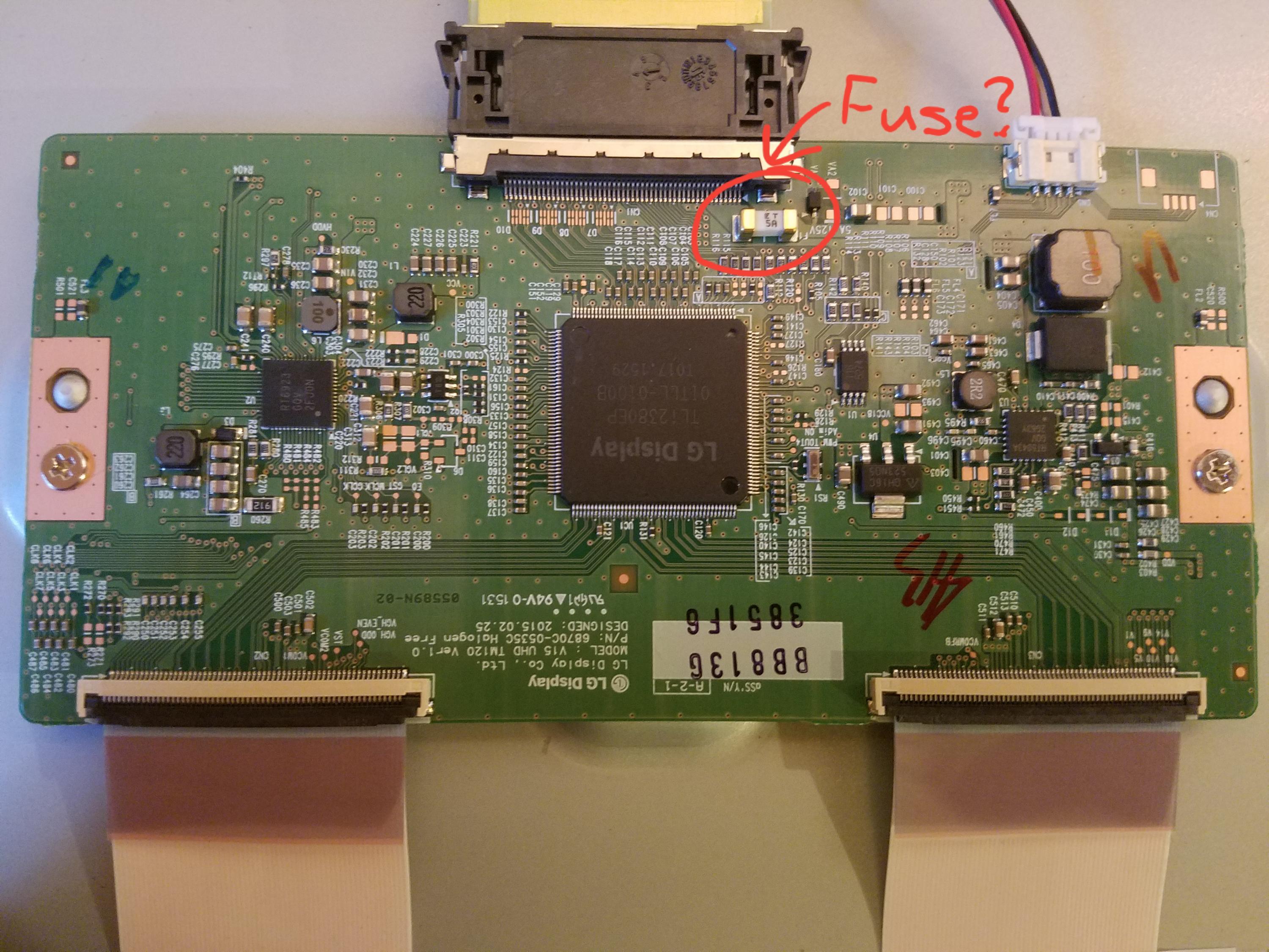

    Check on both sides of t-con board fuse for voltage
      Also to clarify and update after further testing... It is a dim lit screen when I turn it on, not a bright white (1st picture). When I unplug one side of the T-Con it gets bright white on one side (2nd and 3rd pictures). Also I have been able to get volume coming out of the TV from an input. I think that this might mean a bad T-con? Is that correct?
        If this is the fuse I have circled in red then when I tested on each side I am getting 13.22V.
          T-con on the bottom of the TV, you may have liquid damage to the panel, hope not.

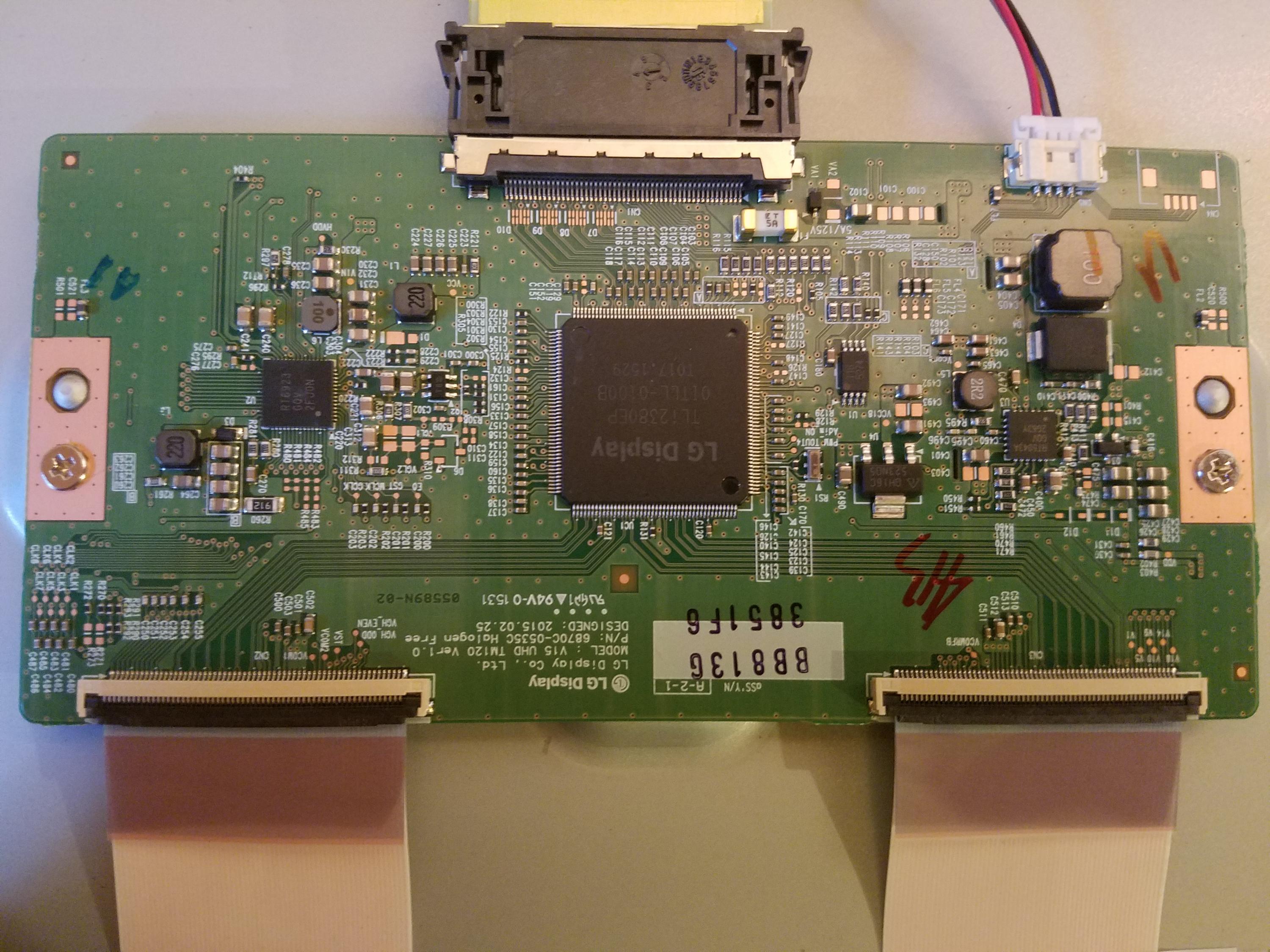

              I would check voltages on t-con
              T-con voltages (typical)
              1. Vin (Vcc): 12Vdc or 5Vdc
              2. (Vlogic,LCM, Vddd,VCC): 3.3Vdc
              3. Vda (Vs, Vsource,VDD, Vdda,Avdd): 14Vdc~20Vdc
              4. Vgh (Vgon,VGHR, Von, Vddg): 20Vdc~30Vdc
              5. Vgl (Vgoff,VST,VGHF,VGHEVEN, Voff,Veeg): -5Vdc~-7Vdc
              6. HVDD about 8v
              7. DVDD,VDDC 3.3v, 1.2v
              8. VCOM about 28v
                  1. Vin (Vcc): 12Vdc or 5Vdc.
                  (13.22)
                  (3.3)
                  (16.61)
                  (27.9)
                  5. Vgl (Vgoff,VST,VGHF,VGHEVEN, Voff,Veeg): -5Vdc~-7Vdc.
                  (Flashing between -7 & 27)
                  6. HVDD about 8v.
                  (8.09)
                  (can't find...)
                  8. VCOM about 28v
                  (5.5, says VCOM1)
                    in my notes, i have vcom listed as half of avdd approx.
                    perhaps someone can clarify this one.
                      VGL should be steady. Researched vcom should be around 5.5v. Still learning
                        Run test patterns on the TCON.
                        • Hamie
                          • Apr 2014
                          • 1383
                          Vgl isn't steady, your readings are normal.

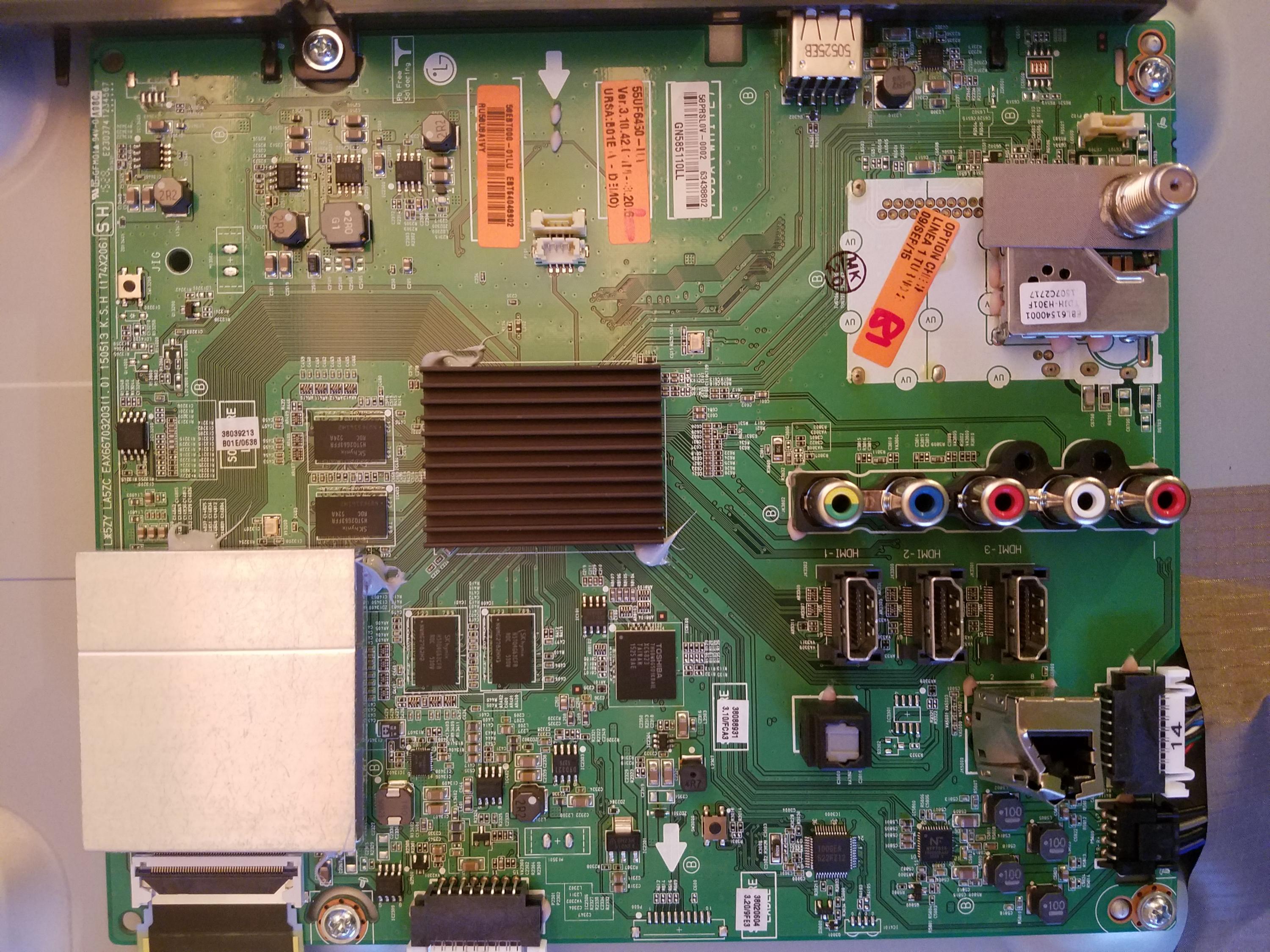

                          I suspect bad mainboard as these UF models are breaking down all over the place and it's always the mainboard.
                          Test patterns will confirm.

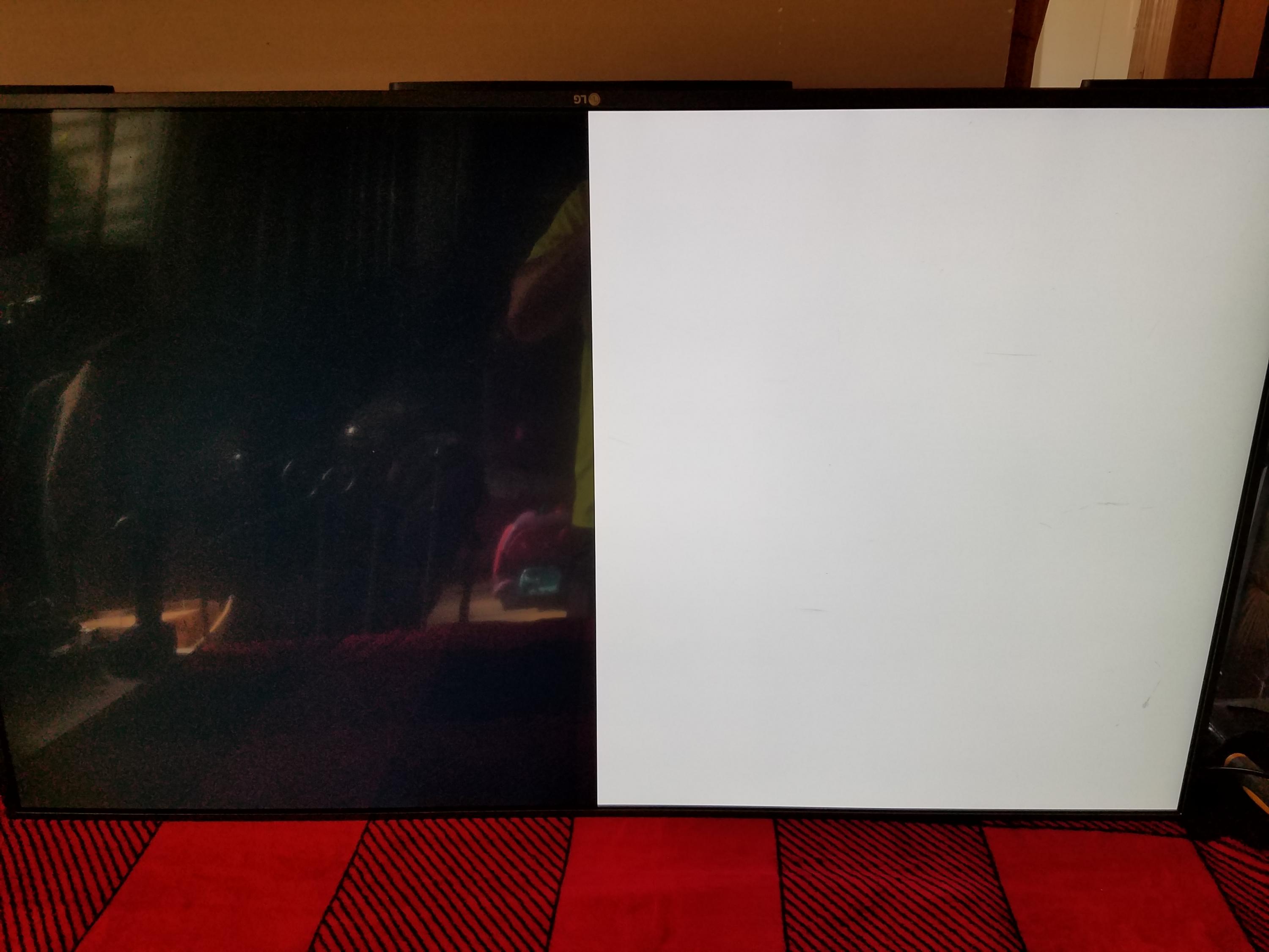

                              Disconnect the lvds cable.
                              Connect a wire from 12v on the power supply and solder it to the TCON fuse.
                              Finally solder a small piece of wire to the vdc test point and connect it to pin 44 on the TCON input.
                              Turn on the tv.

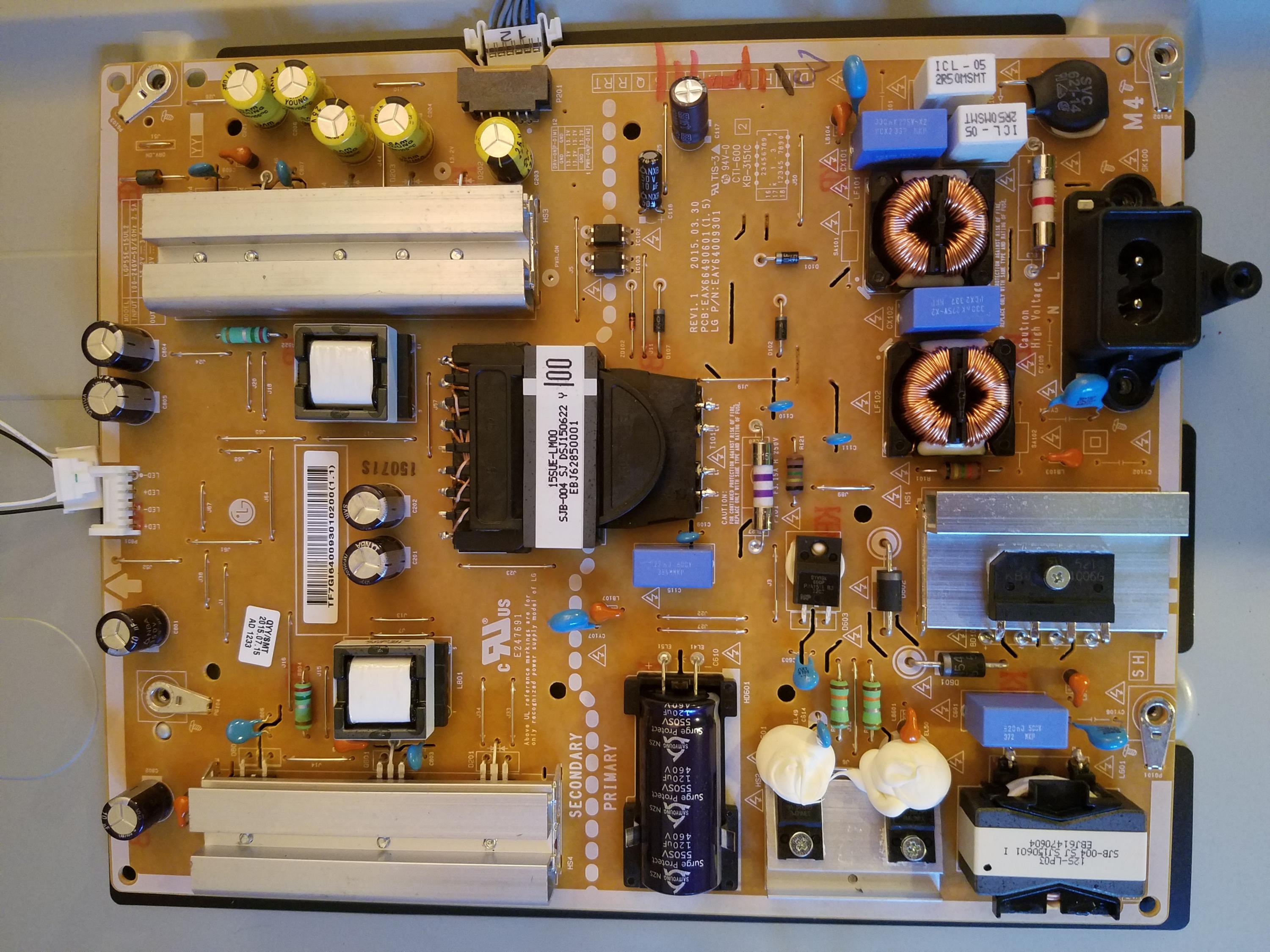

                                Okay, a few questions for clarification before i do this.
                                1) Is the lvds cable the input cable that comes into the topside of the TCON board?
                                2) I can't find a DC 12V+ source on the power board... Where should I be able to find this at?
                                3) Last, where is the VDC test point, n the TCON? I can't find it. Also I can't find a pin 44 on the TCON? Any help on location of these would be greatly appreciated.

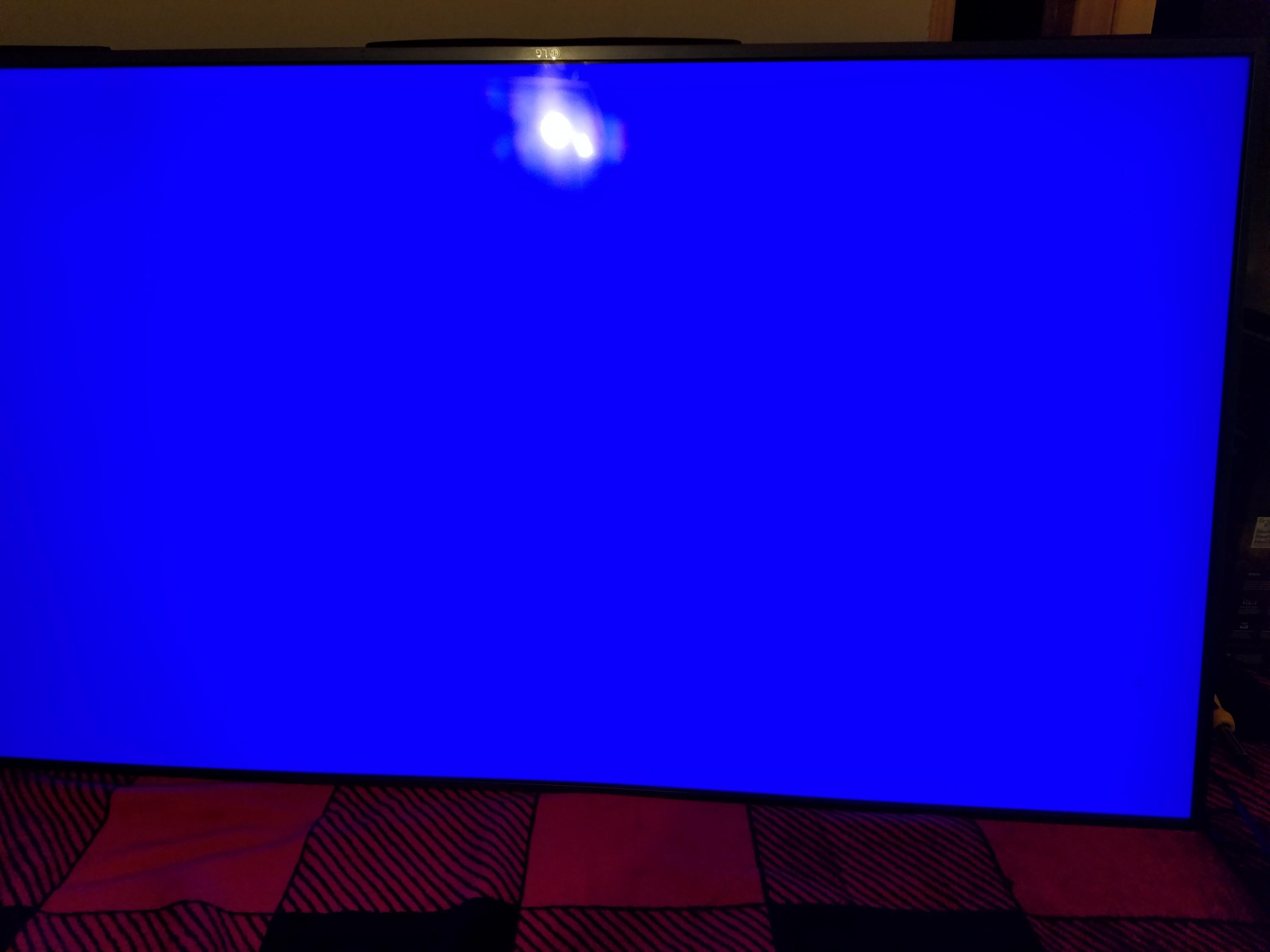

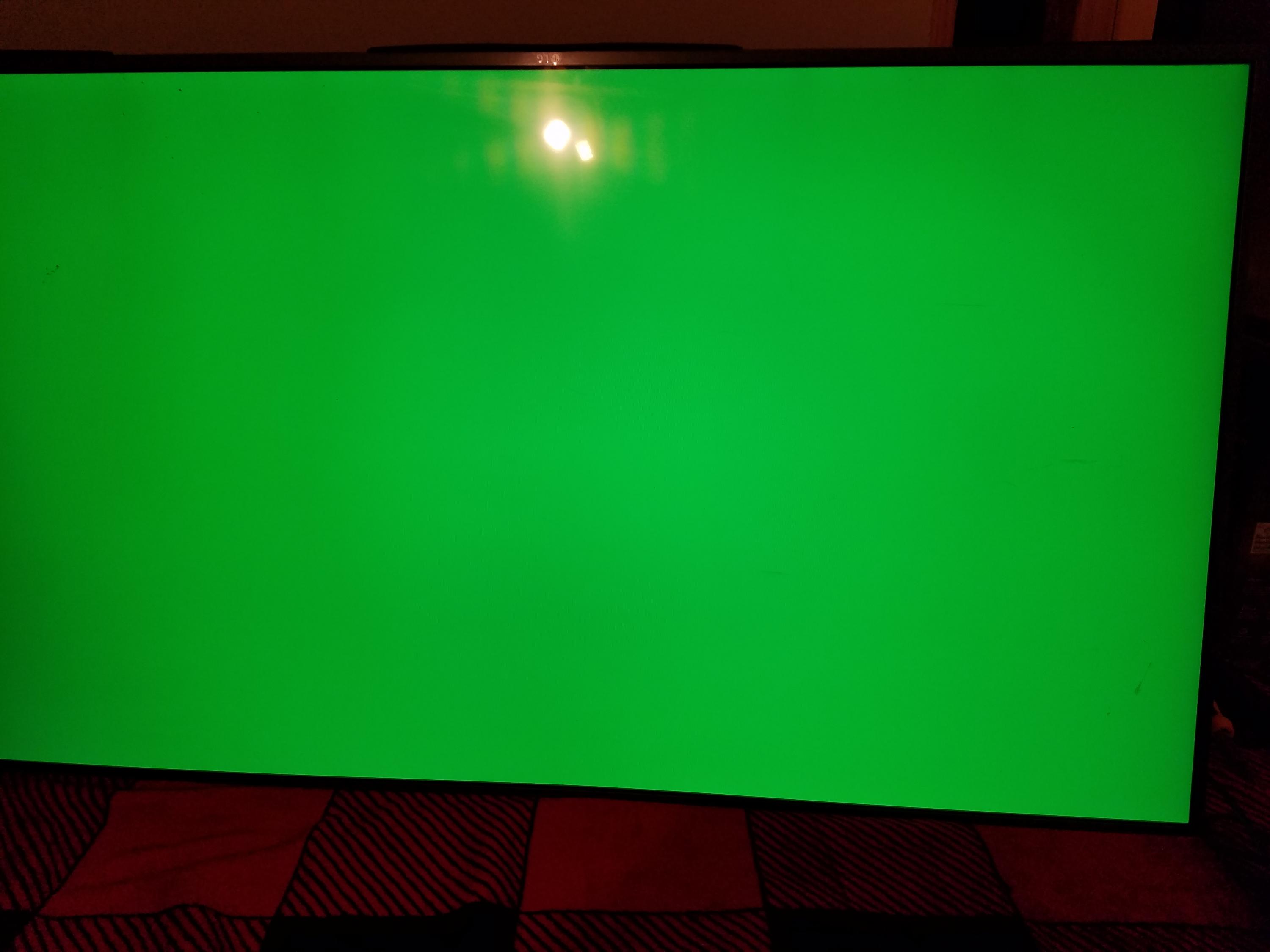

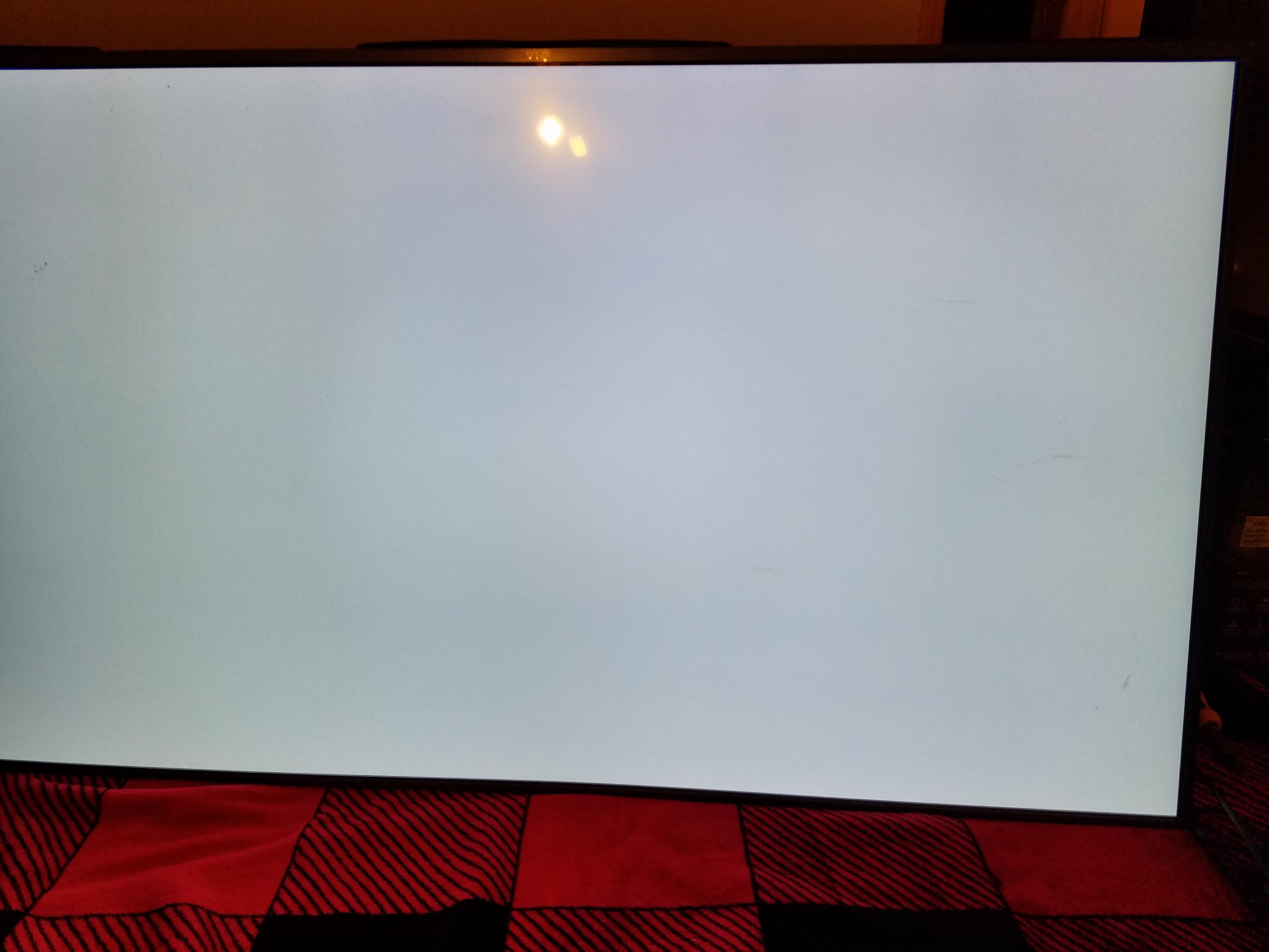

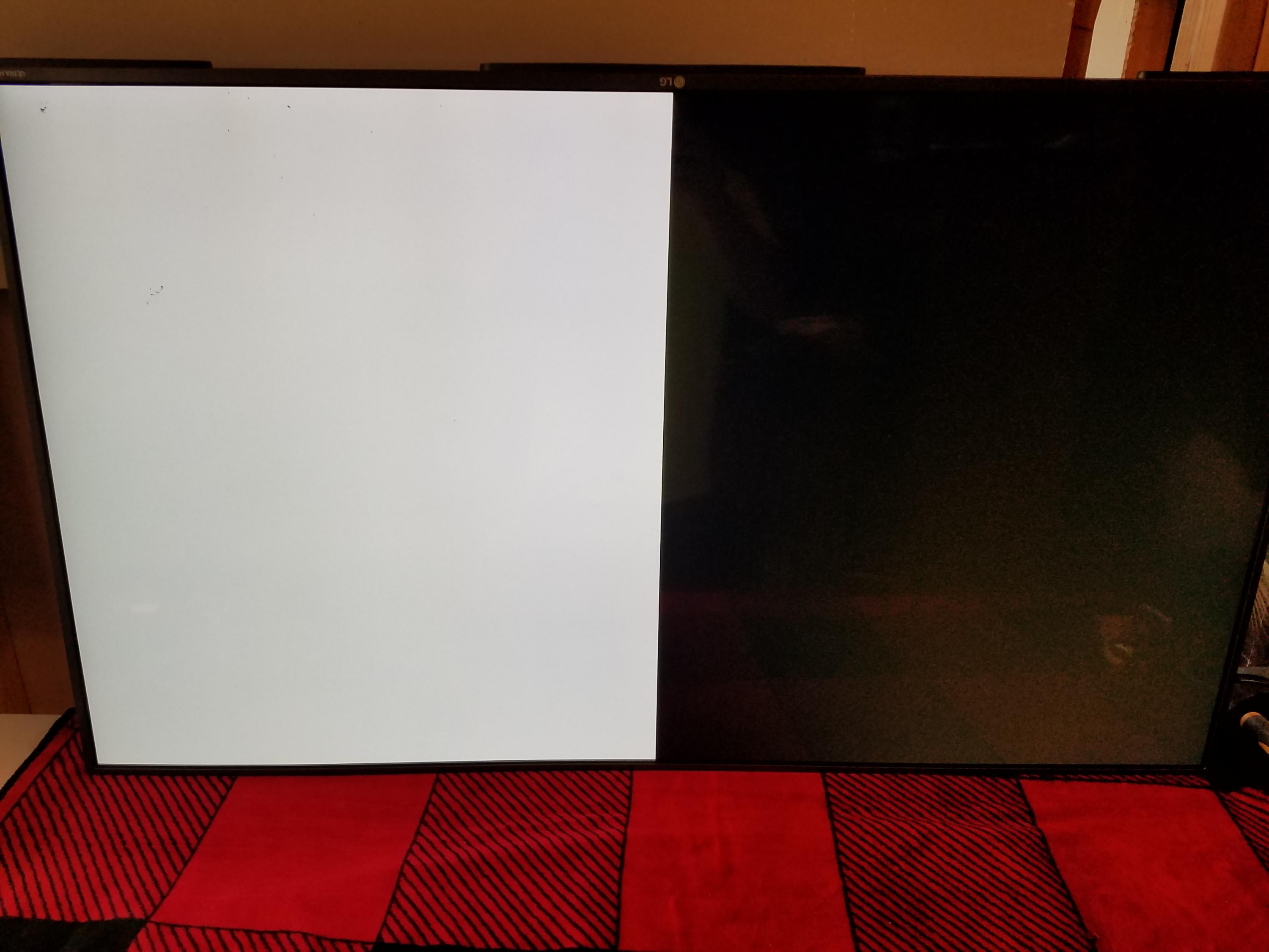

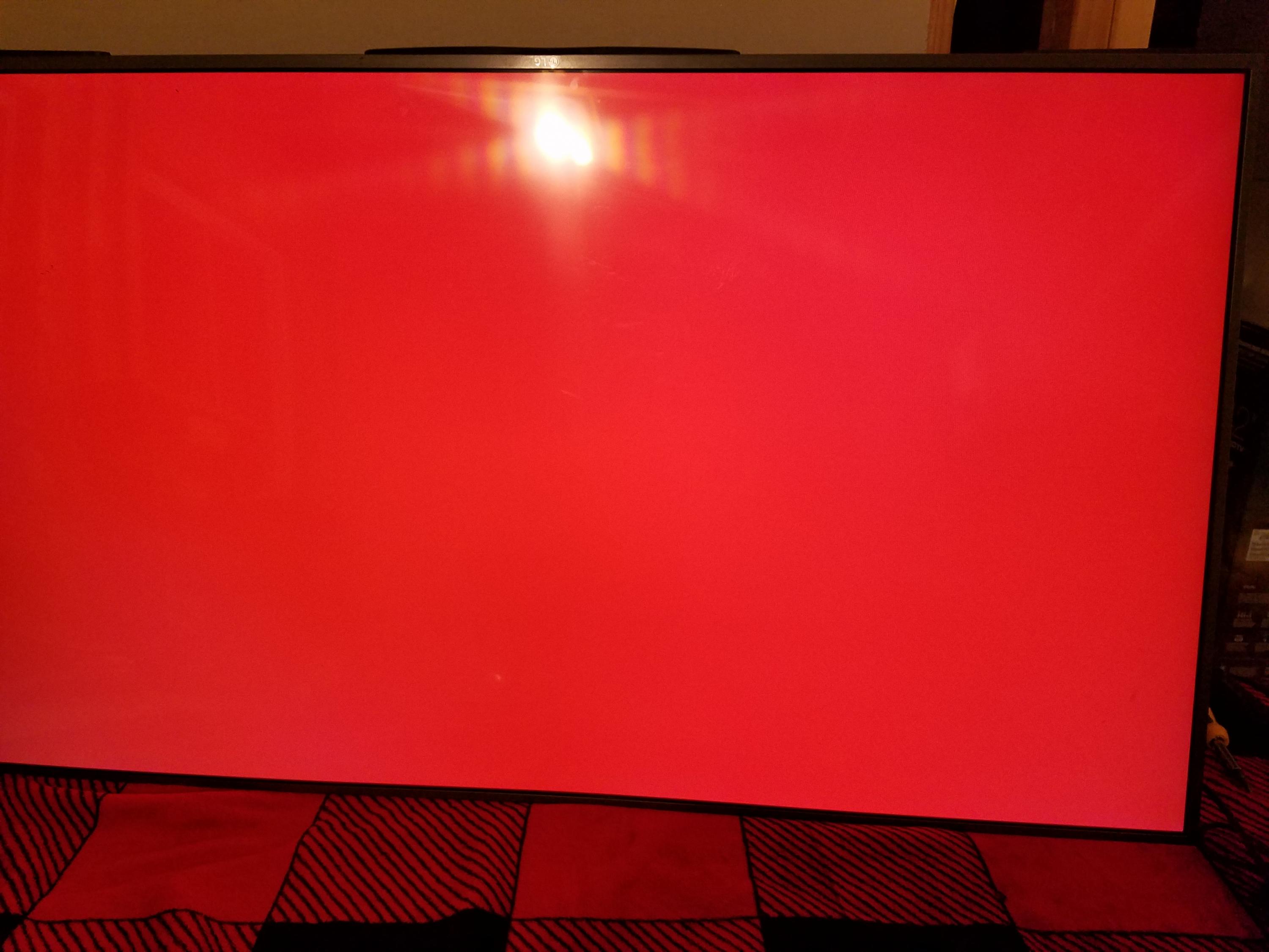

                                    Thanks for that reference! That is a mighty tough solder job! After I did that and turned it on it flashed: Black, White, Red, Green Blue.
                                    Does this mean bad Main Board?
                                    • dick_barton
                                      • Aug 2015
                                      • 6643
                                      • Wales
                                      It certainly looks like it must be a main board problem. The above test eliminates any panel or Tcon fault since the pictures look good.
