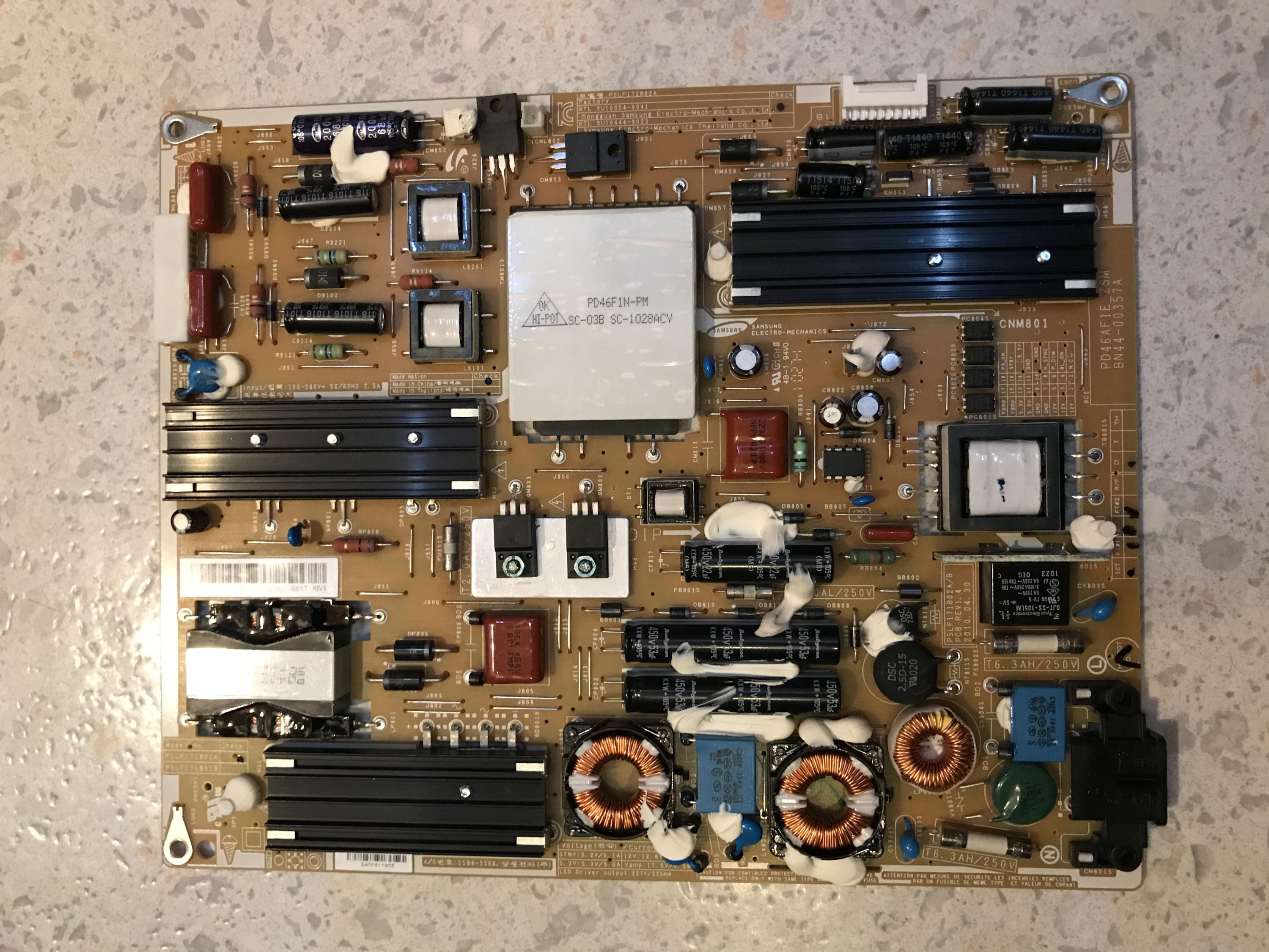

    I have a Samsung UE40C6000RWXXN. It makes the clicking sound and won't boot.
    It's 100% sure it's the powerboard because I have an almost identical other samsung tv and I switched the powerboard and it's working.
    But I can't find the issue on the faulty powerboard . It's a PD46AF1E_ZSM. I get 5.3v on my STB. If I connect it to the logic board the PS_ON voltage will switch between 0 and 3.3v. So I bridged
    STB to the PS_ON but I don't get 12v on the other outputs... I replaced some capacitors but I think they were still ok.
    I don't know where to look now. I have a multi meter and tried to check some fuses and they look ok on the board. Any tip where to look now?

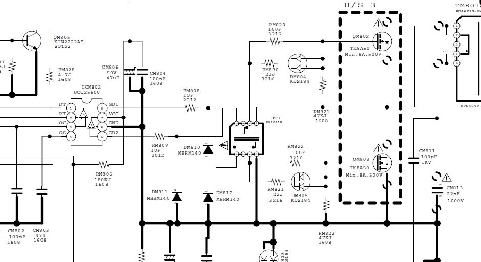

    Power supply schematic available at:-
    Do you hear the relay click in when you power up.
    What DC voltage is there with your meter probes connected to each of the two legs of CP804 when switched on.
    Have you checked FM801S, NT811S & NT812

      The relay clicks 1 time so that's working
      I get 388V on my CP804 and CP803
      FM801s should be fine... Is this a ceramic fuse diode?
      My NT811S and NT812 give an open circuit.
      NT812 changes from 20 omh to 10 omh when I heat it up.
      NT811S changes 2.8 ohm to 1.5 when I heat it up.
      (FYI: I didn't remove them from the circuit... But power was off)
      I think this is ok according to the datasheets?

        Re: Samsung UE40C6000RWXXN clicking power board issue
        The voltage across the capacitor looks fine.
        The relay clicking in is also good.
        The resistances of NT812 & NT811S are also good.
        You don't have the 12V but do you have any other voltages missing, eg Vamp_18V
        Can you visually inspect CM813 and measure its value if you can.
          I get 2.65V on my 5.3v outputs, and I get 0V on my Vamp and 12V outputs
          If I measure on CM813 just DC with my multi meter on both pins I get 0V. Visually I don't really see something. Or should I measure it differently?
            With the mainboard disconnected and the STB5.2 connected to Power On/Off via a 1K resistor, what voltages do you have on the pins of QM802 & QM803 using the negative leg of CP803 as your ground lead for your meter.
              Ok I get 0V on all the pins...
              But I made a rookie mistake and I fucked up my ceramic fuses in the beginning of the circuit... I accidentally touched both legs of the CP803 with my crocodile clamp. So I need to find new ones

                    It's best to replace like for like. If there was a short circuit on your supply then glass fuses can shatter and splatter glass everywhere. Ceramic fuses do not shatter when subjected to a short circuit.

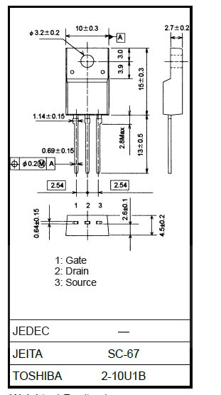

                        I suspect they are OK but would be interested in whether or not they are being driven by UCC25600 driver chip.
                        What you could do is check all the diodes using your meter in diode mode which are around that part of the circuit and also the resistors with your meter set to ohms while waiting for the replacement fuses.

                                    Back up and running 25 fuses to blow now. Something more I can investigate?

                                        With the mainboard disconnected and the STB5.2 connected to Power On/Off via a 1K resistor and using the negative leg of CP803 as your ground lead for your meter (but be careful not to short it again) you could very carefully measure the DC voltages on ICM802.
                                        I measured on the CM806 + leg and CP803 - leg. And I get 13V.
