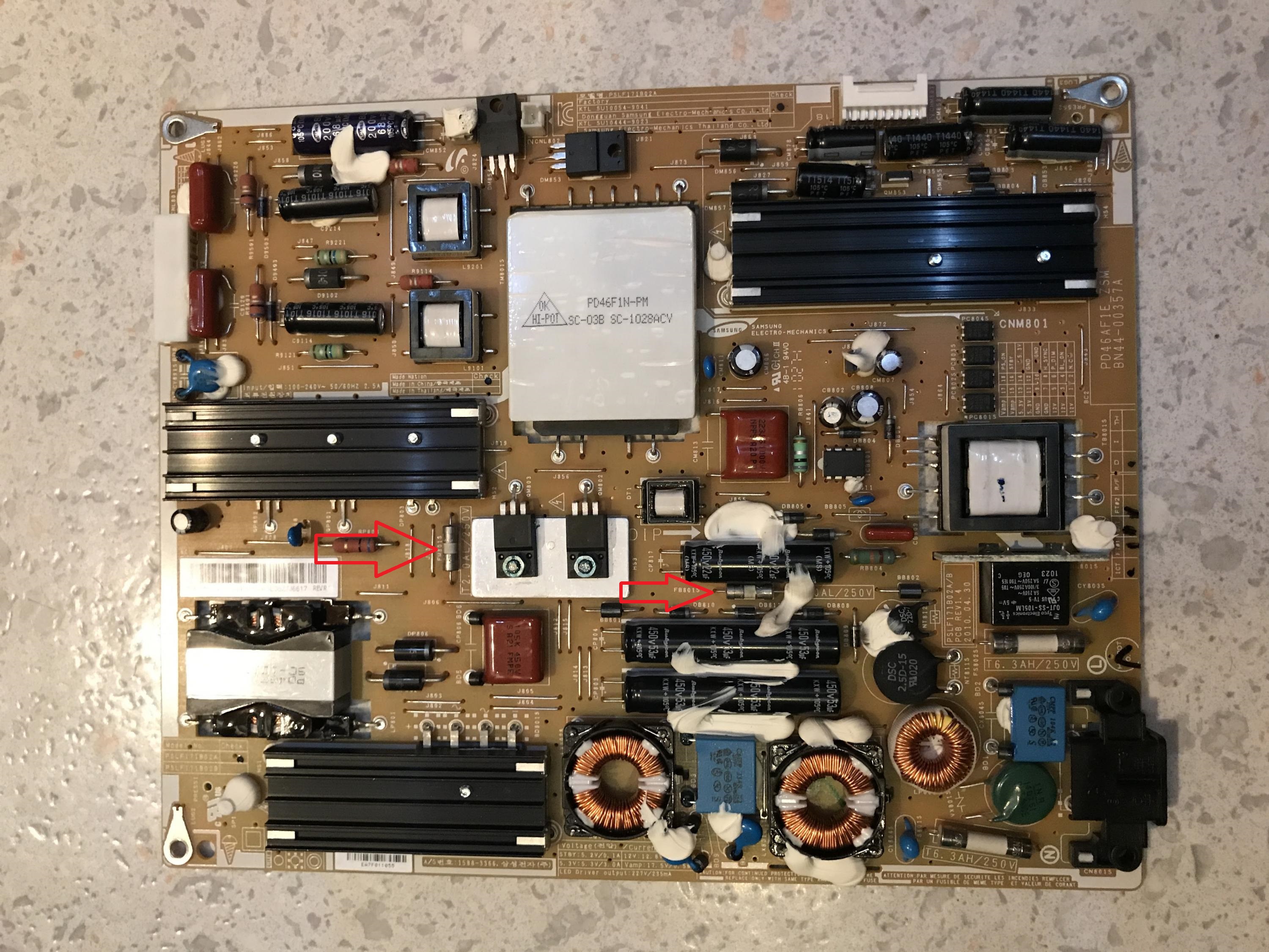

                              Have you checked the two smaller fuses for continuity.
                              Other than that I'm still none the wiser at this point other than maybe try a replacement UC25600 which are not expensive.

                                FM801S is this a diode fuse? Because one side is 1.2k ohm other side is OL.
                                Other fuse is Ok.

                                  I've put red arrows showing the two fuses Post #34. They are small metal capped ceramic fuses. You need the set switched off and then measure using your meter set to ohms across each of them in turn.

                                      Yes. The fuses are ok.
                                      FB801S 0.5 ohm
                                      FM801s 1.2k ohm in one direction and other direction open circuit... So it's acting like a diode as I already asked. It's not really saying something about that on the diagram or do I need to unsolder it.

                                        Fuses on that board should all show < 1 Ohms (depend on your probe leads resistance), if not then it is bad.
                                          Ok, I think we have a winner... I unsoldered it. Gives OL. So its 100% broken.
                                          Can I just bridge it for a quick test or is this not done?
