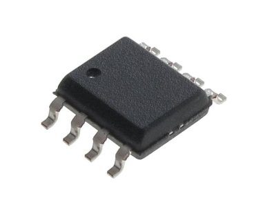

        Two possible courses of action.
        1. Try to do a firmware update via the USB port..
        If that fails...
        2. Try removing the firmware chip from one of the non-functional boards and place it on the good board(s).. The firmware chip will likely be an 8 pin chip that looks like the one pictured. It will either have an ATMEL or WINBOND stamp on it..
        SOME firmware chips are of the shallow, thin and surface mount variety.. If that's what you have, I would not recommend trying to de-solder/solder it by hand..

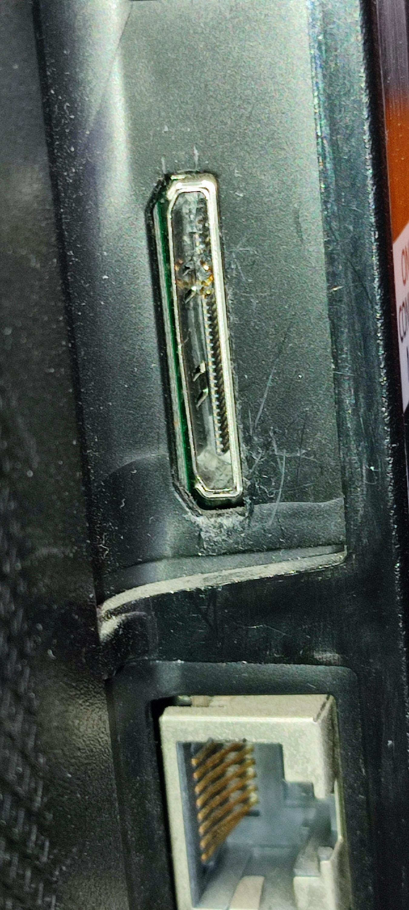

                                    Hi, someone who knows what is the name/model for the mini connect box port please, mine have broken pins .
