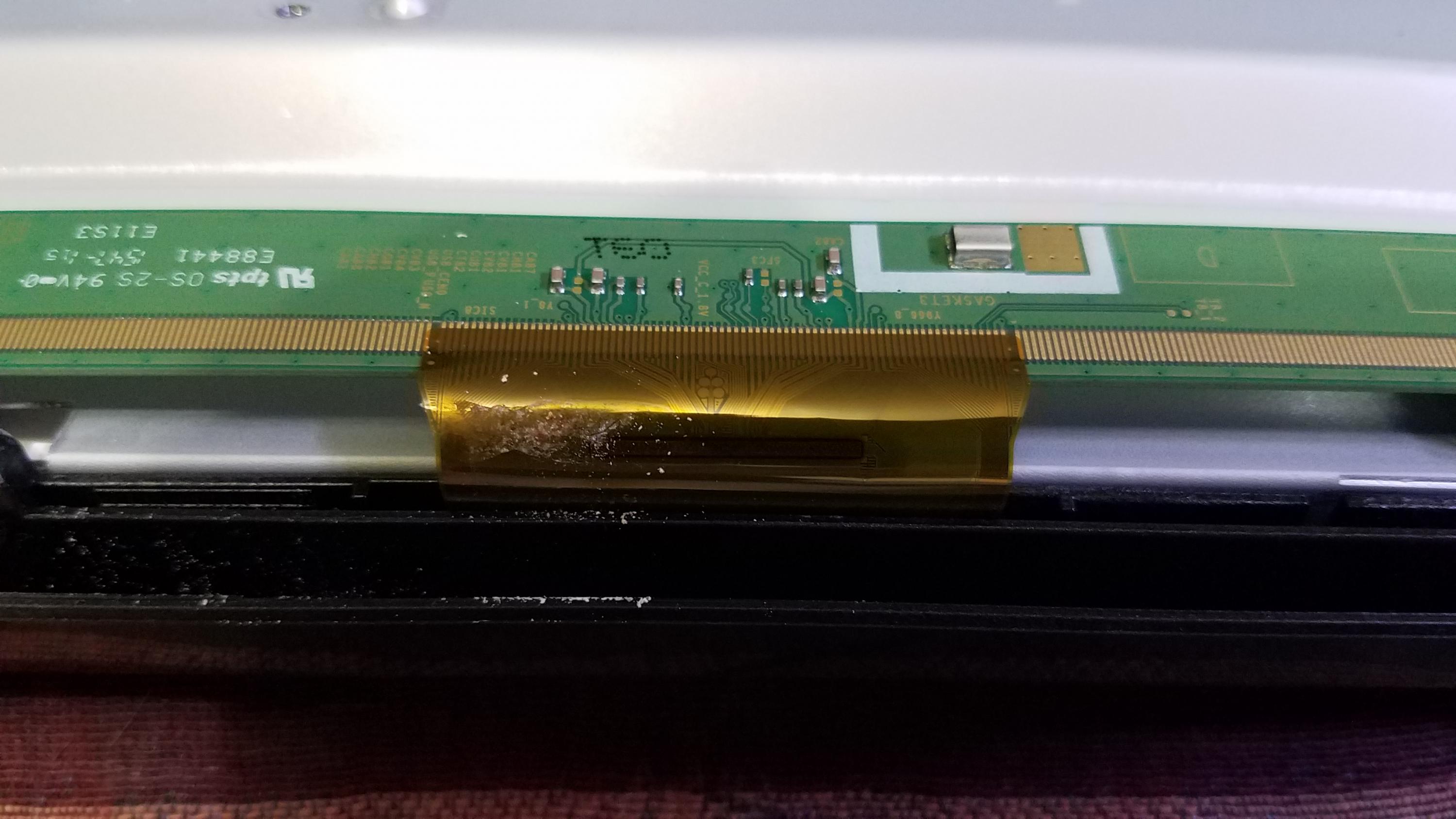

    I have a Samsung UN55JU6700F that has no picture or sound. When plugged in it is clear that power is supplied (screen glows, optical audio light on, and power light indicator responds to remote control). It appears that the backlight powers up as well (see second set of pics)
    I tried to use a flashlight but could not see anything on screen. I am using the S4 for the remote since I do not have a remote so it may make things difficult.
    When I turn it on, there is an intermittent, seemingly random clicking noise. Sorry for the reference, but it sounds like "kek."

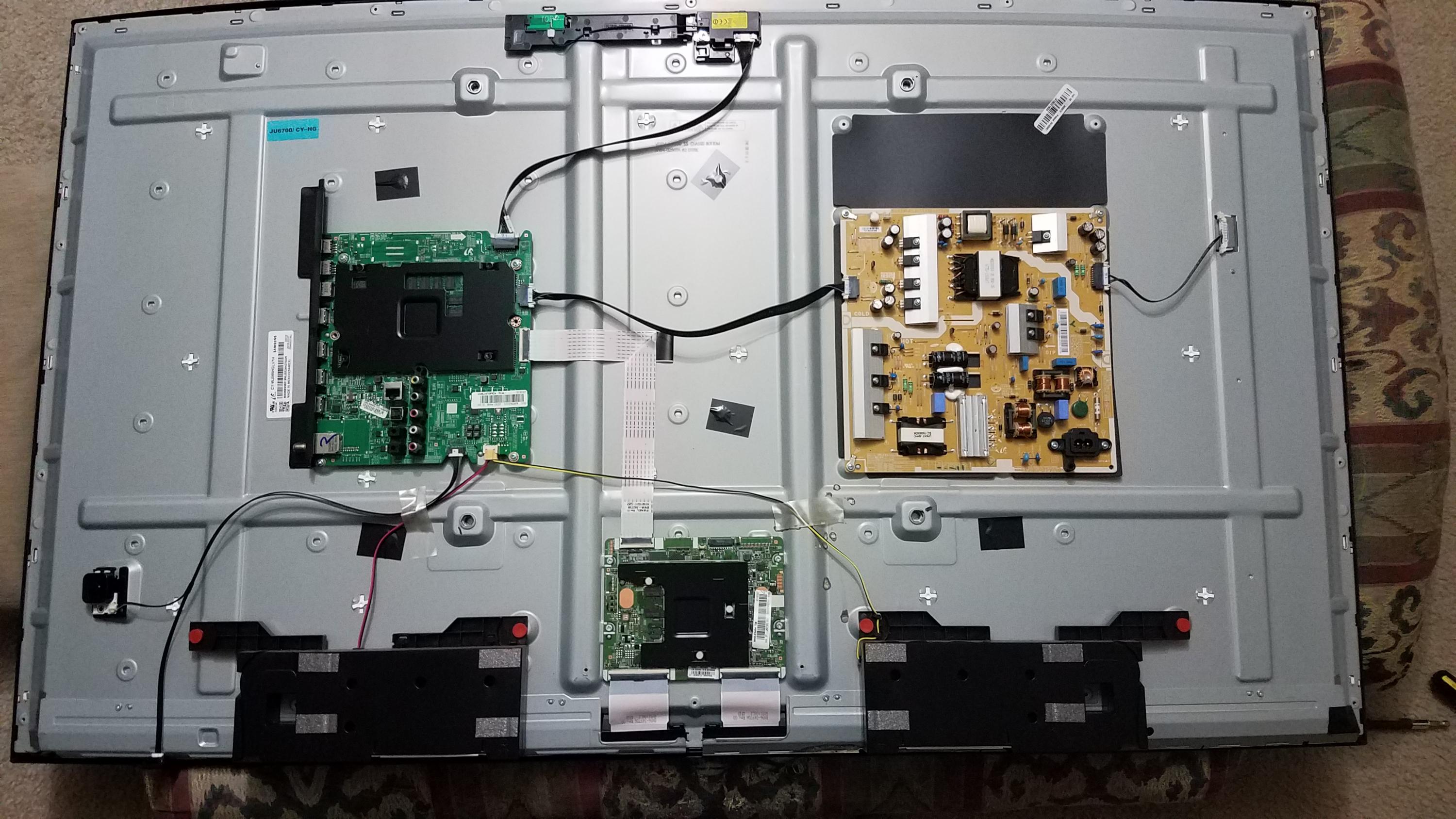

    I opened the back and didn't see any issues with capacitors. I did notice a little bit of dried liquid but it didn't seem to have made contact with anything but one connector (I'll attach a picture from my phone in just a few because I don't know what these are called). http://imgur.com/qFUNv3Y
    Edit: I figured out that if I pressed the volume (up or down) the clicking (kek) noise occurs with each click and is coming from the area where the liquid spots were.

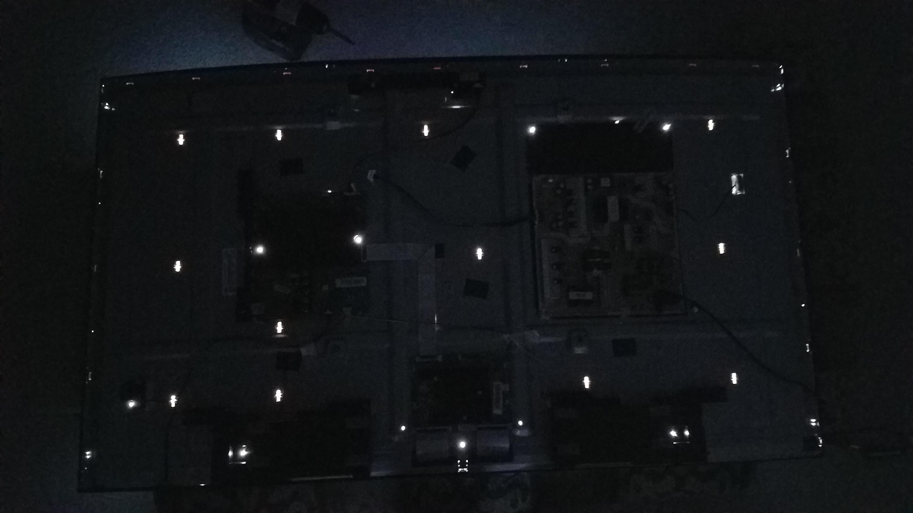

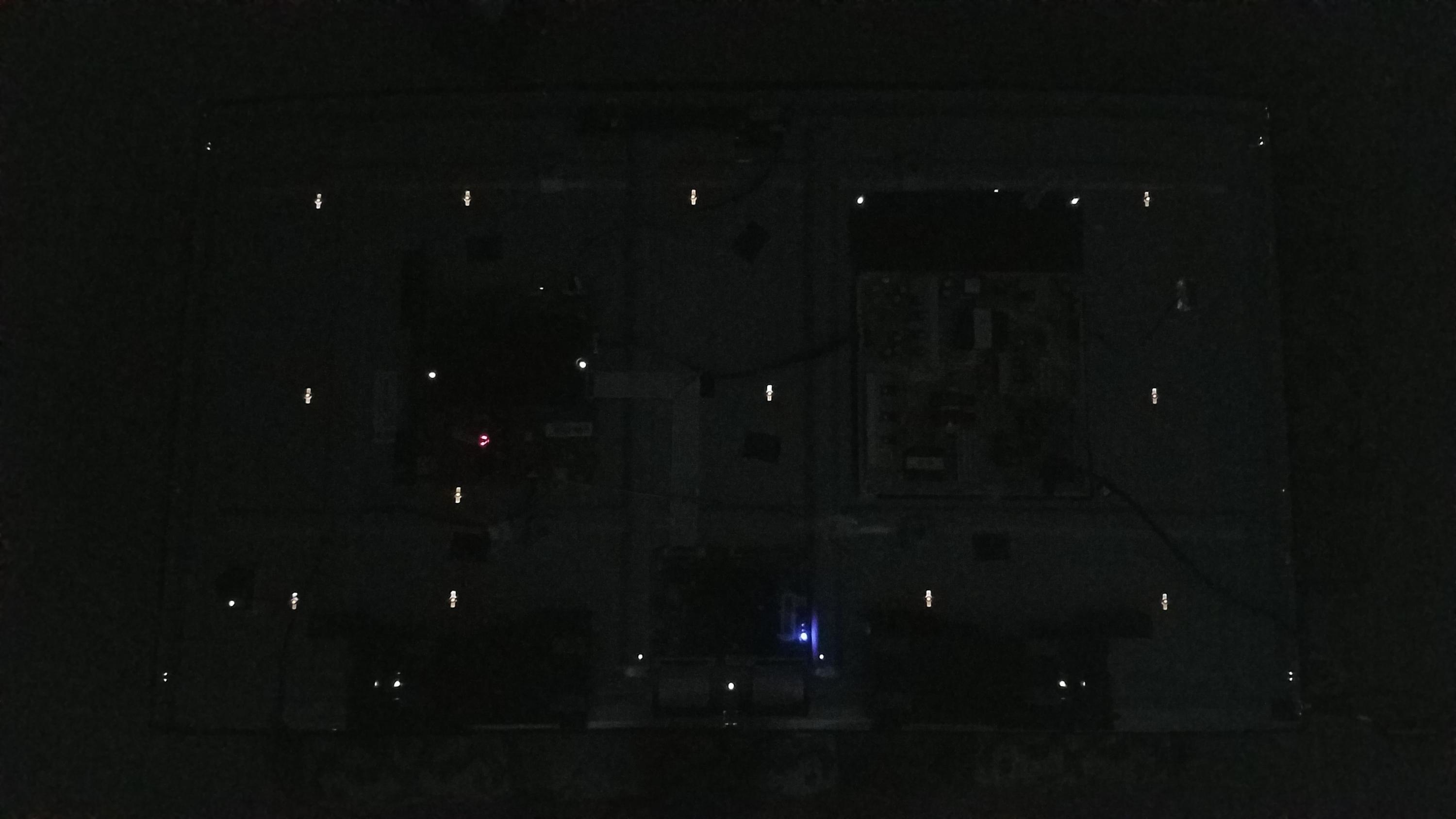

    Here are pics of backlight with main board connected and disconnected
    Power board connected http://imgur.com/0xn55ZV
    Power board disconnected http://imgur.com/B4Bu3WX

      First two pics are the backlight
      Pic 1 main board connected to power board
      Pic2 main board disconnected from power board
      Pic 3 is with the panel off
      Pic4 is where i noticed liquid marks

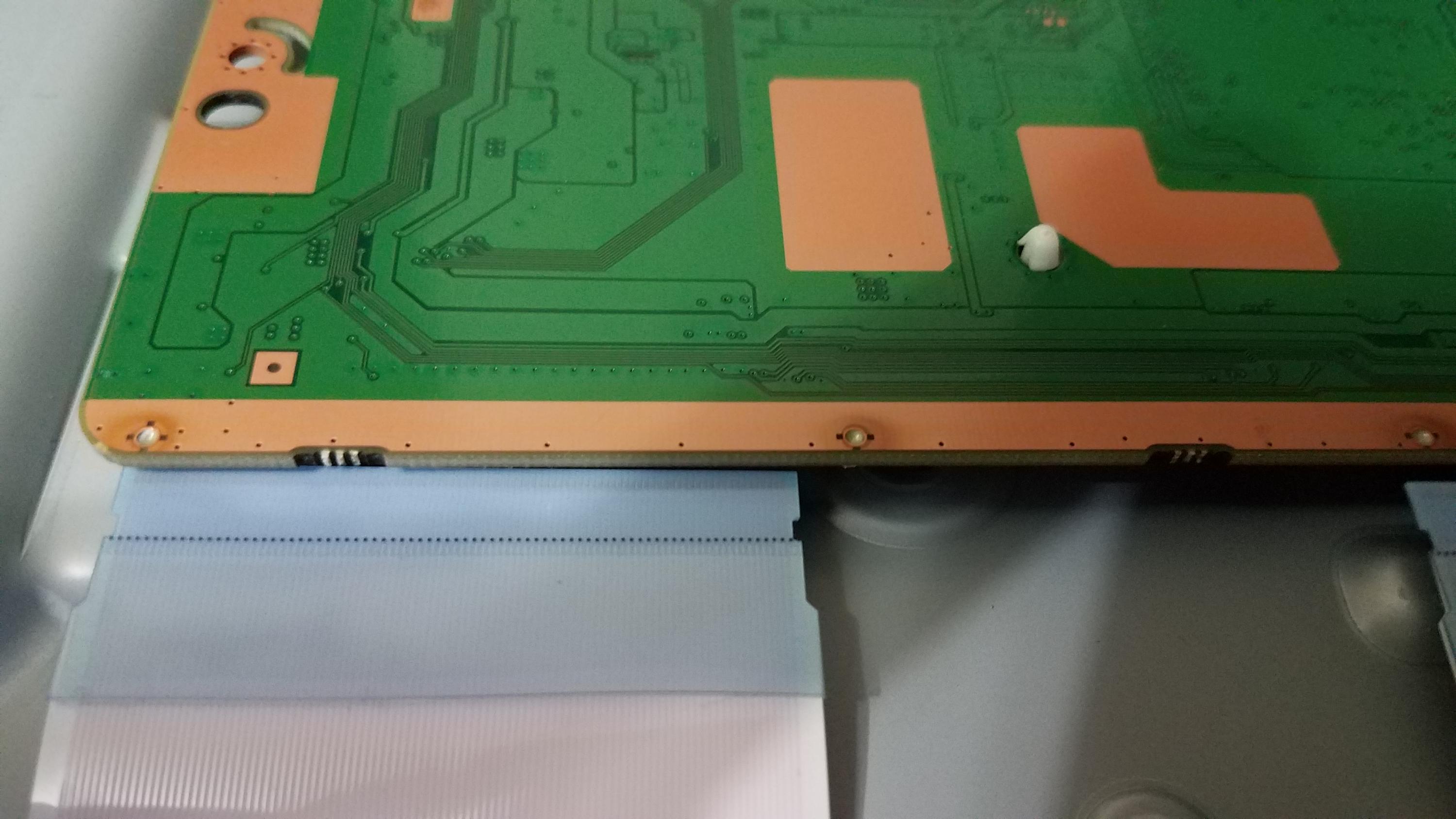

        I would be taking a close look at that ribbon cable for damage especially at the panel end of cable for corrosion and bad traces
        • pogosa
          • Jun 2017
          • 8
          Re: Samsung UN55JU6700F No picture, no sound
          I was able to wipe all of that dried liquid off the ribbon cable and didn't see any damage. The ribbon connects in under the front frame, not sure how to access that.
          Edit: I had also disconnected the tcon board from the main board and the dimmed (or absent) backlight issue remained. Only disconnecting main board from power did the back light pop back on.

            Looks like you have backlights. Try disconnecting one ribbon cable to panel at a time and see what you get on screen.

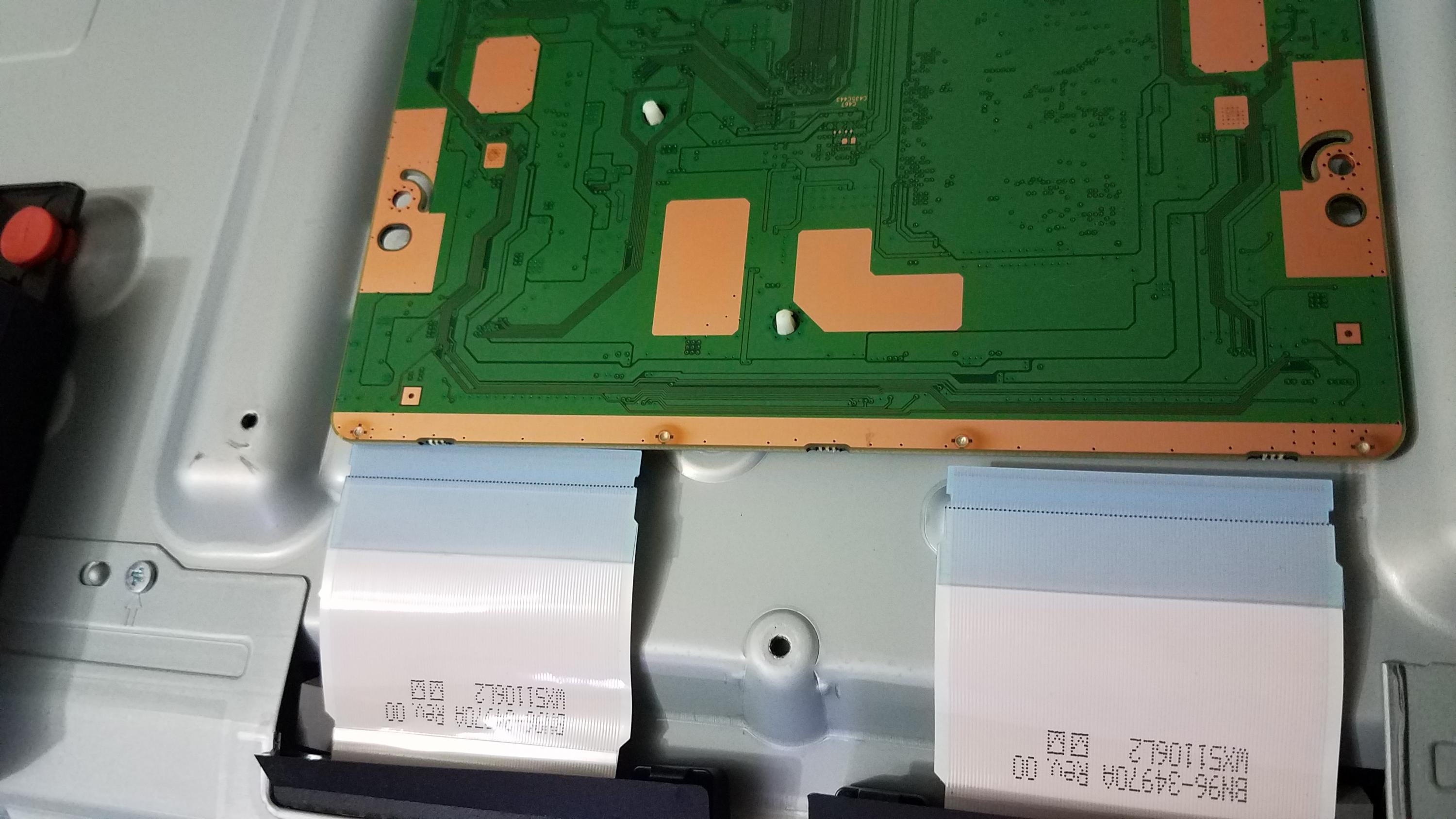

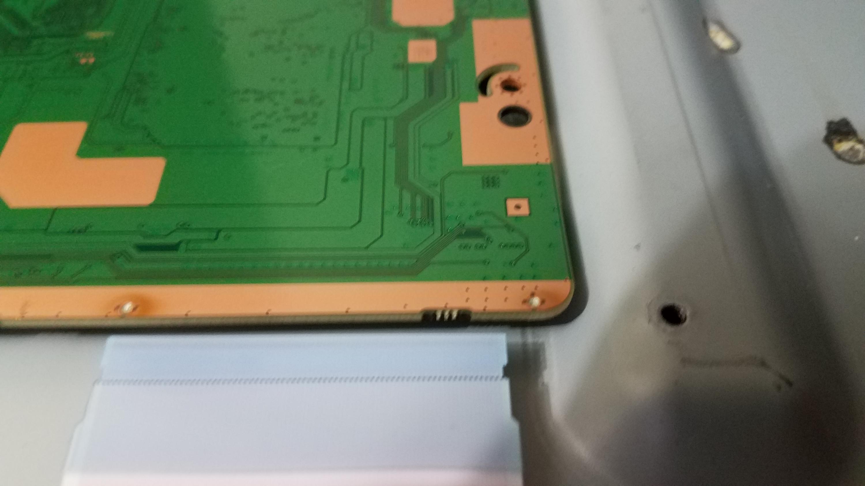

                I pulled the tcon board and noticed discoloration in the back side.
                • Nick's Tvs
                  • Jan 2014
                  • 621
                  That corrosion looks like you have a bad panel. Disconnecting half the screen unfortunately won't work on these newer models.
                          Which corrosion, the stuff on the back or the Tcon board itself?
                              Have you actually checked to see if the TCON is getting any voltage?
