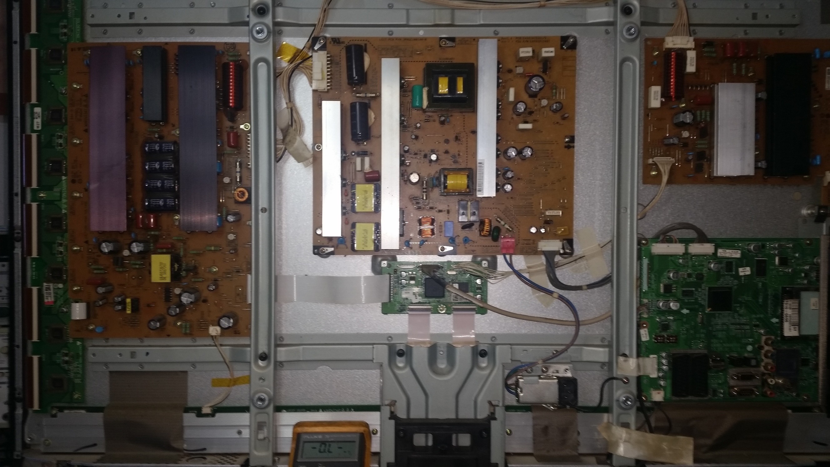

    Hey guys I got a Plasma TV on my bench - first one I have ever looked at
    I've done some googling and basic faulty finding already
    When powered up the relays on the PSU go click-click-click every 5-10 seconds. I didn't time it but it's a regular repeating cycle like clockwork.
    Also the owner says if you leave it plugged in, the TV will sometimes power up on it's own and then run OK for maybe an hour or more, then suddenly shut down again. I've not seen this myself but don't see why it would not be honest info.
    I found this video https://www.youtube.com/watch?v=iLXfYZ6-iwQ and the fault seems to be the same symptoms and this guy also mentions the TV will sometimes power up.
    As per the video I checked the fuses, 22R resistors and diode (out of circuit).
    Now something is really puzzling me about this guy in his video. At around 3min 15sec he is testing the diode and says it is faulty because it has a forward voltage drop of 0.204 when a diode should have 0.4V-0.7V he says.
    But the diode is a SB140A and even before I looked for the datasheet I knew this is going to be a Schottky Barrier Rectifier http://pdf1.alldatasheet.com/datashe...AY/SB140A.html and I always found these had a low forward voltage drop (even the datasheet says it has). Mine is reading about 0.16V on diode test range. So why is this guy saying that is faulty?
    Anyway, I think the diode and resistors are OK, can't really test the 3BR1565 easily http://www.datasheet-pdf.info/entry/3BR1565 but would expect that would fail rather than sometimes work.
    I found a couple of helpful threads on here too.
    https://www.badcaps.net/forum/showthread.php?t=37974
    I unplugged the X-Sus and Y-Sus and the power supply still click-click-clicks
    Either with or without the X-Sus/Y-Sus I don't get any output on VS VA M5V even momentarily unless it is too fast for my Fluke 79 to see.
    Disconnect the main board and it click-click-clicks once but does not do it again. Only rail with any output is STBY which is steady 5V both with and without main board attached.
    No shorts on any supply rails on either XSus YSus or Mainboard connectors with boards attached.
    Anyway sometimes it will work and shorted semiconductors don't tend to be intermittent.
    But does disconnecting main board - and the clicking stops after first cycle - prove anything? Is there some pin on main board connector I need to apply a voltage without main board attached to force the PSU to run?
    Or possibly I am down to the brute force method of pulling and testing all the caps on the PSU?
    All look nice and clean and good visibly, but del3165 on other thread said that fixed his. Unfortunately he didn't say which caps and there are quite a few. I have ESR and Cap meter.
    Any ideas to narrow this down a bit further?

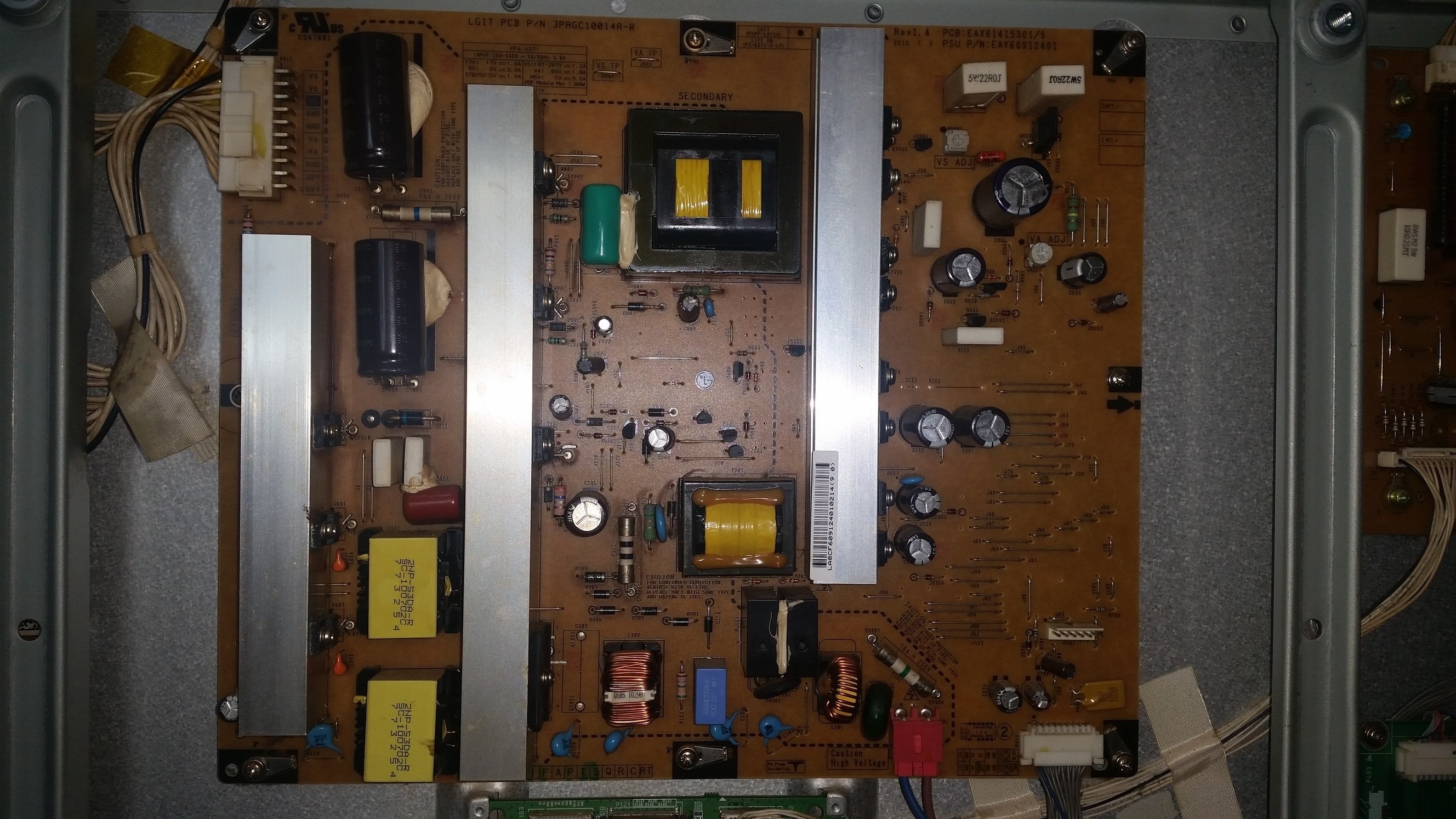

      Does anyone have a schematic for this PSU board?
      I got the training manual from elektrotanya and that is of some help
      I connected a link and a 100R resistor as described in the training manual to power up the 17V and 5V rails. They don't power up. It just goes click-click-click same as with main board applied
      I didn't connect the 100W light bulb load to VS yet as I didn't connect the second resistor to power up that section of the PSU.
      The training manual says to use 2x 100W light bulb in series as a dummy load. I can only assume that is for 110V bulbs, not the 220V ones i have?

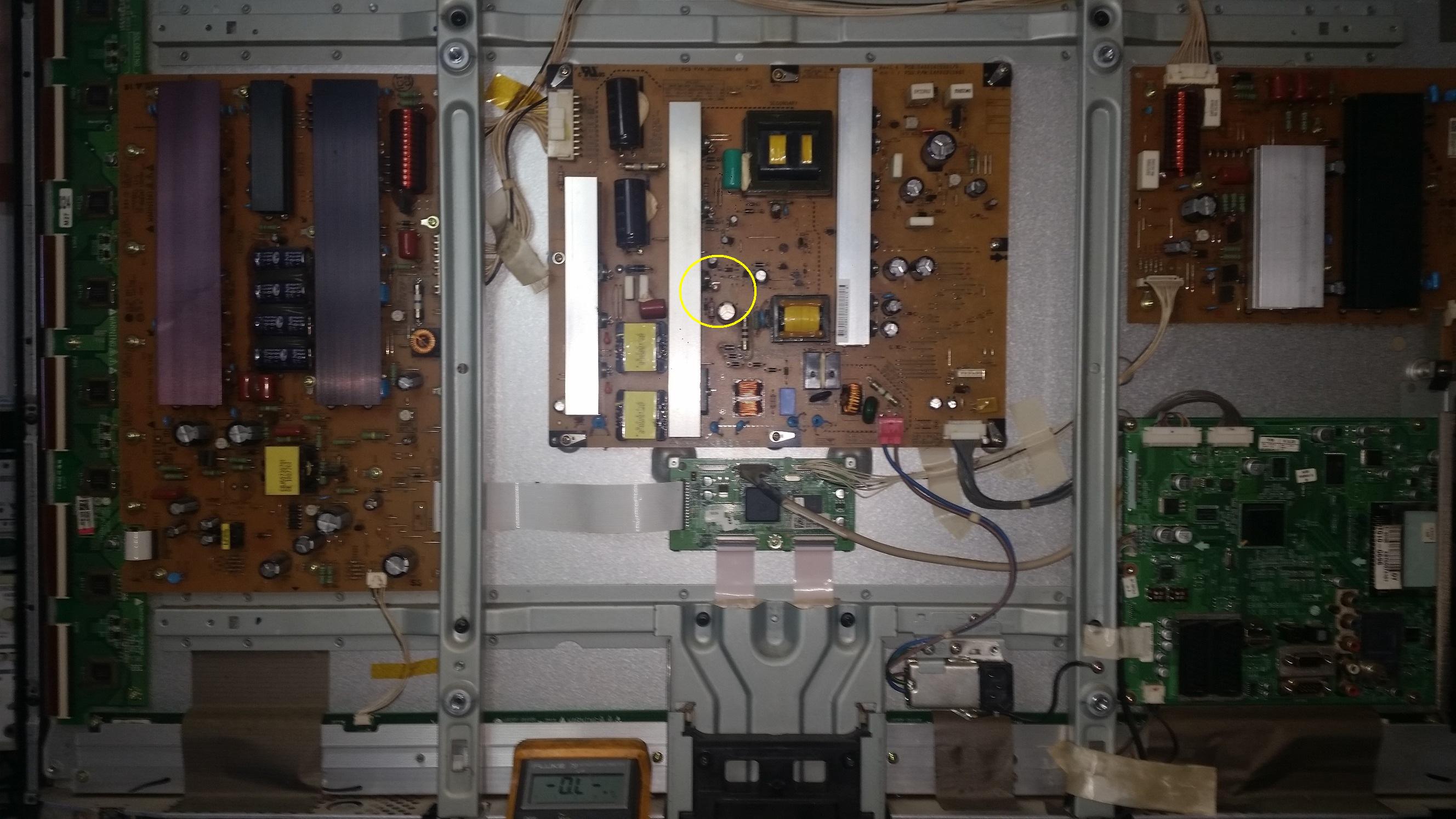

      I pulled all the electrolytics and tested for ESR and Capacitance. All are good. I changed the top right capacitor C901 (150uF 250V) anyway.
      According to the training manual it is the microprocessor on main board that triggers the relays to turn on but something is still doing that with the main board disconnected - I am thinking that would be IC701 which actually drives the relays. I don't seem to find any datasheet about this chip other than this http://www.audiolabga.com/data_html/F4316MSF17.html
      When I power up I get a quick flash on the light bulb limiter, when the relays click the first time my light bulb limiter flashes bright then goes off. On the second click it flashes very dim after that it stays off. I can see boost voltage 390V so looks like the PFC kicks in on the first click and charges the main electrolytics.
      Holding my scope probe near the PFC inductors and main SMPS transformer primary I can see the PSU does drive the primary for a second or so on each click.
      My only guess now is IC701 turns on the PSU, doesn't like something it sees, and turns it off again but without schematics/info I'm a bit stumped with this one at the moment
      Can anyone help?

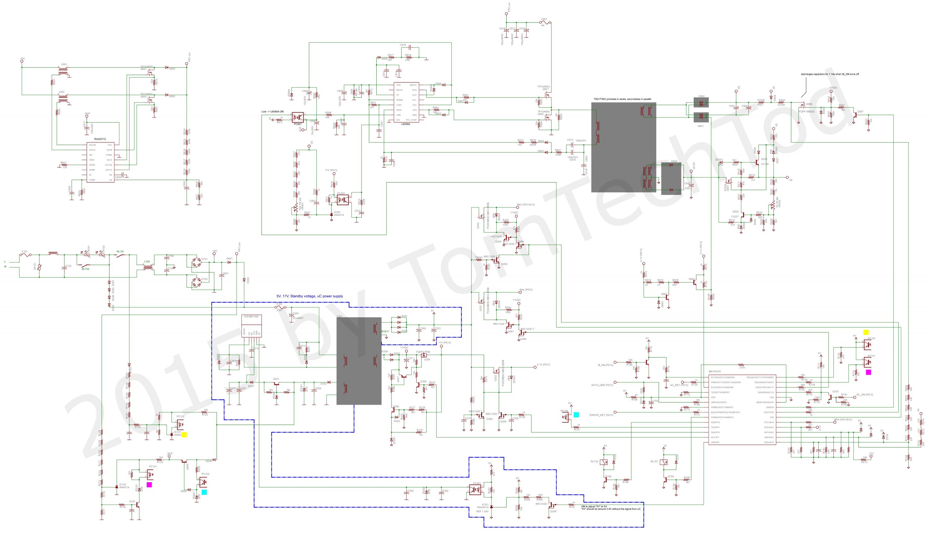

              Seem to be a bad ic (ice3br1065jf) possibly a diode and (2) 22 ohm 5 watt resistors, thats whats in the kit so I would check those parts.
              This schematic might be close

                Re: LG 42PJ350 Click Click Clicking
                I'm afraid the sensationalized schematics from page 25 on are all you can expect to get these days.

                    I just don't get it - these sensationalised schematics lol don't give you the info you need to fix the PSU easily, but the circuit description goes into great detail how it operates. Really what is the point?
                    @R J
                    I will look at that schematic see if it is anything like
                    From investigating this fault with the relays forced on yesterday I have discovered a few things more. With relays on my 105W light bulb limiter now flashes bright every few seconds. This is with no load.
                    There are two separate SMPS controllers on this board plus the PFC which has it's own controller R2A20117
                    The ICE3BR1065JF controls the smaller standby SMPS. As well as STBY 5V this transformer also generates the M5V voltage rail and 17V rail.
                    When you connect a resistor to RLON as described in the service manual it actually supplies M5V from the same rail as STBY, it turns a serially connected FET on to feed 5V from STBY to M5V.
                    It does the same for 17V actually, the 17V ail is present even in standby but it has no load due to a serial FET being turned off.
                    In my case this SMPS is working and generating 5V and 17V so the ICE3BR1065JF is working along with the diode
                    Actually when my light bulb flashes bright the 17V rail drops slightly, as the PCF boost voltage also drops 20-30V
                    The larger SMPS is controlled by a L6599AD http://pdf1.alldatasheet.com/datashe...S/L6599AD.html with associated high and low side power FETs and this one generates the 200V-ish VS and 60V-ish VA voltage rails, This is the one that is not working
                    The 2x 22R 5W resistors are some party of the VS supply secondary circuit, not directly related to ice3br1065jf at all. They check OK on my board
                    Even when the bulb flashes bright I see no voltage on VS or VA even on my scope. Also I see nothing (or very tiny) high frequency pulses direct on VS secondary before the rectifier diode
                    Holding my scope probe on 50mV range near the primary of the VA/VS SMPS transformer I thought I see a burst of high frequency pulses when the light flashes but I see the same near the PCF inductors and 5V/17V SMPS transformer (which is running all the time)
                    This is acting like I have a short on VA or VS but I don't - unless a rectifier or Cap is breaking down under voltage. Something draws a lot of power at least 100W every few seconds - could be the PCF as the main caps discharge somewhat with light bulb flash, but even so then something in the VA/VS supply is loading the PCF boost voltage..

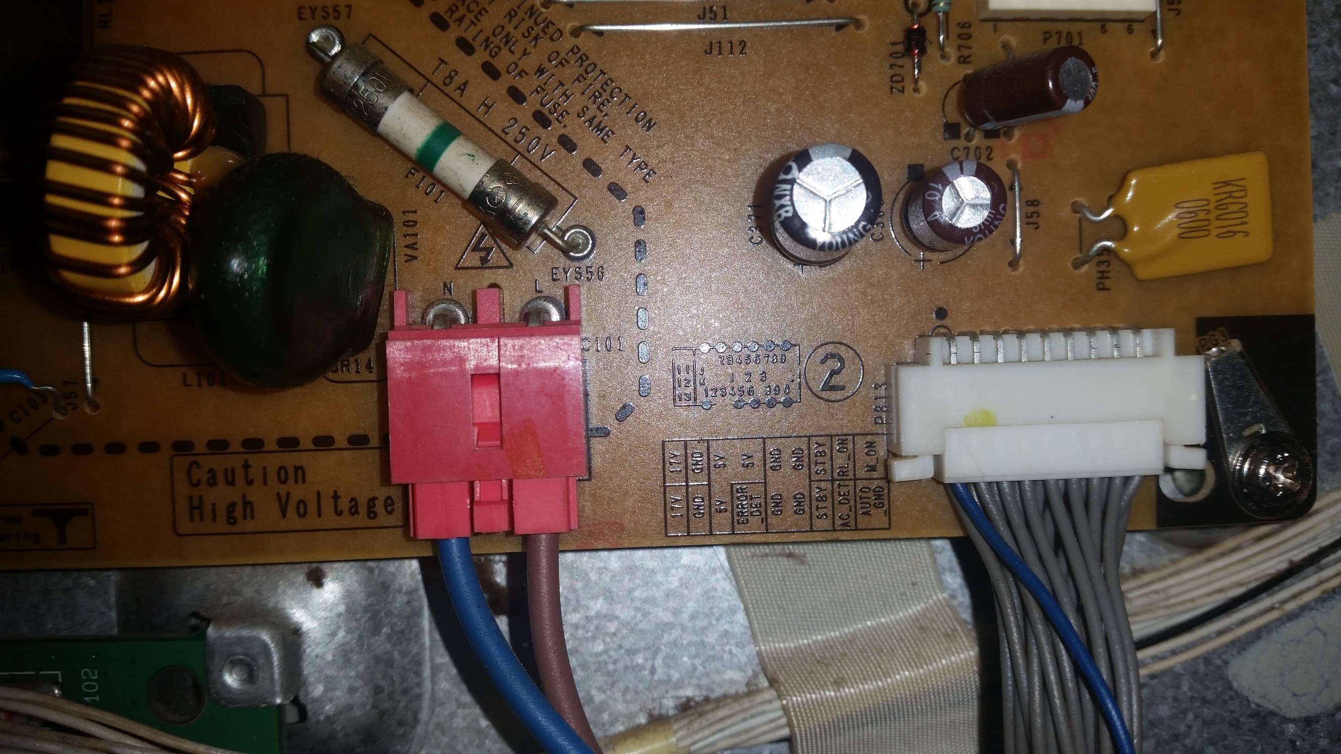

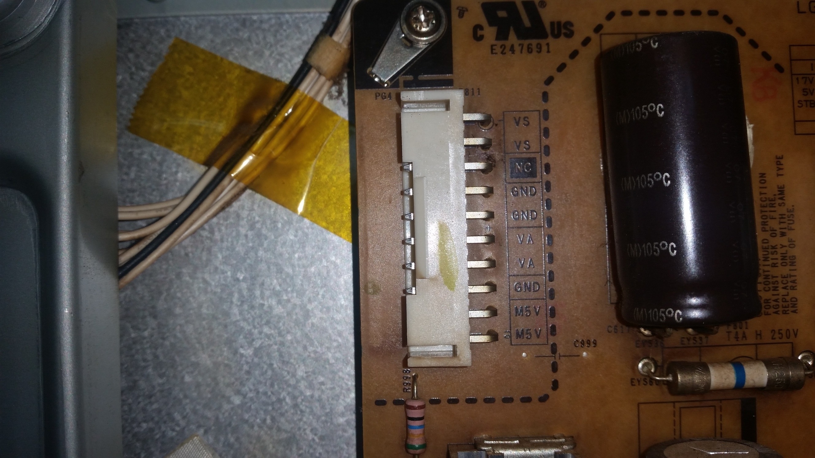

                            Yes the manual says you need to add two 100R resistors and a ground link to plug P301 with main board and X/Y sus boards disconnected
                            A) Ground the Auto Gnd Line (Pin 18) will allow the supply to be powered up one section at a time.
                            (B) Add a 100 Ω ¼ watt resistor from 5V Standby to RL_ON and the 17V and 5V Run Lines on P813 will become active. Also AC-Det and Error_Det will go high.
                            (C) Add a 100Ω ¼ watt resistor from any 5V line to M_ON (Monitor On) to make the M5V, VS and VA lines operational.
                            I did that but get no VA / VS
