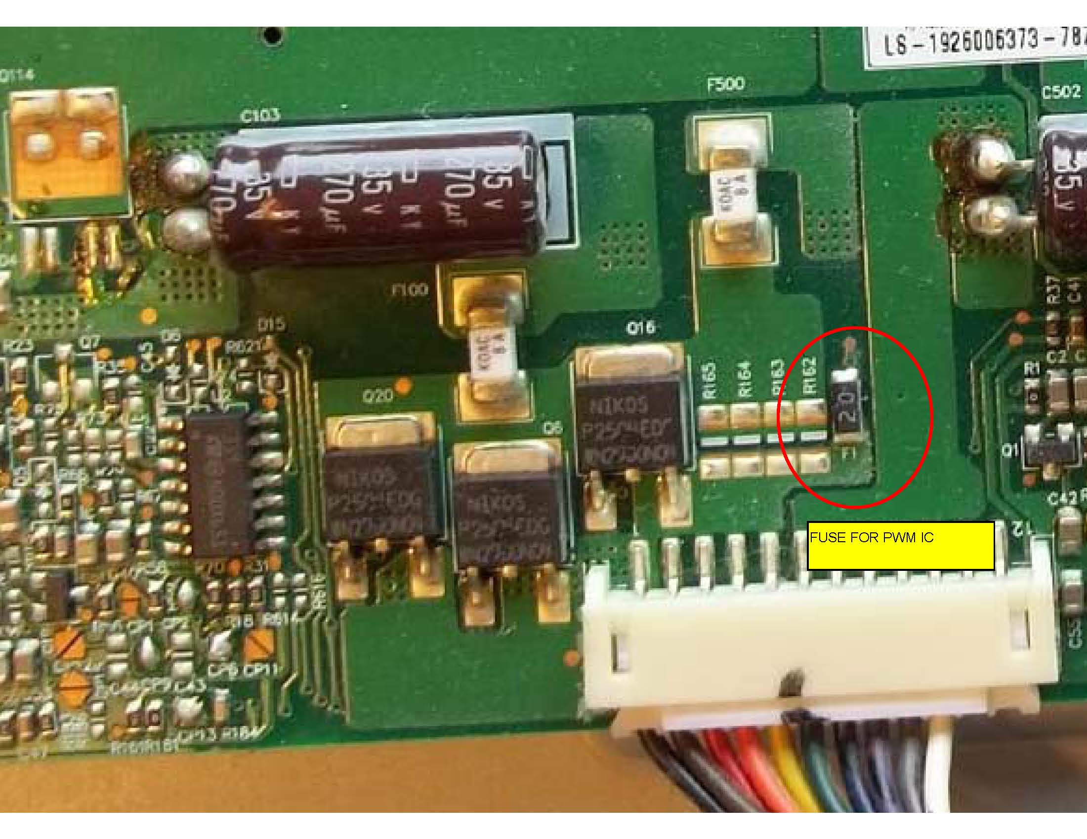

        Re: Toshiba LCD 26AV502R - no picture but I do have sound
        Check very small black F1 fuse (see picture for example to see what the fuse look like) with '20' printed on top, it is below the printed 'CMO' silkscreen. More likely that fuse had failed, very common on CMO inverter board., It should have 24VDC at both ends with ref. to the chassis GND.
          Fuse F2 shows 24.22 Volts on either side. Fuse F1 shows 0.003 V.
          So is this the culprit?
            Yep. There is print right next to it beside F2, it shows current and Voltage rating of that fuse. I believe it is 1A fuse.
            This looks to be your board:
            CMO 27-D023043 (VIT70063.50)
            http://www.shopjimmy.com/cmo-vit7006...t-inverter.htm
            BTW, "Fuse F1 shows 0.003 V." Do you mean one side shows 24V and another side shows 0V?
                  diif,
                  When I tested F2, the black lead was on earth and I received 24.22 V on both sides of the fuse. Is this normal?
                  budm,
                  Similar to my response to diif, I received 0.003V on both sides of the fuse when the black lead was on earth. Apologies for not being clear.
                  So F2 is good? F1 is shot? What next?
                      F2 is good with continuity. F1 is not. I did the diode test on F1, without power, and showed that it was not open.
                      So I believe F1 is the culprit. What are my options?
                          Maybe I have my terminology mixed up. Sorry.
                          When I tested F1 with the black lead on ground, there was hardly any voltage on either side (0.003 VDC). This was with the TV powered on.
                          With the TV powered off, I put it in continuity, and there wasn't a continuity beep coming from the meter like F2. I think we can rule out F2 at this point.
                          Now, the diode test for F1 - pardon but I'm not that familiar with how the diode test works (like the results), so I noticed when I put both leads on F1 in diode test mode without the power on, I saw the VDC level increase to about 1.63 V.
                          Did I do something wrong?
                          Thanks.
                                  All,
                                  There's only one side of continuity between F2 and F1.
                                  Here's what I did for measurements. I called them left and right.
                                  Left Side F2 to Right Side F1: 0.3 Ohms
                                  Right Side F2 to Right Side F1: 0.3 Ohms
                                  Then,
                                  Left Side F2 to Left Side F1: 62.3 kOhms
                                  Right Side F2 to Left Side F1: 62.6 kOhms
                                  So, I believe F1 is bad, but does the "left" side of F1, being high resistance, indicate a problem in the trace?
                                  Thanks!
                                  VV5
                                    From your inverter picture you are sure you are getting voltage on top end of F2 white fuse and no voltage on top end of F1
                                    • VictorVictor5
                                      • Jun 2017
                                      • 23
                                      • US
                                      #38
                                      Here's what I did.
                                      Black lead on ground, red lead checking fuses.
                                      Results are as follows:
                                      F2 Fuse, left side = 24.22 VDC
                                      F2 Fuse, right side = 24.22 VDC
                                      F1 Fuse, left side = 0.08 VDC
                                      F1 Fuse, right side = 24.22 VDC
                                      Sorry of the "left" and "right" are confusing. Just makes it easier in my head.

                                        OK, now you telling us you do HAVE 24VDC on one end of F1 fuse? I thought you told us you do not have any Voltage (0.003v on either end of F1 fuse at all. Just change that F1 fuse and finish with the repair, the thread is getting too long for a simple fuse.
                                        • VictorVictor5
                                          • Jun 2017
                                          • 23
                                          • US
                                          #40
                                          budm,
                                          Apologies - that fuse is really small so I had to use some force on the probe to get a reading. But I can confirm that I get one side voltage, the other side I do not.
                                          So what does this mean?
