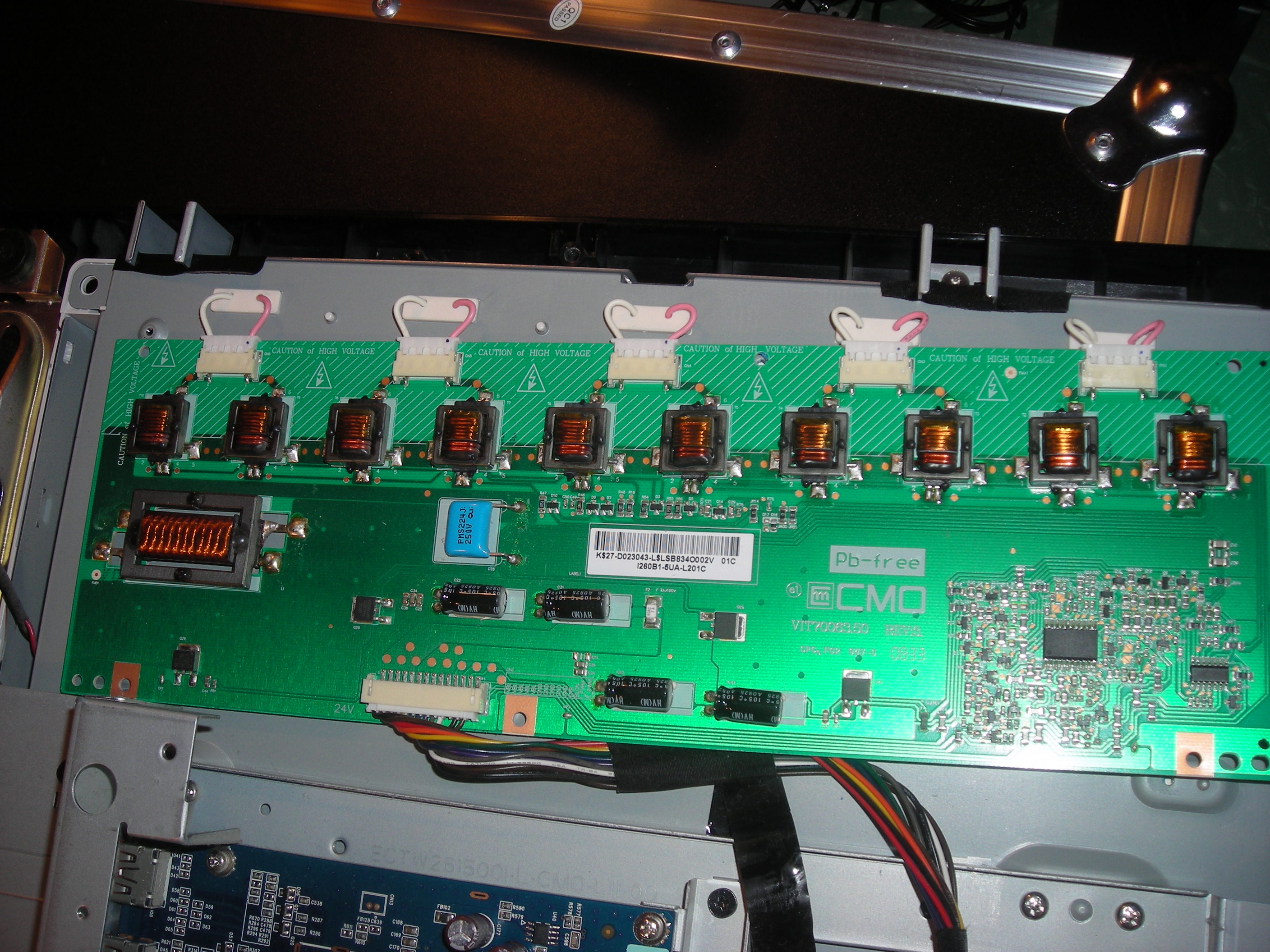

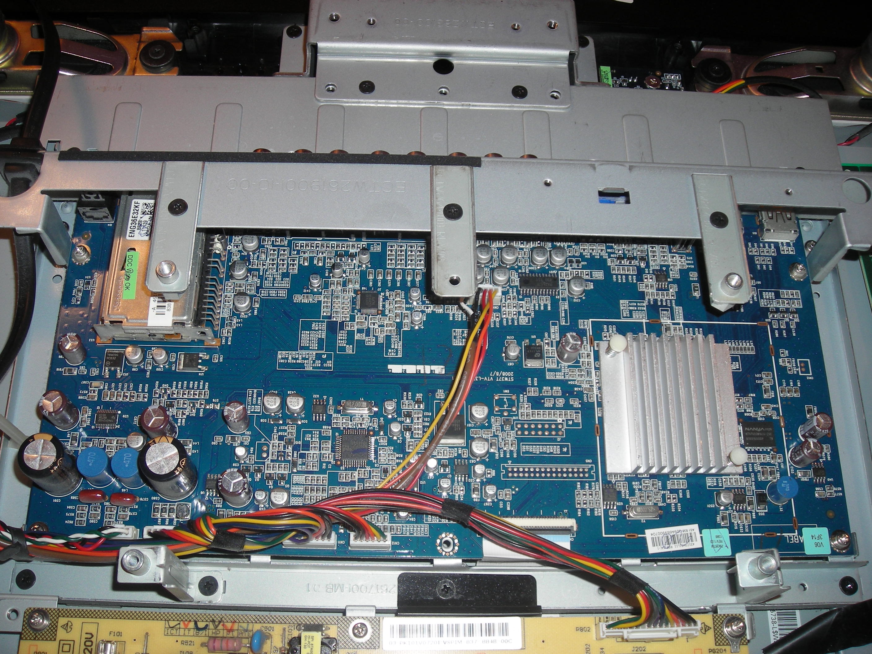

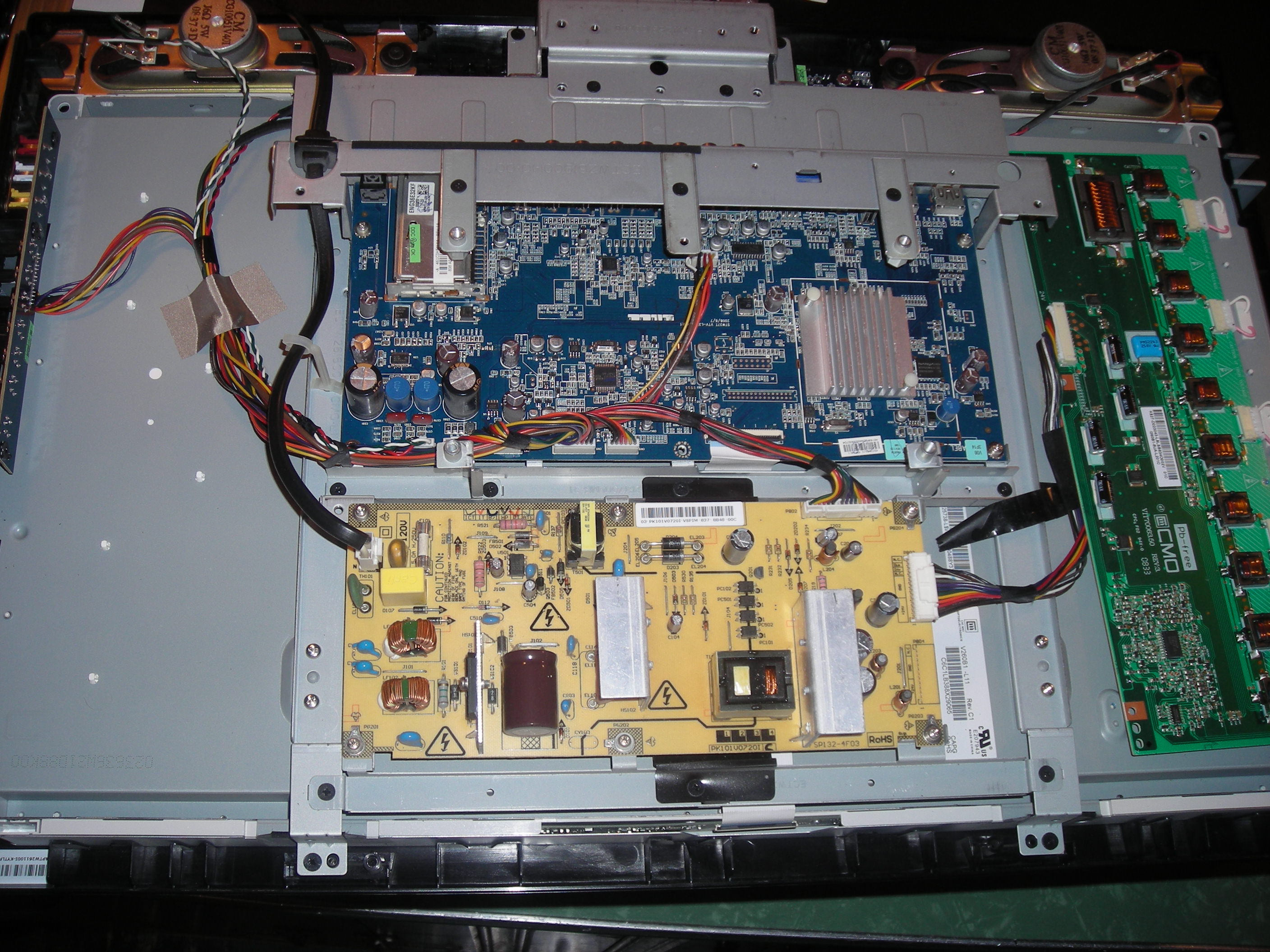

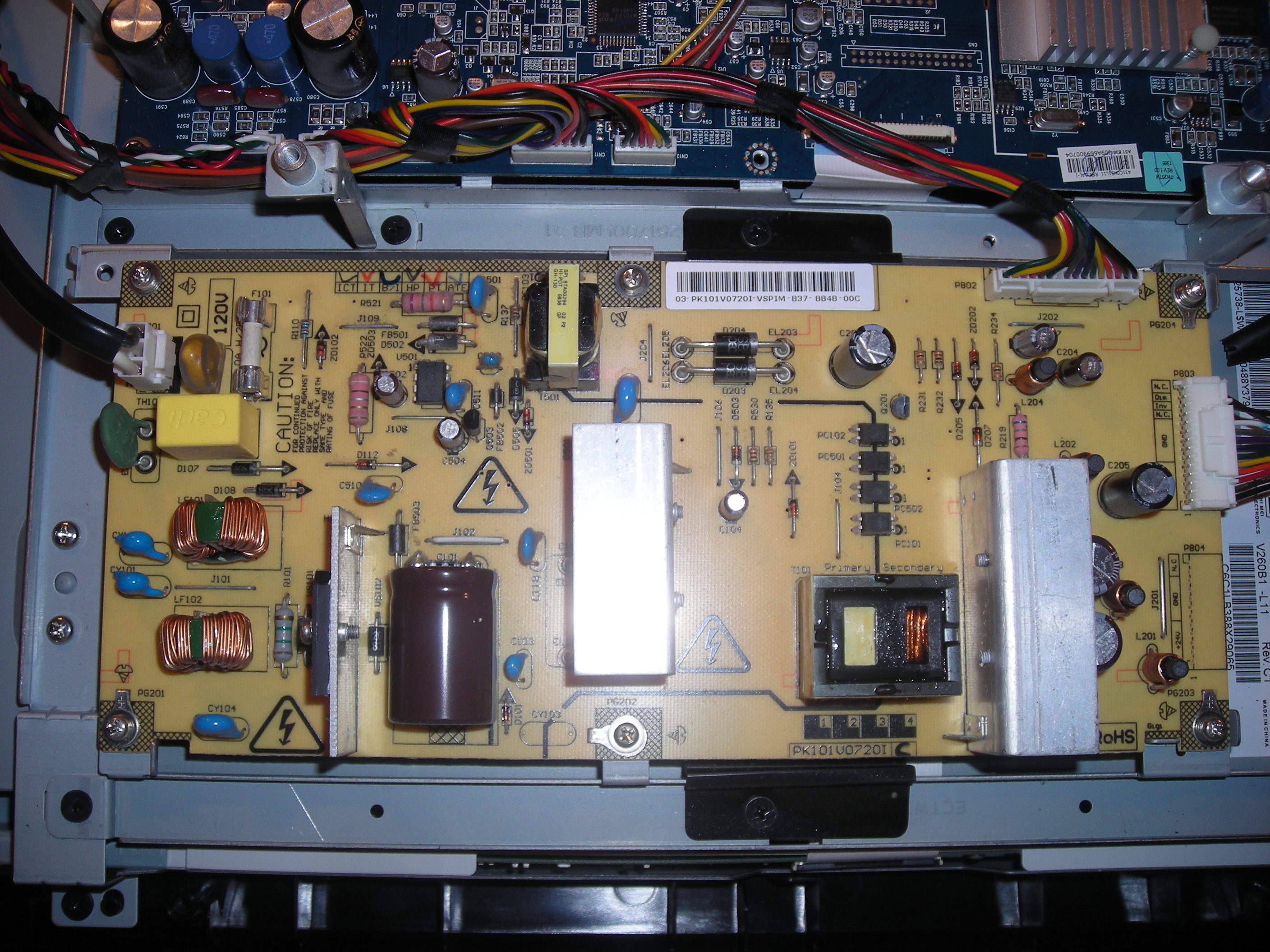

              Re: Toshiba LCD 26AV502R - no picture but I do have sound
              Let me know if these are good enough or if you need close-ups.
              First one is of entire back side. Just to orient you, the yellow power board is the top of the TV.
              2nd is main board. 3rd is power board. 4th is inverter board.
              Let me know if those look good as well.
              VV5

                                  • attainteddragon
                                    • Apr 2013
                                    • 764
                                    • australia
                                    thats better.
                                    you have your inverter on signal and inverter power. so main board is good at this point.
                                    now, on the inverter board, check the dc voltage on each side of the fuse f2 and report back. make sure it is resecured prior to applying power. cover can stay off.
                                    in a dark room, is there a small splash of backlights on start up?
