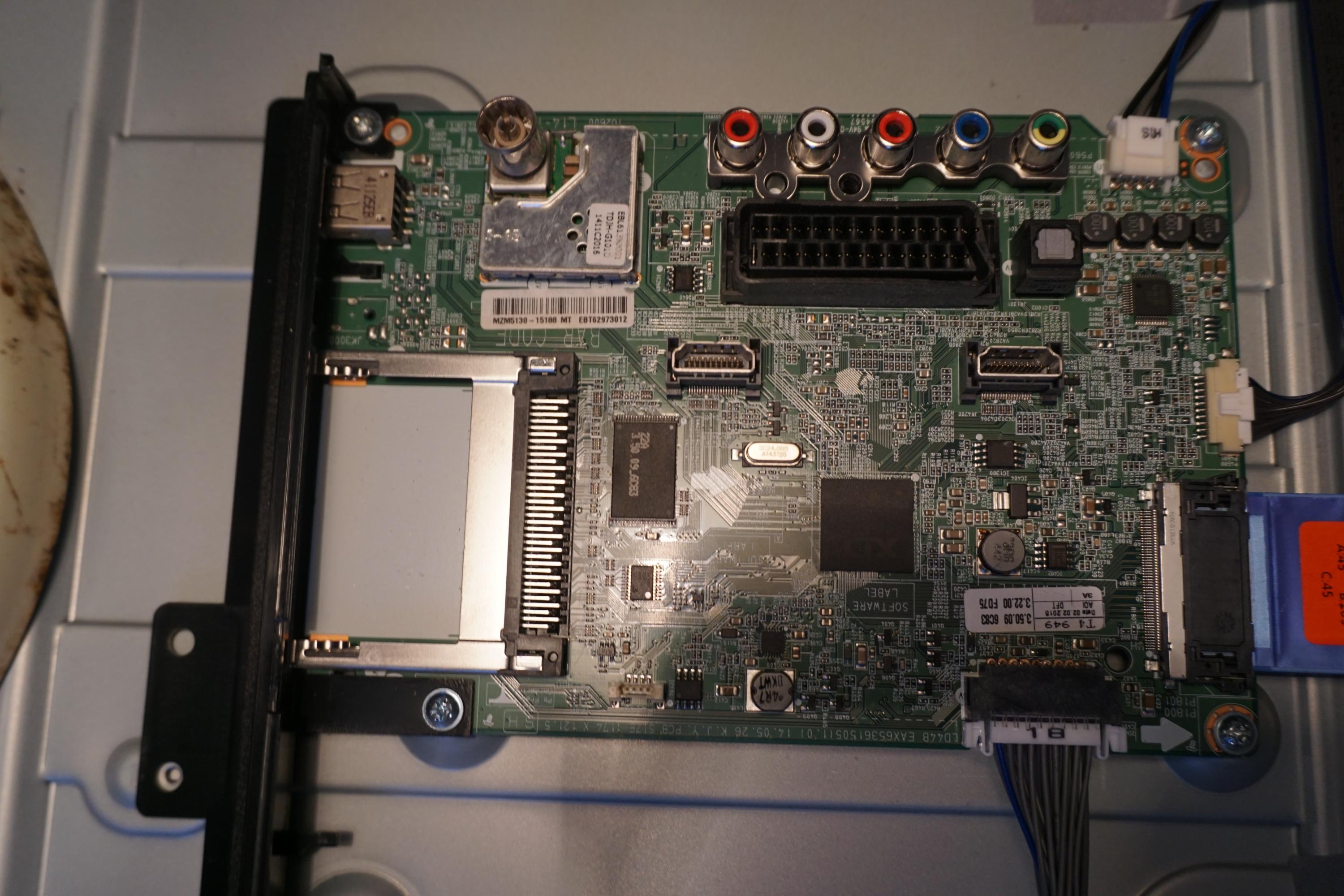

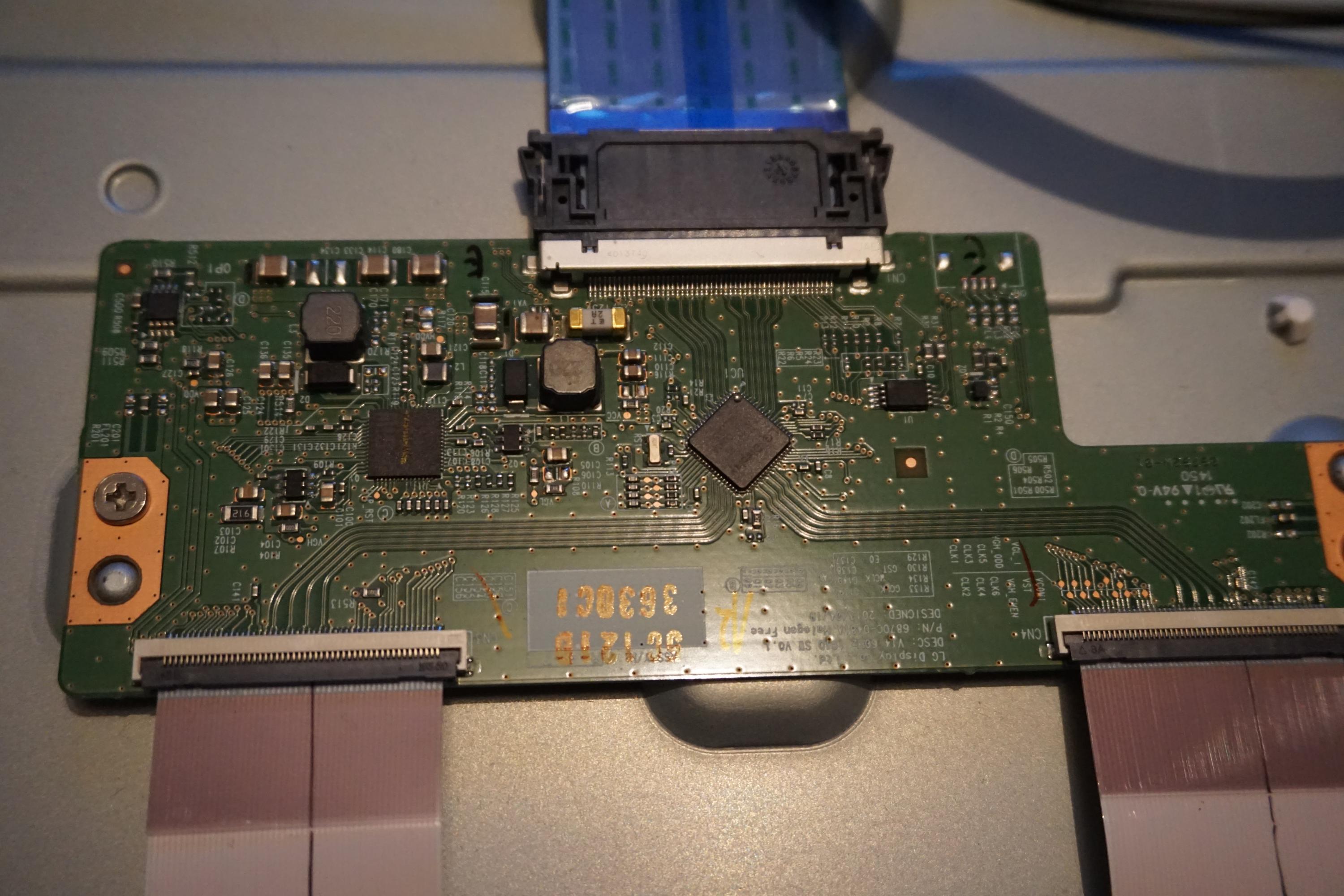

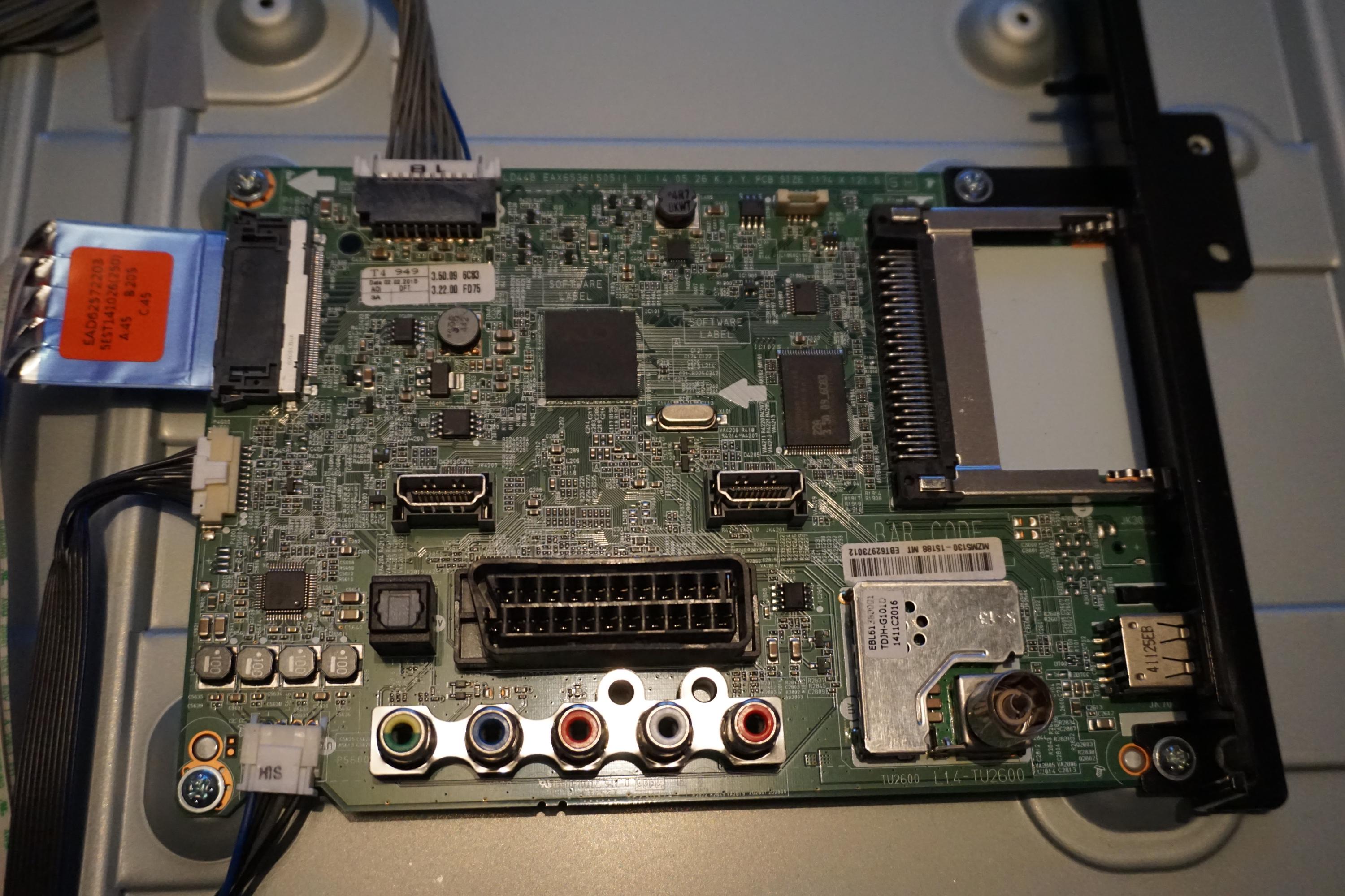

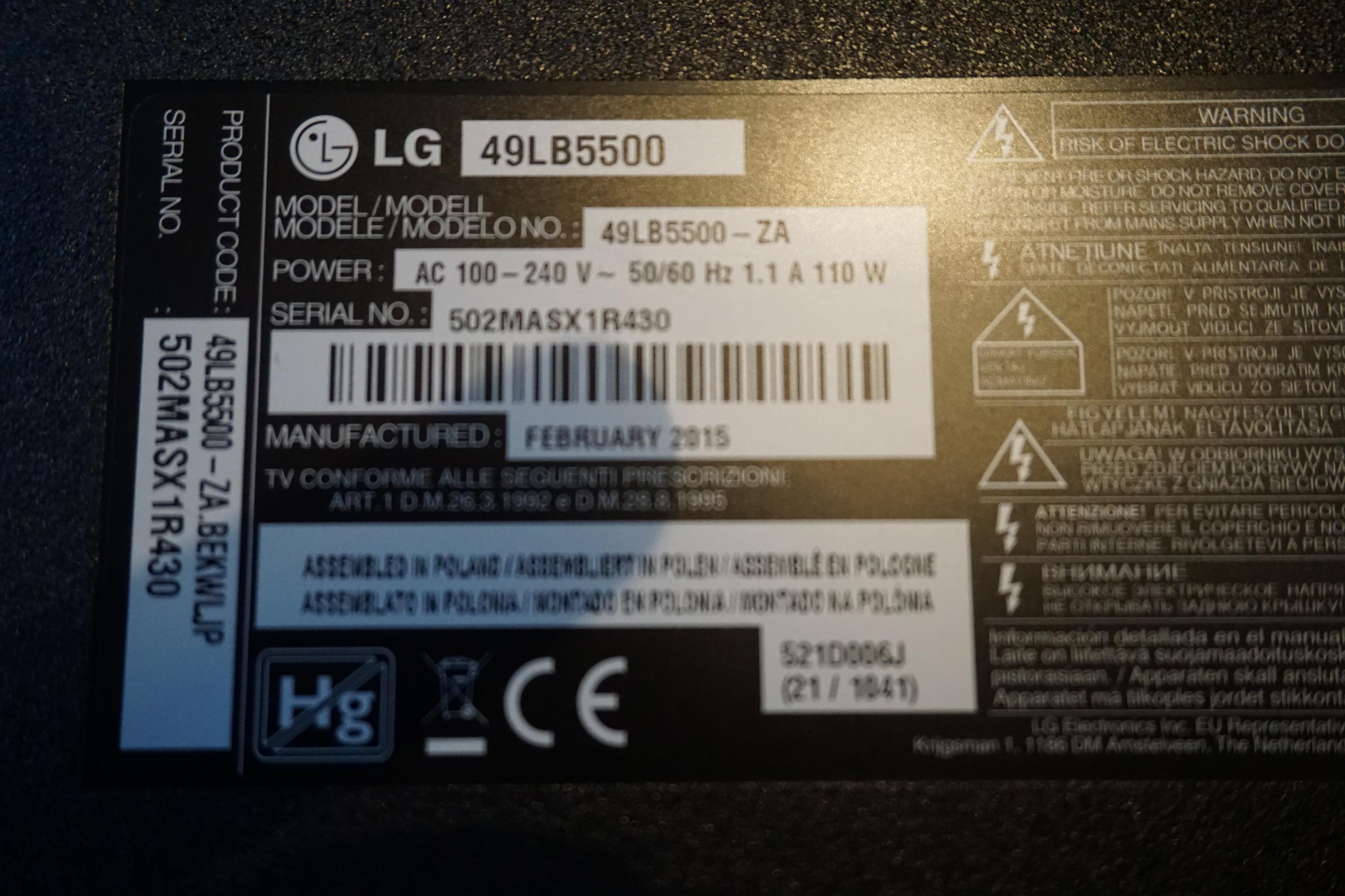

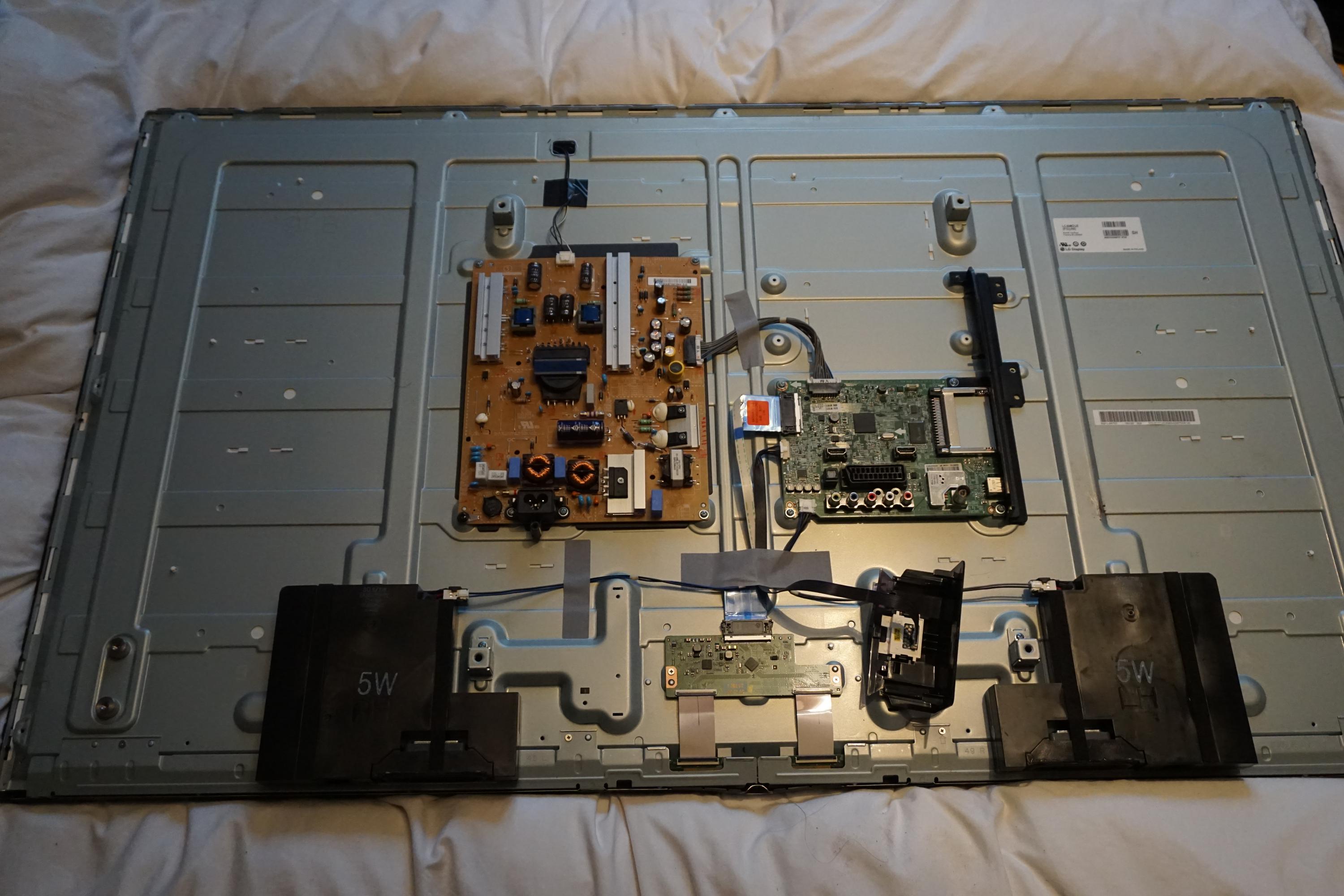

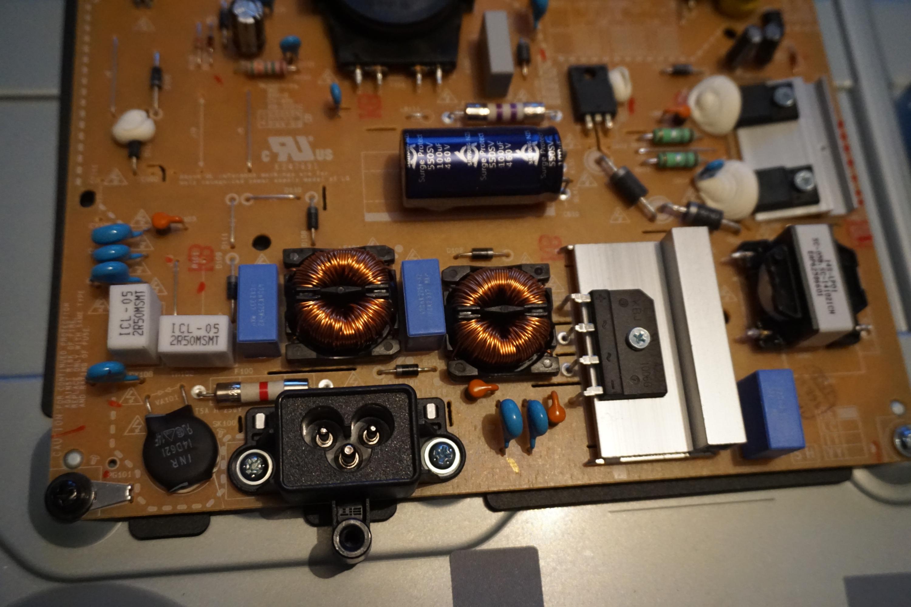

    Hi All,
    So... It's been a while since I was here and it seems all the knowledge I thought I had has gone and I'm totally at a loss (I've been searching all night too). So.. I thought I'd ask here and see if anyone can kick me off and point me in the right direction
    I've got an LG LED TV and the backlight keeps flicking on-and-off. It comes on for a second and then off for 5 and on for a split second and off...
    I've looked around the board and can't see any bulging caps, tried to fiddle with settings etc and got nowhere..
    I'm assuming it's going to be an LED strip but I thought before I rip it to pieces and get down to that I'd try and exhaust any simple tests I could with just the back open..
    So, I've taken some photos (which I hope aren't too terrible) and now I'm at your mercy Where shall I start do you think?
    Excited to be playing around with this stuff again and luckily I don't really watch much TV so this is as much for fun as anything else before I toss the TV out.
    Thanks in advance all!!!!!!!!

      Re: LG 49LB5500 LED Backlight Problem..
      Sorry! Computer froze whilst downloading from my camera.. Take 2! (and hello again )

        measure the voltages on each LED string at the power supply. You have 2 strings.

                  Yeah... LED's can fail like that. Once a faulty LED gets hot, it fails, it cools off, then it turns on again. The cycle repeats. Measuring the voltage on the strings, will tell you on which string the problem is, then you have to disassemble the panel and find the bad LED.

                    Cool - what's/where's the best place to test the strings? At the power supply?

                              Hurrah - found the cable... Now I just need to figure out where/what I'm testing? I assume I take the power supply board off and test the contacts on the rear? Or should I test on the T Con board?

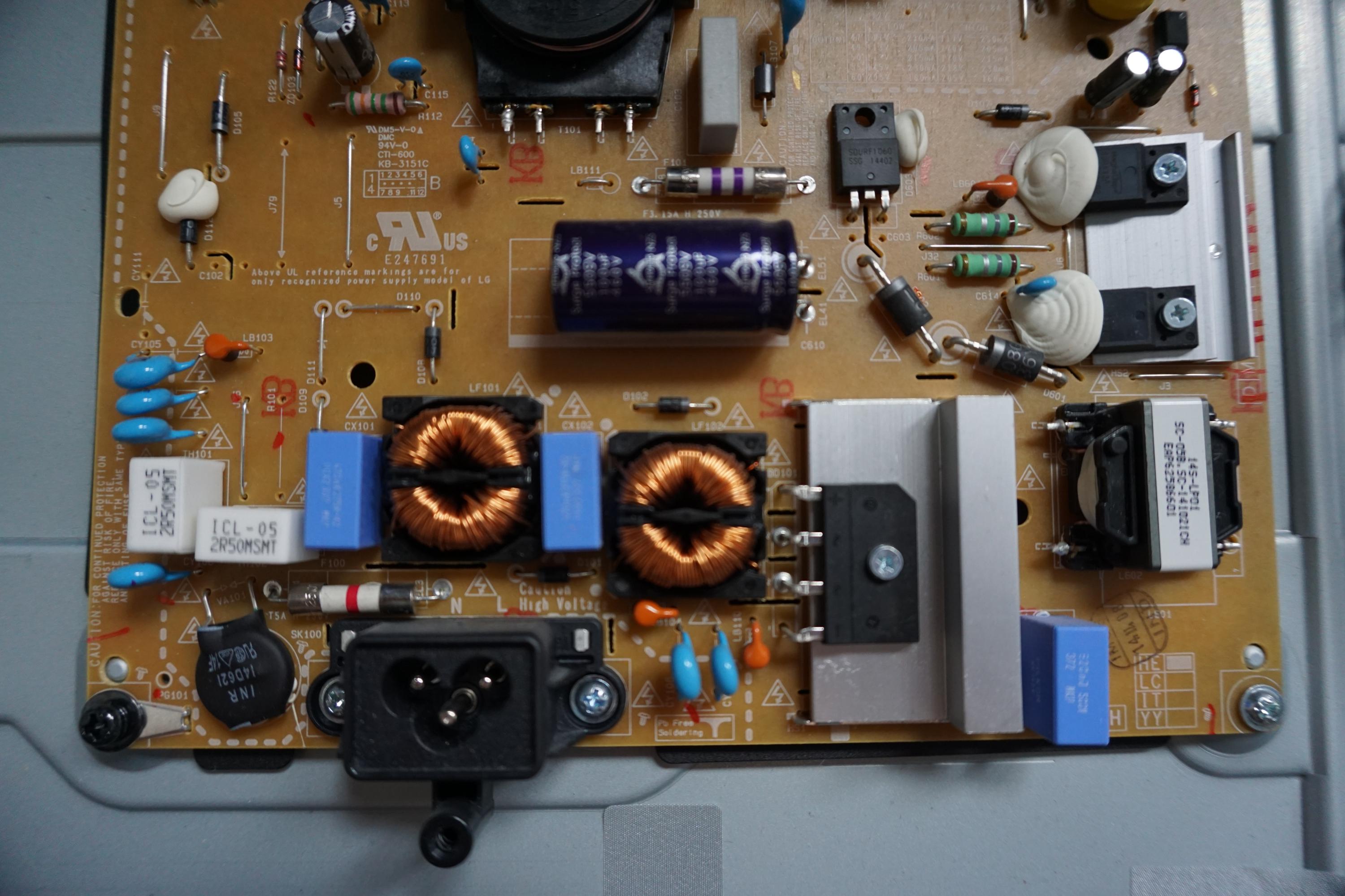

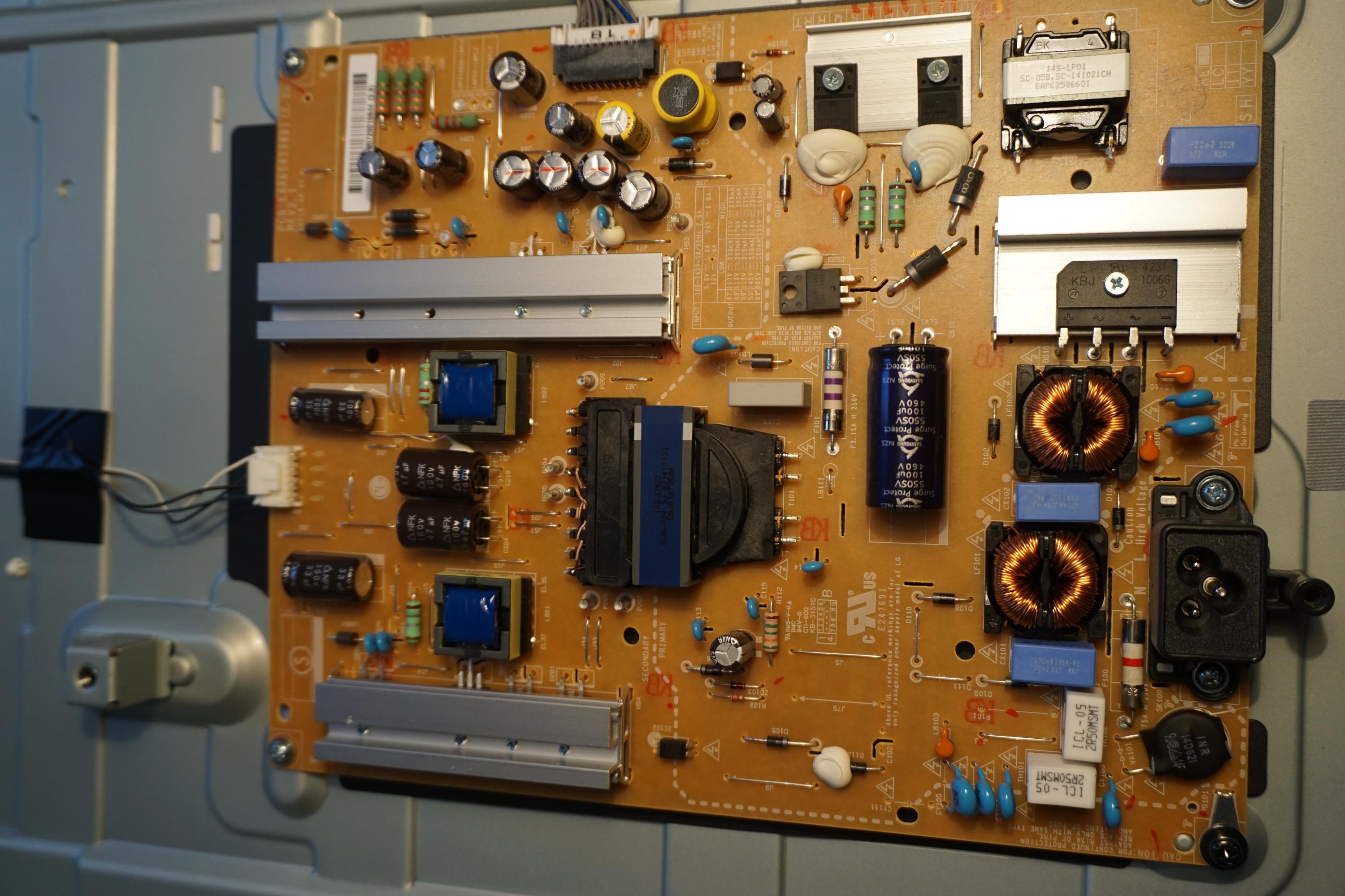

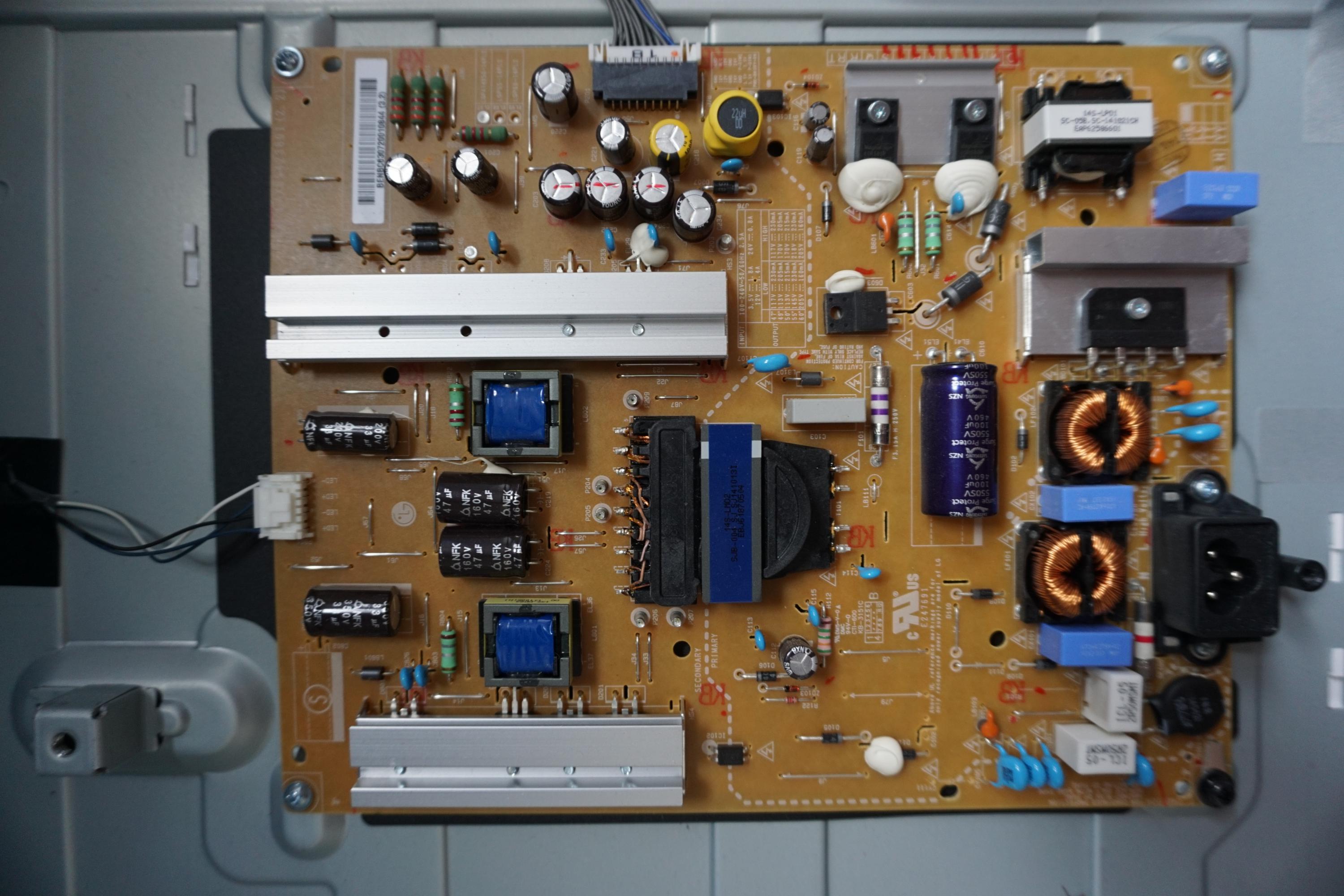

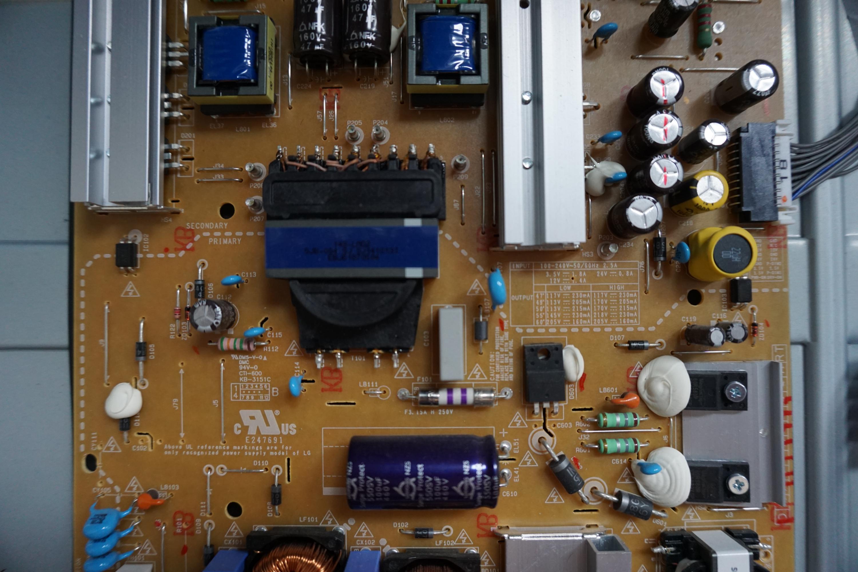

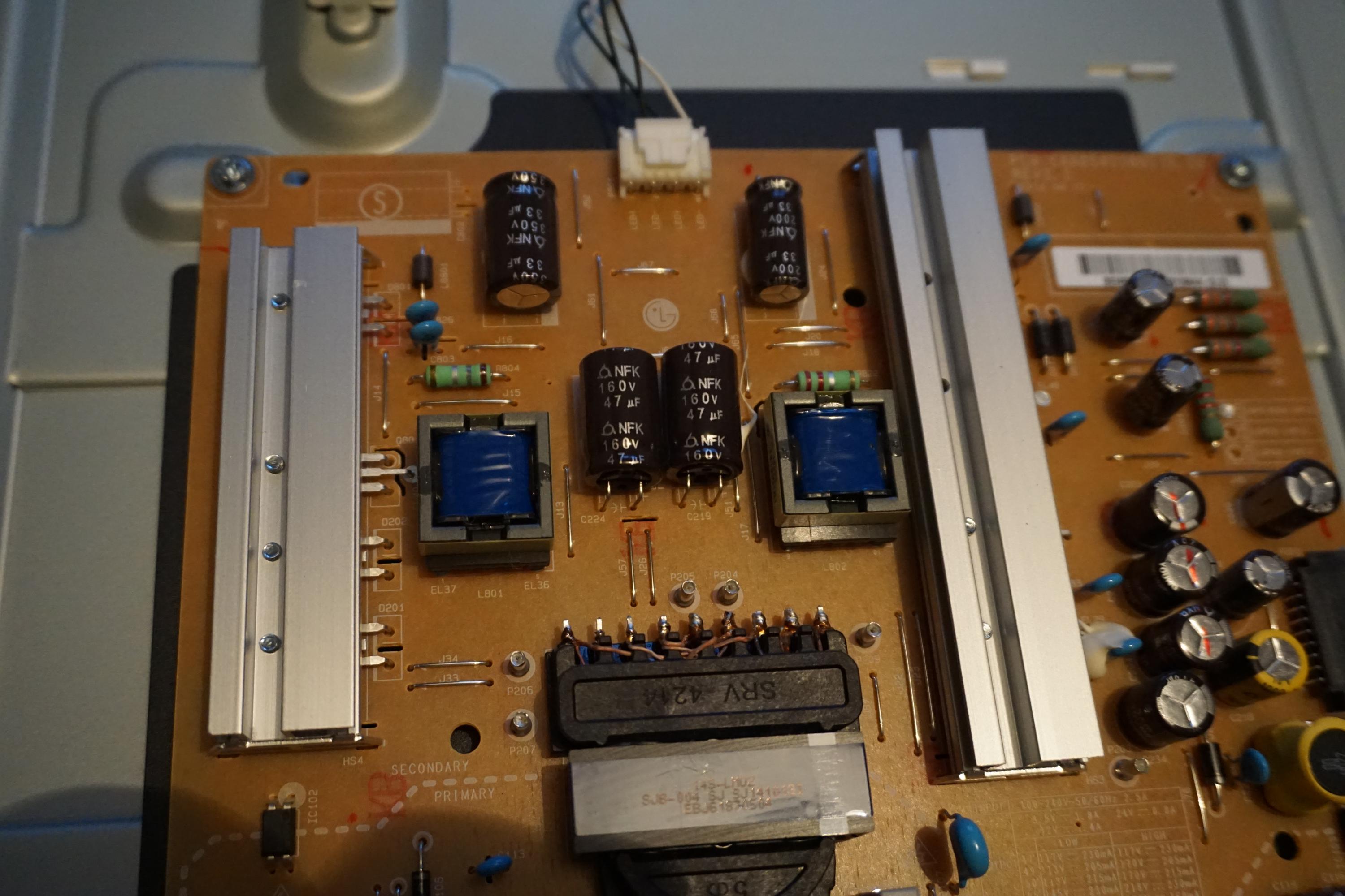

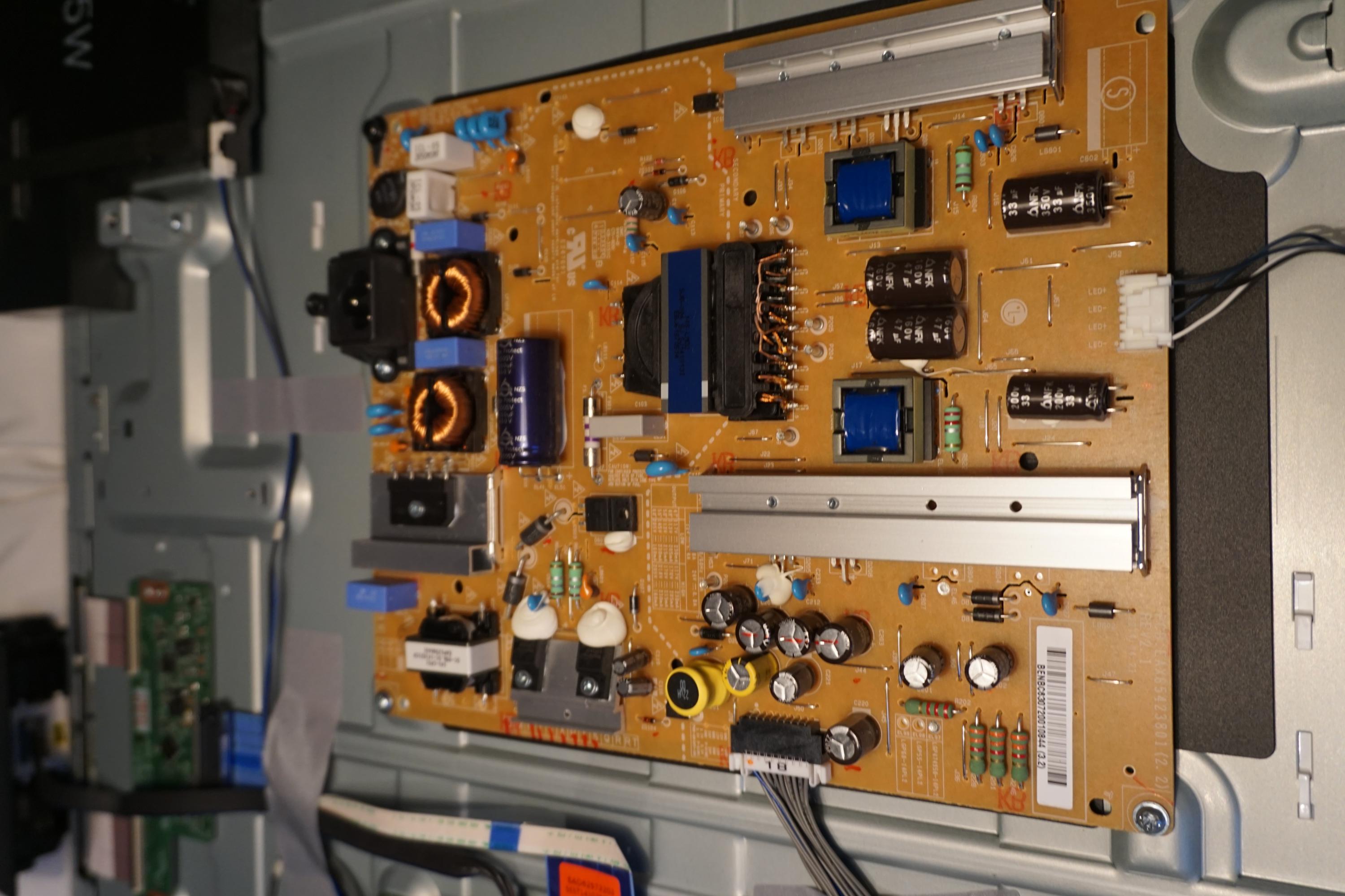

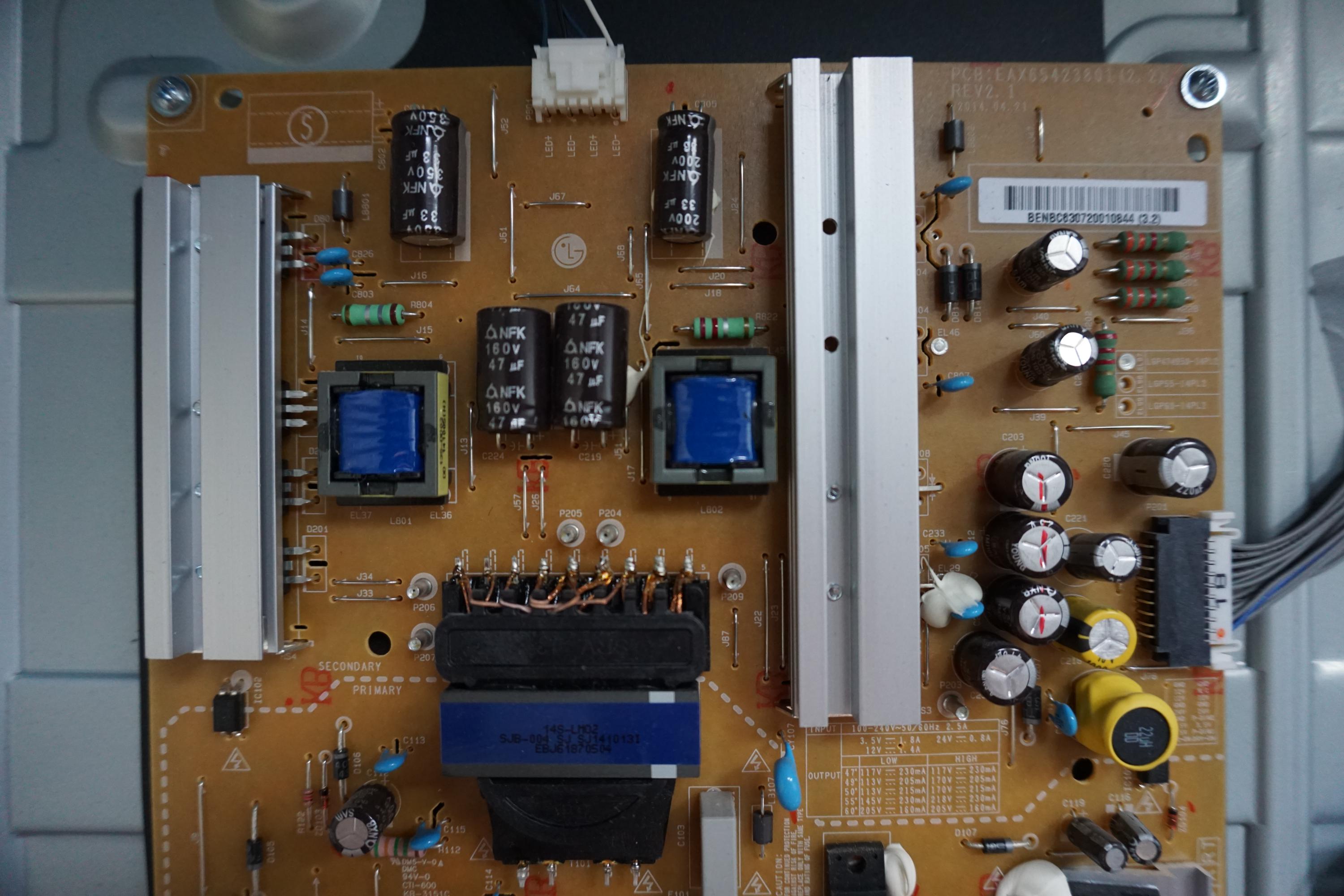

                                can you post a good clear picture of the power supply and also picturs of the connectors on it so we can see the printing by them as you should be able too test the led volatges there too prove you do have a issue.Sometimes though you have to strip the lcd panel down so that you can see the leds then power the set on and hopefully you will see the led at fault.
                                • stedmund08
                                  • Nov 2015
                                  • 34
                                  • England
                                  As requested
                                  • stedmund08
                                    • Nov 2015
                                    • 34
                                    • England
                                    Hmm, they still look somewhat blurry on the screen.. Let me know if they're no good.
                                    • Andrew F. Ali
                                      • Jan 2014
                                      • 2450
                                      • Trinidad & Tobago
                                      Would have to take some LED backlight supply voltage measurements at start-up and at shutdown. I would just go ahead and replace all the LED strings, if it is cost effective.
                                      • stedmund08
                                        • Nov 2015
                                        • 34
                                        • England
                                        Where do I measure from? The two coils at the bottom?
