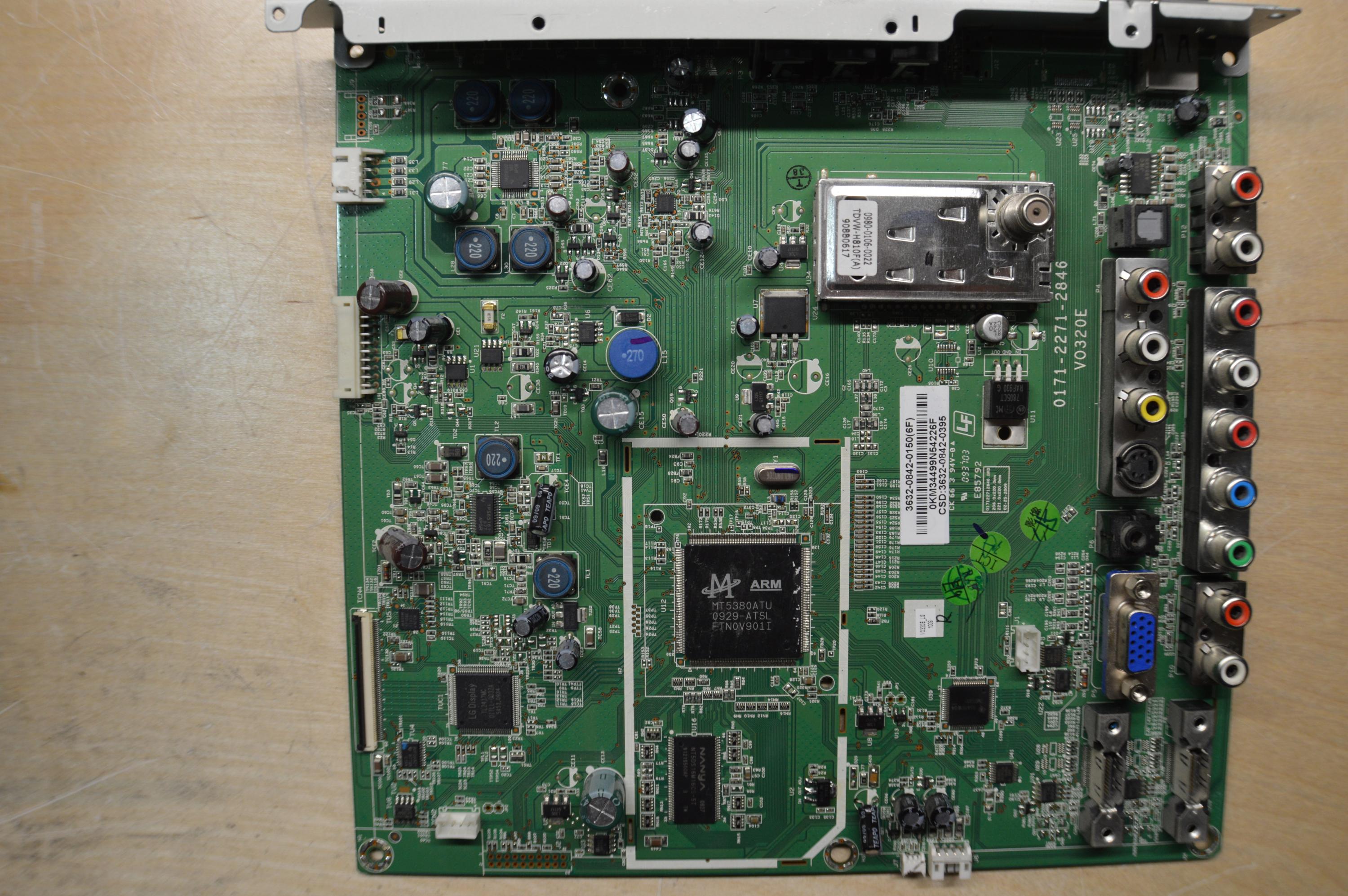

    Vizio VO320E main board
    Working on a Vizio 320E that has issues with the main board. The main IC U12 gets extremely hot. Wondering if anyone else has had this same problem? How can I confirm it's the main IC. Also has anyone else ever tryed to change this IC? Saw them on eBay for $15.50.

      Re: Vizio VO320E main board
      Since you post no pictures and I don't have clairvoyance have no clue
        https://www.badcaps.net/forum/attach...1&d=1496523291
        Sorry about that. Let me know if you need better pictures.
          Looks like main processor. Surprised you can buy it. What are issues? How hot? Is that why you removed heatsink? Did it have thermal pad on it?
            I did remove the aluminum heatsink because I wanted to see the part number on the main IC. It gets very warm.
            With in 50 to 60 seconds you can't touch it. I first thought it was U2 voltage regulator because the voltage reading on the output pin was .17 volts and it was also very hot, I change it but nothing changed. I'm thinking that's because something else in the circuit is shorted.
              Might want to remove U2 and check for short on output trace. See where trace is running
                I have already change U2 voltage regulator and it still gets hot because something else in circuit is shorted. Does anyone out there have a schematic for this TV?
                    I'm sorry I miss read your post. Yes output pin to ground is 0 ohms dead short.
                      You will need to run that trace and check components for short. If it runs to main processor with no shorted components between then I hope you have good soldering skills.
                        I ordered a main board off ebay because we're getting pretty deep here. So just for fun I took my hot air gun and removed the main IC and the short to ground remained. (which really surprised me because that IC was getting so terrible hot) So then I removed IC U39 and then the short to ground was gone. It now reads 270 ohms to ground. So at this point I guess I really don't know what to say.
                          U39 looks like hdmi
                            that is still a very low reading, so i doubt that is the main fault.
