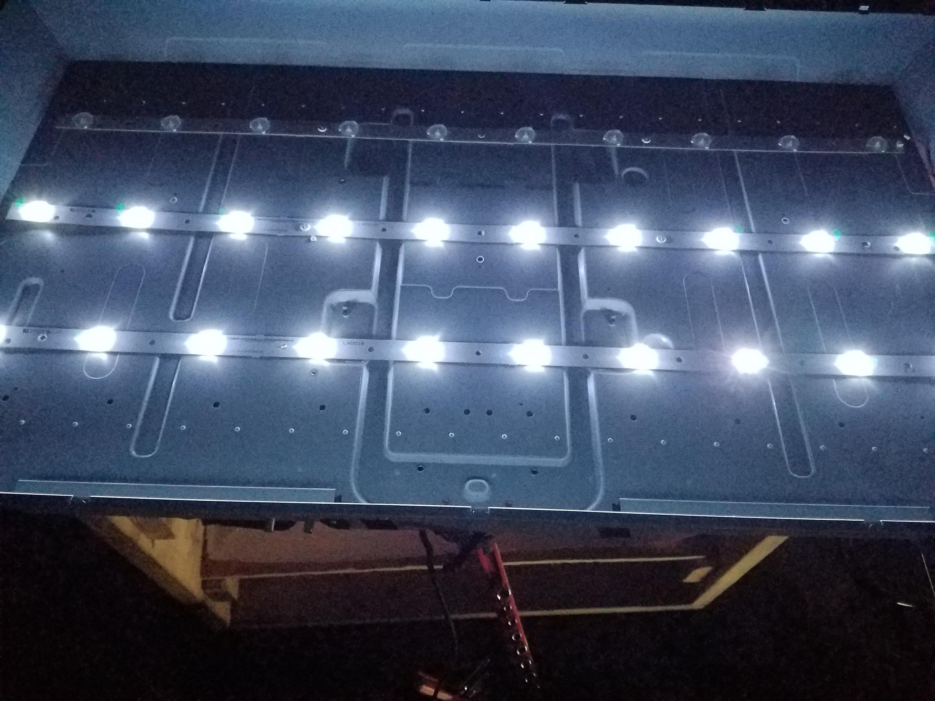

    Proscan PLDED3992A-C led failure?
    I read a couple of threads on this set but i didnt see any repair resolution
    But it did guide me to take apart the panel to get to the led strips
    As you can see the bottom 2 strips do power on and the top does not. But they flash non stop every second
    I disconnected the top strip to see if the bottom 2 would stay on but they continued to flash every second
    Would this mean the top strip is faulty ?

      Re: Proscan PLDED3992A-C led failure?
      So if one led is faulty the entire strip goes out?
          They are in series if 1 opens the strip will go out. If 1 shorts the shorted 1 will go out. The tester will tell the working voltage at 300ma
                                        so i got the LED tester and tested all 3 strips
                                        the bottom 2 strips light up
                                        the top strip does not
