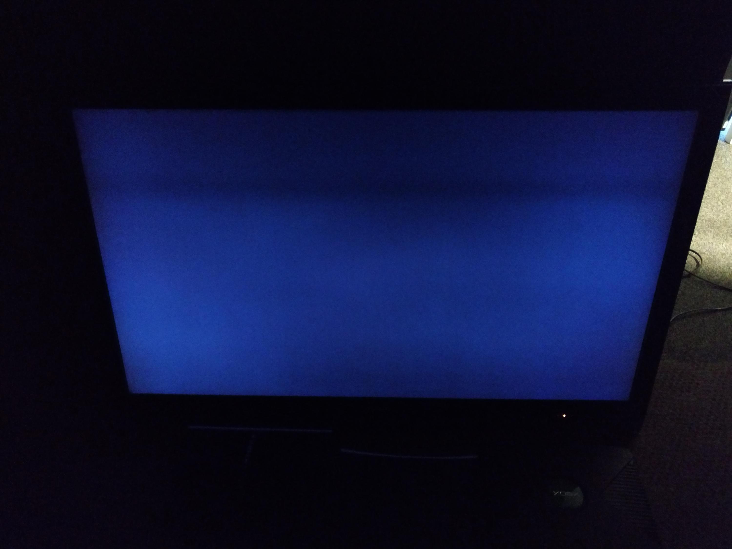

    I'm working on this Sharp 52" LCD (conventionally backlit; not LED) and it has what appears to be at least one dead backlight. It powers on briefly with a blank screen, then shuts off with a blinking green light. In the time that it is on, I can see a horizontal area that is dimmer than the rest, so I'm pretty sure that this is a bad backlight issue.
    The trouble is, I can't find replacements anywhere for this model. Is there any way to find out what kind of backlight it needs without tearing the whole thing apart? If not, is there an easy way to bypass the system and rig it up to run with one less lamp?

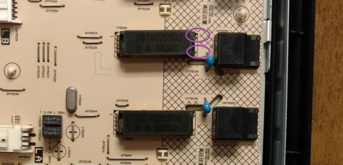

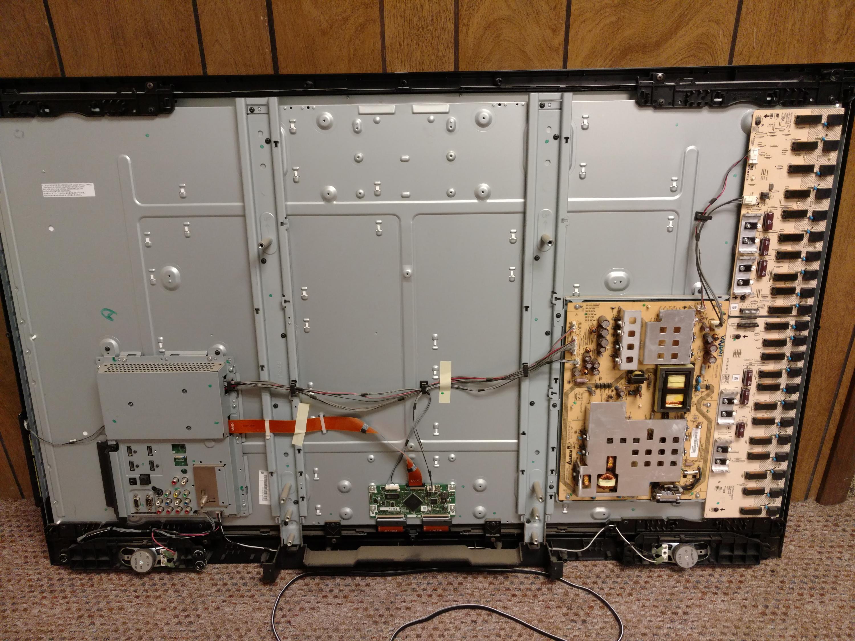

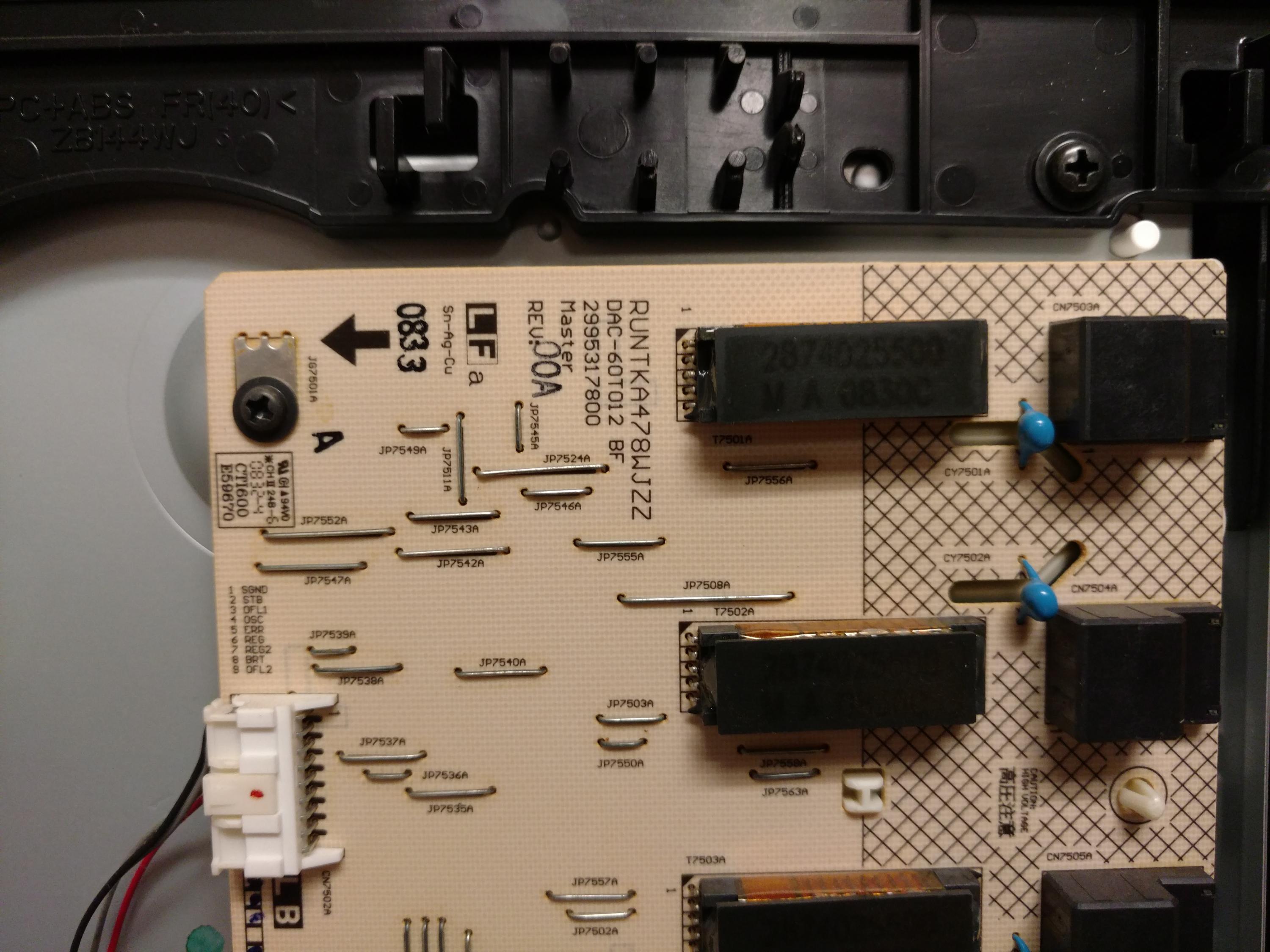

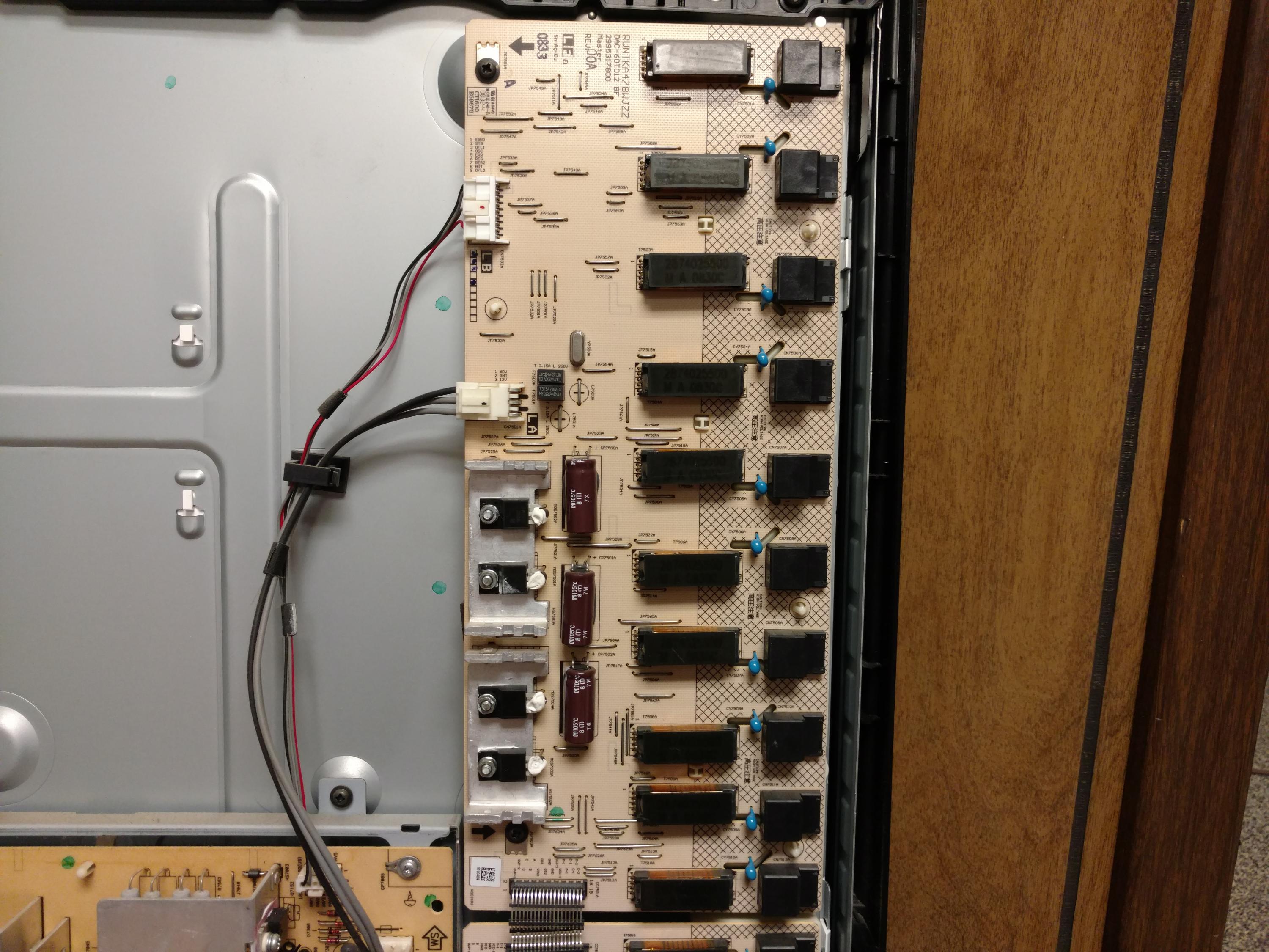

            More details about this model; backlights replacement or bypass feasible?
            I finally got the rear cover off and got a look at (as well as pictures of) the layout. There are two inverter boards on the right side and none on the left. The Runtka478wjzz inverter that this model uses appears to actually be for a Sharp panel (not just a Sharp-branded television). No sticker is obviously visible identifying the exact model of the panel, so I'm not sure how to find out what kind of lamps this thing needs (the sticker might be hidden under something though, so I'll try to keep an eye out).

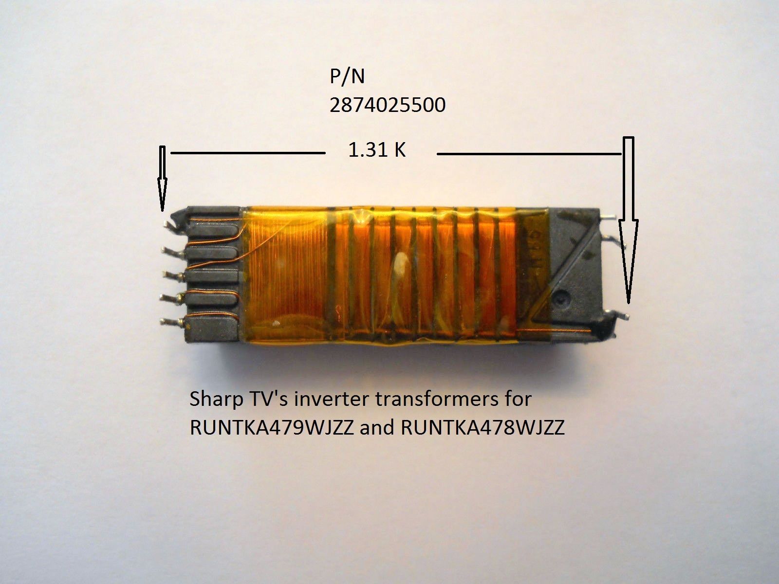

            If I'm reading the markings correctly, these inverters have number 2874025500 transformers on them.
            Beside lamp replacement, the other question is, is there an easy way to bypass one of these in order to allow it to continue to operate without trying to run the defective backlight?

                          Re: Bad backlights suspected on Sharp LC-C5255U LCD
                          Also one of those inverters might have failed. You might be able to just find the wrong inverter, replace it and be good. I did this on a 32" I had. $7 for the part and tv was back in business.
                                pic of the inverter board please.
                                have you checked the output windings on the transformers yet?
                                    measure the resistance on the output pins of each transformer.
                                    i havn't had to look at this type, but looks like one transformer per ccfl.
                                    power off of course.
                                    the one that relates to your non illuminated ccfl may of failed.
                                    if it has, it will have a noticeable difference of resistance compared to the others on the inverter board.
                                    if so, you can replace it and have the tv fully functioning without any bypassing needed.

                                      Infinite resistance!
                                      I'm getting infinite resistance on all of the transformers when testing those output pins with the multimeter. It's not an auto-ranging meter, but I've gone to each transformer and ratcheted through all of the different resistance testing options to no avail. Am I doing something wrong?
                                        Pinout of transformer
