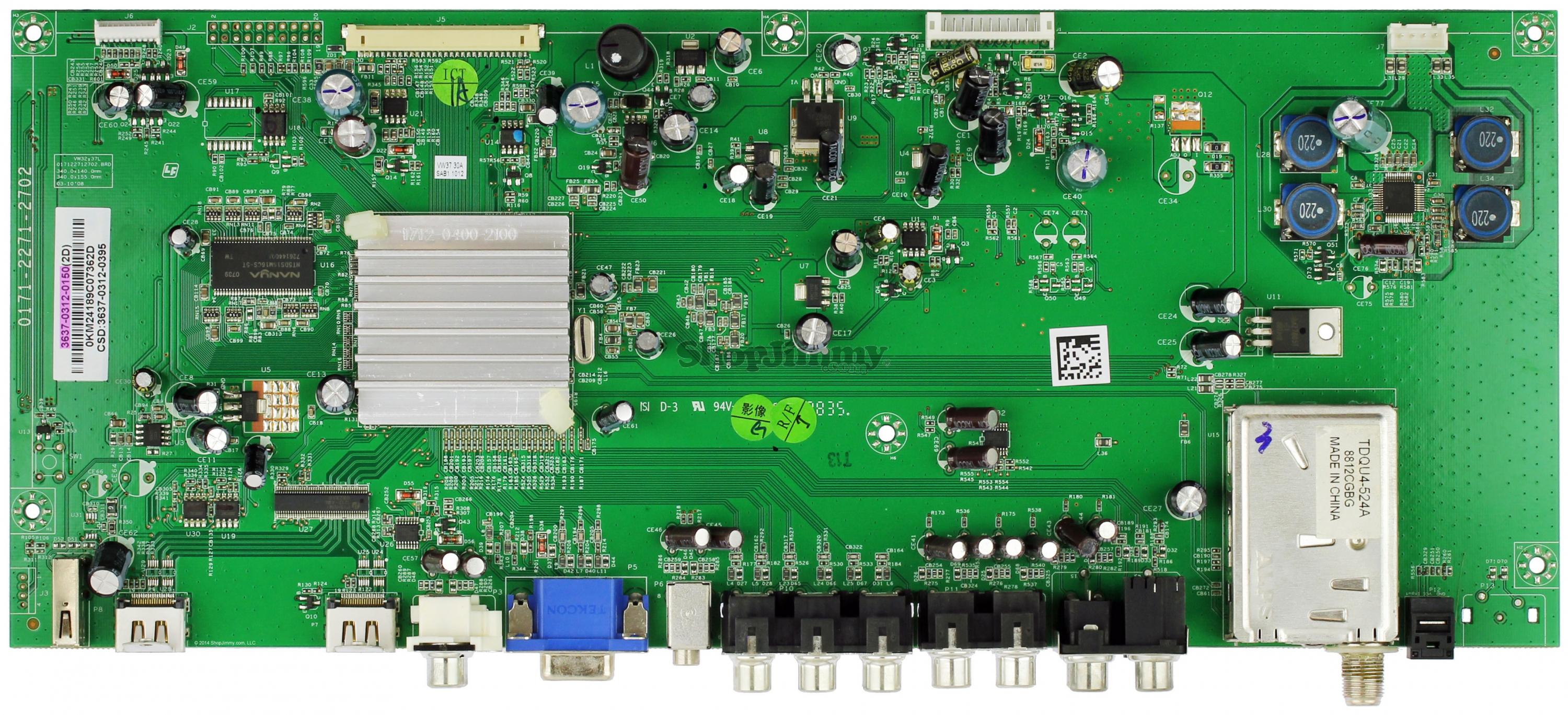

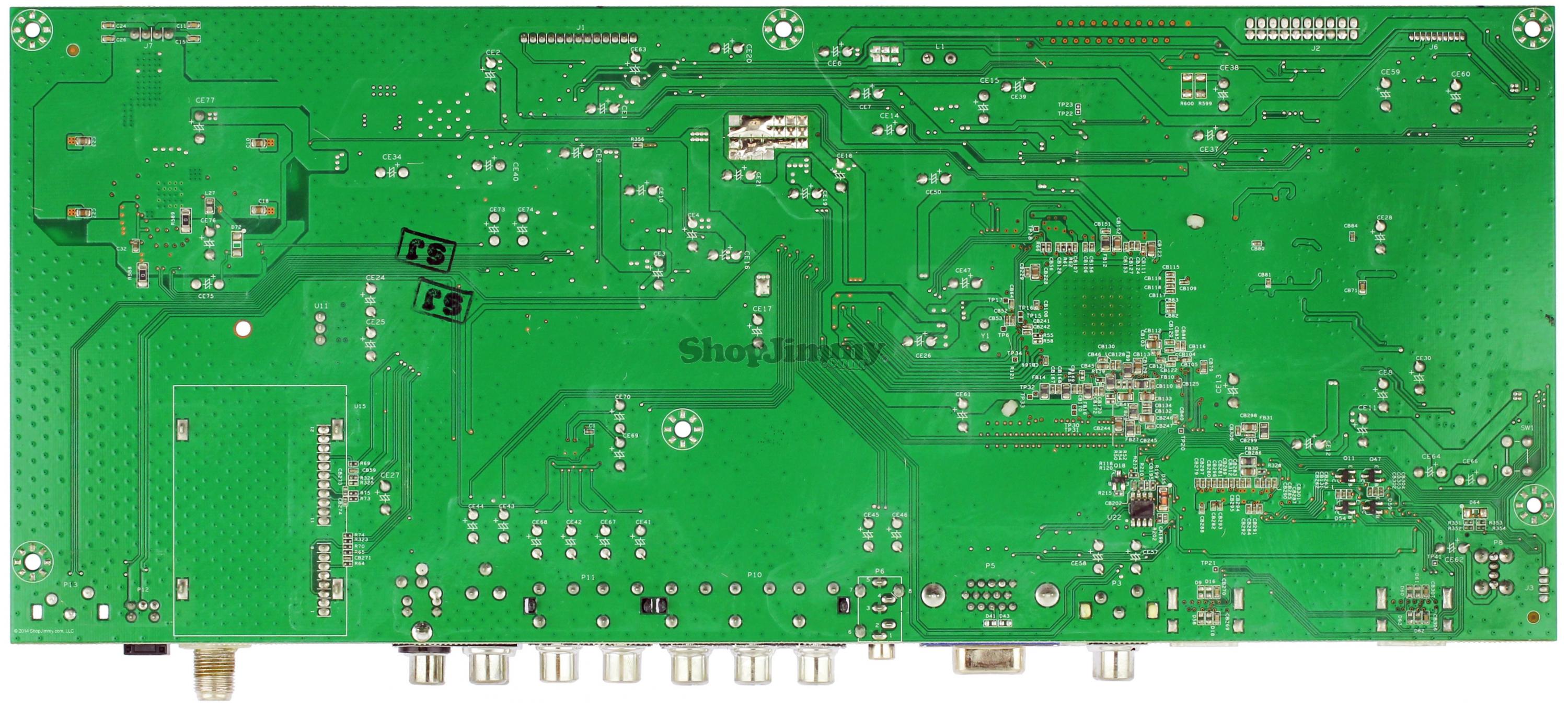

                            http://www.shopjimmy.com/vizio-3637-...7lhdtv30a.htm#
                            Vizio 3637-0312-0150 Main Board for VW37LHDTV30A
                            Pictures provided by shopjimmy.
