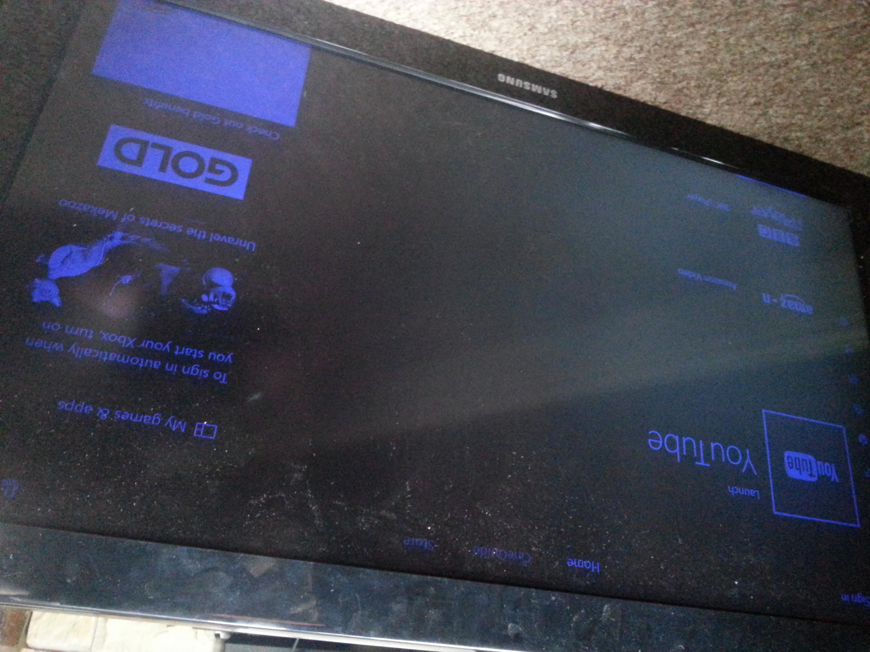

    Hi guys,
    As the title says, the TV has a blue tint to the screen, really quite bad as well, it's unwatchable. I've just put a new T-Con (well, refurbished with new gamma chip) into it as well. I'm not entirely sure what the fault was before, it was probably 12 months ago when I looked, I just had a record that it needed a T-Con board so ordered it up. Not sure whether the picture was blue before
    Any ideas? Knackered LCD ?
    Thanks.

    Any pictures to show the problem?

      Pic of what the screen looks like.
      Apologies for it being upside down and dusty lol. The picture is also very dark.

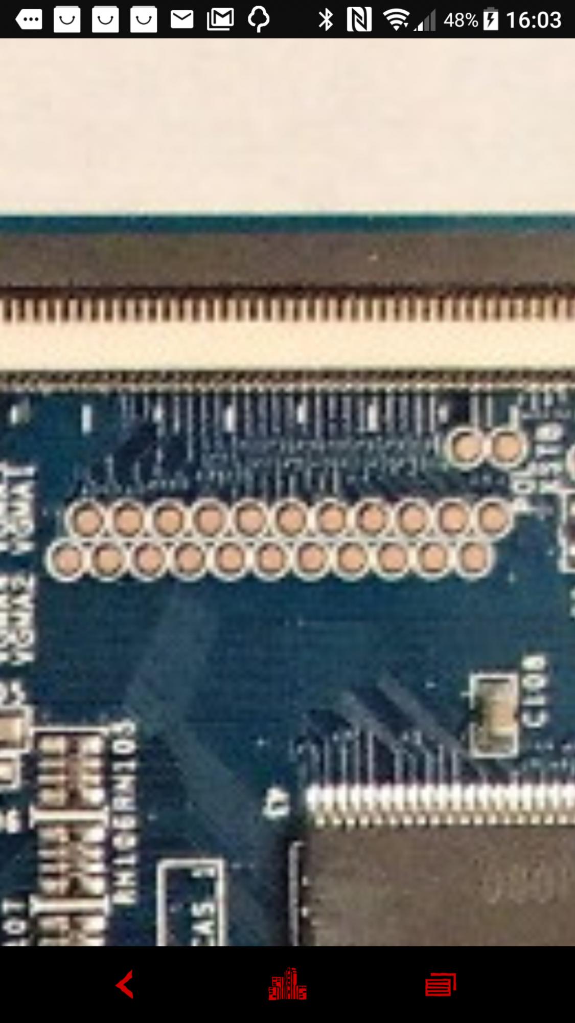

        Probably a faulty AS15-F chip on the TCON.
        Testing gamma voltages would confirm.

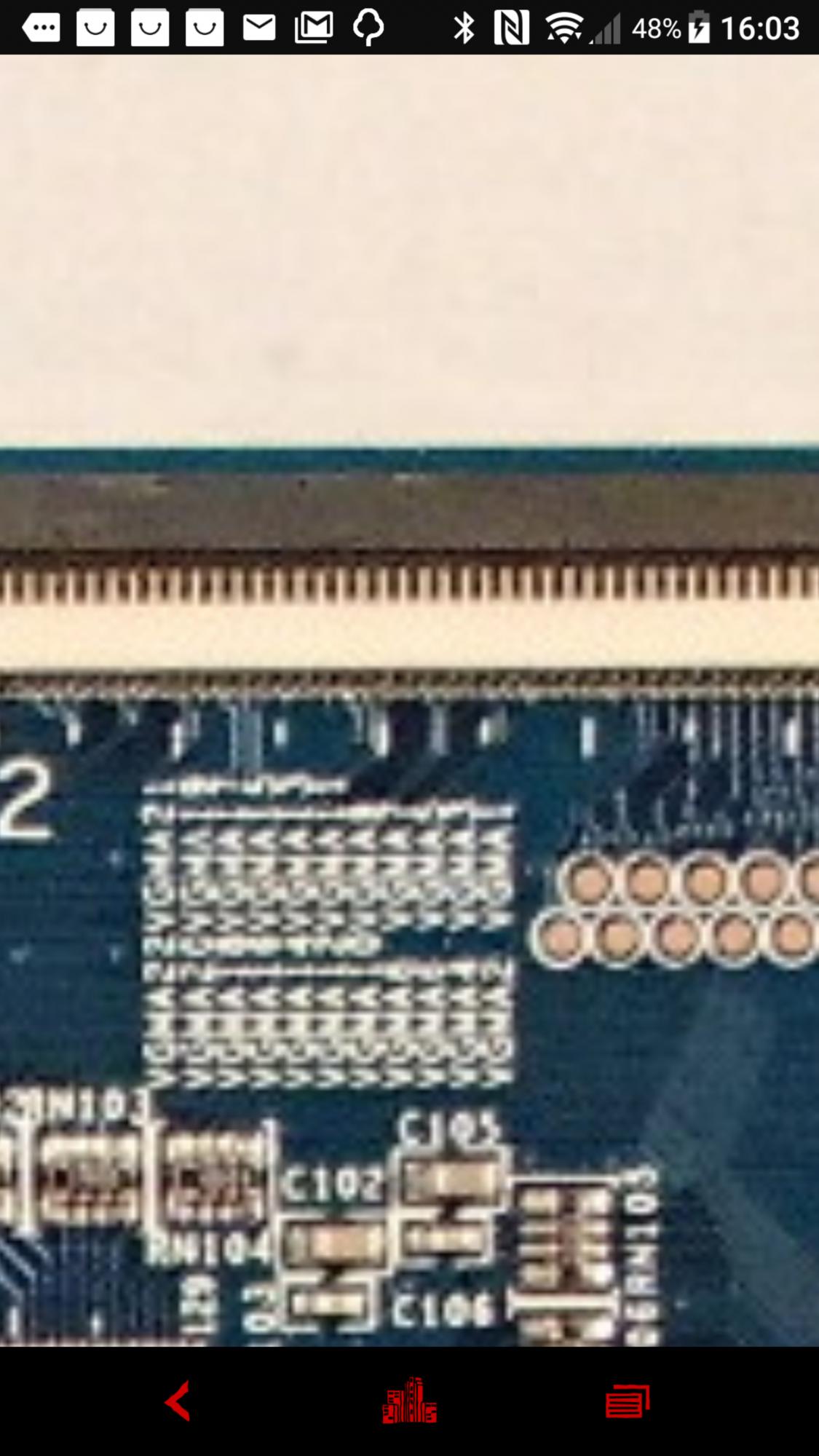

            Re: Samsung LE37A556P1F blue tint to the screen?
            See pics.
            Test points for gamma.
            Post results.
            Eg:
            vgma1 = 15.2
            Vgma2 = 14.7
            Etc
            Etc
