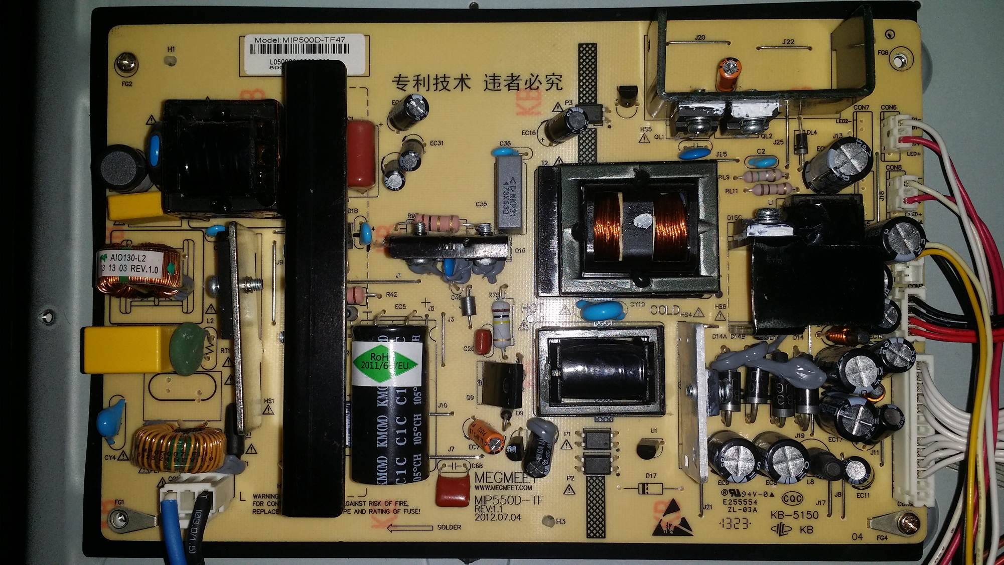

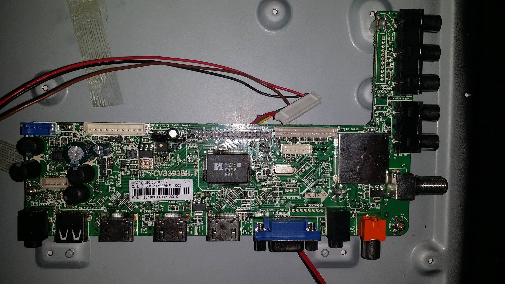

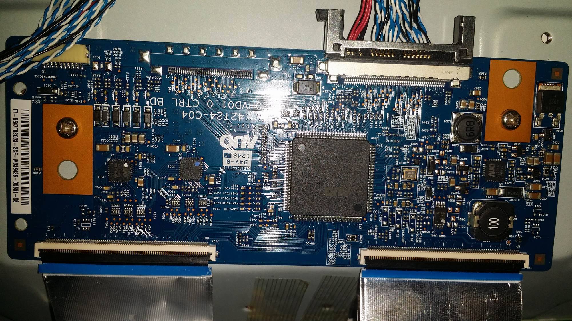

    I have a SEIKI TV model number SE47FY19 and I had no picture but I had sound. I did the "flashlight" test and I could see the menu but I had no backlights. I was told to replace the power supply but still had the same problem. Then, I tried to replace the T-Con Board and still had the same problem. Finally, I replaced the main board but now the TV has the standby light on (red light) but when I hit the Power button or use the remote, the TV does not turn on. Can ANYONE help me please?? Did I buy a faulty main board? Or is it the power supply? I'm really lost here

    Put the old mainboard back in. It looks as though you have a led problem.
    Any pictures of your boards????

      Re: SEIKI TV SE47FY19 No Backlights
      Here are the pictures
        What dc voltage do you have across the two legs of EC5 (capacitor) when you switch on.
        Also just above EC5 (3rd picture) there's a blue ceramic capacitor which appears to have some sort of deposit on the circuit board alongside it. Is that capacitor damaged?
        Edit
        What voltages do you have on the pins of CON6 & CON8
              Probably bad backlights. That will require the disassembly of the whole tv and testing of leds. It is a very delicate job to do without breaking panel. I suggest you watch some youtube videos on replacing backlights and see if you want to tackle job
