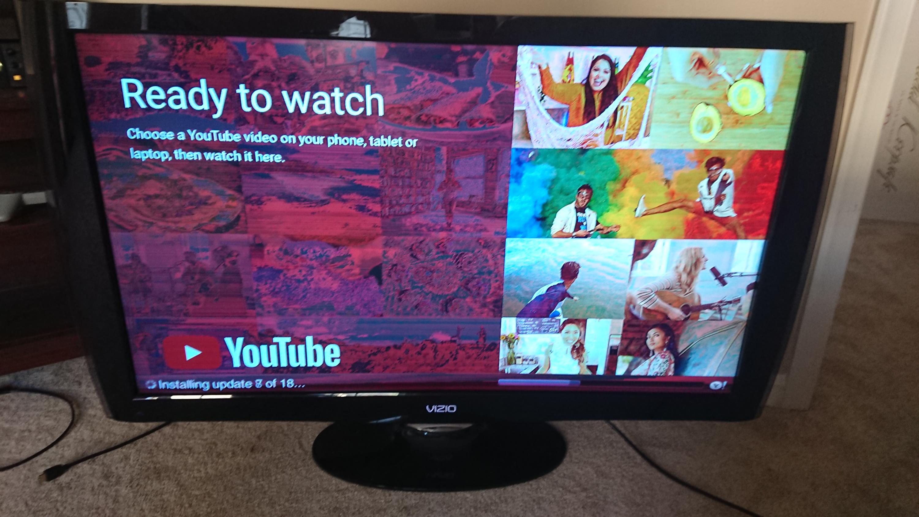

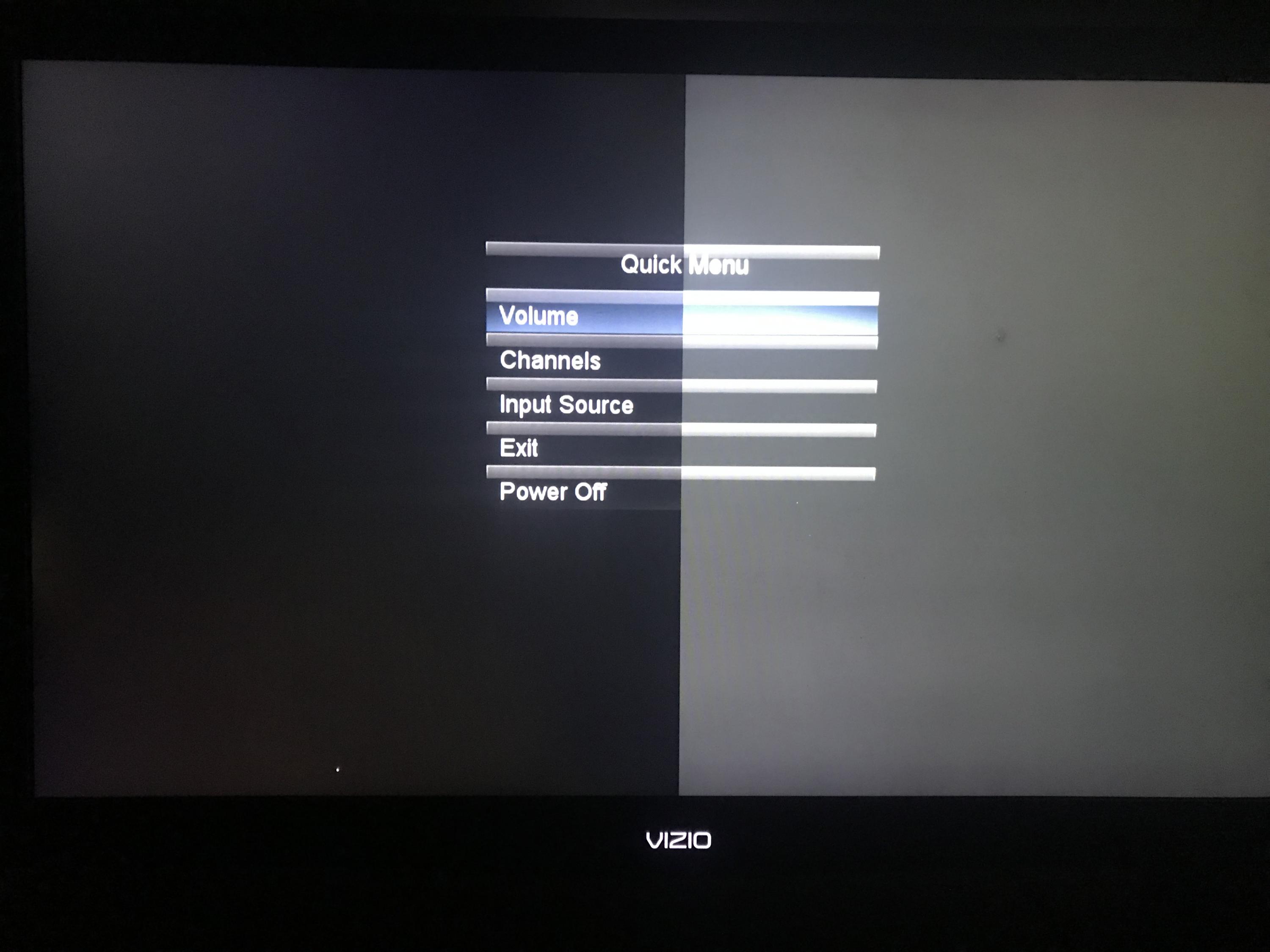

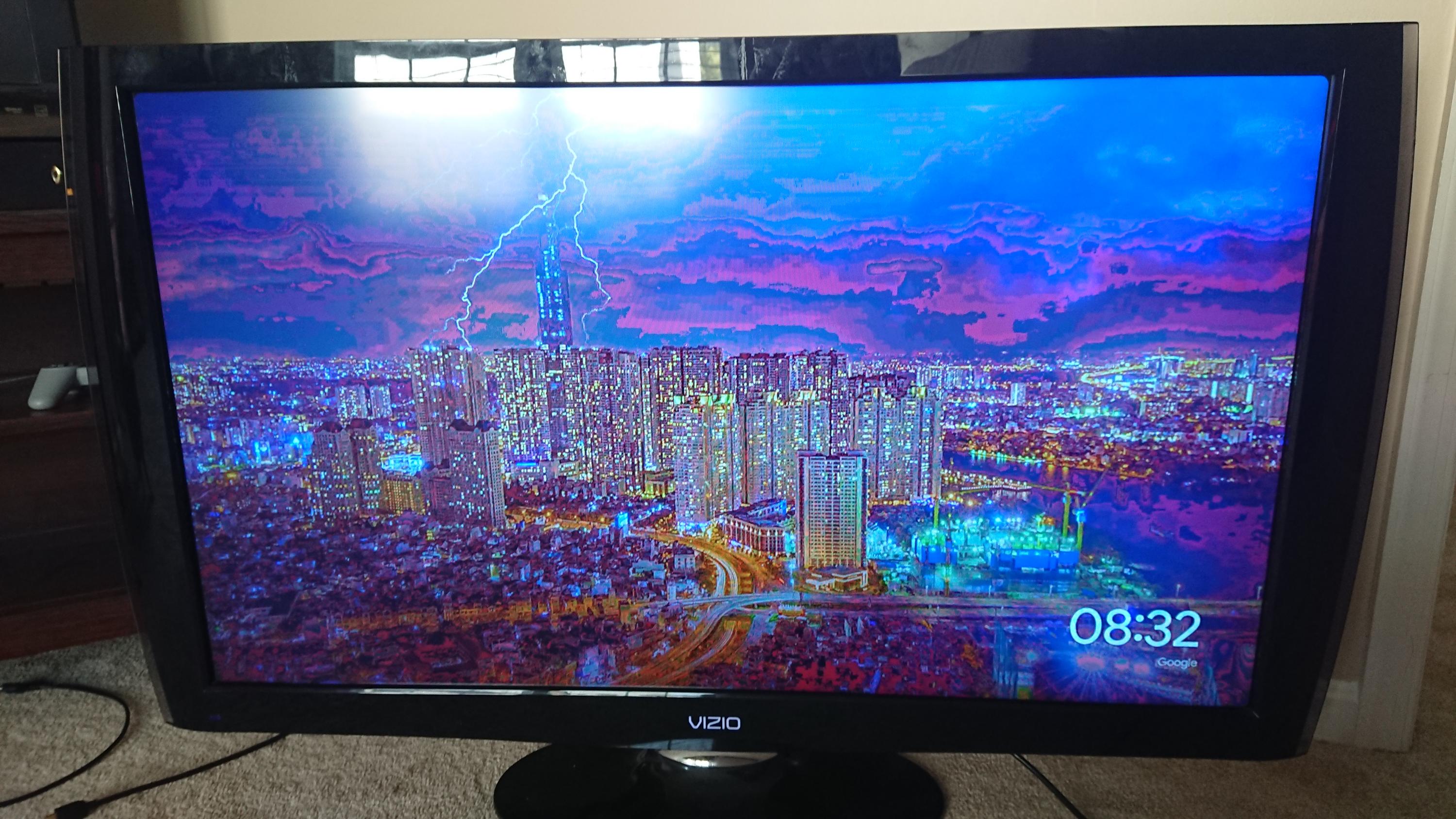

                        Hi, I'm new to this forum but I've been lurking for a while. I just got a replacement mainboard and I've attached images to show what's happening. The picture would flicker and it would seem to fix itself after a few minutes. It's not limited to HDMI. I would also randomly get HDMI no signal but eventually does come back. I'm starting to suspect that the main CPU is on its last legs and needs to be re-balled. Any idea what could be causing this? Any help would be greatly appreciated.
                            I fixed my Vizio M421VT that would have a symptom of pic scrambled, i heated the BGA with a Heat Gun both sides of the board, and added 2 fans 5 v dc on the back against the BGA and it's been good ever since.

                              Re: How to Fix your Vizio M470NV and M550NV
                              Quick update. I've noticed that this red/magenta "shimmer" and "HDMI No Signal" fixes itself after the TV has been on for sometime. My theory is that heat causes the soder balls to expand eventually bridging the spotty connections.
