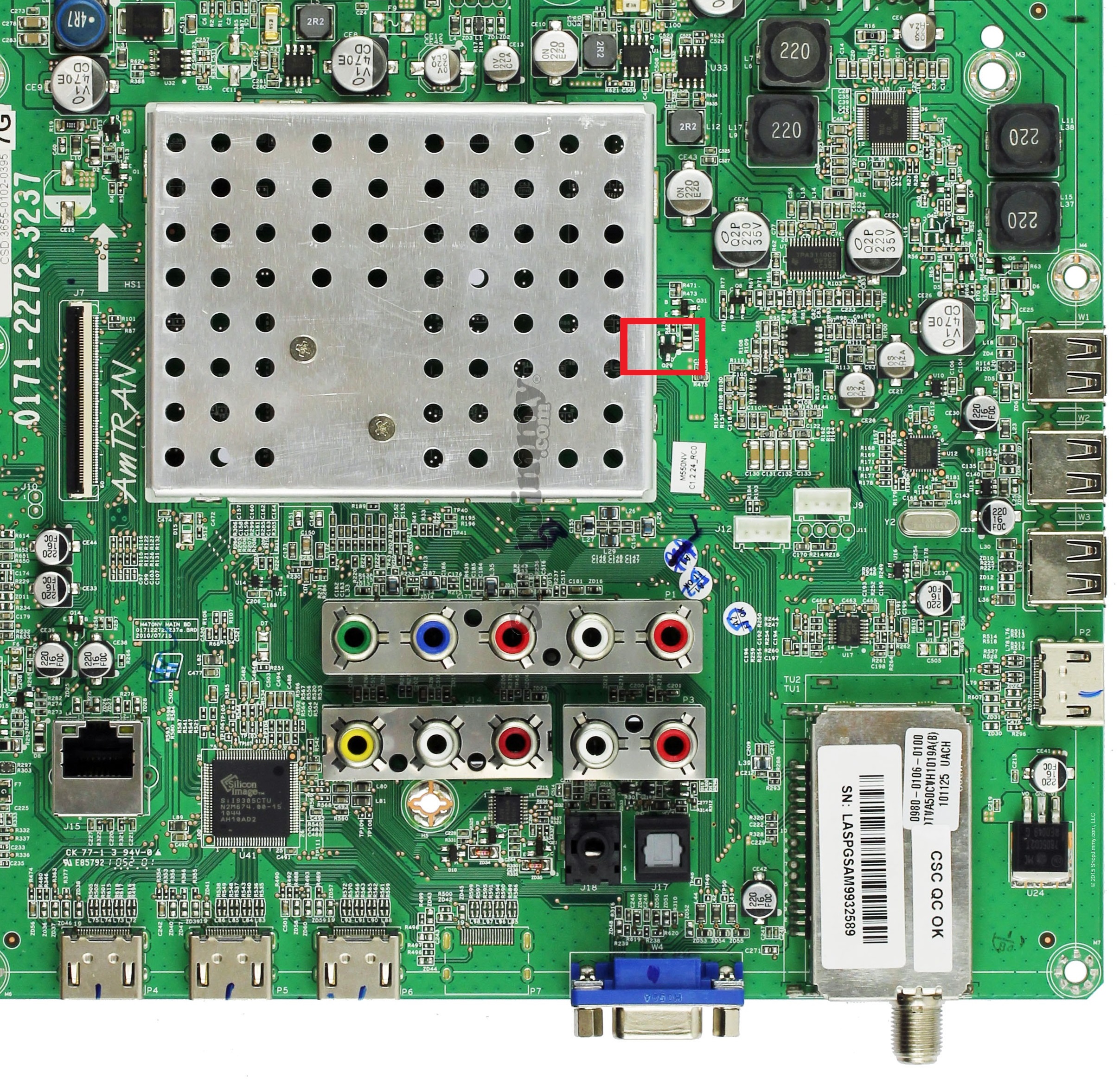

                        Has anyone found the transistor needed for repair option 1; Q29? I don't do too much transistor work or surface mount stuff, but do a fair amount of soldering in my hobbies and wanted to give this a try. Thanks!

                          Re: How to Fix your Vizio M470NV and M550NV
                          Jimmypooh
                          Per the original post,
                          "The Q29 transistor is located about 2 millimeters off to the right of the large heatsink. It is a very small three legged surface mount component."
                          I have attached a picture to display the exact location of the component.
                          Remember you must replace the Silicon image as well as the transistor located at location Q29

                            Sorry for the confusion. I was able to find it, I mean what transistor is that? i.e. where can I order one? Mine tested out with the specs you mentioned but your instructions suggest to replace anyway.
                            I'm going to give this a shot for some fun, but if I can't seem to get it working I'm planning on sending it your way if you're still doing these repairs.

                              Unfortunately, this is not a question I will be able to answer for you. We have had issues in the past with suppliers running out of stock on certain parts, and having to work very hard to find alternative ways of getting parts. Due to this, as a rule of thumb, we don't give away our sources anymore unless parts are plentiful from many sellers.
                              What I can suggest however is to have you just replace the silicon image and boot up the set. If the transistor is indeed faulty or has some sort of damage, you may see issues with the audio malfunctioning, or other various small problems, with boot up. You will not see any additional damage however from booting it up with a faulty transistor, especially if you are getting proper readings on it. I would suggest however testing it for an extended period of time before buttoning everything back up to ensure everything does indeed work properly.
