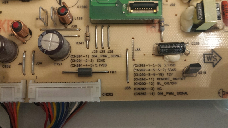

      I have a Vizio XVT373SV that suddenly developed a problem. The organge standby light is on and the TV turns on. Once it turns on, all I get is a "No Signal" on the screen and none of the outputs are working - HDMI, Composite, etc. The TV menu screen works and allows me to switch between inputs.
      With the TV turned on, I checked the power supply connector pins and get the correct voltages listed on the board for each pin - 5.1 for pins 1-3 and 12 volts for pins 8-10. When I turn the TV off, I get 5.1 on standby pins 1-3 and 0 volts on all other pins on the board. The power board is a Delta DPS 143AP-1.
      My symptoms seem to fit your list of signs of a bad main board. Do you think it's tha main board?

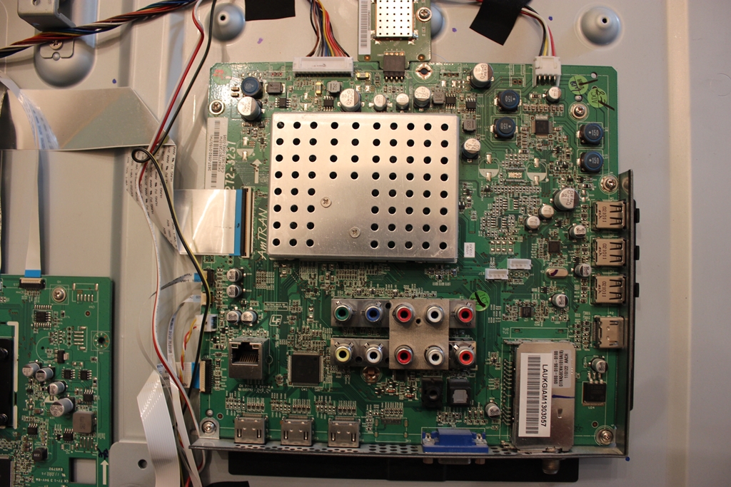

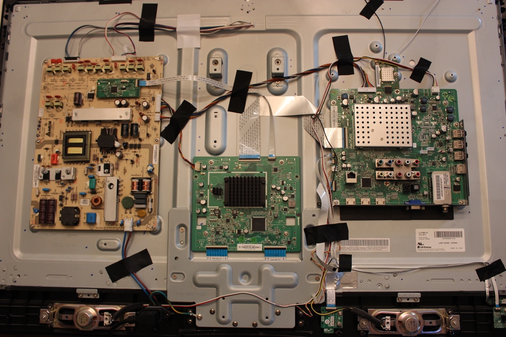

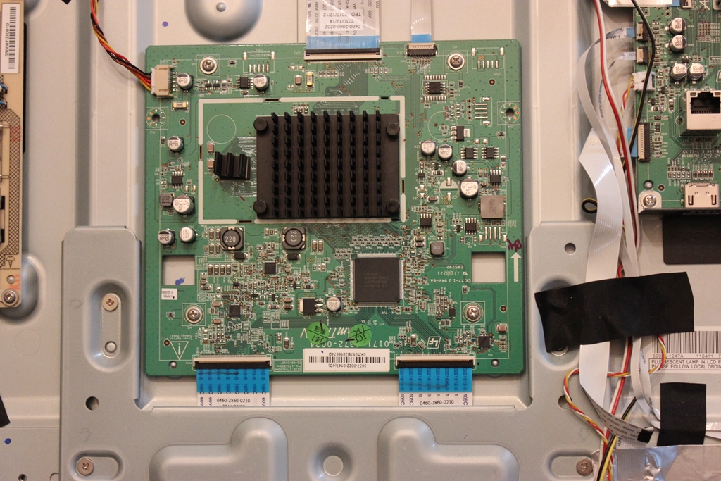

                          Still getting a "No Signal" message when I turn the TV on. Have tried all the suggestions above. Here are pictures of my Vizio boards. Nothing really stands out as being bad.
                          If I can see the "No Signal" message, the menu screen and the app icons, does that mean my T-con board is OK? If not, how do I test votages going from the main board to the T-con board? Should I remove the ribbon coming from the main board to the T-con where it connects to the T-con board?
                          I'm pretty sure the problem is my main board but want to make sure something didn't cause the main board to go bad. Have found a new main board for $90.

                                  What are the first 12 numbers on the white sticker on your mainboard? might start with 3647xxxxx

                                      Main board numbers are 3637-0592-0150. Here is a link to a new board on E-Bay - https://www.ebay.com/itm/292950340212
