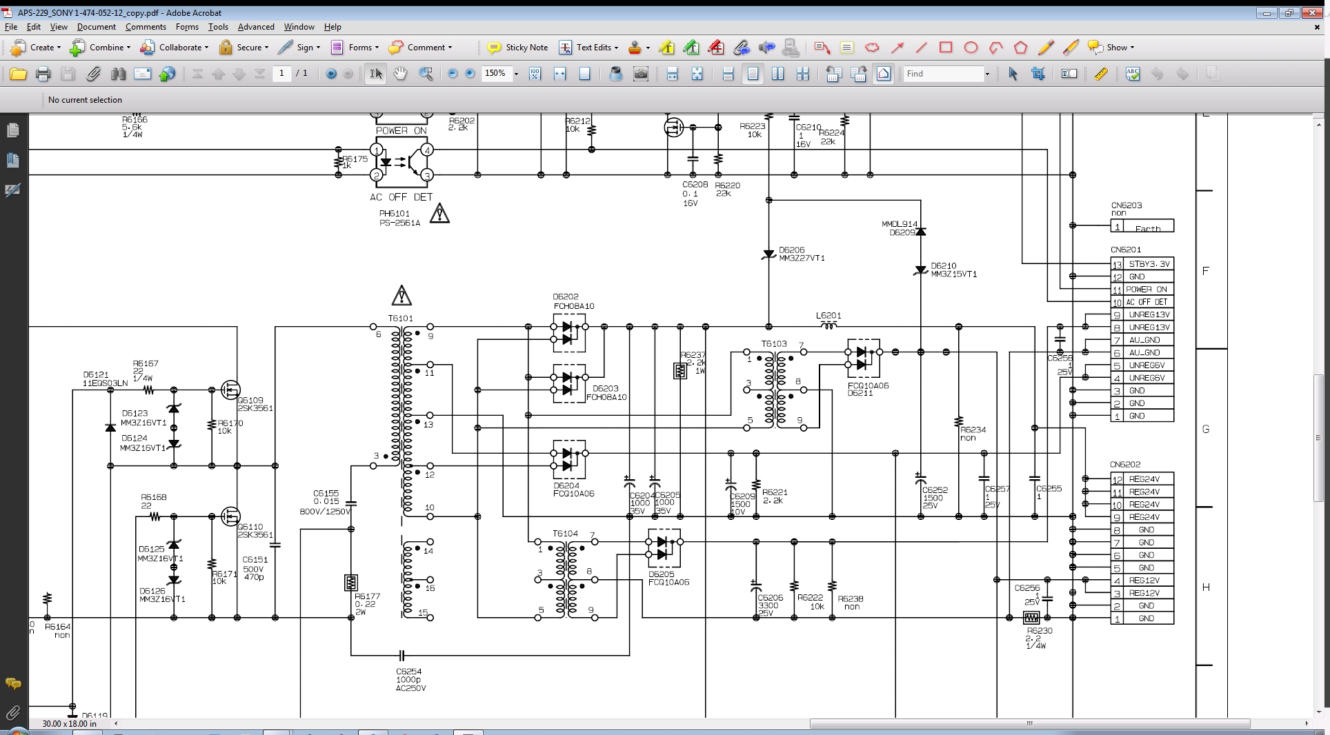

                    shematic

                      Analysis of the problem
                      It seems like the 12V should be coming from the power supply though. Given that, I don't understand how we'd be seeing the exact same problem on the replacement. Either something's up on the mainboard or the replacement power supply was afflicted by the same issue as the original. I'll get in contact with the eBay seller to see if we can find out any more information about its origins.
                        #31
                        Re: Sony KDL-32S3000 LCD 2 Blinks Error code
                        Based on the schematic provided, the REG12V is generated by the transformer T6103, D6211,C6252.
                        The primary of T6103 is driven by the secondary winding of the transformer T6101 which generates the 24V, UNREG6V.
                        Transformer T6104 for the UNREG13V uses the same topology, so inspect those parts in the UNREG12V section.
                        You do have 24V, right?

                          REG 24V regulated by the power supply?
                          REG 24V would be there for a brief moment upon power on before dropping off into the teens and slowly piddling away.
