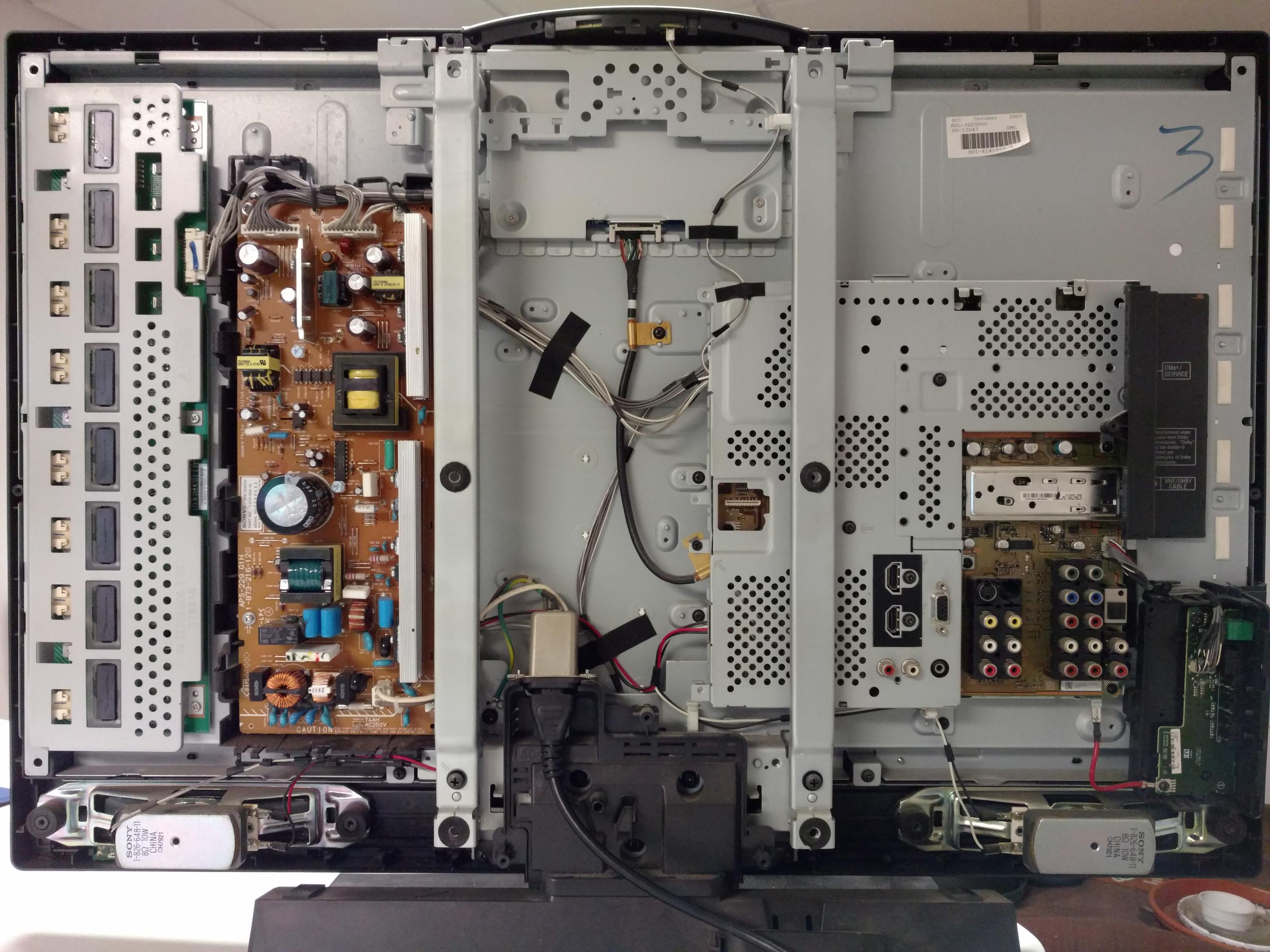

    I'm working on this Sony Bravia LCD and was wondering if anybody has any ideas as to how to figure out what the problem is. What happens is that when the power button is pressed, I hear the relay click and the power light comes on, but nothing happens for a few seconds. After that, the power light comes off and the "STANDBY" light blinks twice repeatedly. No backlight, no video at any time in the process.
    According to the service guide, two blinks indicates a "balancer error." Now, I'm not that familiar with Sony products, but I am familiar enough to know that, like Apple, they have their own proprietary names for things, so I guess the question is, what is the "balancer," first of all, and how can I diagnose it?
    In the only other thread that BadCaps has published on the issue, it was suggested by one person that this is likely to be a GH1 board. If "GH1" equals G1H, then that looks to be the power supply. Is the power supply the "balancer?"

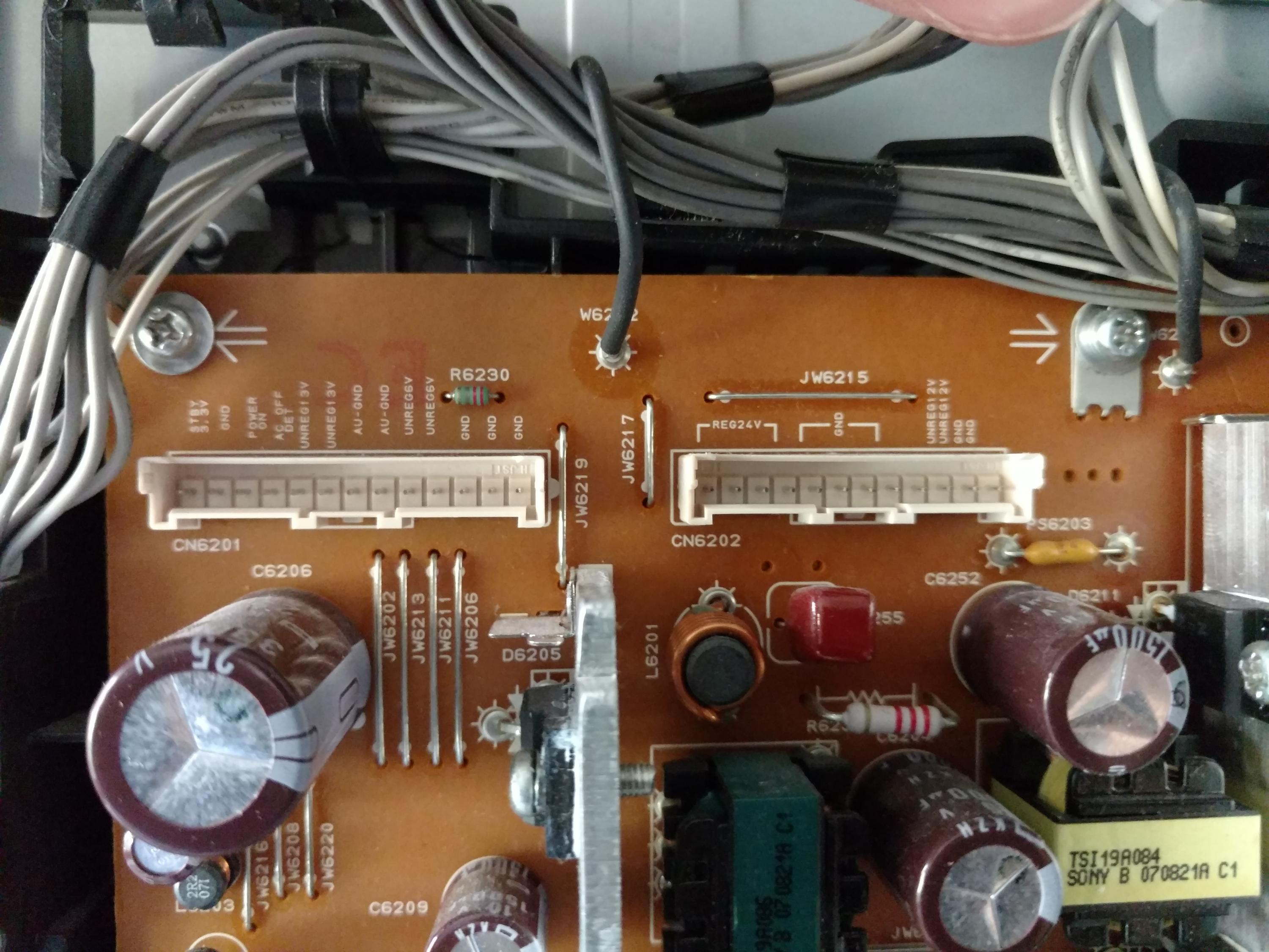

                  The power supply schematic attached.
                  • SurrealMustard
                    • Jan 2015
                    • 487
                    • The United States of America
                    Inverter Fuzes test good
                    I would lift the cover from the inverter board and check that none of the fuses have blown.
                    I tested all three of the fuses that I could find and they all checked out.
                    Is that the same one as in the service guide?

                          Troubleshooting differential
                          Originally posted by dskall
                          Balancer may have to do with inverter/backlights
                          Under the "Meaning/Related" fault for a balancer error, it says "Balancer error/PANEL_DET (PMUX6.7) to low level, between 2.48V and 0.83V." I searched the rest of the manual for PANEL_DET, but didn't find much except for some tiny references to it on the schematics. What exactly does PANEL_DET (defined as "panel detect" in some literature online) do?
                          could be the mainboard too not sending the voltages to the inverter board i wonder if you can force on the psu and check all voltages are correct is there any writing on the underside of the psu by the connectors to tell us what each pin does etc
                          There's writing on the topside actually. Only for the connectors on the power supply though.
                          Originally posted by Andrew F. Ali
                          Disconnect the cable from the PSU to the Inverter bd and power-up the TV. If it is the Inverter Bd that was causing the problem then the 24V should remain on and the ' 2-blink' should stop also, confirming the Inverter Bd as faulty.
                          Same two blinks when powering up with the inverter power connection unplugged.

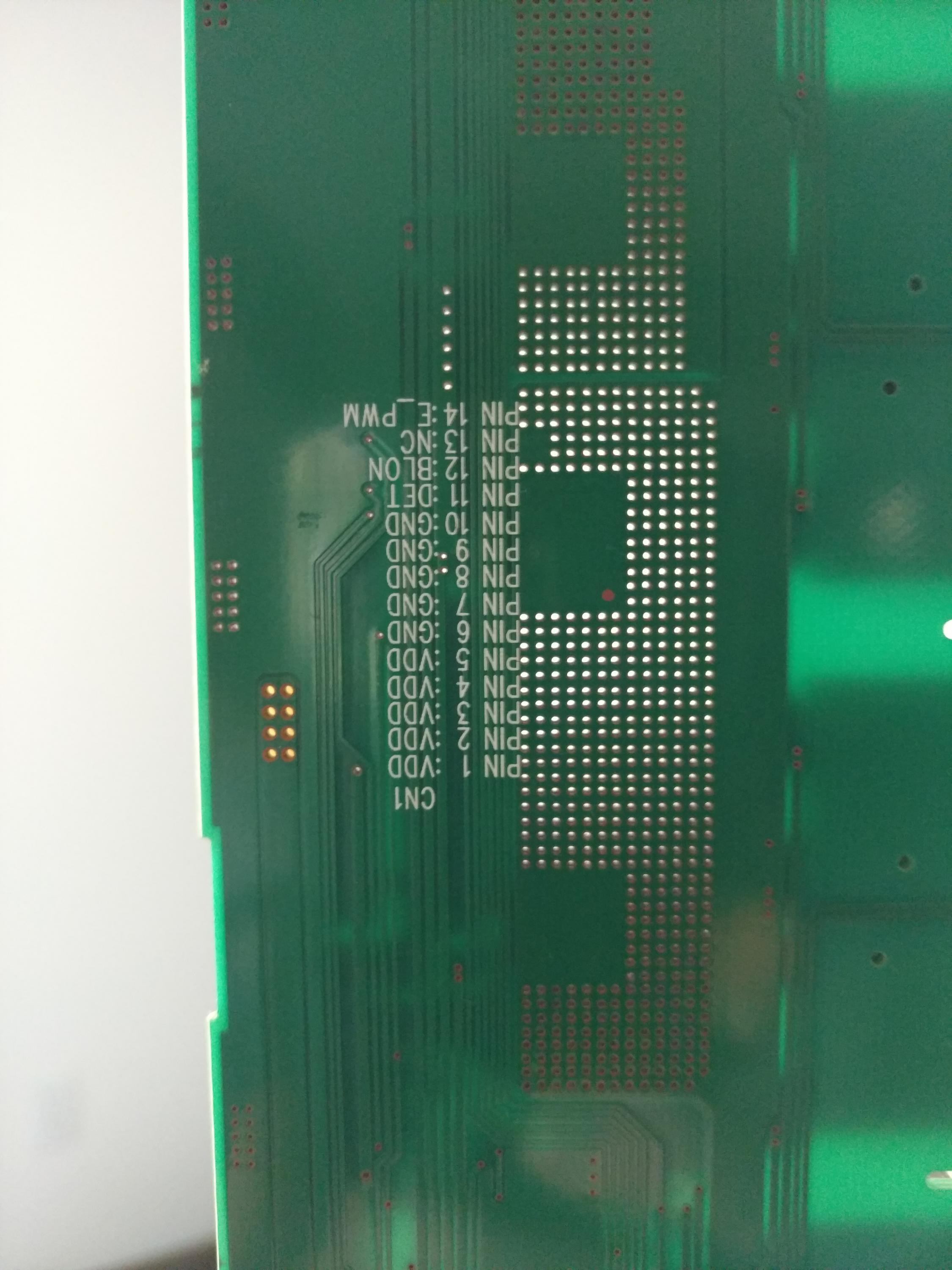

                            on the invertor board by the mainboard connector is there any writing?

                                Re: Inverter Fuzes test good
                                Your power supply is marked as APS-229 G1H and I believe that it is the correct schematic for your power supply. Compare the schematic against your board to be certain.

                                  hidden pinout
                                  As a matter of fact, there is a pinout on the back of the inverter near the connector. Would the "DET" on there possibly be related to the "PANEL_DET" cited by the service guide?

                                      Re: Sony KDL-32S3000 LCD 2 Blinks Error code
                                      Your TV is WAX3 chassis, not SE1A chassis.
                                      See training manual about 2-blink code page 22, 30.
