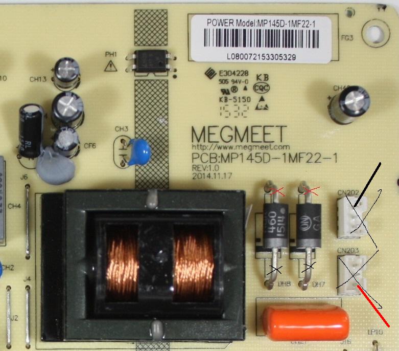

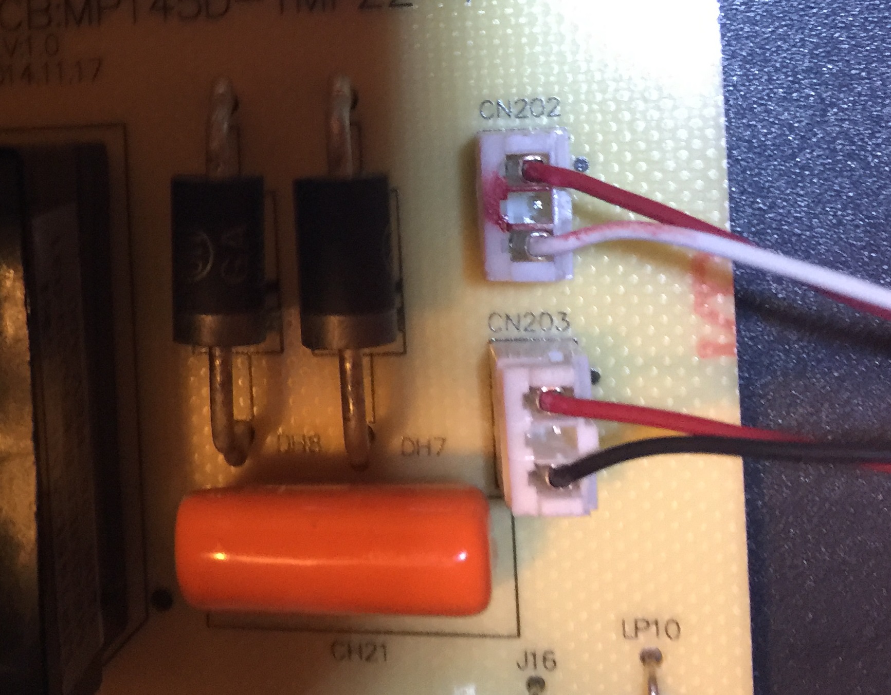

    I was just given this set, I've looked at many posts and videos that point towards the leds going bad on this set. I've tested the boards and the leads going to the leds and get high voltage at them (287 at red/black lines in pic attached). According to this post sounds like that means an open circuit and the leds should be tested?

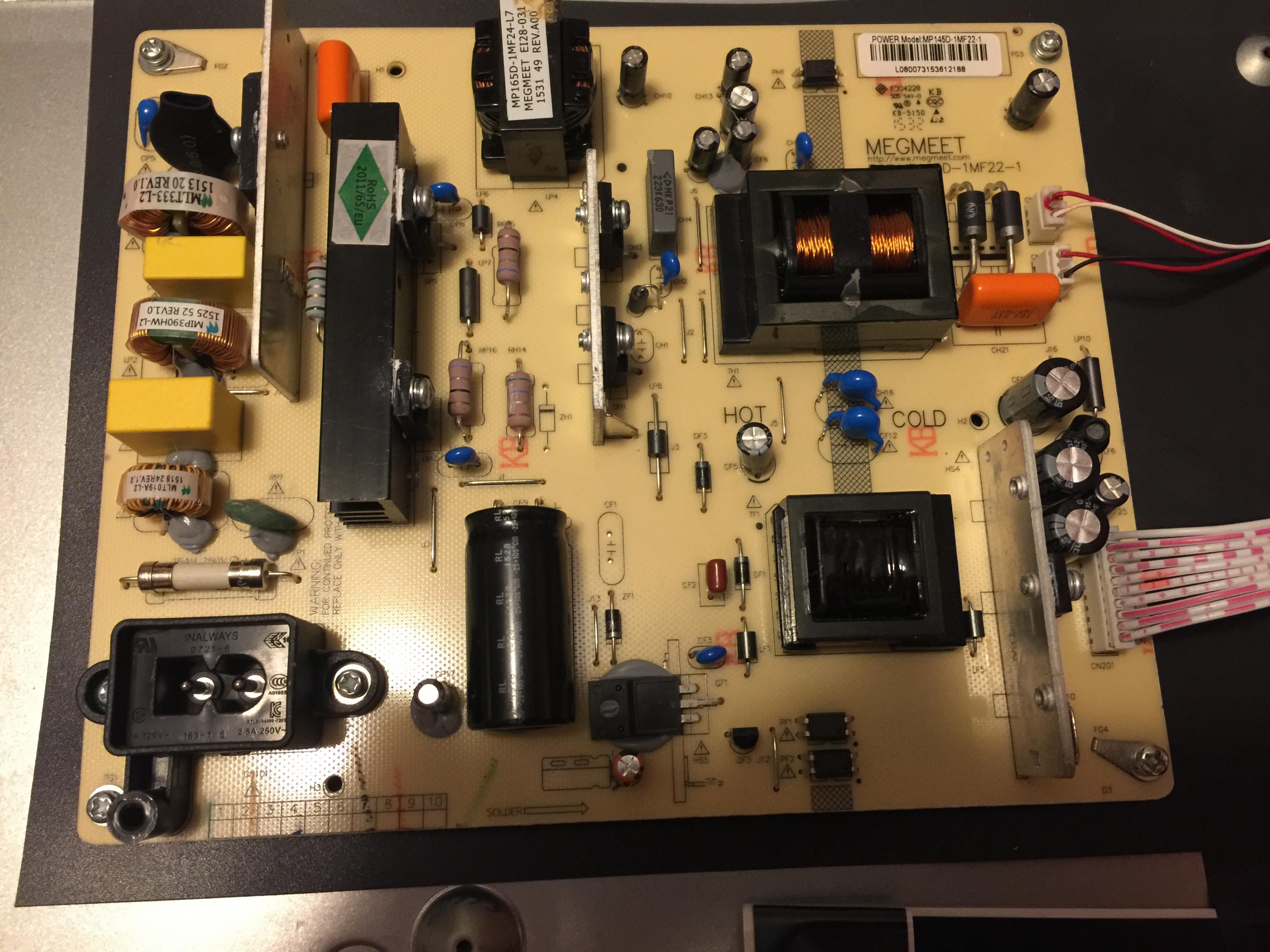

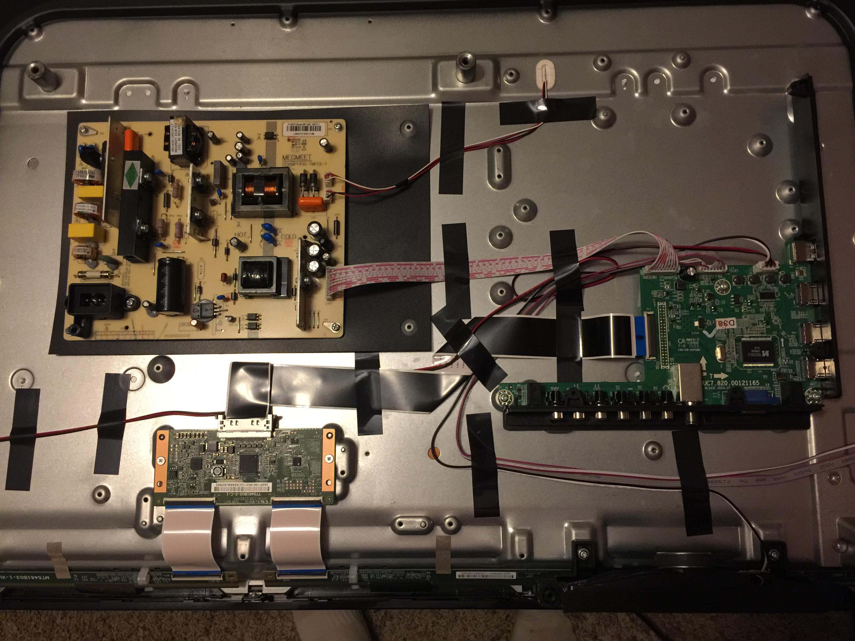

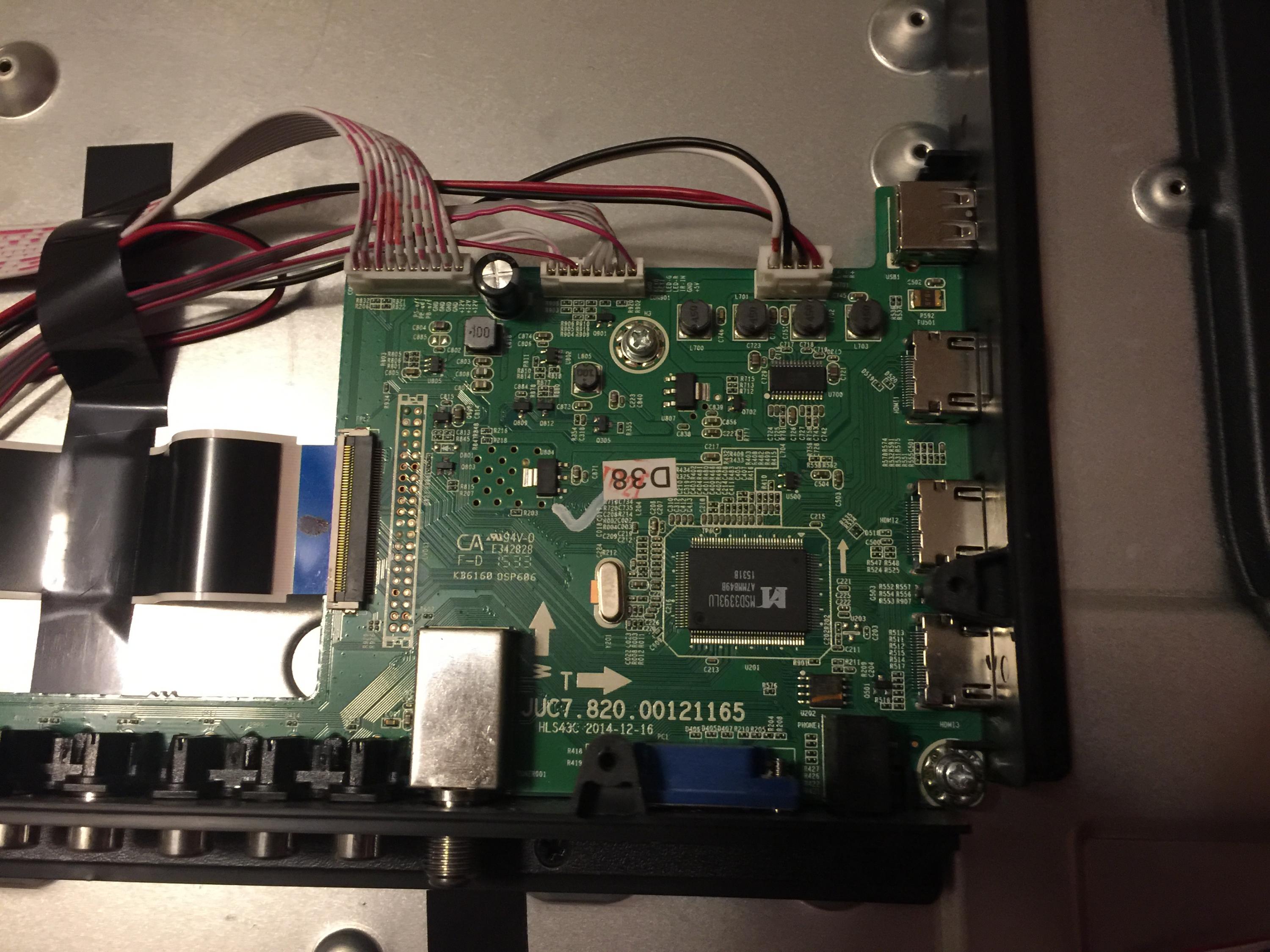

        Re: Hitachi LE55A6R9A confirm bad LEDs
        Have you disconnected the main board and then powered up to see if the backlights come on.
        Do you have a photo of your circuit boards?
        • jason424
          • Dec 2015
          • 187
          If I disconnect the main board I got nothing. No power led or anything since it looks like it's integrated into the main. Pics attached.

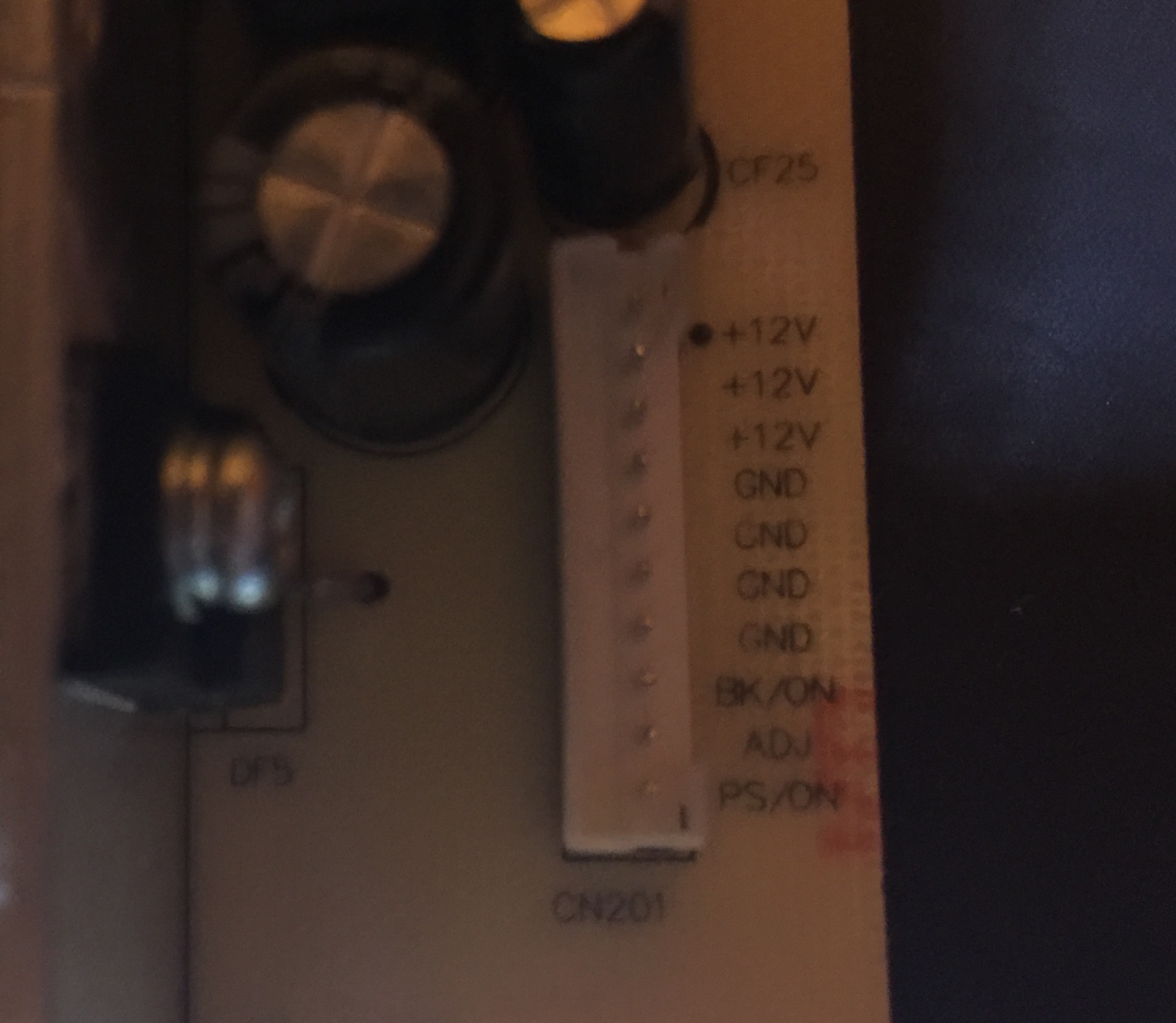

            Behind CN201 you have legends along side the pins. What voltages do you have on each pin.
            Pin number.......Pin Name...... Pin voltage
            etc

              Need voltages from connector that goes from power supply board to main board. Will need pin#- PIN DESCRIPTION -Pin voltage in standby-Pin voltage when pushing power button and picture of connector on power supply board.
              Format:
              Pin# - Pin Description - Pin Voltage standby - Pin voltage power on
              1 - XXXXXXX - XXv - XXXv
              2 - XXXXXXX - XXXv - XXXv
              3 - XXXXXXX - XXXv - XXXv
              4 - etc.

                CN201:
                12v: 12.2
                12v: 12.2
                12v: 12.2
                GND: 0
                GND: 0
                GND: 0
                GND: 0
                BK/ON: 3.2
                ADJ: 3.1
                PS/ON: 3.2
                EDIT: Pic attached of desc/table

                  CN202:
                  268
                  187
                  CN203:
                  187
                  0.00
                  When testing CN202(red) and CN203(black) I get 287 as outlined in the first post.

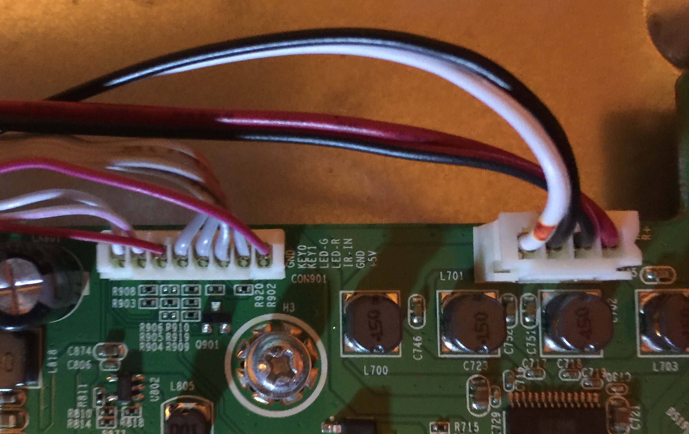

                    con901:
                    gnd: 0
                    key0: 3.3
                    key1: 3.3
                    led-g: 3.0
                    led-r: .1
                    ir-in: 5.2
                    gnd: 0
                    5v: 5.2

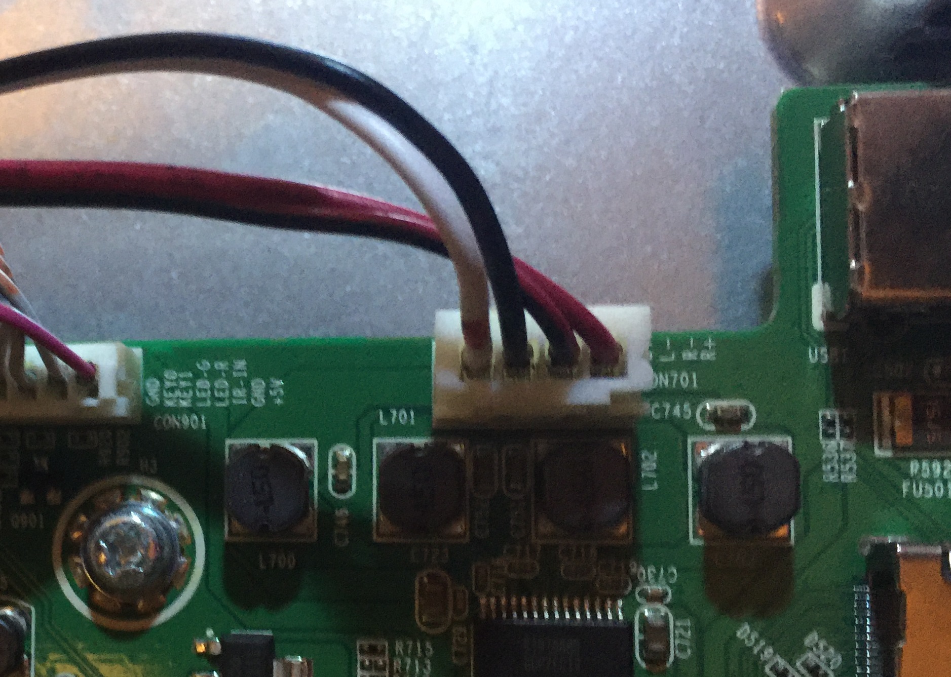

                    • jason424
                      • Dec 2015
                      • 187
                      con701:
                      l+: .2
                      l-: .2
                      r-: .2
                      r+: .2
                        Confirmed....Bad LED backlights.
