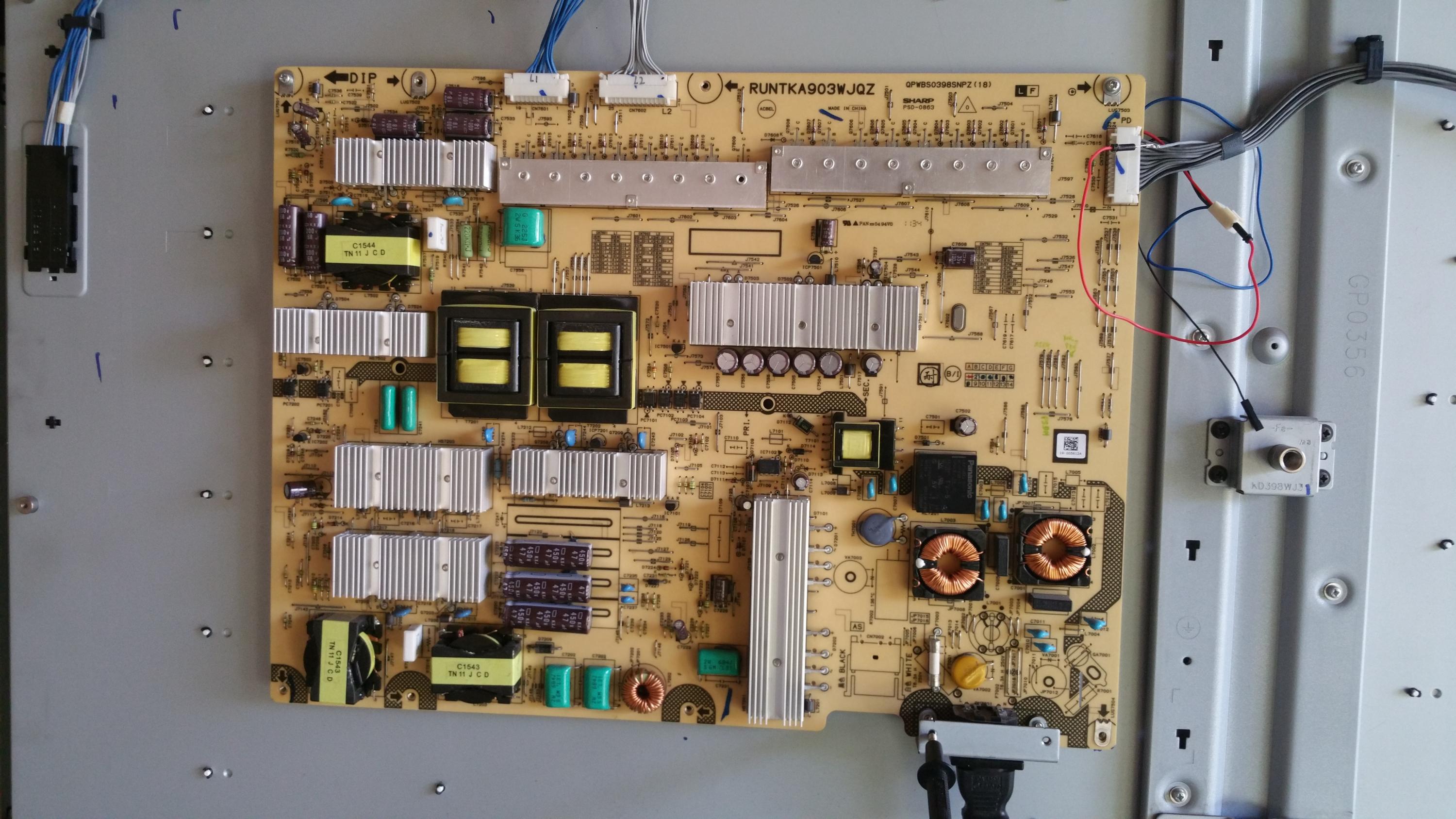

    Hi I am new here, I would like to get help, how to fix this Power Drive for Sharp TV LC-80LE632U
    The PS board is RUNTKA903WJQZ The error is 2 long flash and 3 short flash .
    The TV was fine last week until a I installed chromecast 1st genreration and still working for 1 day, I change the power source for Chromecast from external ac adapter to TV USB as I don't want the chromecast keep running as the TV off, I rarely use this TV since I purchased 5yrs ago. The day after I move the power source of Chromecast I turned on the TV, I found the error.
    I have tried all reset combination I read from the thread but no go,
    for couple days I have read many threads from this forum.
    https://www.badcaps.net/forum/showth...ht=lc-80LE632U
    https://www.badcaps.net/forum/showth...rp+lc-70le732u
    I want to try fix the TV as I already replaced with new Main board, as first thought I had overloaded the Mainboard and somehow spike happened. but still have same error.
    with this Picture below
    I tried to limit PS issue as I have tested , it doesn't have 12V the only pin have voltage is Bus5V
    I have soldered some cable jumper to pin PS_On and PNL_PWR and STBY and also Bus5V to make easier on testing.
    And basically I just want to make sure the problem came from Power Supply, and I tried to force to turned on the Power supply by jumper PS_On with bus 5V with 1K resistor (I read from BudM's post), after I pulled the PS_On wire on connector that came from Main board ===> same result (no voltage on other pin)
    I have 3.0 V on that cable came from main board. (so I assumed the MB sent signal to turned on the PS).
    but the blink is not come out if the PS_On wire is disconnected but as soon as I I connected via jumper the voltage become 0V. on PS_on.
    With my little knowledge in electronic, I am begging any favor from this forum, how to test further and the logic to make sure that the problem from PS and possible to be fixed not the bigger parts.

    So with the main board disconnected, when PS_ON is taken to 0V do all the voltages on the power supply voltages come up.

          Thank you all for respond, I did reset with Vol Up and Chnl Dn combination nothing change.
          all pin on CN7501 is 0V except the Bus5v is 5V.
          I took off the Power Supply for bench test, I have external regulator 5V to 3.3 V (from my old arduino project) and get the power 5V from Bus5V pin as input and connect the output to Pin PS_ON now I probe the CN 7501 pin with the result below
          1:PNL_12V ==>0V
          2: PNL_12V==>0V
          3 : GND
          4 : GND
          5 : UR13V==>0V
          6 : UR13V==>0V
          7 : UR13V==>0V
          8 : UR13V==>0V
          9 : GND
          10 : GND
          11 : GND
          12: GND
          13 : AC_DET ==>3.27V
          14 : PS_ON ==>3.3V
          15 : BU+5V ==>5V
          16 : PNL_POW ==>0V
          17 : VSYNC(GSP) ==>0V
          18: SCL==>0,2V
          19 : NC==>0V
          20: SDA==>0,2V
          21: OFL ==>0,03V
          22 : ERROR==>0,2V
          23: NC==>0V
          24 : STB==>0V
          I stated the main board sent the signal 3.3V to turn on the PS ( i took the wire out from the connector) and do the probe that it was stable on 3.3V and when I connected it drop to 0V , I assumed there is protection on Mainboard to cancel the PS_on signal once error detected. Correct me if I made wrong assumption. Could I get help to trace why the 12V and 13V is not detected, and also I had connected the PNL_PWR with 3,3V external regulator parallel with PS_ON still same result.

                  Post #5. I believe you also need to take STB to +5V via a 1K resistor and check your voltages again.

                      Take STB with 5V via 1K resistor same result.
                      PS_On with external regulator(5V->3.3V) from Bus5V
                      PNL_PWR aslso with external regulator(5V->3.3V) from Bus5V
                      0 Volltage on either 12V or 13V pin

                        I ordered PS from ebay and just arrived today and install on the TV it is just simple working!! with old mainboard
                        it seems the 2 Long and 3 short flash error came from Power supply, I read one thread have same error he just changed the Mainboard to make TV working.
                        Now I have a non working PS It need to be fixed for spare and a working Main board but with 1 long and 1 short flashes, bypass the error with Ch Dn and Vol up the TV working , I could't enter to service menu to reset the error from the previous owner already have in this board.
