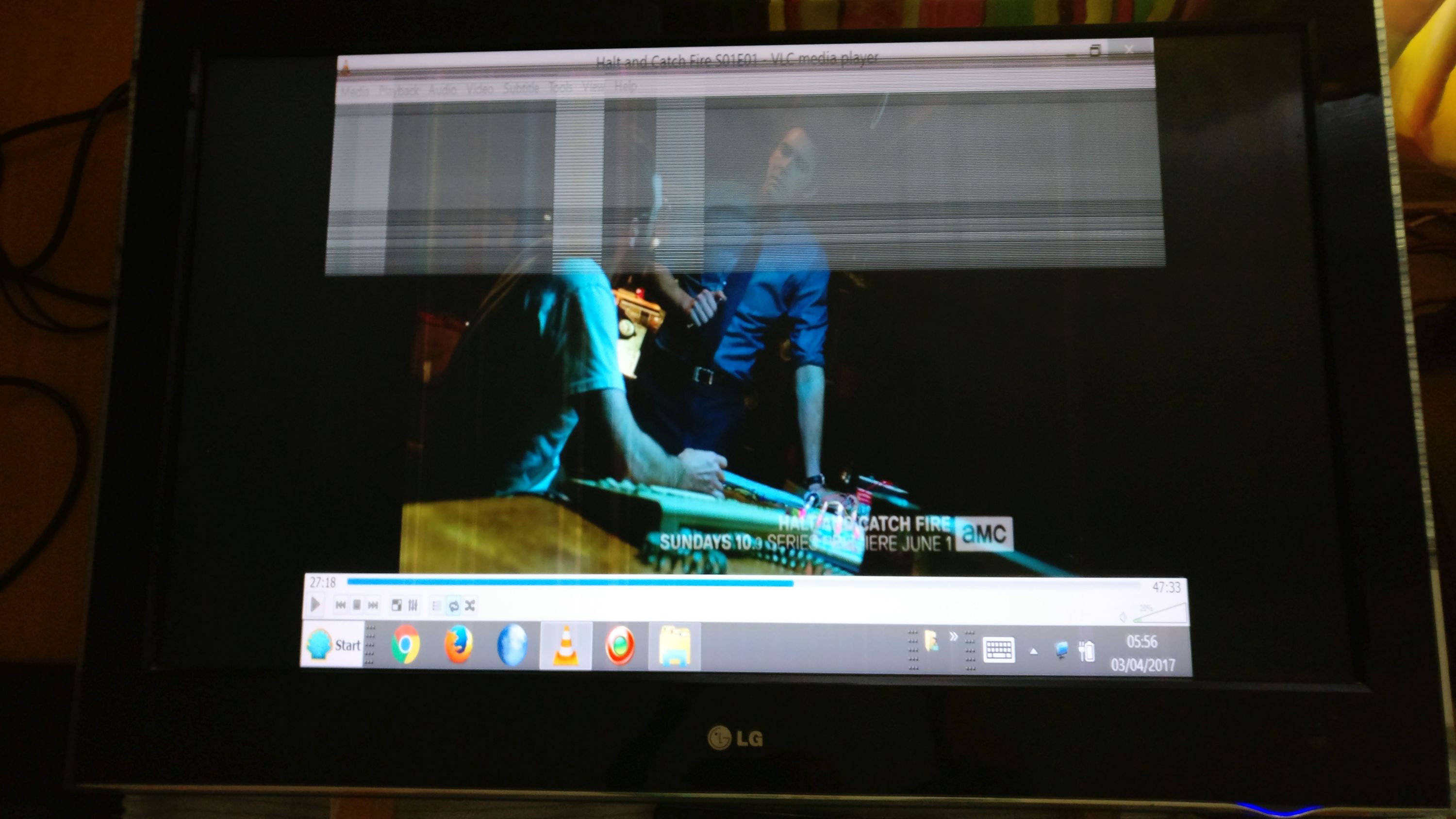

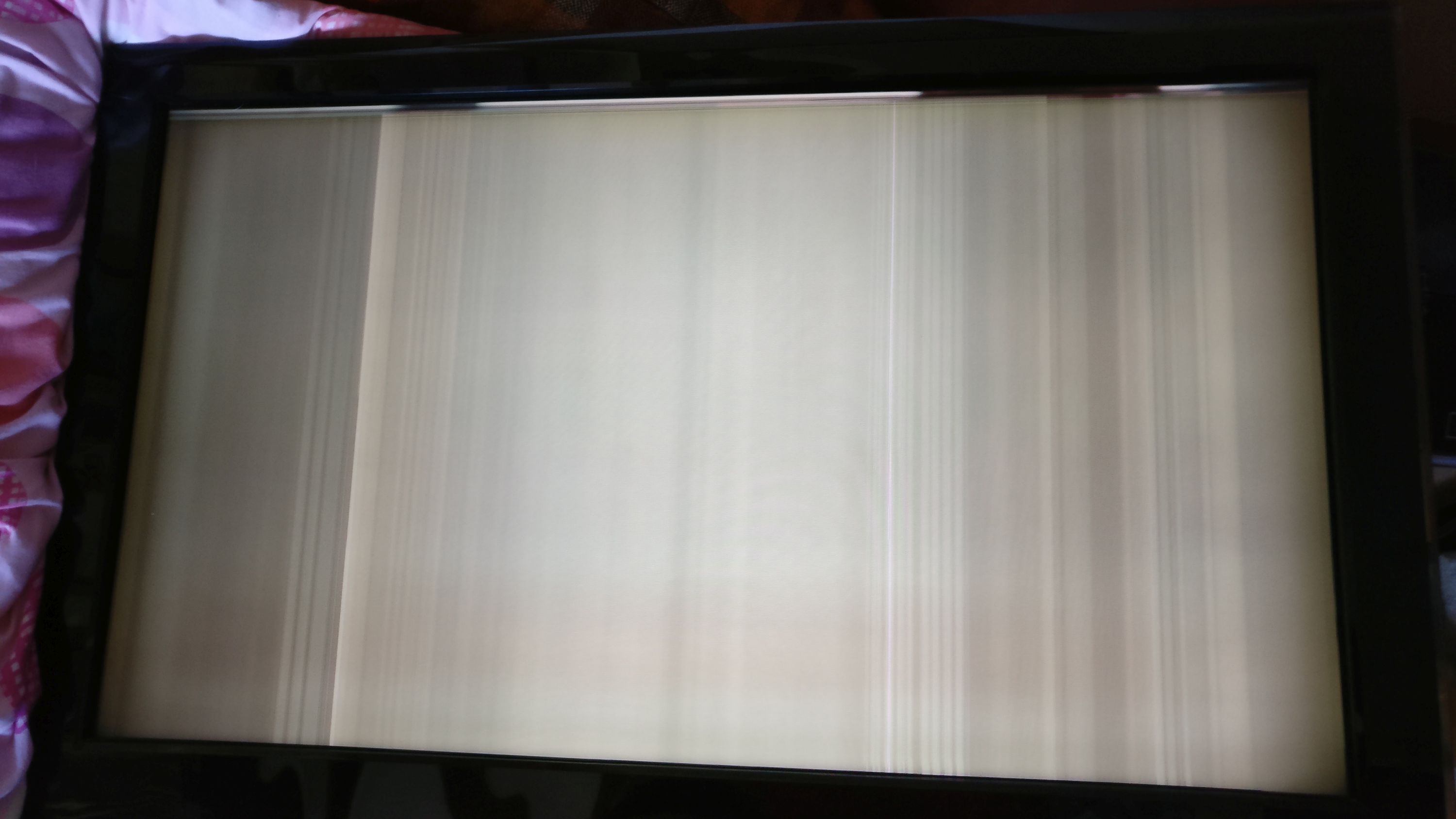

    I have a LG 37LH5000 TV Slow to start (20 minutes), then vertical bars only on display. Sometimes grey scale, sometimes color.
    After 45 minutes about 1 cm horizontal band of picture at top of screen.
    After 1 hr picture gradually forms from bottom up, slowly "raising" a horizontal shutter-like curtain of lines.
    After 90 minutes this leaves a complete picture, with a slight horizontal flicker about 2cm down from the top.
    After 2 hrs, clear solid picture no flicker.

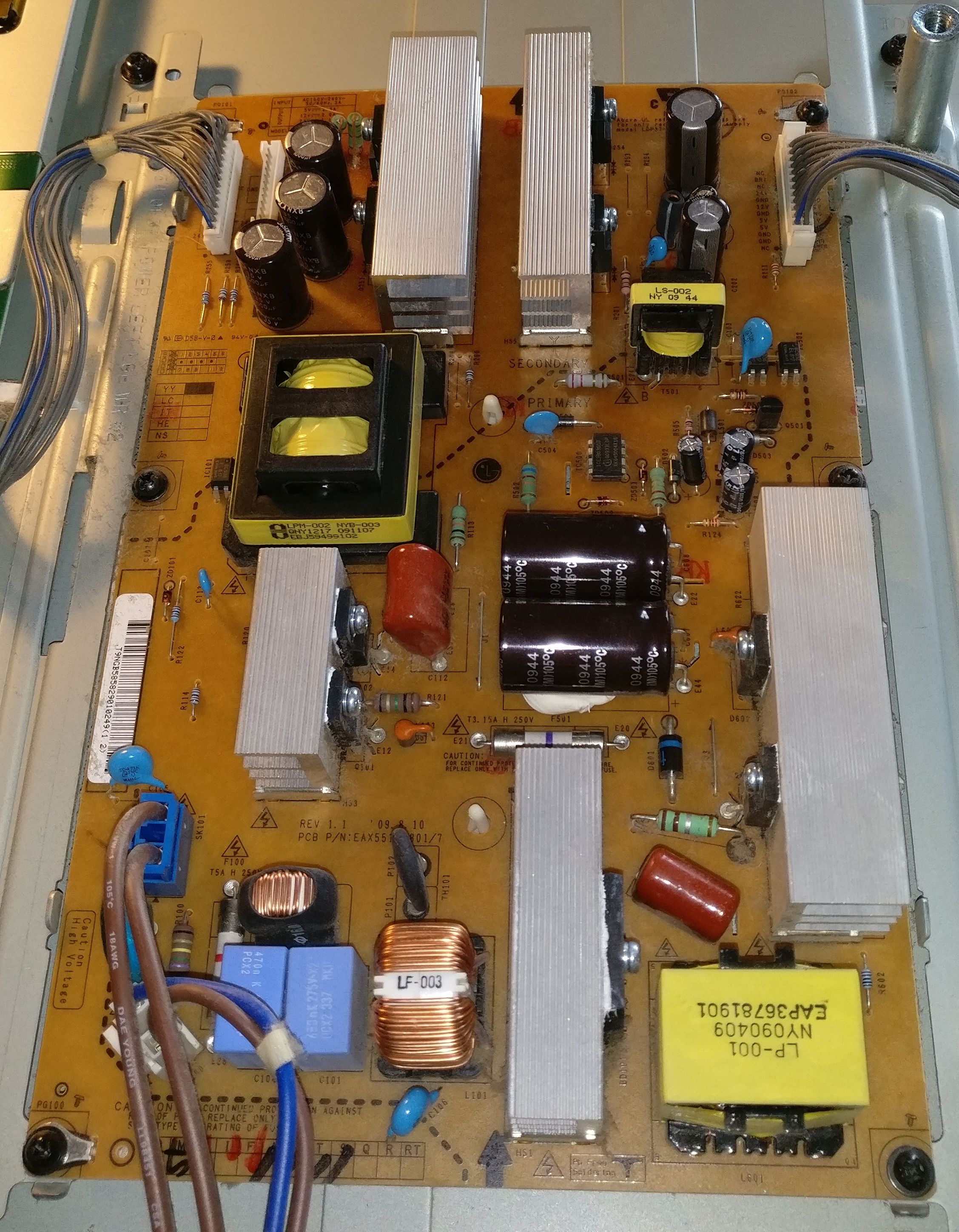

    From what I've read so far, this seems like a power supply problem, possibly requiring capacitor replacement. The job will be a first for me, though I see there are lots of tutorials available.
    I've included pics in the hope of some words of advice.
    Plus, do the screws that need to be removed to take off the back cover all have an arrow symbol pointing at them? There does seem to be a lot of those. Or is it just the screws around the outside edge that need to be removed?

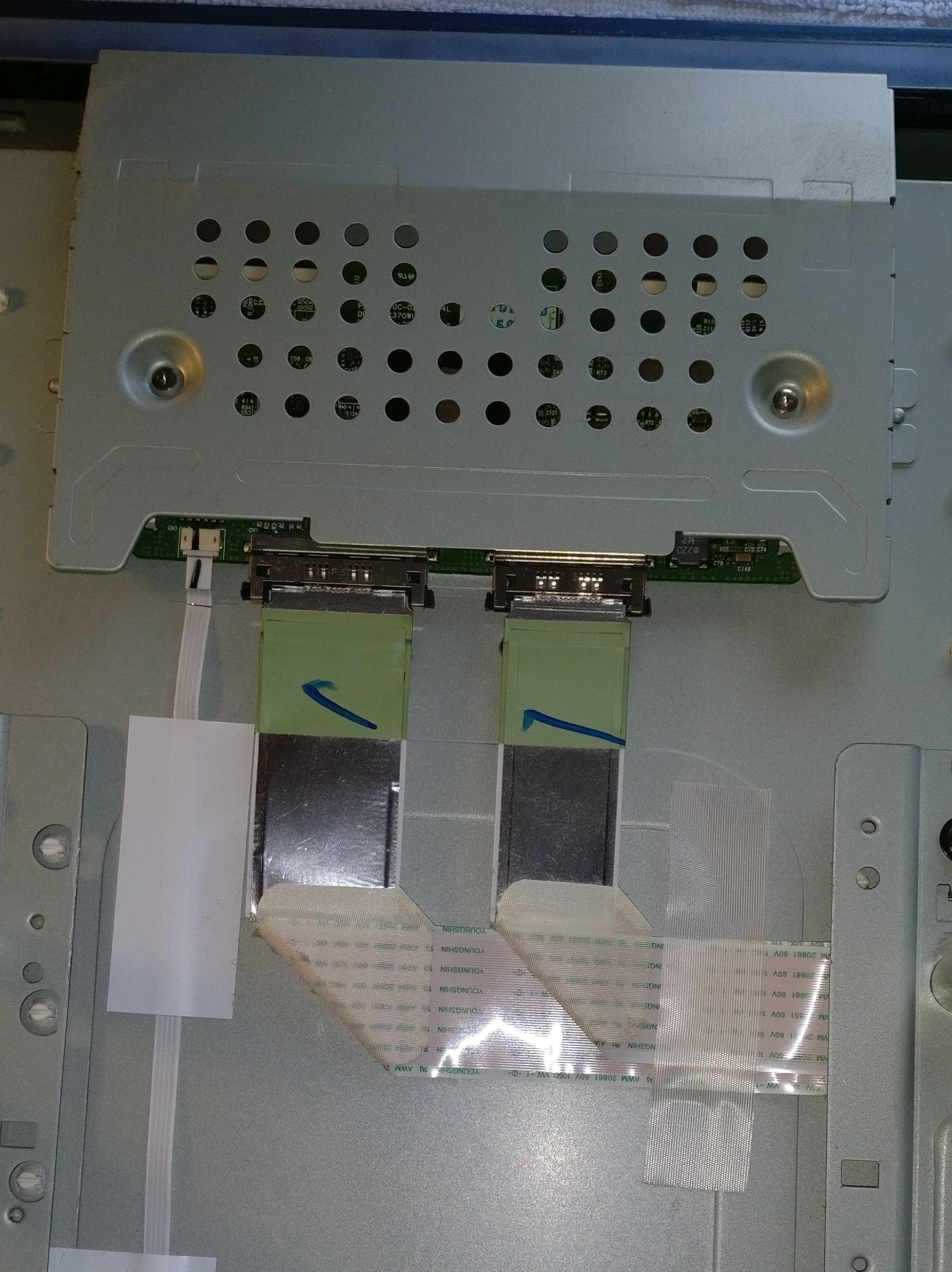

    Switch off set, disconnect one ribbon cable from the tcon to the panel, power up, press menu and take photo of screen and then power off and reconnect ribbon and remove second ribbon to panel and repeat as above.
    Remove the ribbons carefully lifting up the connector tabs so as not to damage the ribbons or connector. Replace the ribbons carefully before pushing closed the connector tabs.
    There are a lot of screws. Just remember if they are different sizes where they go. Pencil and paper is useful.
    Once the back is off, clear sharp well focused photo's would also be useful.

      Yes lots of screws to remove. Look for any bulging caps. Sounds like a capacitor problem.

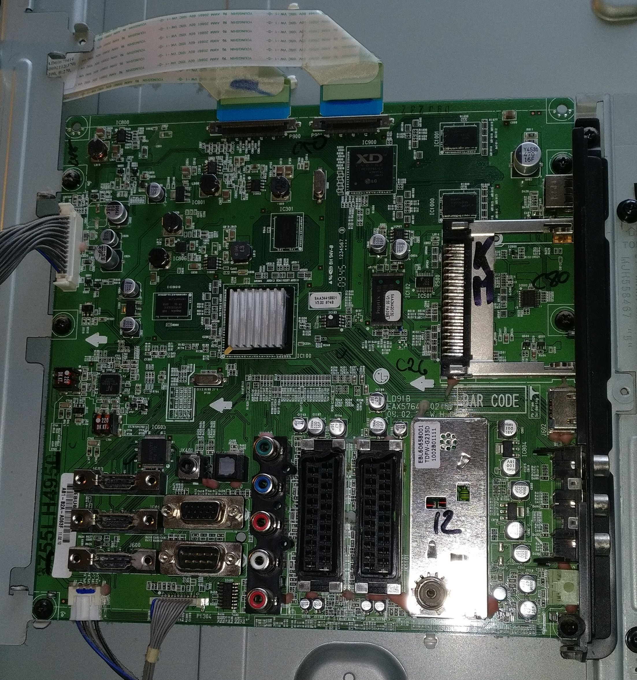

          The attached photos show the capacitors on the power supply "looking" healthy. Maybe one has a minutely raised top but that may be wishful thinking by me.
          I'm a bit disappointed not to be seeing bulging capacitors here. It might've made things a bit simpler.
          I need to do some more reading on the subject. Before I go further into dismantling, I'd like to know for sure what the significance is of the picture on the display coming into a perfect state after 90 minutes and staying that way until shutdown.
          I've seen that power supply board and tcon faults both produce the vertical lines on screen. But does the picture coming and staying good after a warm up period indicate more strongly one or the other possibility?

              Well fortunately or unfortunately depending on your point of view. Bad caps aren't is prevalent as they used to be. So opening a set up looking for bulging caps for a cheap easy fix is not what it used to be. The good news in your case is yours maybe heat related so heating/cooling should narrow down bad component.

                  Try heating power board with hair dryer to see if problem clears up.

                      Tried the hairdryer heating test on the power board.
                      It didn't seem to have any effect in the short term.
                      I didn't wait the full 90 minutes for results, nor the 20 initial minutes previously needed for anything at all to show on the display, mainly because I was holding the display upright on the table without a stand or back, to do the check.
                      Do you think I should set things up to wait the full 90 minutes, to see if there's any reduction at all in the time it takes for an acceptable display after heating the board?
                      Or does the fact that the initial effect of heating the power board is no different indicate that I need to look elsewhere?

                        What are the part numbers as written on the IC's. Can you give the IC board number IC801, ICxxx (can't read it) and the dc voltage on pins 1, 2, & 3
                              The IC board numbers are IC801 & IC803
                              IC801 part number: 1190A 17-33
                              1C803 part number: 1190E 17-18
                              Both these part numbers begin with a "C" in reverse character.
                              I'll give the voltages as soon as I can get them measured.

                                They are both voltage regulators and IC801 should have 3.3V output and IC803 should have 1.8V output. You need the set switched on and out of standby.
