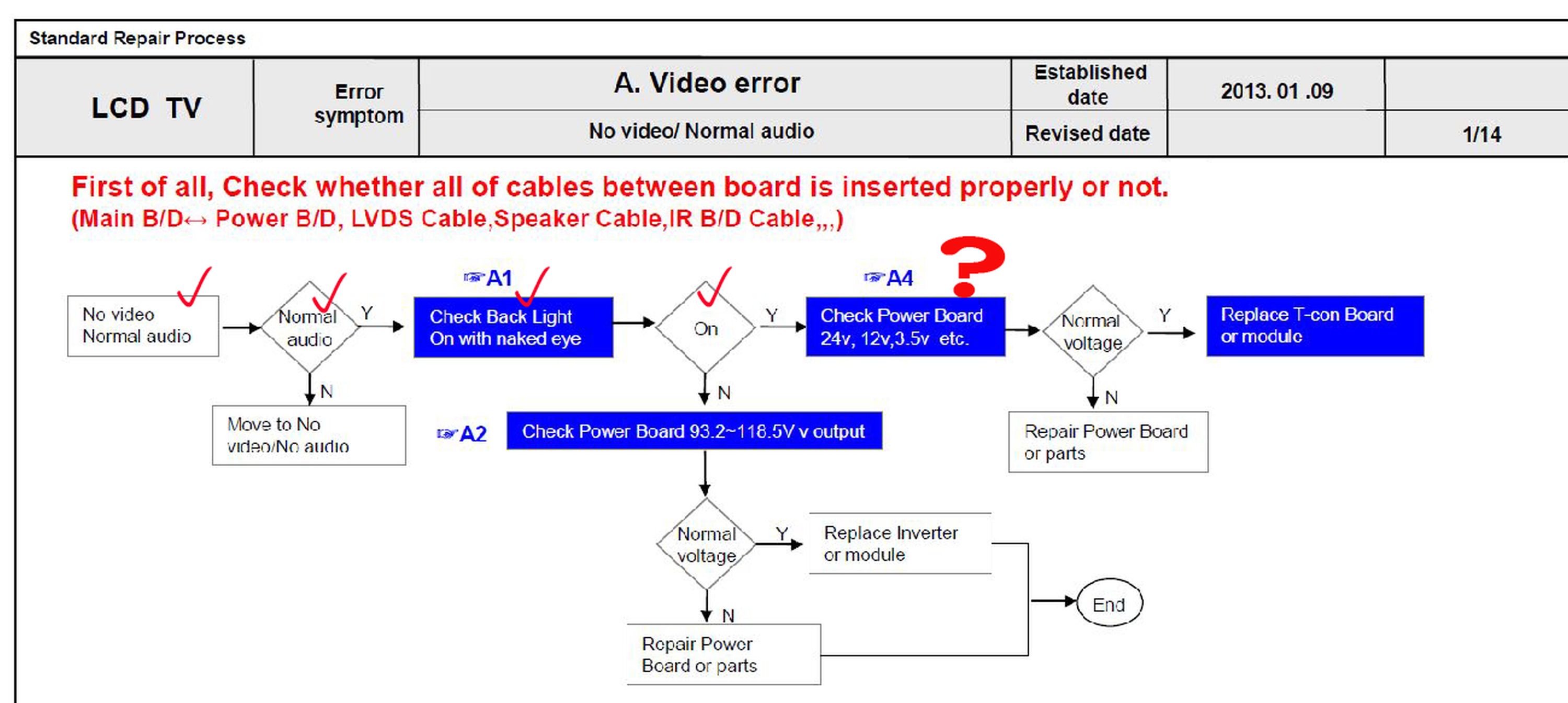

                                    • vinceroger69
                                      • Mar 2012
                                      • 6714
                                      • uk
                                      #38
                                      Re: Newbie with LG 37LH5000 (PS?) problem.
                                      can you upload a picture of your tv one showing how all the boards are connected together and one of each of the boards so we can see what type of connectors etc were dealing with.

                                        • MickyLuv
                                          • Apr 2017
                                          • 40
                                          #40
                                          Here's part of a flowchart for a similar LG model I found online.
