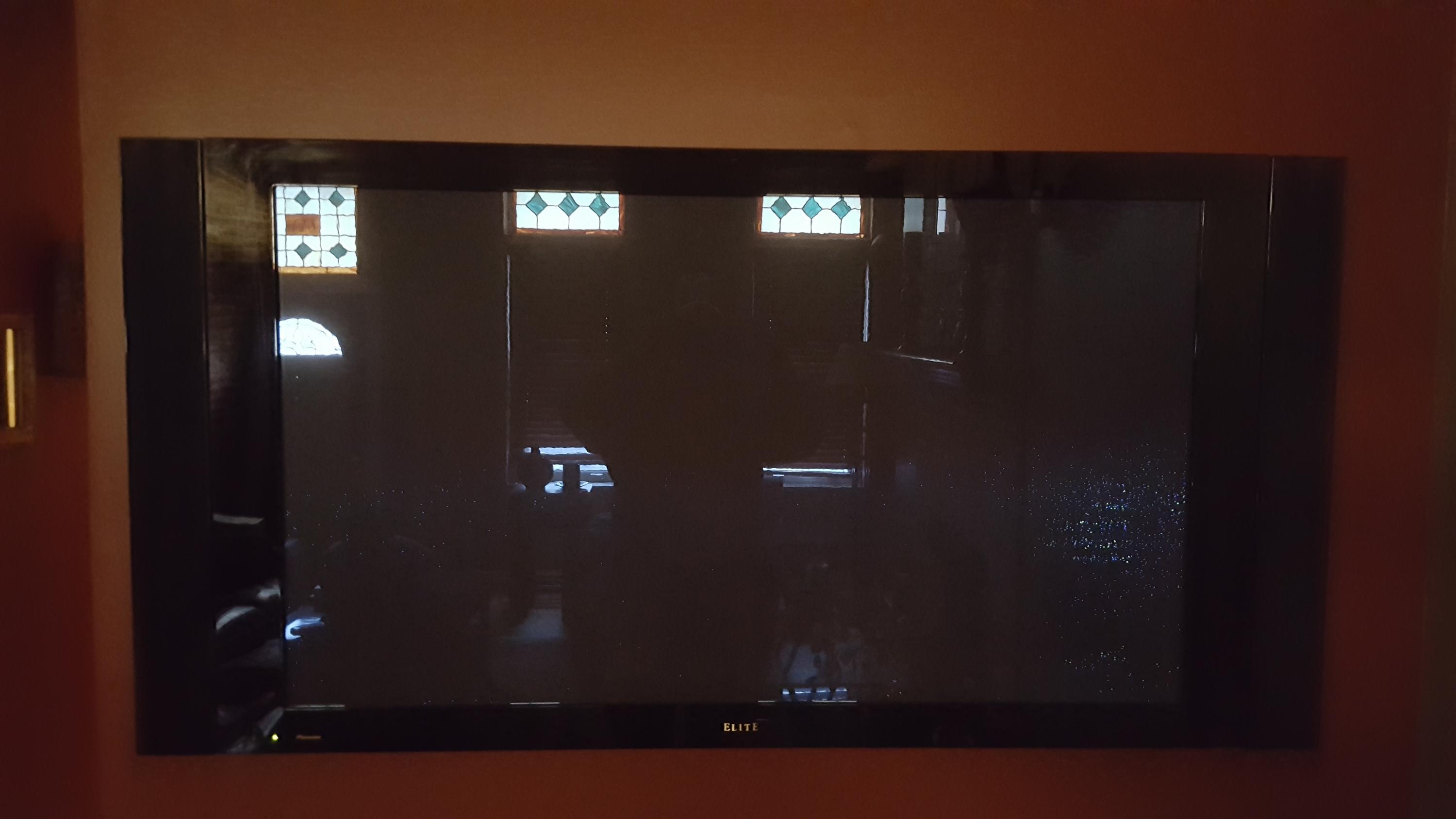

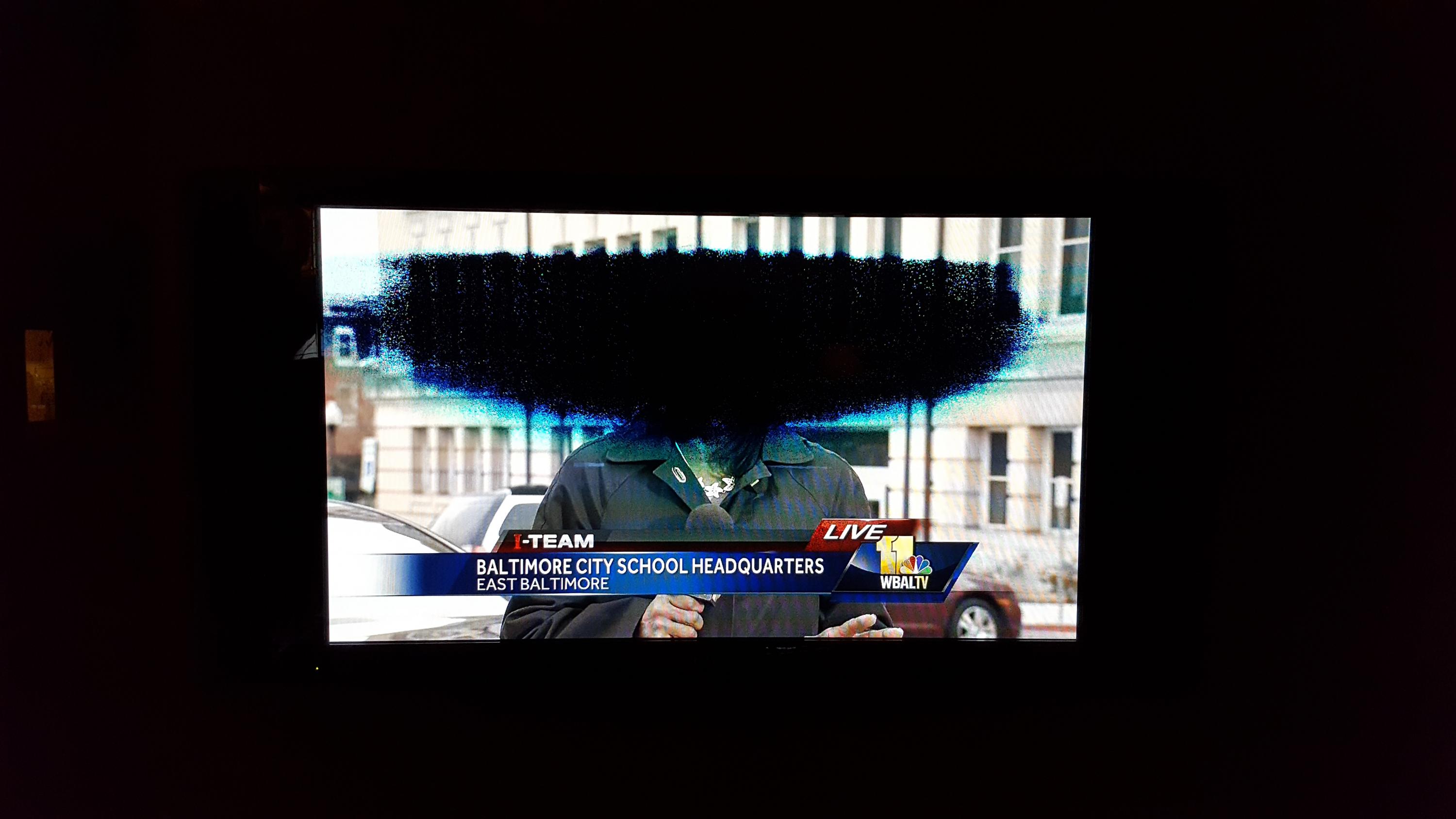

    I have read several threads about their plasma's taking a long time to turn on or for the picture to show up. Mine turns on, sound is fine, remote is fine. The issue is it takes about an hour for the picture to show. Pixel by pixel and then eventually the picture is fine. The TV is about 12 years old. Pay a lot for it at the time. Originally I was going to buy a new LCD but after more research I am thinking maybe I can fix this TV but I am not sure...thus my post here.
    Note this TV has two pieces. The plasma display and the media receiver.
    Can someone diagnose my problem?
    Is is a power supply issue?
    Capacitor issue? I haven't opened her up yet but I will once I determine if its worth it.
    Z-sustain or Y-sustain?
    Main board?
    Here are two pictures. The black screen is when it first turns on. The second is after 30 mins. Another 30 min the picture is clear and fine.

    Reset connectors to panel with power off

      Wow looks like the panel is worn out, try upping Vsus via the service menu that will fix it. Also the connectors to the panel are bonded to the boards DO NOT PLAY WITH THEM !

        Is this a sudden occurrence or has it slowly been getting worse.

          Thanks for the responses. It started about a year ago. At first, it only took 30 sec, then longer then longer and now it is just over an hour for a clear picture to show.....keep in mind that a perfect picture does eventually come.
          I am technically inclined but I have never worked on a TV before. I probably could do it with guidance. Also keep in mind that I am not a professional and I only knew about the zsus, ysus, cap issues, main board etc from reading this forum.
          How do I up the Vsus? and how do I get to the service menu?
          I did pay $8K US back in 2004 (still makes me sick to my stomach). That's why I want to see if it is worth fixing. But she has stood the test of time so far....just a little slow as we all do when we get older. haha

                Capacitors on the y sustain board. I delt with this before. This is how Pioneer manifests itself when ysus vsus voltage cannot be obtained properly. I don't remember which capacitor I changed but I believe it was it 470 or 330 microfarad near the top of the ysus board

                  Should be able to preheat those caps freakaftr8 speaking of with hairdryer to speed up startup/warming process to narrow down suspect cap, no need to get it hot just warm unless it bulging then it is replace on sight otherwise esr meter is needed.....

                    Precisely. That's what I did and found the picture came right back so I knew immediately what was going on. I was also monitoring VADR or whatever the address buffer voltage is. Because inevitably this is what it's affecting believe it or not

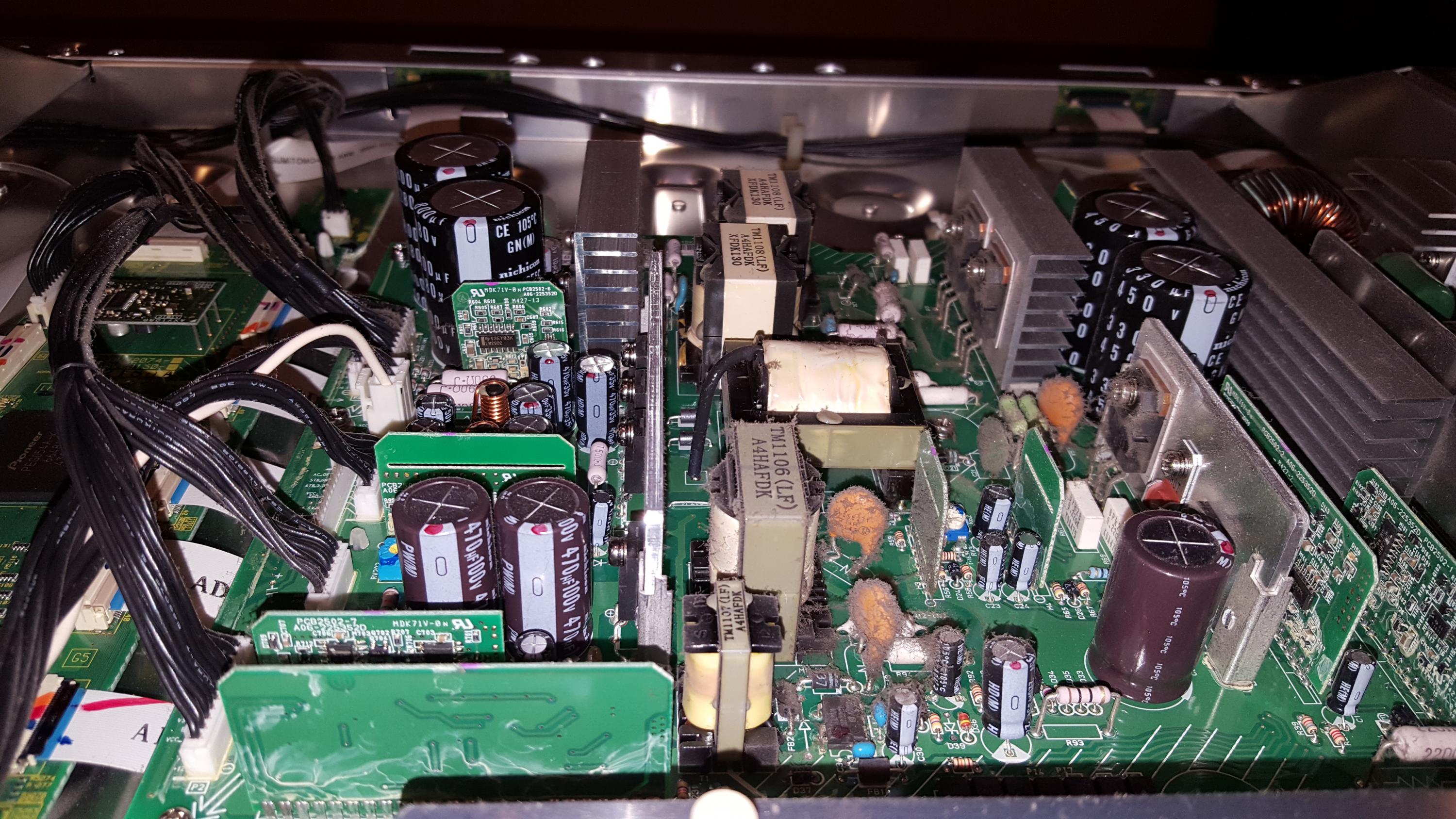

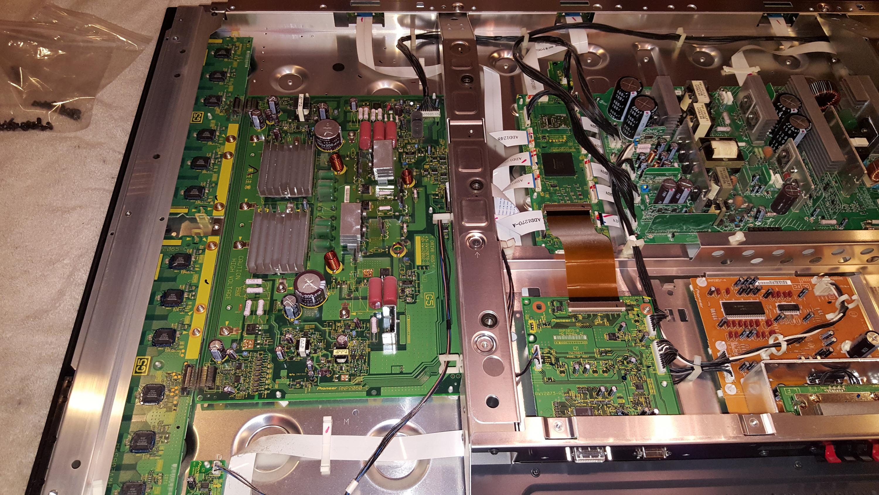

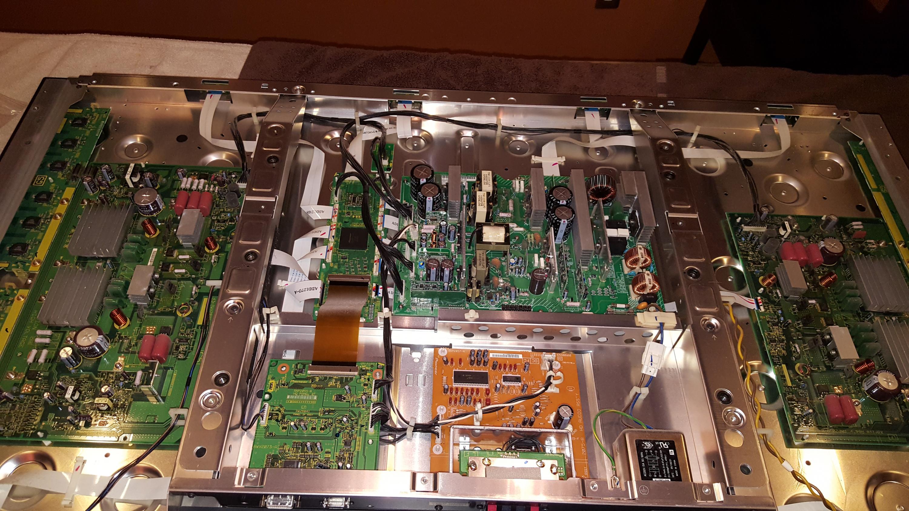

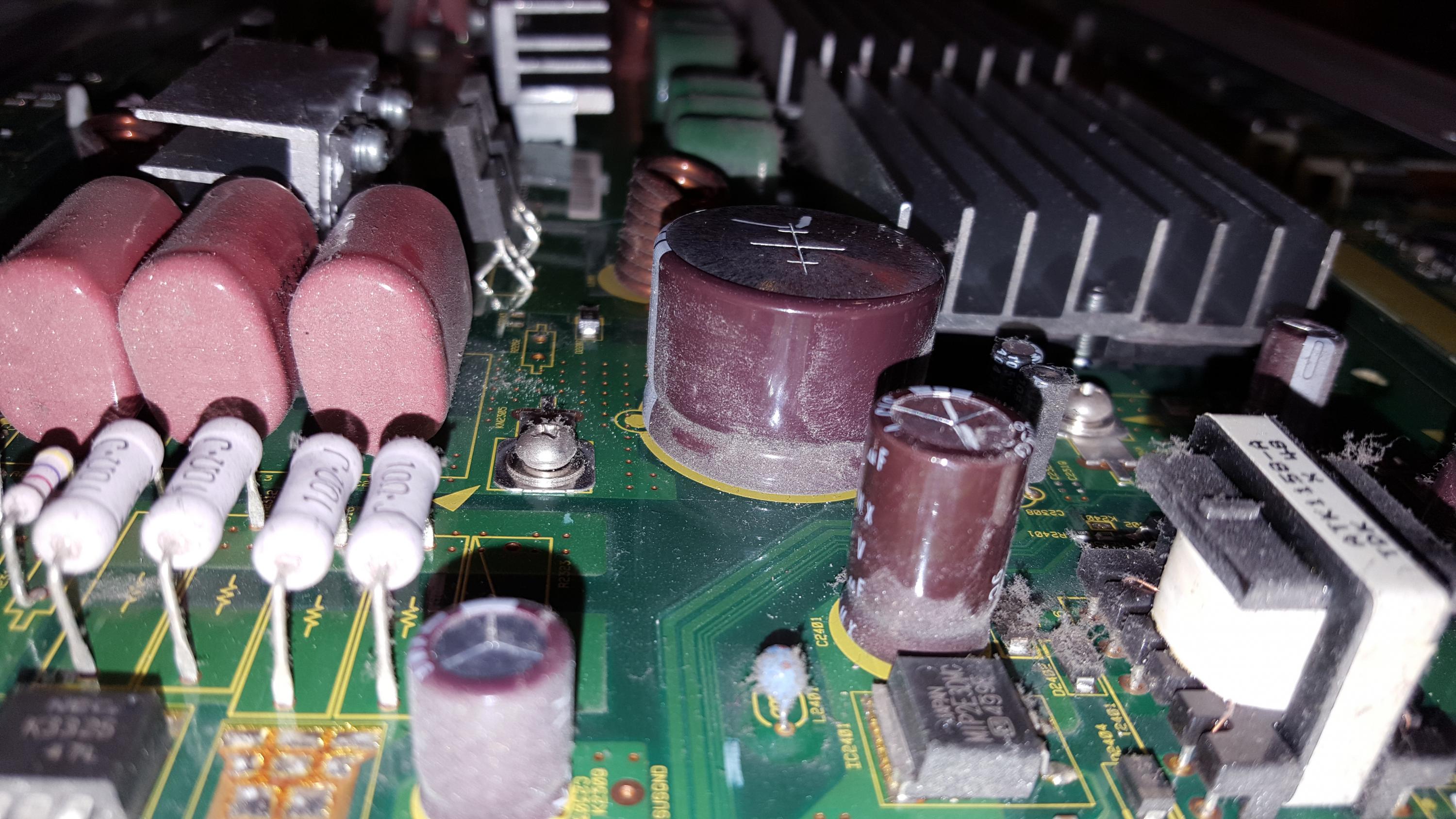

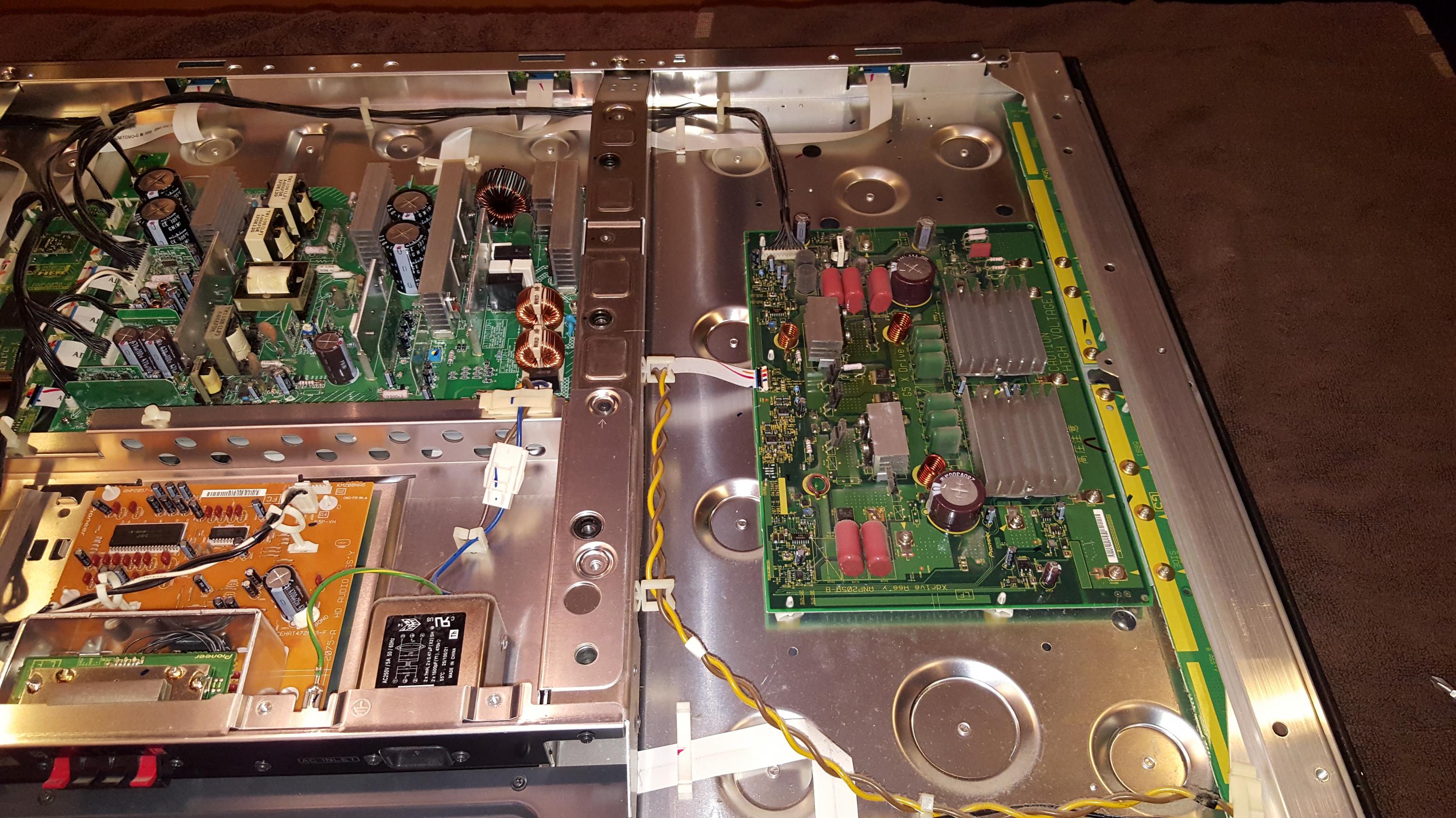

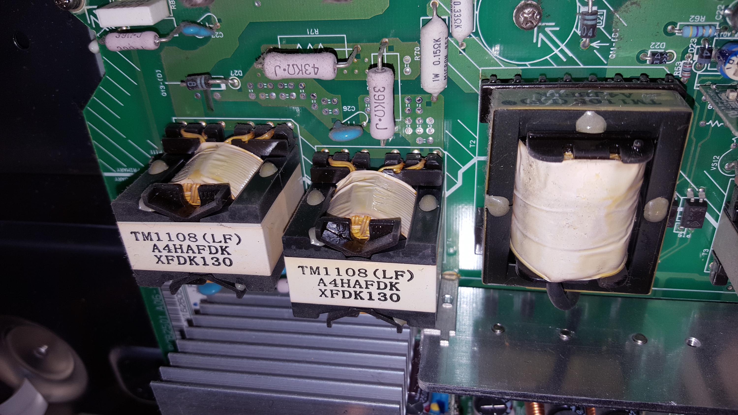

                          I opened her up. Here are some pictures looking from the back.
                          1. First picture is the Ysus I think (left side). One of the caps has maybe a slight little bump? Hard to tell.
                          2. 2nd Picture of cap on the Ysus that might be buldging? Big brown one.
                          3. 3rd picture is the Vsus (right side)?
                          4. 4th picture is the full back pic.
                          5. 5th pic is main board and power supply?
                          6. Not sure what these are but looked brown. Probably ok tho.
                          Nothing seems to be obvious.
                          Let me know if you need a different type of picture.
                          Thanks!
                          Boyd
                          • heavymachines
                            • Mar 2011
                            • 1028
                            Re: Pioneer Plasma Pro 1120HD fixable or Not? 2 pictures shown
                            Future reference we like straight shot pics, But i was able to see area we need to pay attention to. Ok on ysus there is a big cap 280v 300uf on the upper portion of ysus. Warm each cap from one mentioned and all others above it, 1 at a time and see if tv fires right up. if all fails warm the entire group remember not hot but warm.

                              Do i have the tv on as i warm with dryer or turn tv after i warm with dryer?
                              Also, the tv isnt hooked up to cable. Do i have to hook the tv to cable to do this test?

                                heat with set off, after heat, turn on set does it speed up picture warming? no ok turn set off try heating another cap turn on set does it speed up? no ok turn off try another etc. it would be best to use the last input u used on this for best results.
                                Safety precautions, if asked to disconnect or reconnect anything on plasma internally etc, always have set off and disconnected from all power sources and 30 second drain time before you do anything.

                                      Unfortunately I gave the stand away since I was never using it BUT I have it propped on a chair upside down.
                                      How long do I keep the hair dryer on the cap? I warmed the cap but screen still dark. And can I warm the cap while the TV is on? That would be faster.

                                        i've never warmed cap while in operation. so i cannot recommend to do so.
                                        Heat them up till it is warm to the touch on sides of caps heat from top.
