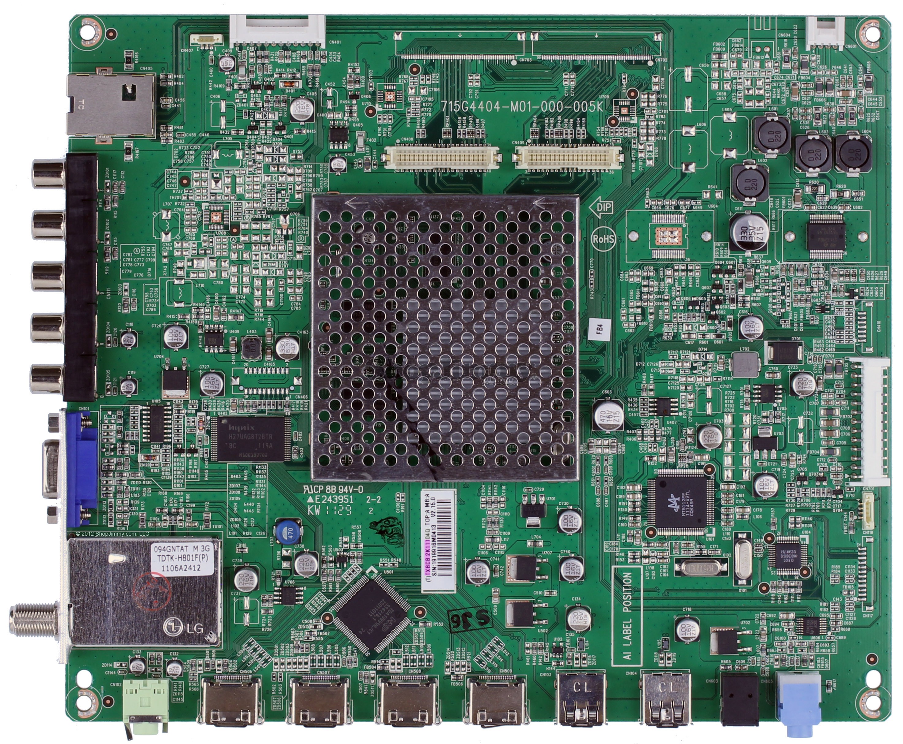

    Tough Dog Vizio E551VA LTLPKZAM : Main Board CBPFTXBCB2K111 US $173.99, Out of Stock, nobody has this PCB.(Made by LG)
    All I need is E551VA firmware to fix back and white problem, Any help?
    Yes it is U405 H27UAG8T2MTR 16Gb (2048M x 8bit) NAND Flash, It took 3 hours to program or read it contents(dump). Same IC is used in vizio M470nv or M550nv. Why so big .....they put internet APPs (....Netflix..) inside of it. which can put 8 movies inside. Isn't that nice when you open TV already has 8 movies built in, but which 8 movies will be ?

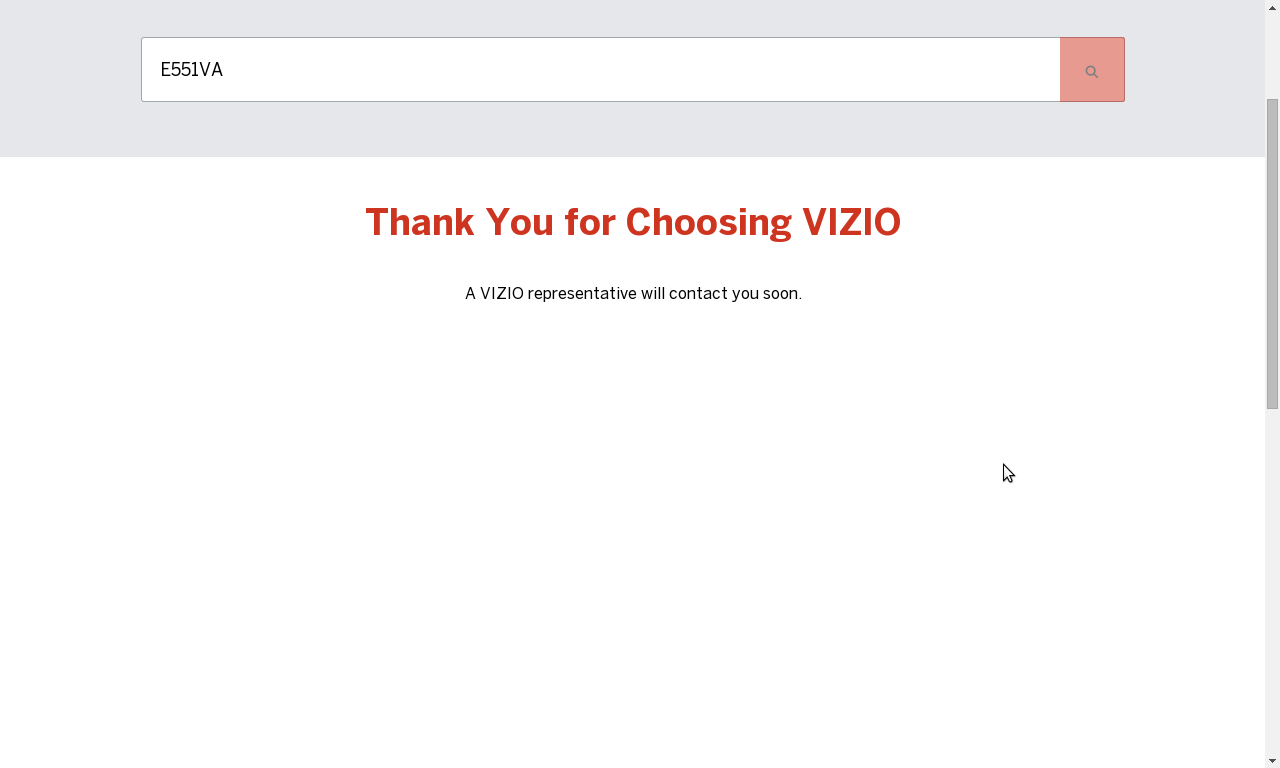

    Can someone helps me do this (I did that): Send an Email to VIZIO Support or Call a VIZIO Support Agent.
    https://support.vizio.com/s/search/A...language=en_US
    PS: Maybe try with small size TV. .. https://www.badcaps.net/forum/showth...t=31626&page=2

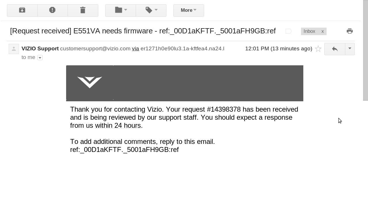

    Mmmm Vizio response is fast. (15 minutes)............How can they upload 16G firmware to me, let's see. ..... .
    PS: Is this A Robot?

      customersupport@vizio.com customersupport@vizio.com via 4mvlhavyzr44w0.1a-kftfea4.na24.bnc.salesforce.com
      12:47 PM (43 minutes ago)
      to me
      Thank you for your recent inquiry with VIZIO. I would be more than happy to help you. Here at VIZIO we do offer best in class technical support.
      What are you using to watch TV? Cable, antenna, satellite? Does the Black and white effect other devices connected to the TV?
      Thanks and have a great day!
      Buddy
      VIZIO
      800 Stevens Port Drive Suite DD750
      Dakota Dunes SD 57049
      Phone 877-878-4946
      Visit us: www.vizio.com
      Facebook: www.facebook.com/vizio
      Twitter : www.twitter.com/VIZIO
      ref:_00D1aKFTF._5001aFH9GB:ref
      To: Buddy
      Thank you very much for the prompt reply.
      "Does the Black and white effect other devices connected to the TV?" All the devices connected to this TV, the image is become black and white. One TV shop owner said to me " it is the firmware problem, and the PCB is not available anywhere in US. " I am a TV repair shop owner try to assist this angry helpless customer wins back his confidence in Vizio. Any information you can provide me would be greatly appreciated.
      I really appreciate any help you can provide.
      Peter Mar 21 2017 13:59
      PS: I think, they are the Best. "Here at VIZIO we do offer best in class technical support." What do you guys think?

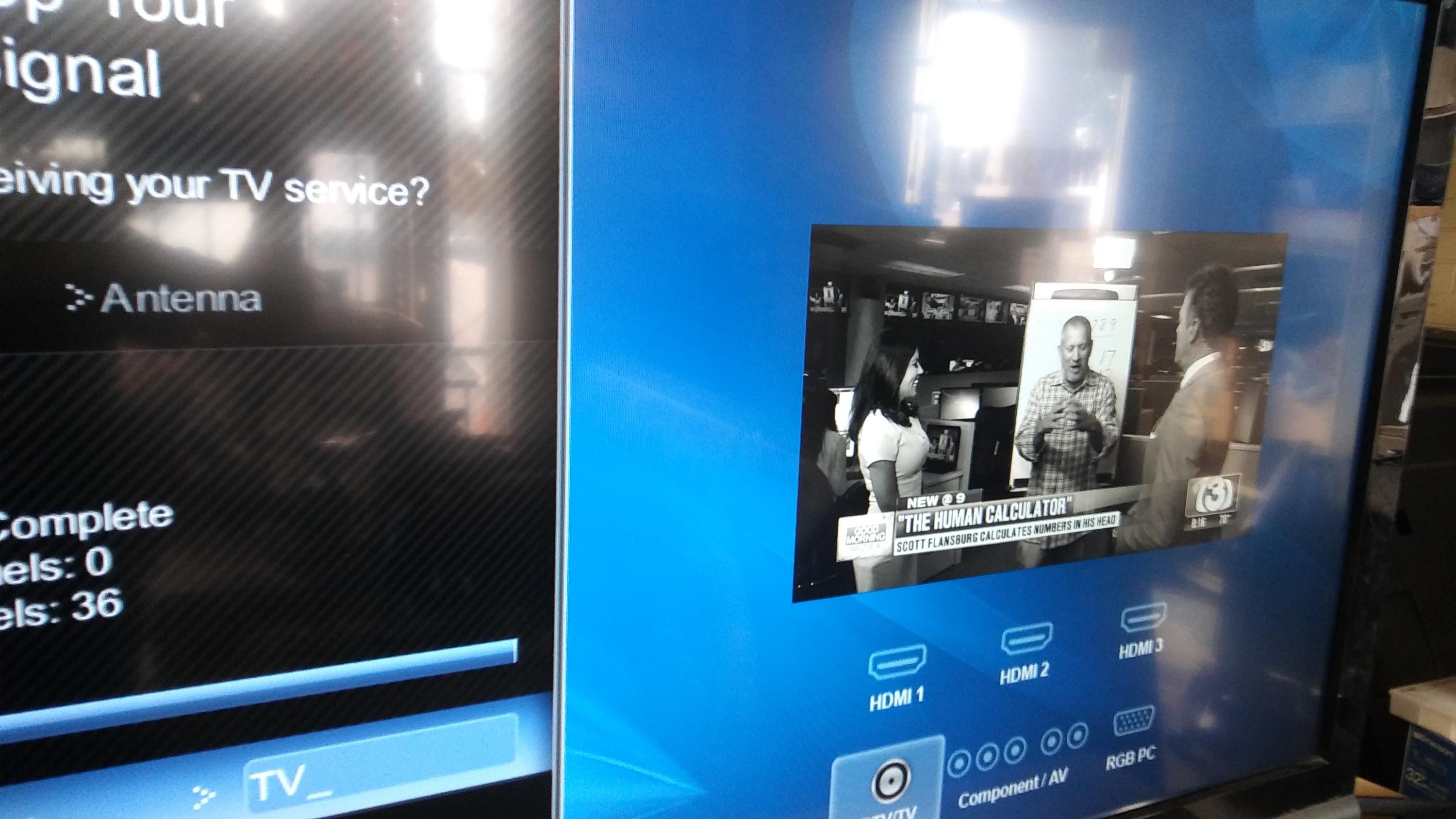

          I tested with this TV input.
          TV : B &W
          AV : B &W
          Comp : B &W
          HDMI 1 : B &W With computer HDMI output TV picture is color
          HDMI 2 : B &W With computer HDMI output TV picture is color
          HDMI 3 : B &W With computer HDMI output TV picture is color
          HDMI 4 : B &W With computer HDMI output TV picture is color
          RGB : Color
          Why with Laptop HDMI and HD15 RGB output TV works with color?

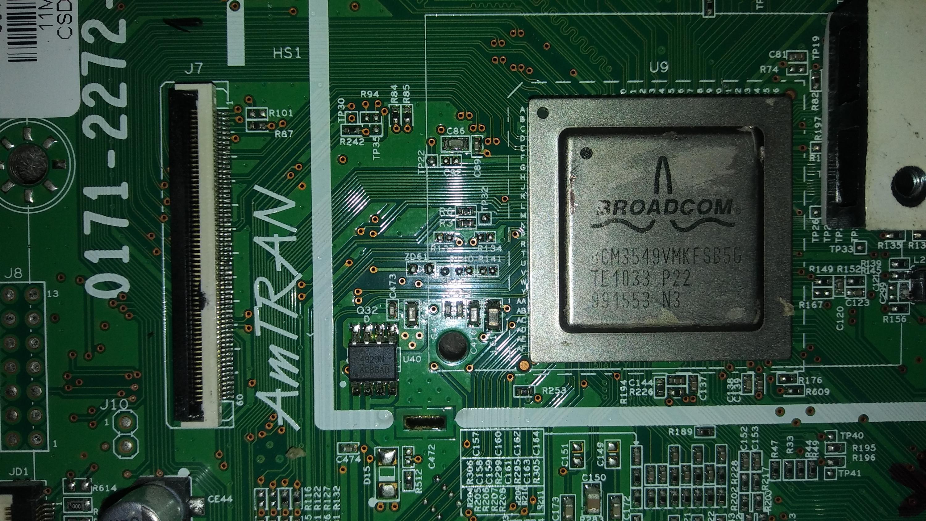

                  The U401 SoC IC, working temperature is at 56'C, almost untouchable. SoC IC partially damaged. This is the best I can guess!
                  I know Vizio can't admit that which might get sued. We always be put under the cloud. That's why we need Badcaps.net.
                  I might just bail it out. They still can use as a computer monitor(pic1). But i will study more on this kinda of LG chassis.

                        Thank you very much! The customer can watch color TV with computer, has picked up the TV. This were very common problems over this mode of TVs, For $140 I could not find the board.
                        • NORTHWAYTV
                          • Oct 2011
                          • 3
                          Re: Tough Dog Vizio E551VA
                          Ic just needed reflowing.
                          • capwizard
                            • Jun 2016
                            • 1991
                            Thank you very much , Youre A PRO. NORTHWAYTV "Ic just needed reflowing." But Vizio and LG never gonna admit this fault.
                            It is A rule of thumb If I saw the SoCs with metal casing made around 2010 - 2014, All have over heat problem and U Can't Touch This.

                              Broadcom
                              Broadcom Corporation was an American fabless semiconductor company that made products for the wireless and broadband communication industry.
                              BCM3549 is a SoC, 2012 made by Broadcom. USA
                              http://itersnews.com/?p=9859
                              • NORTHWAYTV
                                • Oct 2011
                                • 3
                                I am very familiar with broadcom, and the particular issue for those few years. However we have repaired many different models the past few years with these chips.
                                • capwizard
                                  • Jun 2016
                                  • 1991
                                  Thank you very much to point out this and share your experience with us of which we never will get the right answer from LG or Vizio. You are our sunshine.....
