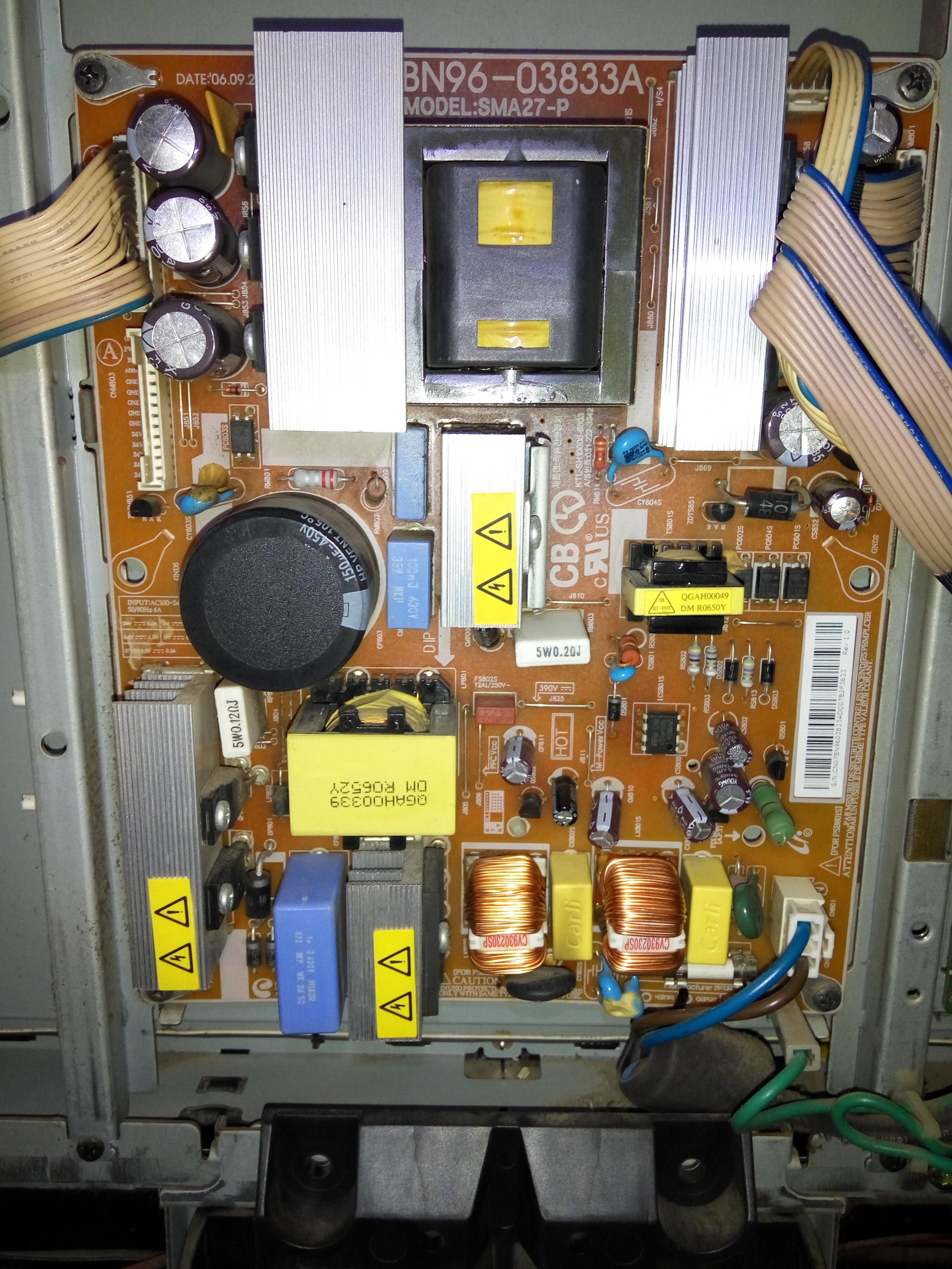

    Hello, My girlfriend parents had a samsung tv that "broke" couple years ago. They bough new one and were going to finally throw old one because it was taking place in garage, decided to take it to my home and try to check if it's possible to make it alive again as she has only 20' monitor
    TV turns on, backlight is working fine, theres sound when i connect it by HDMI cable, but there is no picture at all.
    I measured voltage on power supply board and it looks fine (just checking if its ok with description next to pins)
    I found 2 faulty capacitors on power supply board, but i'm not sure if it wouldc cause that problem
    1. cracked
    2. puffy head, but didnt crack yet

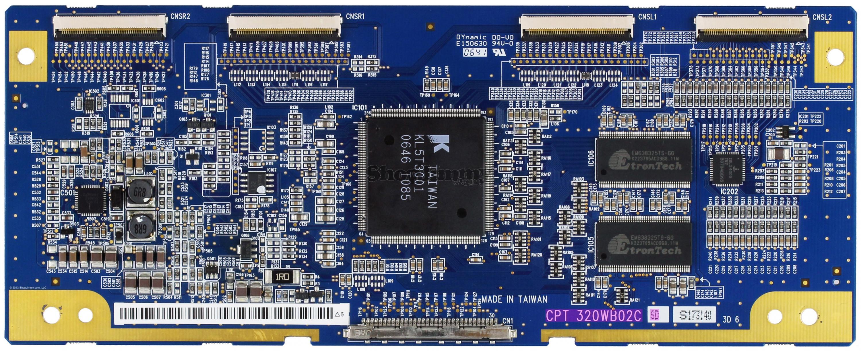

    Attaching also t-con board(CPT 320wb02c), im not specialist but i didn't see any obvious damage on it - still could be a problem, didnt know how to examine it

    Re: Samsung TV, sound ok, backlight ok, no picture - model LE32S71B
    i would start by re capping the psu as capacitors can also fail with high esr etc and still look good once you have done that we can get you to do some voltage testing etc.
        a possibility yes on the t con board there shoud be a fuse what dc voltage do you get on each side of it ?
          Sadly cannot find any fuse on the t-con board, i think i will have to find some service manual with schematics
          #EDIT I think there is a fuse under 1R0 resistor (blue one with N on it - so small that i cannot read it clearly), there is continuity between ends, didnt try to measure voltage as im not sure if im touching proper thing
              Left side is where voltages are produced for t-con so fuse would be along lower left side. 12v
                i measured that blue SMD which i suppose is fuse, there is a 12.3V on both ends. I dont see any other SMD that looks like fuse on that board

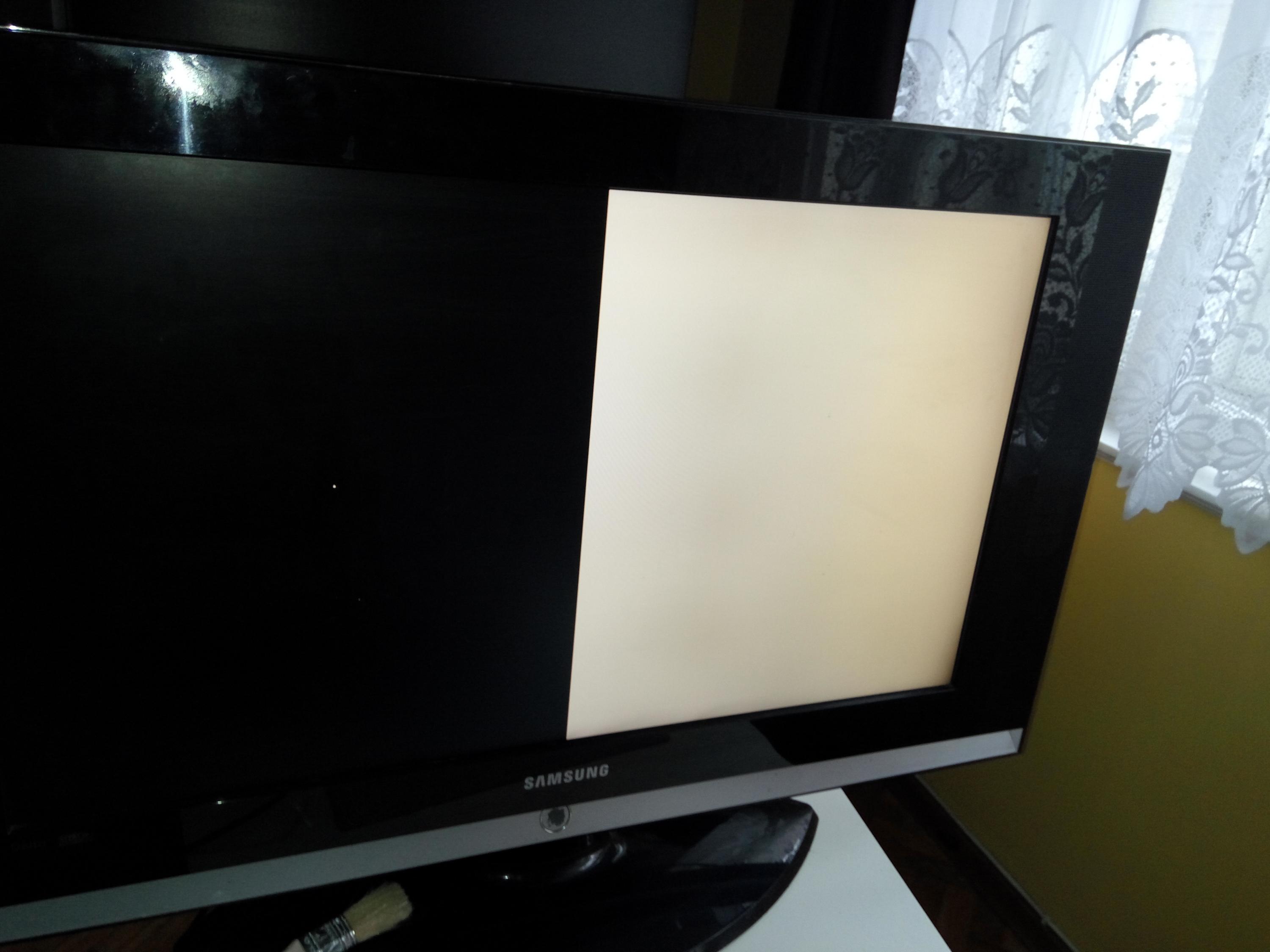

                  Disconnect ribbon cables going to panel one at a time and see if you get picture.
                    diconnected
                    all connected, black screen with backlight working
                    1st ribbon disconnected, right half of screen went white
                    2nd ribbon, nothing changed
                    3rd ribbon, left side of screen got blue, green and brighter green colour
                    4th whole screen went black with backlight working

                        Dissconect both left ribbon cables what do you see on the screen? then put those two back and do the same on the right what do you see on that side
                          Two left disconnected - right part of screen gets white, left part of screen is black
                          Two right disconnected -, right is white, left is black but with one brighter vertical stripe
                          same if i restart tv
                          during that test i was playing youtube by hdmi so sound was still up on tv speakers

                            if this was my set i would try another t con board as there usually cheap if it does not work you can re sell it on ebay etc too get your money back.
                            Also change those capacitors on the psu too can you also upload a picture showing the whole top side of the psu
                              Top left is swollen and cracked one is on the right just below mainboard ribbon
                                yes there certainly bad so not sure if there causing your issues if this was my set i would change all the capacitors on the psu except the very large primary one if that dose not get the picture back then try a t con board
                                    make sure you try to get low esr capacitors 105c rated some of the cheap 85c rated general purpose ones may not work if you can get panasonic capacitors in the fc fm fr series you should be fine
