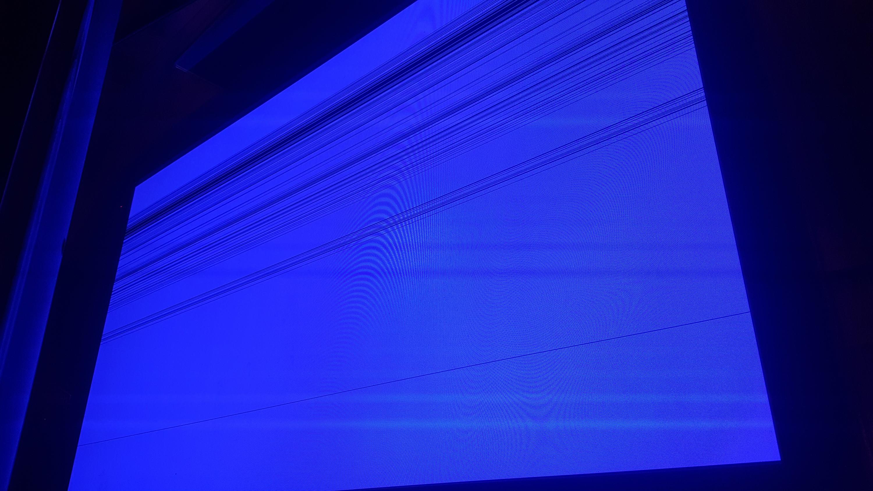

Samsung pn50c590g4f bad panel?
  • microvibe
    • Mar 2013
    • 275
    • canada
    Have a Samsung pn50c590g4f with horizontal lines. The ysus heat sinks are extremely hot can't touch very long after 10 minutes running test patterns . Buffers ic don't get hot. Is this just famous samsung shot panel or possible ysus buffer board? Attached pic of test pattern.
    Re: Samsung pn50c590g4f bad panel?
    Yes this is a bad panel.
    • ReeceyBurger123
      Never Give Up !
      • May 2014
      • 7325
      • Britain
      Originally posted by tom66
      yes this is a bad panel.
      +1 also Ysus on these getting hot it normal, thats why they have a high failure rate due to heat.
