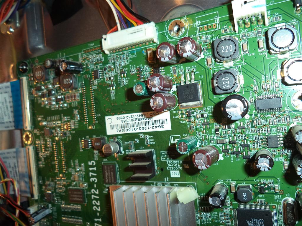

    Vizio m420sv tpa3110ld2
    Have Vizio M420sv that had no audio and 4 bad caps. Little freeze on tpa3110Ld2 and audio returned . Replaced 4 caps but didn't have a tpa3110Ld2 to replace audio ic. I tried in vain to find datasheet for tpa3110Ld2. Could only find tpa3110d2. I replaced the tpa3110Ld2 with a new tpa3110d2 and the audio works fine. MY question is what is the difference between the ld2 and the d2 chip. Also would you just leave the tpa3110d2 in the TV or replace it back to a tpa3110Ld2 when it gets here from china. The tv has 4 ohm speakers. The only info i found is that the tpa3110Ld2 was a 10 watt and the tpa3110d2 is a 15 watt audio out.
    Thanks for any info

    The TPA3110D2 is a 15-W (per channel) and TPA3110LD2 is A 10W+10W amp, Or sub with TPA3113 6w +6w. They are pin to pin compatible.

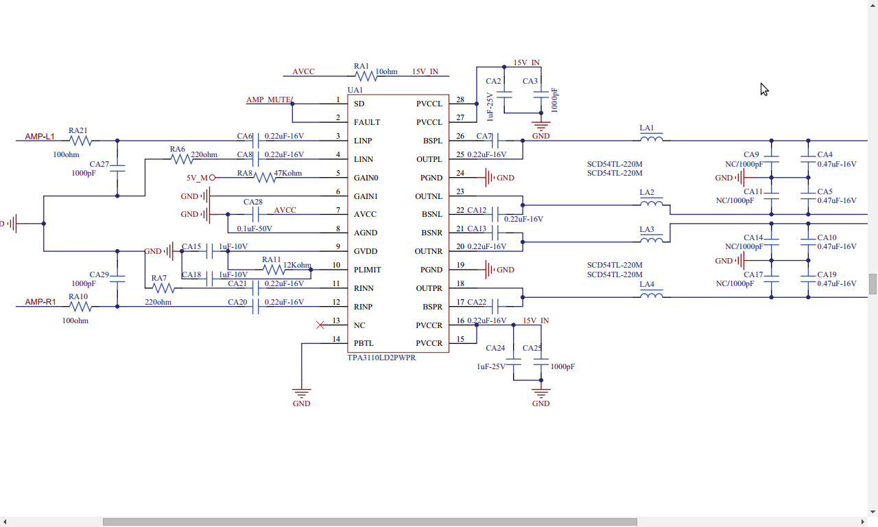

      Thanks Did you have the datasheet for the tpa3110Ld2? So you would just leave the tpa3110d2 and call the job done.

        Re: Vizio m420sv tpa3110ld2
        I only have TPA3110LD2 application, power use 15VDC, most is for 32-40" TV
        Haier 32D3005B
        I bet you have a lots TVs, to find this parts

          OK Thanks. I have seen most of the diagrams but maybe looking to deep. Thought something might have been different internally to the SD and fault pins. Vizio does not have a good service manual so will just go with what i have. Looked at everything on TI and nothing but tpa3110d2.
