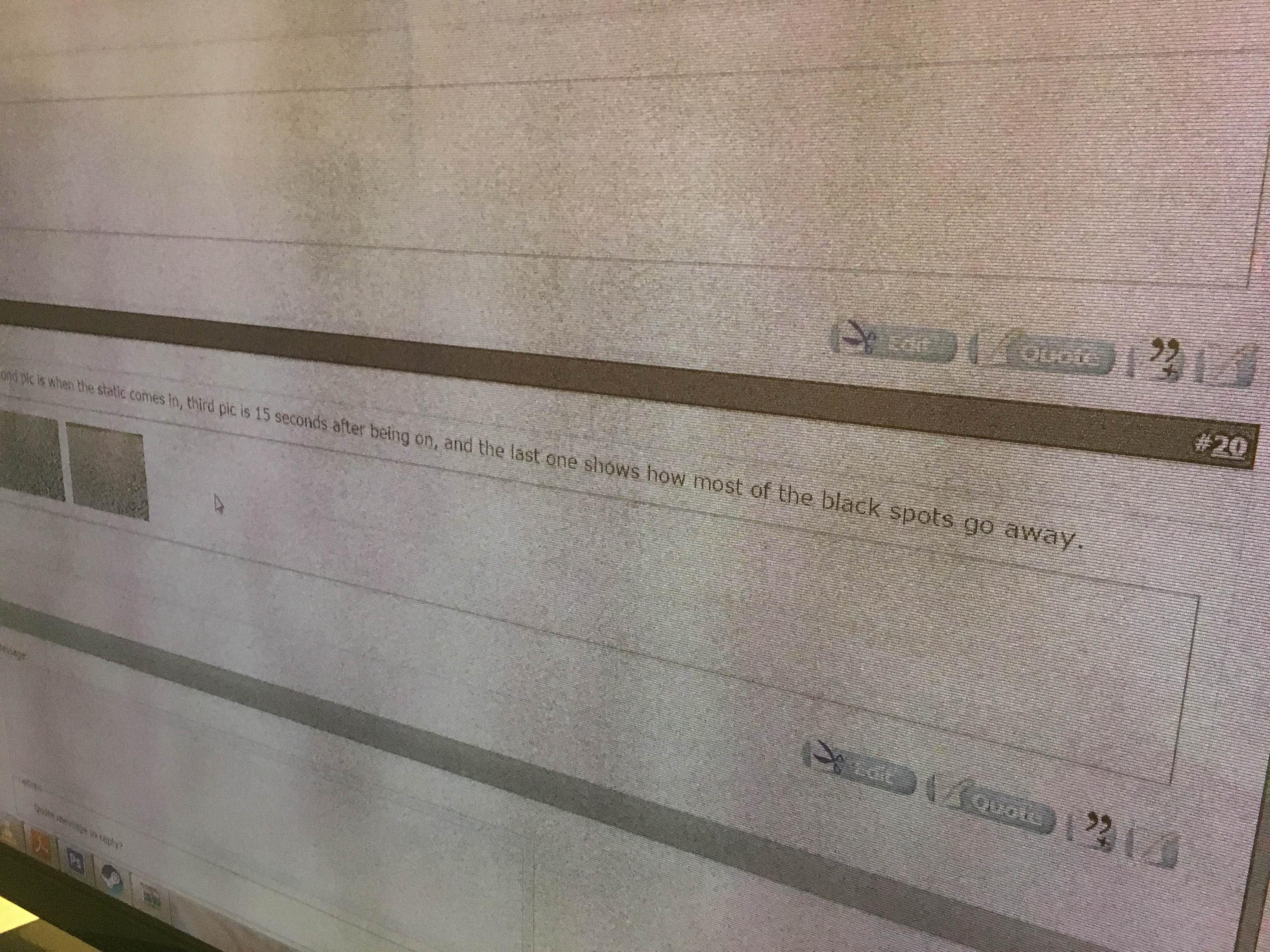

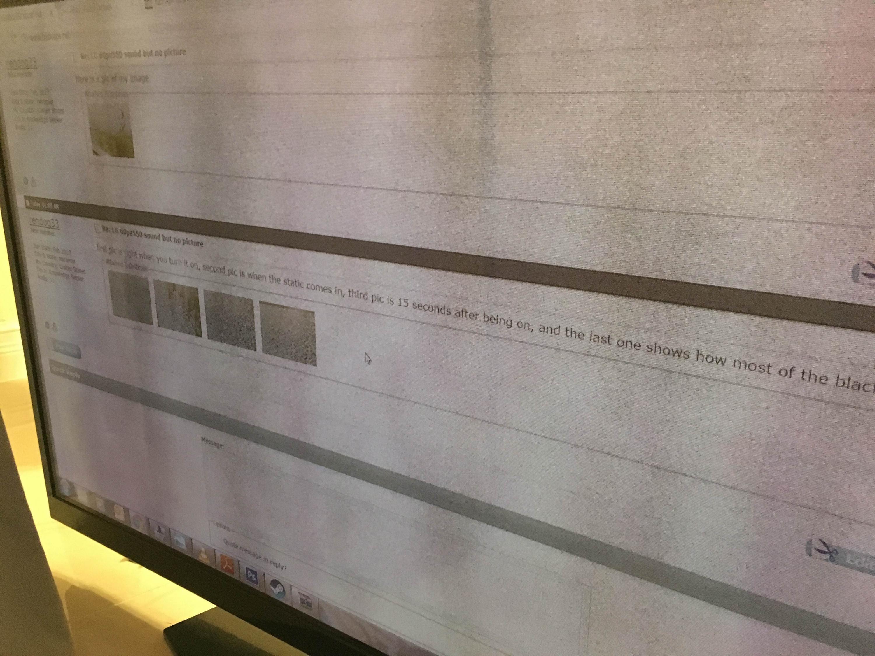

    2 more with laptop feed.....please see pics on previous page.

      I'm about to replace the z-sus but would like to know if the pictures above and at the end of page 1 seem to point to a bad z-sus board. Thank you.

        That's what I would do. Looks like a classic case of zsus failure

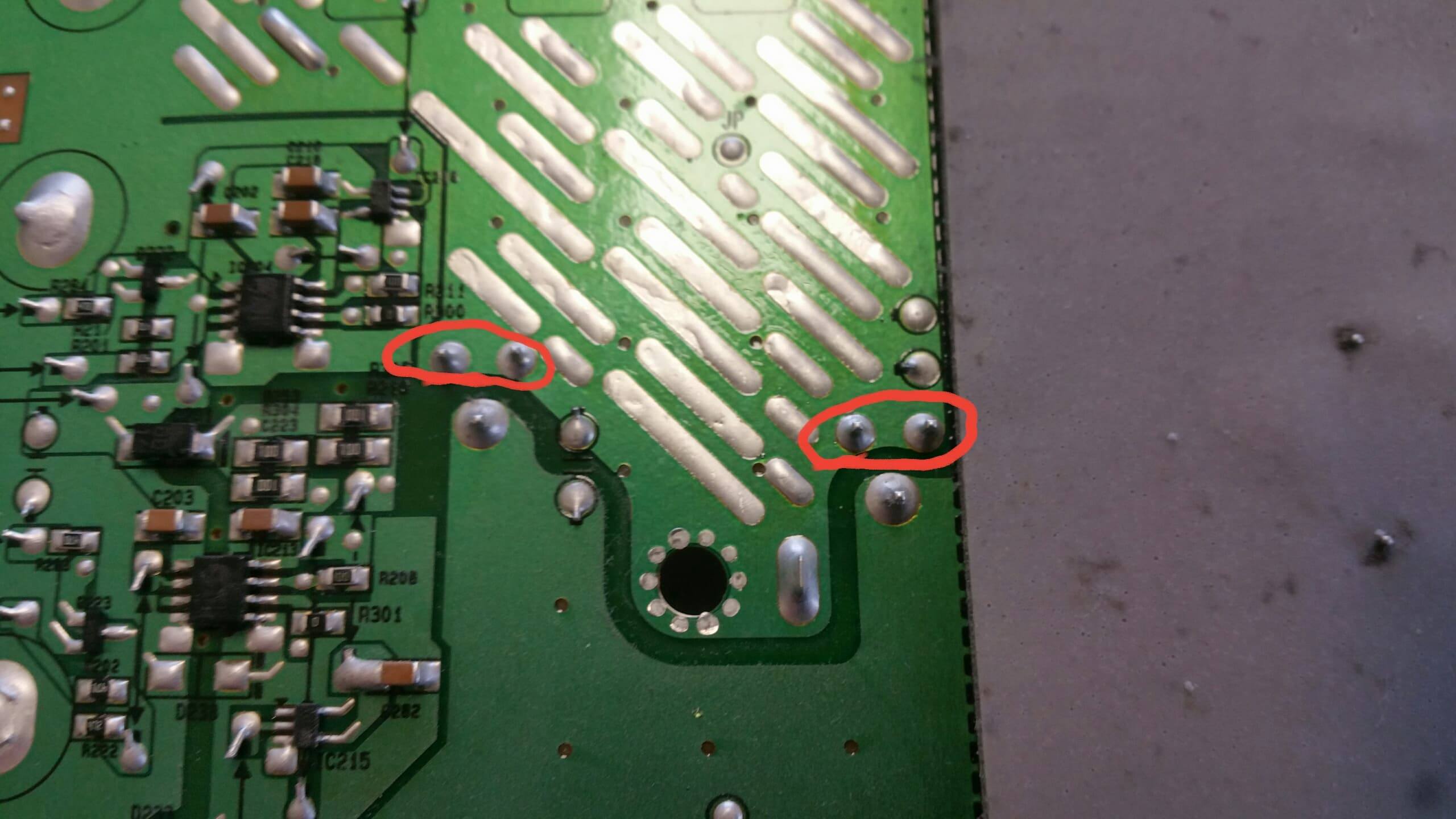

                        Hi guys. I had one of these dropped off today. I think one of the copper coils is cracked on the zsus. Is there a way to test and be sure that is what is causing it to have no picture?

                          Remove the useless lead-free solder and re-solder them all wirh leaded solder. Don't try and use the 1/8 thick plumbers solder, it won't work. Then test the set.

                            I resoldered them on both z, and y before posting the question.

                              Put your meter in continuity mode(beeps when probes touch each other) and check for shorts on the igbt's mounted to the heatsinks. Any beep means there is a short. These have 3 legs, and don't worry about the diodes.

                                Can i just put ground probe, on back of the panel, and just touch each pin with hot probe?

                                  I wouldn't. Pull the board and check them from the bottom side.

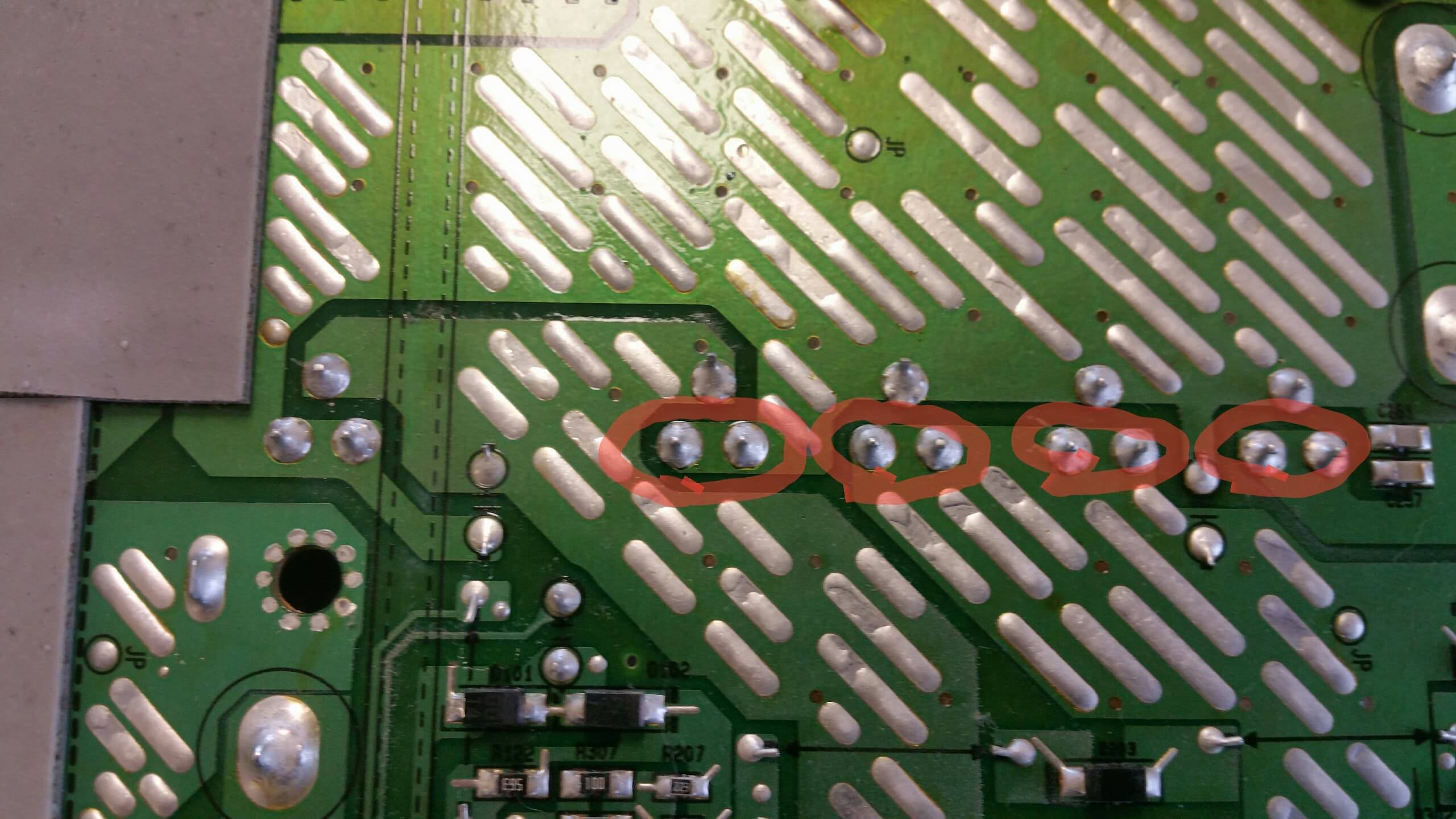

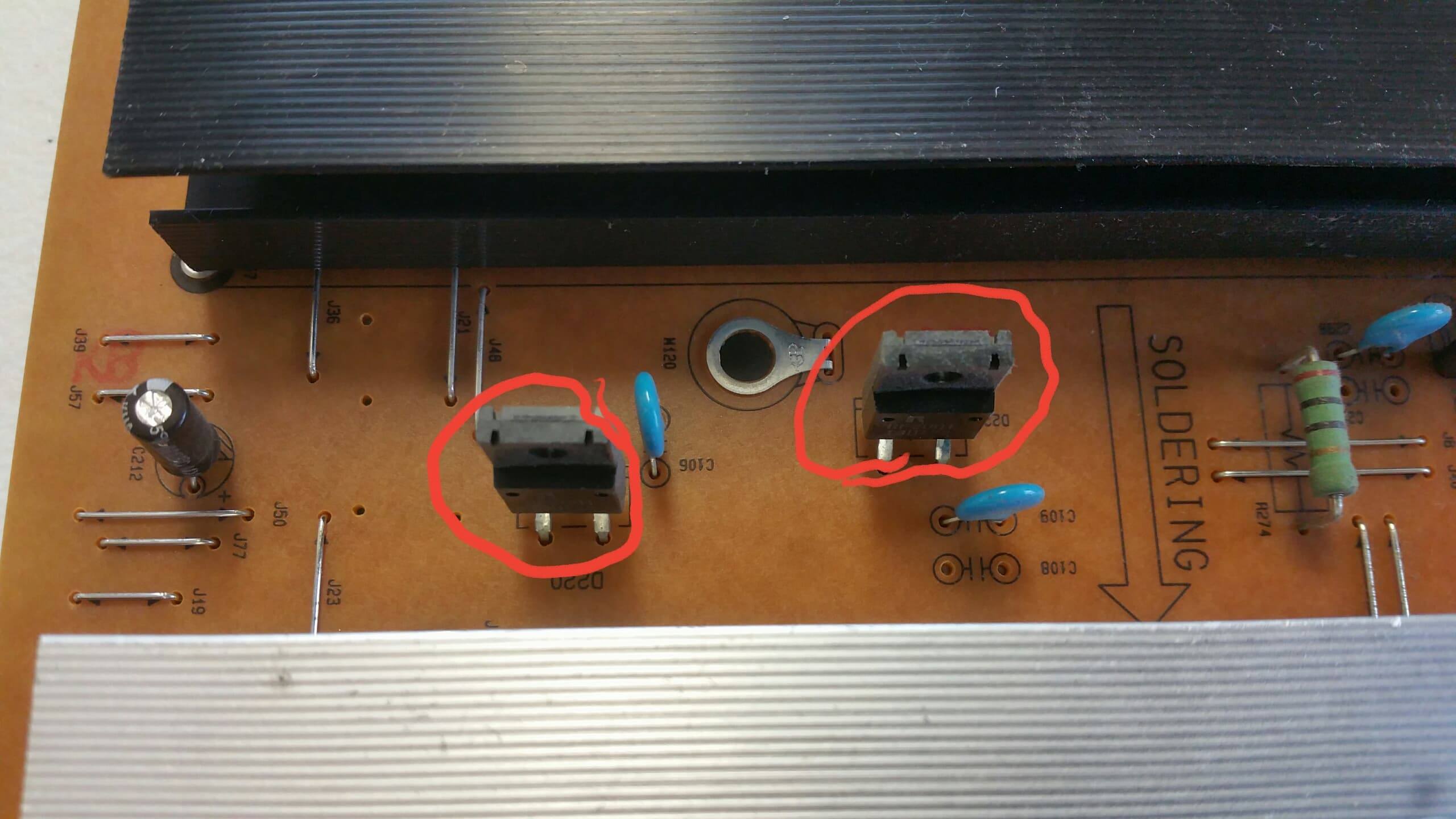

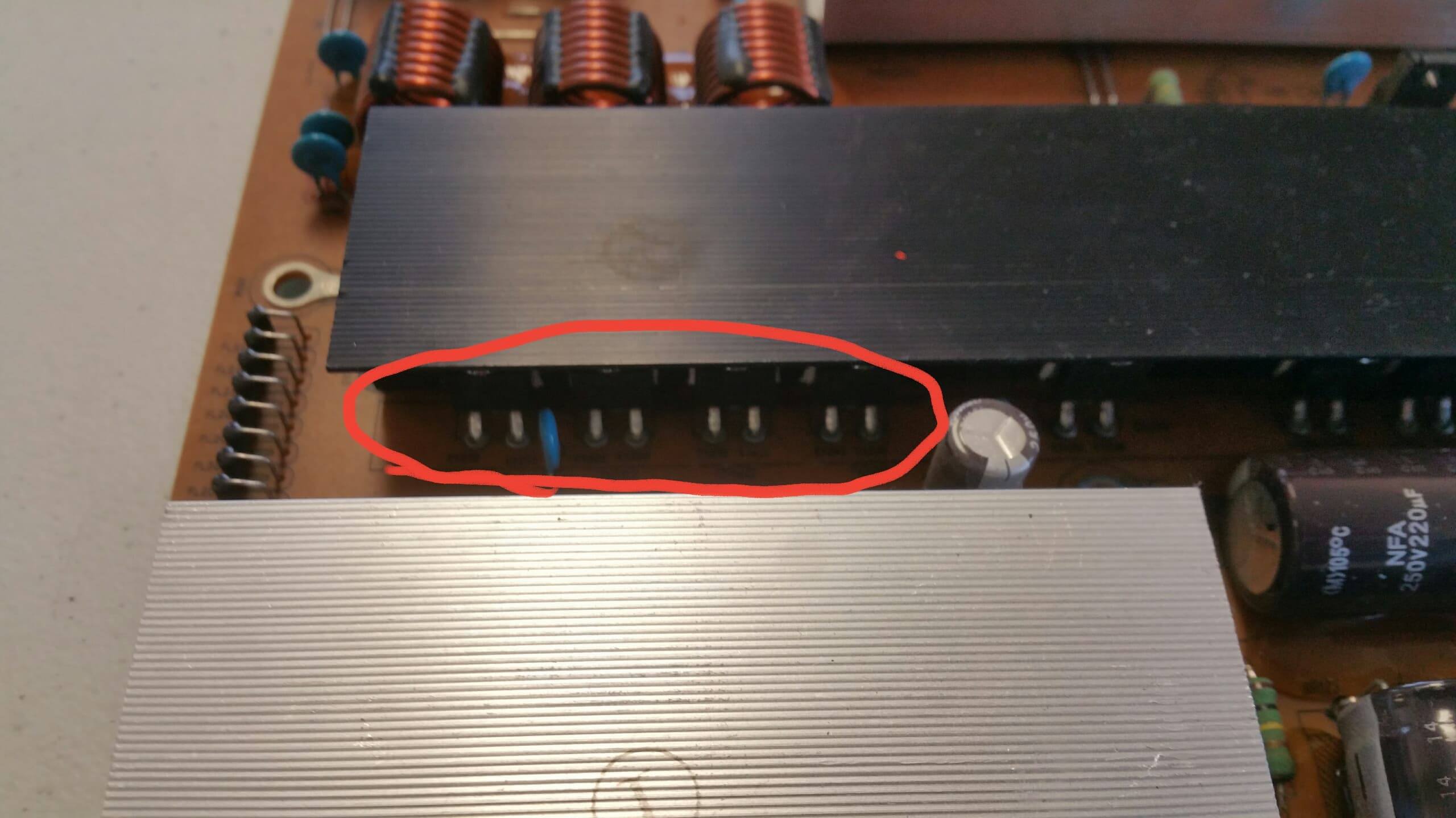

                                    TV Timmy. Here are some pics. The red circles i get beeps with my multimeter in continuity mode. Pictures are of the top, and bottom area of board where i tested. They are out of order for some reason.

                                      landen:
                                      Thanks for those photos.
                                      If you look closely, you will notice that all the points you measured with beeps (pins 1-3) are physically connected by trace on the PCB. This does not correctly test these components.
                                      You need to measure all of the 3-Pin diodes and IGBTs/Mosfets pins 1-2, 2-3, 1-3 for shorts.
                                      Diodes rarely fail on these TVs. Please measure all 3-Pin IGBTs that are heatsink connected whose component markings begin with E or Q.
                                      Please visit the thread below and follow my troubleshooting advice with the attached markup pictures:
                                      www.badcaps.net/forum/showthread.php?t=74898

                                        The parts you have in the second picture are diodes, marked with a D. They are connected together.
