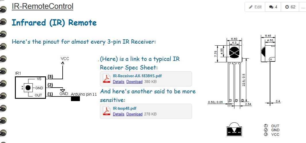

        There are 3 pins on the IR receiver. Ground, VCC and output which you can check using your multimeter.

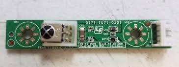

          I had a remote sensor board fail on a Vizio VX37L HDTV10A. Board number was similar - mine was 0171-1671-0501.
          I didn't trouble shoot the board to determine what was bad. Bought it from a vendor on Ebay.
          Yes, they do fail.
          Hope this helps.

                Maybe worth checking that the IR sensor lead has been reconnected after it was last serviced. Also that the IR receiver is lined up correctly with the lens on the set.
                So, the IR sensor board has a cable coming out that was plugged into the IR board and into the button board. The button board has a cable coming out that goes to another board (probably the main logic board). Didn't realize there was another cable coming out the other side of the button board. I looked at the silkscreen and saw stuff like AV1<something> AV2<something> IR GND <etc>. I plugged that cable in and next thing you know, working like a charm! I'm not charging the guy because I'm the one who last serviced it!
