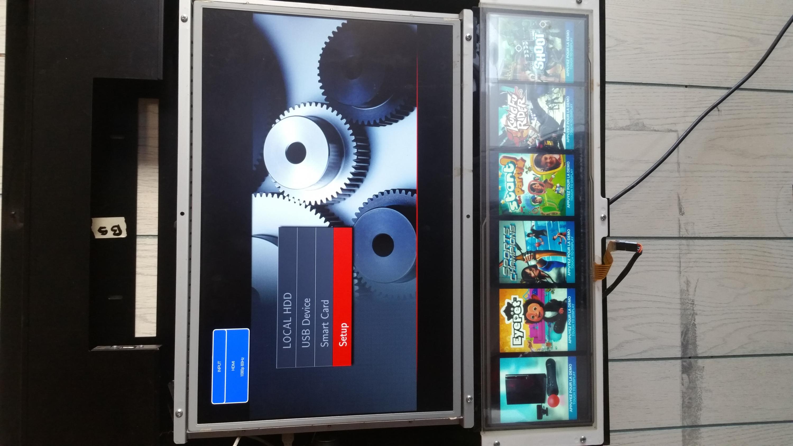

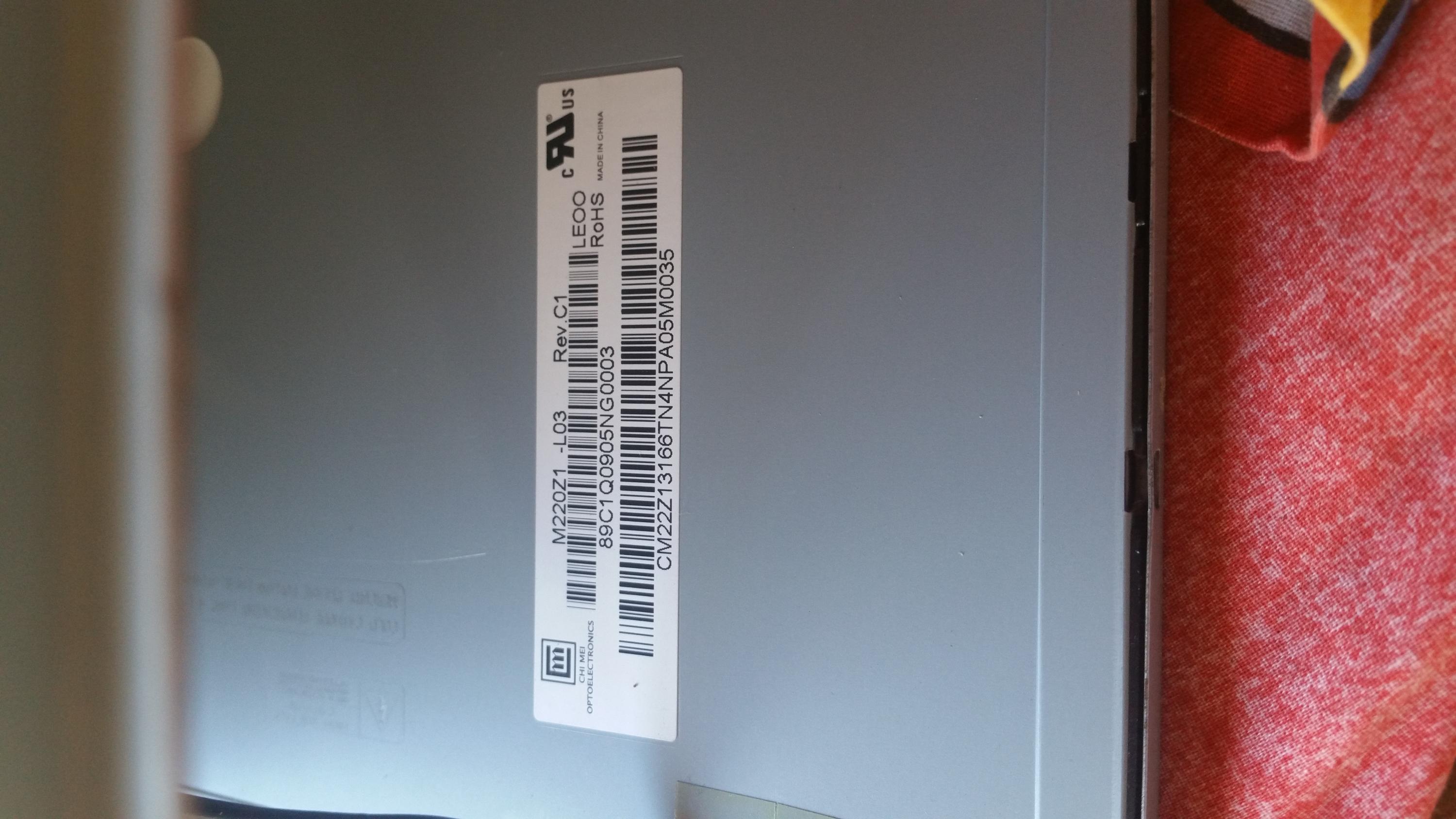

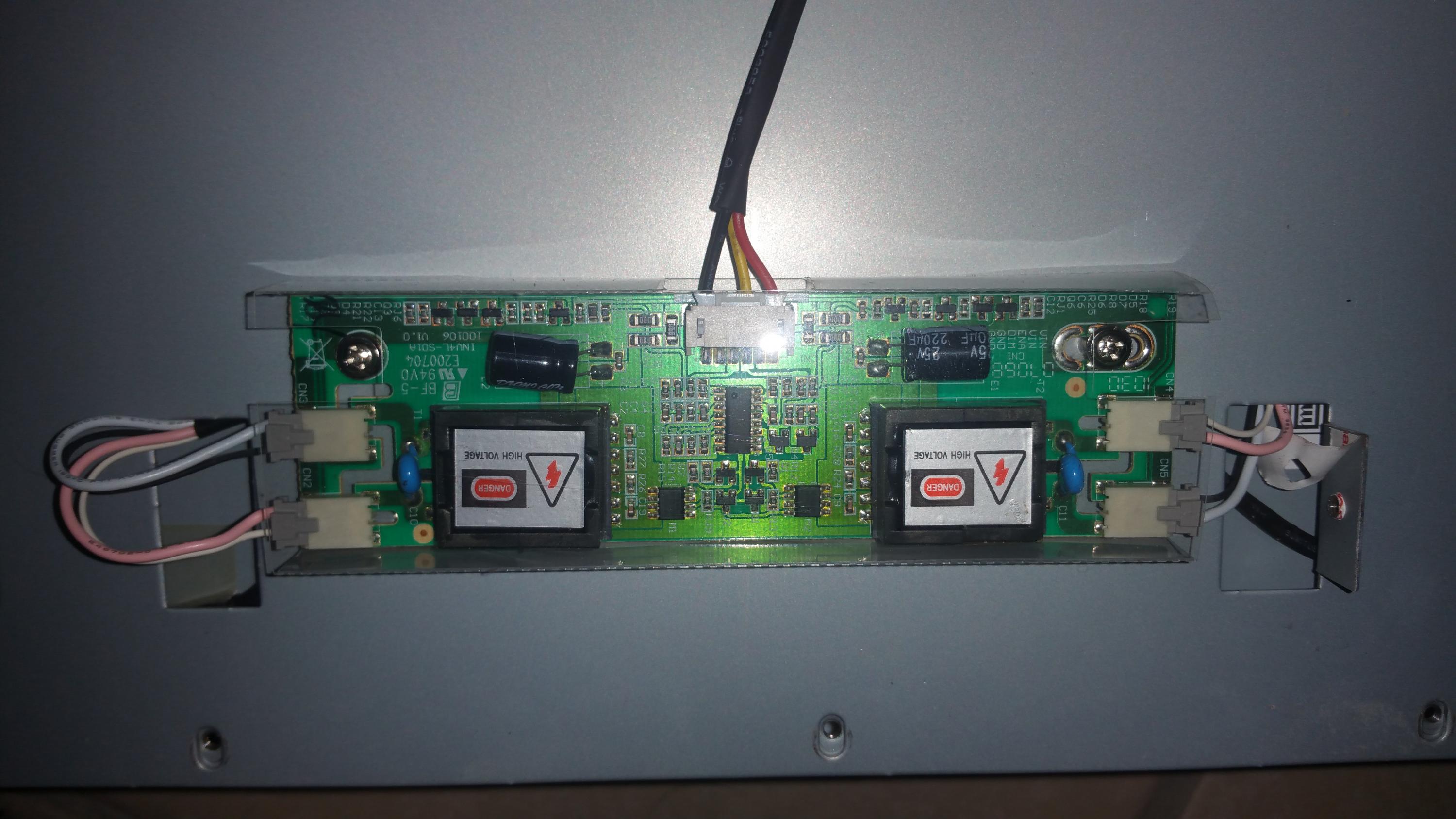

    Hello I'm new here and I have a question I was hoping someone would be able to help me?
    I can't leave the main menu and I've tried using a mouse to navigate with no luck. Ive been able to find out that it is a chi mei innolux lcd serial number (m220z1-lo3) there's also some other numbers on here ( 89c1q0905ng0003 and cm22z13166tn4npa05m0035) display but I do not have the remote for it so I have no clue how to use this! Do I have to hook a computer tower up to this or can I just put USB stick in? is there a universal remote code? Any help would be amazing!!! Thank you if you need any other info please let me know

      Re: need some help
      I believe it is a monitor. It's basically just the lcd panels encased in a steel frame. There is a board on the side with a USB connector and a SD card slot.

        Re: need some help
        i have some pictures of it if that helps

          Re: need some help
          That label seems to be just for the display panel, what is this thing connected to? What is connected to it right now that is puting the video of the gears on the screen?
          There must be a main board, a power supply etc. also
          Usually there are a few buttons that are connected to the main control board to control the on screen menu
          Is there a touch screen that normaly goes over the display screen?

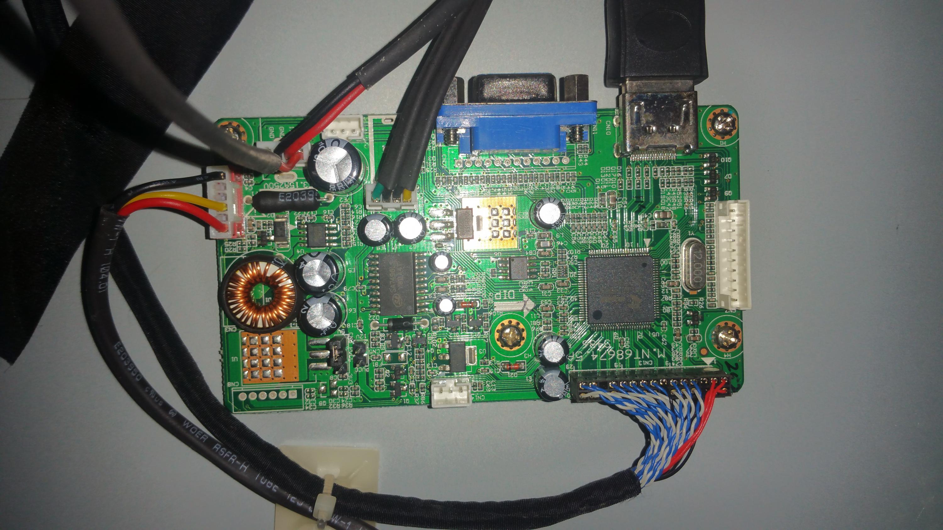

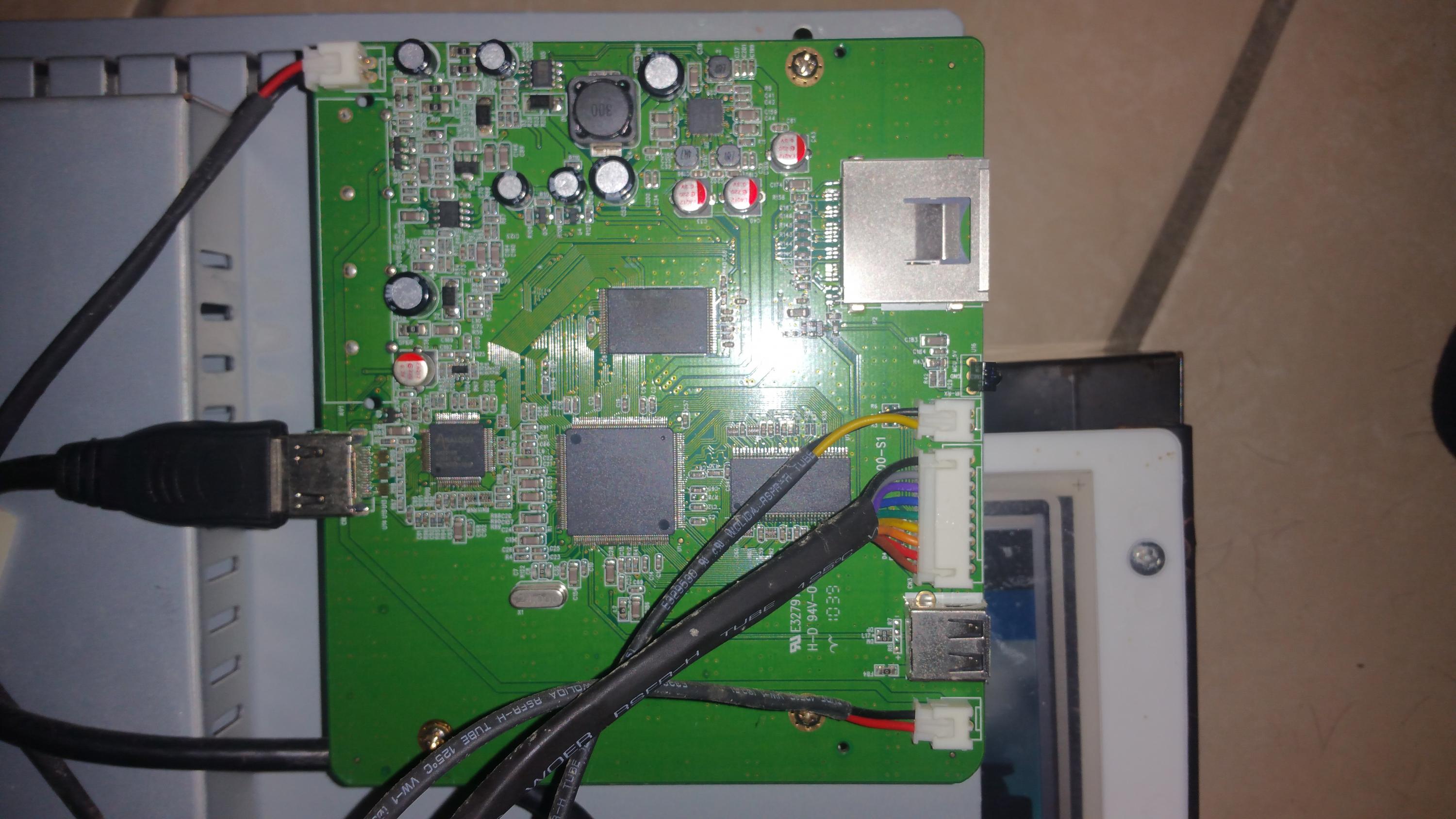

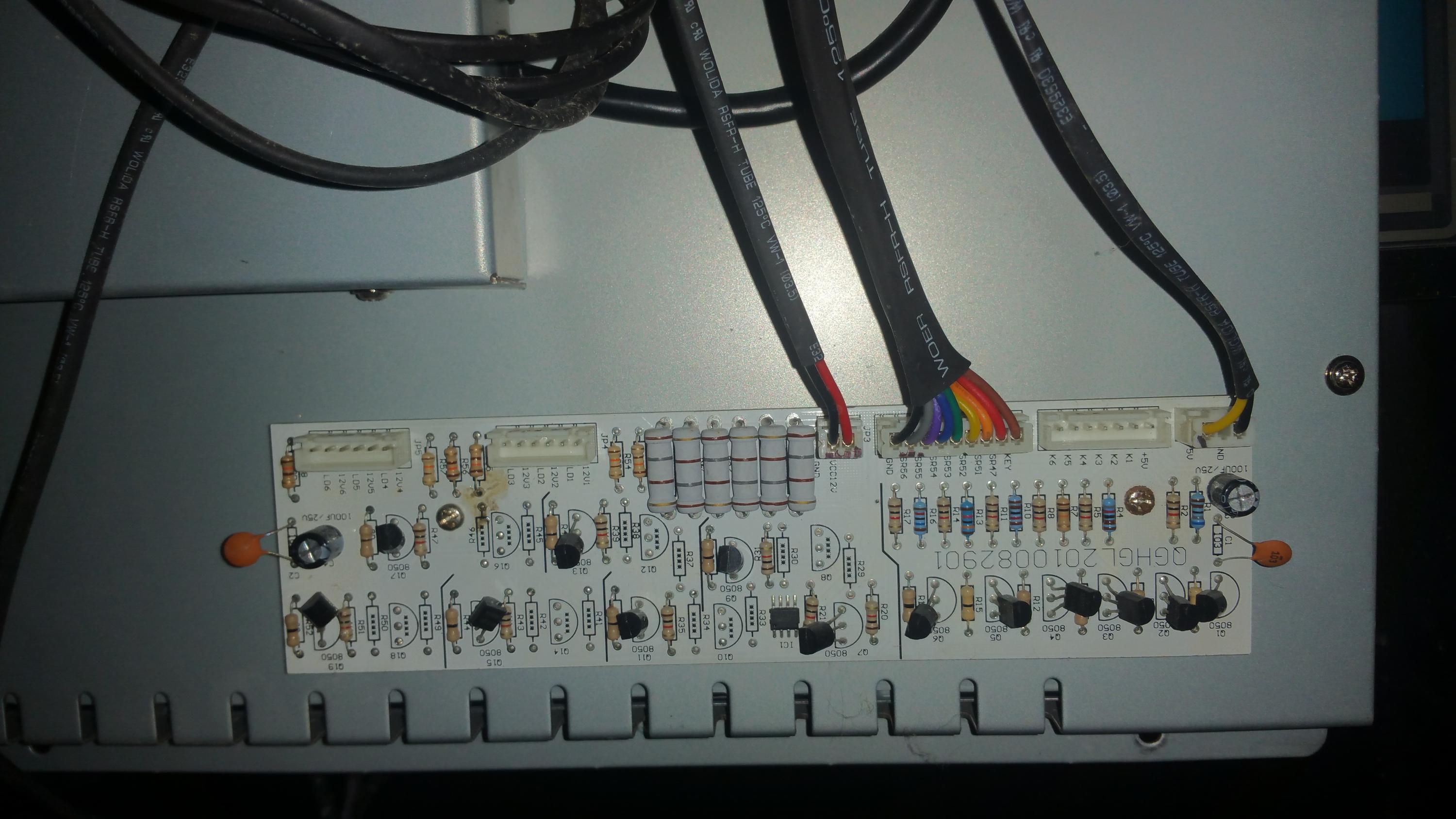

            Re: need some help
            the panels on the bottom are touch sensors but touching them just takes me to a blank screen. there are 4 boards on this thing, 3 green and 1 white. there is a in line power supply. I've looked this thing up and down and it seems the only thing I can control is the volume knob on the top of the monitor. here are pictures of the 4 boards.

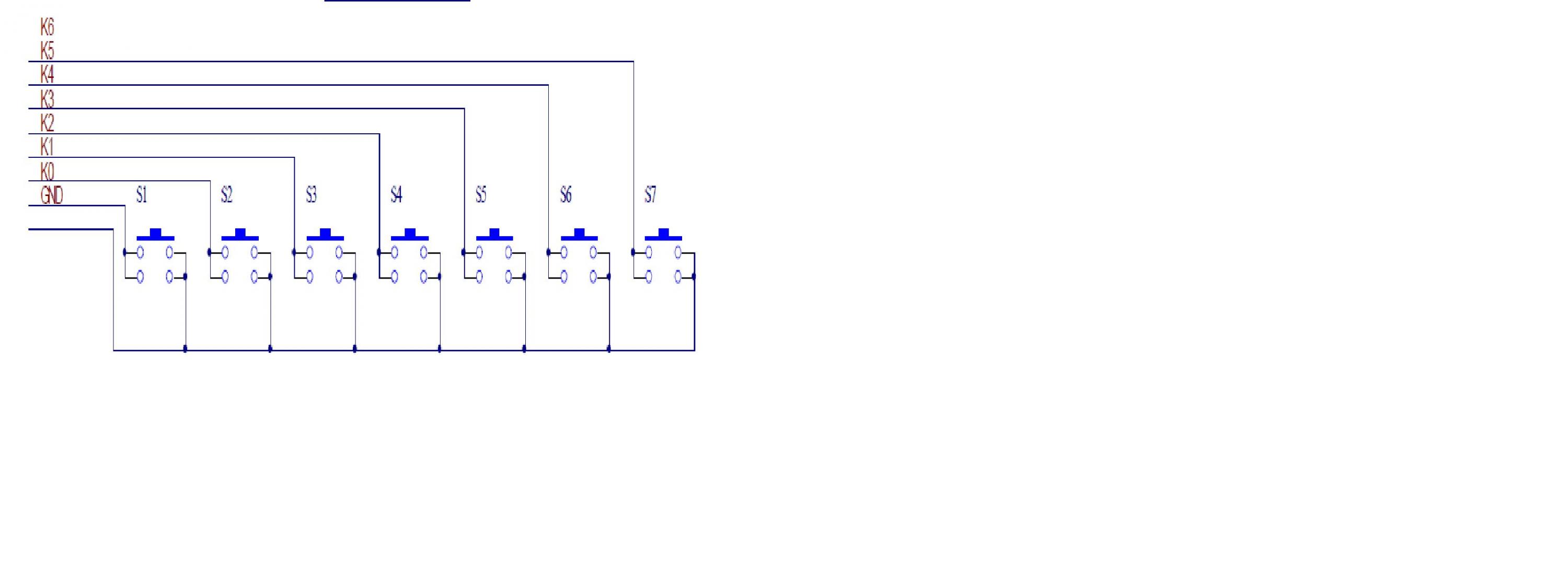

                  Re: need some help
                  You are missing the keyboard that connects to CN7, You should be able to make one with a few buttons

                      Re: need some help
                      This is too complicated? then connect a wire to CN7 Pin 4 (or Ground) and touch the other end of the wire to one pin at a time (pin 1, 5, 6, 7, 8, 9 or 10) and see which one has the desired effect
                      That plug (CN7) is where the keyboard plugs in, You don't have one so what else are you going to do?
                      I can't tell which is pin 1 but if you check on cn7 pin 4 will be connected to ground, that will tell you which way the plug is numbered
                      I also don't know which button S1 - S7 would be, looks like its Power, Menu, Vol+, Vol-, Input, Exit

                          Re: need some help
                          Note: these are normaly open momentary switches.
                          The way it works is each button has a certain function, when the switch is pushed it takes that line to ground. So if S1 was the power switch when it is pushed it takes the K0 line to ground telling the microprocessor to turn off or turn on the monitor, if S2 was the Menu, pushing it would take K1 logic line to ground turning the menu on and off. etc.
                          It would be easier to navigate the menu with the keyboard, so you only have to push a button to change items. maybe a local electronic shop would have a plug that fits CN7 and an old keyboard with a similar switch arangement.

                            Re: need some help
                            What you want is similar to this but with 7 buttons and 10 pins http://www.ebay.com/itm/Universal-LC...kAAOSwd4tUCDcO
                            Getting closer https://www.aliexpress.com/item/2pcs...208.4.8.LpgIzF
