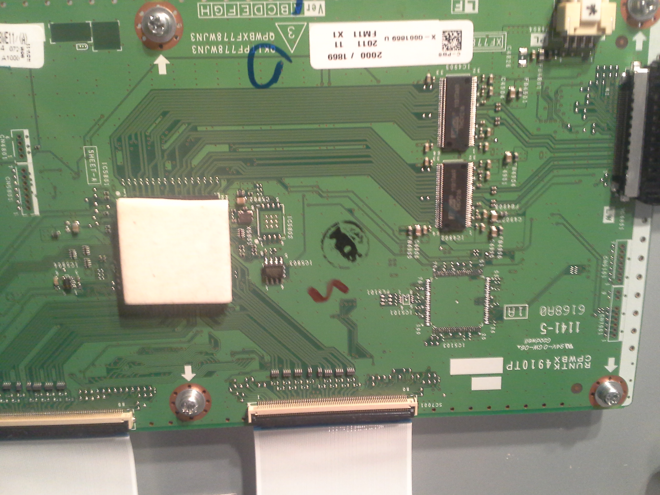

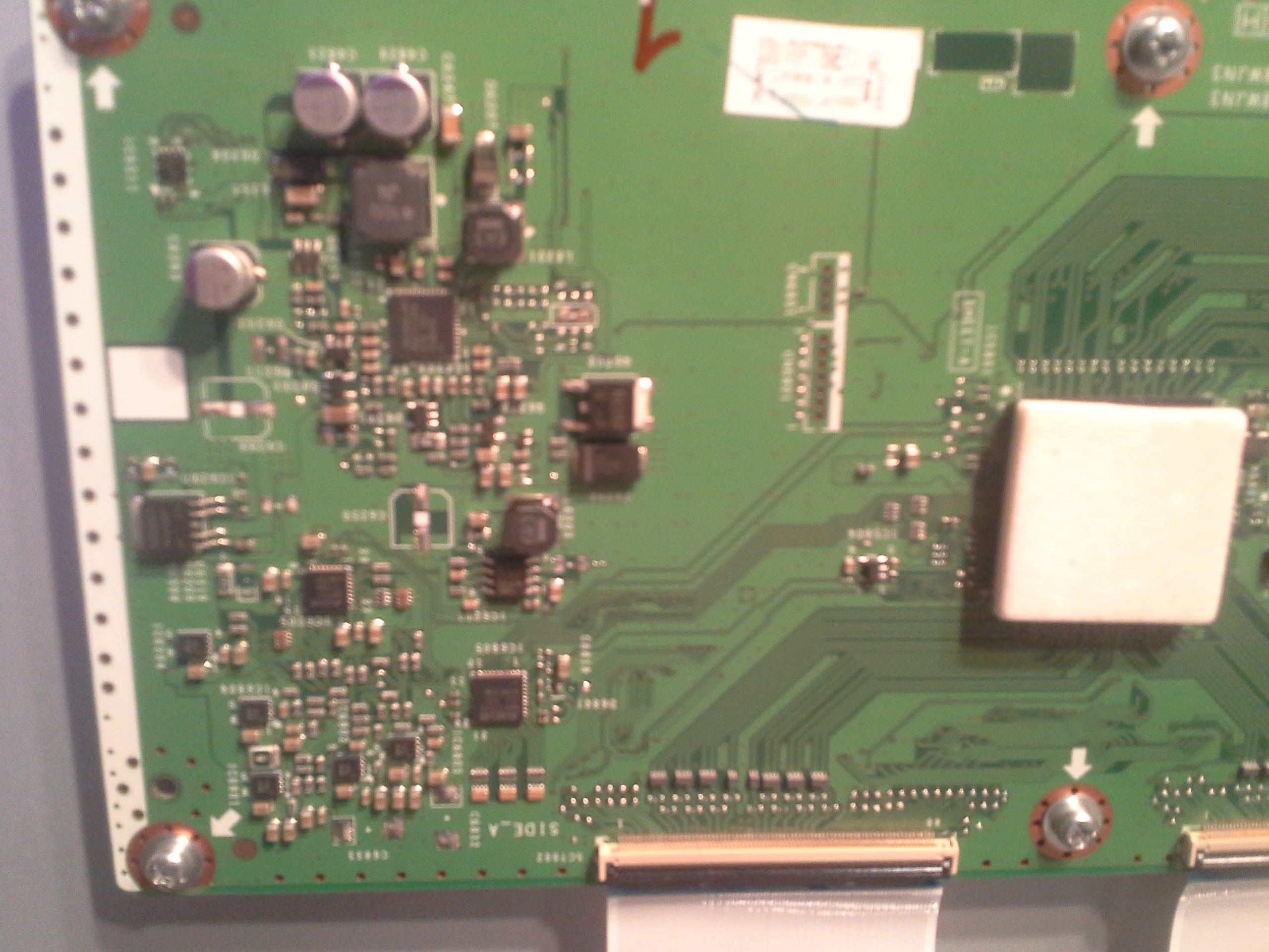

      Re: Sharp 70" model LC-70LE733U 2-5 blinks
      T-con pics.
      Who would you recommend for parts?
      pete
        I would just start checking the obvious transistors and mosfets for shorts or open fuses. You do know that Sharp LCD panels can represent themselves with hours of operating properly and then all it takes is just a little short on one of those ribbons for the horizontal driver's and Wham-O there goes your Tcon. Then you replace the t-con and it works fine again for a little bit. I've already been through this. Unfortunately for you if it is the panel it's going to be hard because it's just going to keep blowing tcons. and it's time based.
        So in essence you either have a bad tcon that you had repaired or purchased or a panel that's a tcon after a certain amount of time. Trying to make out what you were talking about earlier did this company repair or replace your t con board? And also since the back panel says it's a different model and year for certain that your main board has not changed I would say somebody has been into this tv before changing out boards.
        If your tcon was repaired and not replaced you should be able to locate the area that they repaired. It'll look like shiny solder amongst all the other connections.

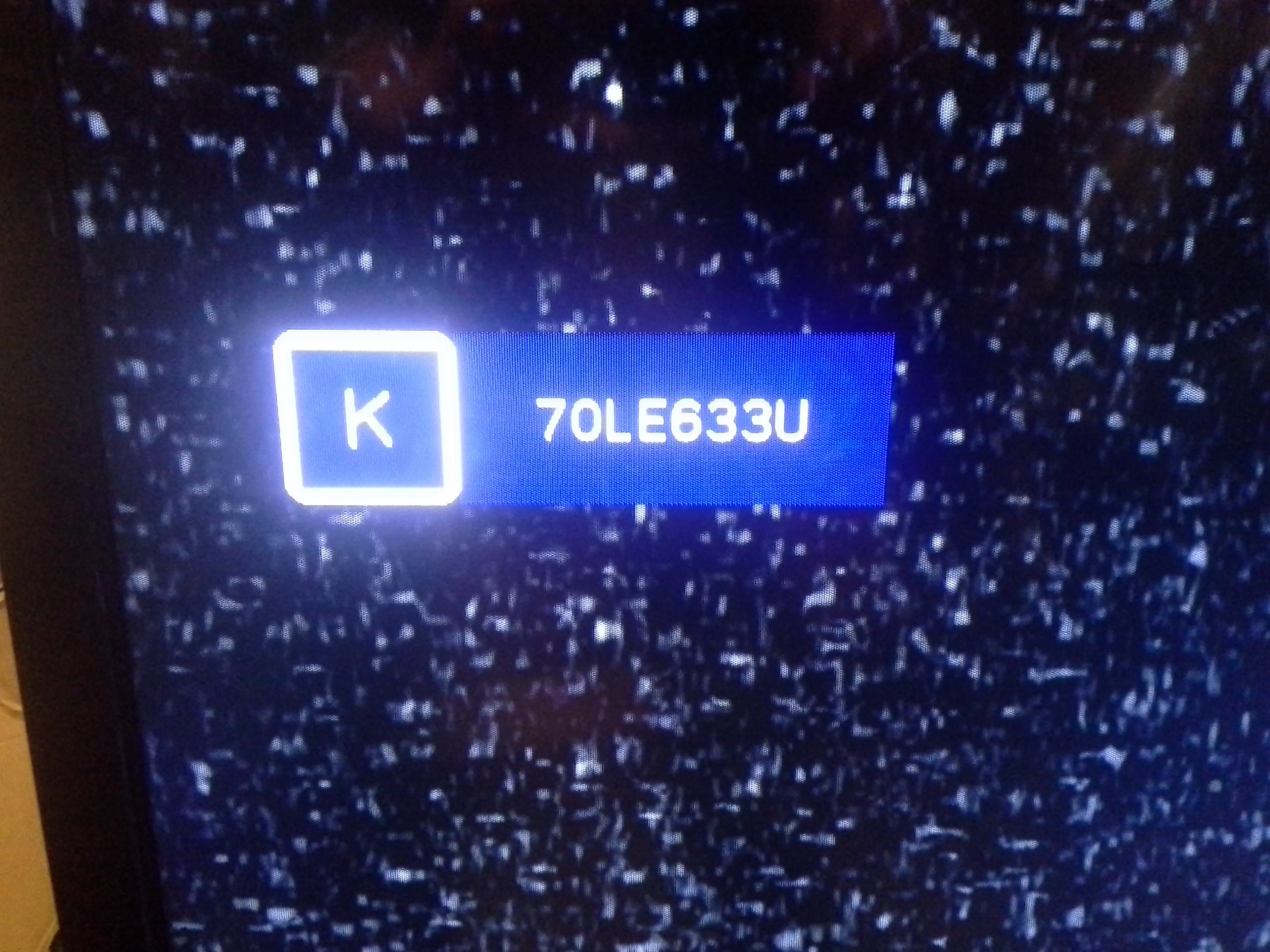

                          Maybe this means something to the rest of you.... there were no light error codes.
                          From pg. 1 of the service menu:
                          MONITOR ERROR CAUSE
                          1. 21 B 00002084:58
                          2. 21 B 00002084:58
                          3. 21 B 00002084:58
                          4. 21 B 00002084:58
                          ERROR STANDBY CAUSE 50 50 0 0 0
                          From pg. 25 of the service menu:
                          Error standby cause
                          1. 50 OH15M E_TCNF_S
                          2. 50 OH15M E_TCNF_S
                          3. NO RECORD
                          4. NO RECORD
                          5. NO RECORD
                            hmmm... you are not looking at the counters, you are looking at the "error log / occurrence"... kind of cryptic... I think. Look at the counters.
                            the one cause is associated with the tcon... T-CON FPGA status error and the other cause is associated with ... your guess... a panel error ... :-(
                            lastly, when you are in the service menu, did you check the settings for the model (as you questioned earlier) and also for the firmware version along with tcon version?
