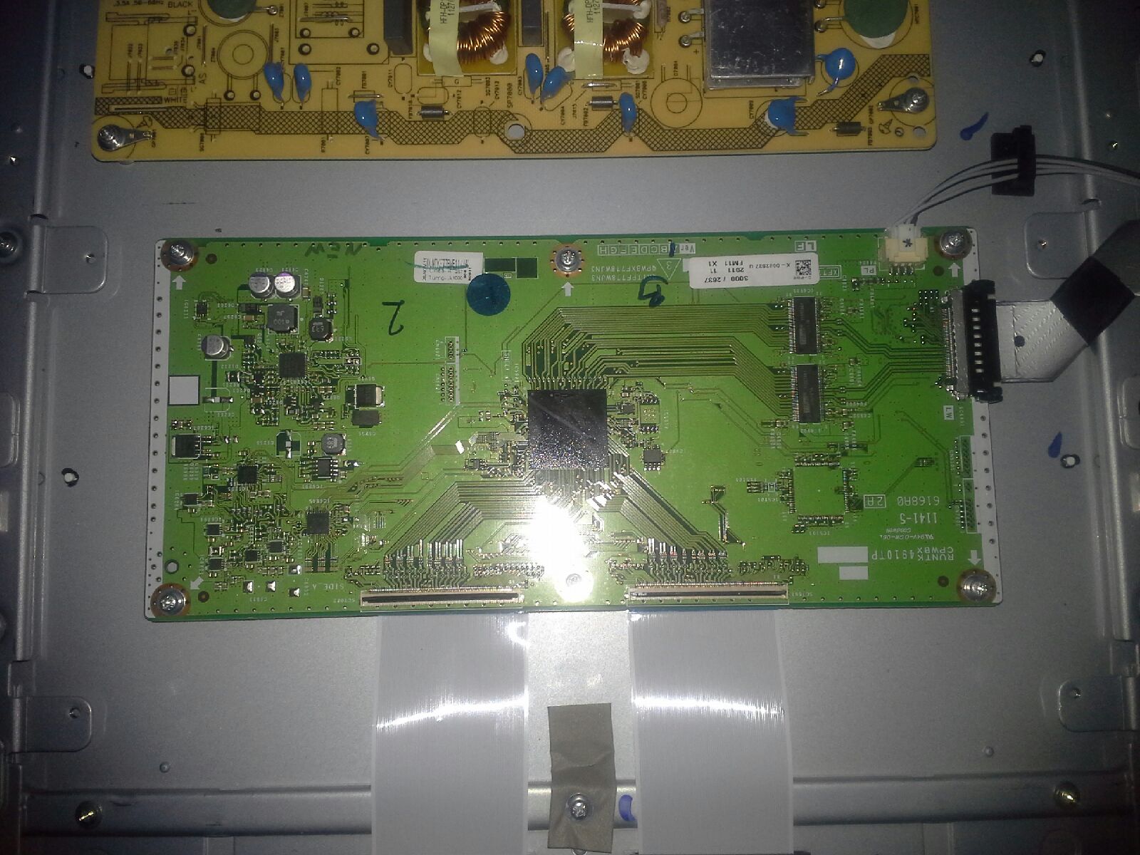

    First let me say thank you to this board for helping me fix several Panasonic Plasmas and a Sony Bravia 46" .
    Once again another 70" Sharp Aquos Quattron with no picture, no sound with the 2/5 blink code. Using the reset procedure ( hold volume down and input while plugging in) the code goes away until you hit the power button. This occurs whether you have the left tcon cable disconnected, the right tcon cable disconnected or both disconnected. At no time do you get any kind of picture.
    I have already replaced the power board RDENCA442WJQZ and T-CON board RUNTK4910TP and the code still remains. Why did I replace these boards? because when you don't exactly know what you're doing it's easier to throw parts at something than actually trying to diagnose it properly so once again I'm asking for this forums knowledge.
    I've noticed unlike other Sharp 70" models that have 4 cables at the base of the t-con board mine only has two. Does this change the diagnostic procedures? Like many others I've found little to no technical info about this tv on the net.
    As always your help is appreciated.
    Pete

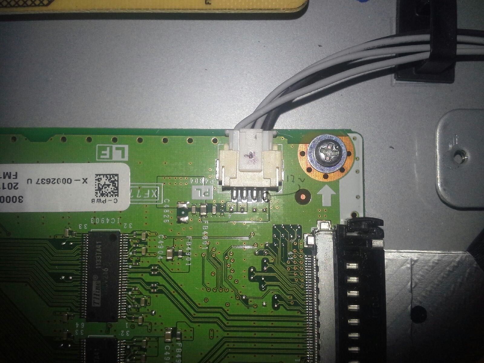

              • ga70gto
                • Oct 2014
                • 61
                Re: Sharp 70" model LC-70LE733U 2-5 blinks
                I have been able to make these voltage checks. On the center power board at pin 16 of connector "PD" I have apprx. 3.3 DC volts.
                On the tcon board at connector P4804 at pin 1 I have 12 volts. These were achieved by using the reset procedure and remain until the tv goes into the 2/5 mode again.

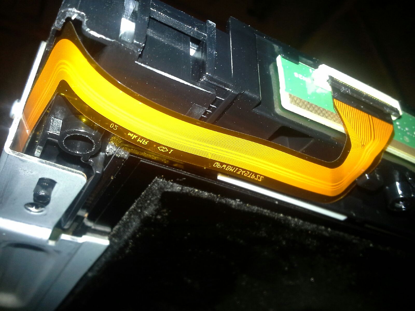

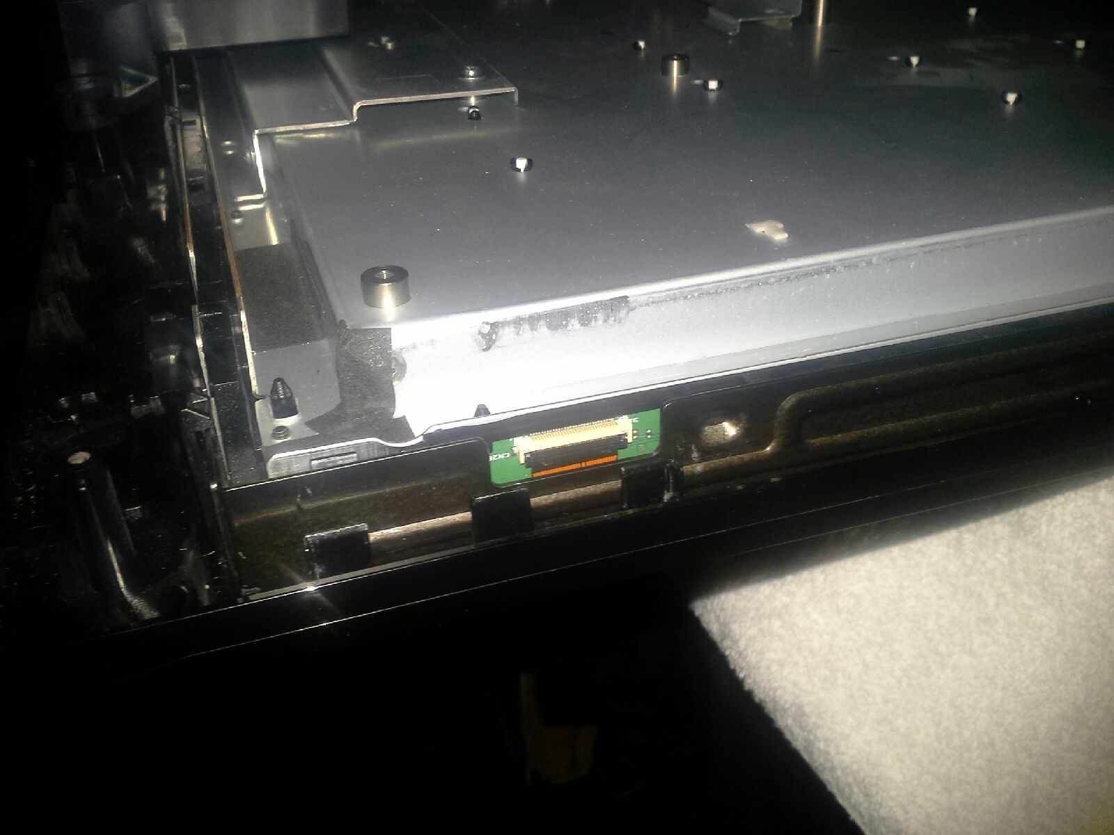

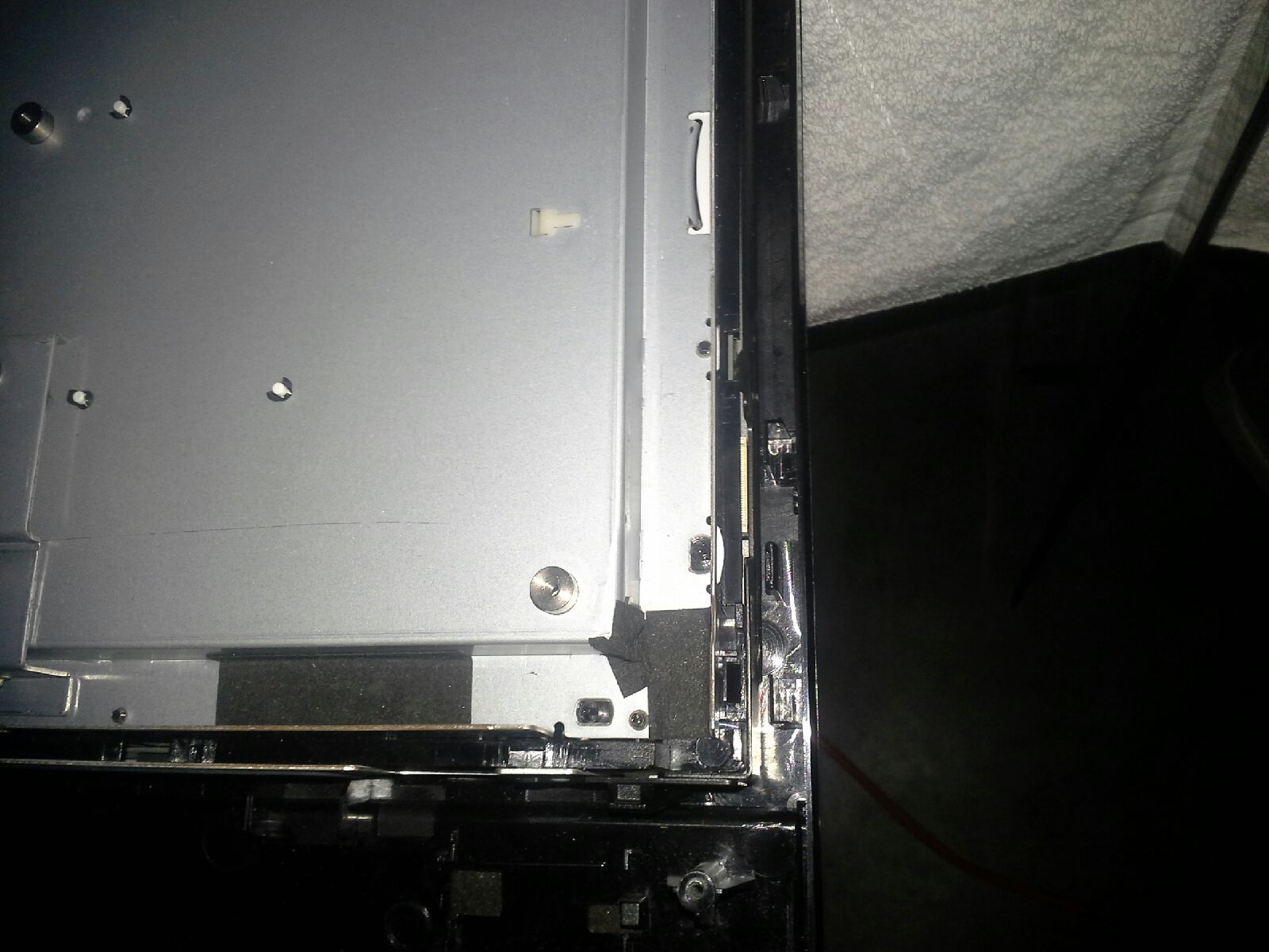

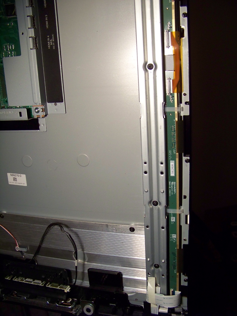

                      • ga70gto
                        • Oct 2014
                        • 61
                        my tcon board only has two lower cables and whether I disconnect the left or right or both when I power on the tv using the reset procedure it eventually reverts to the blink code of 2/5.
                        Attached are pics of the right lower corner of my tv and a picture of the edge, to me it just doesn't look the same as yours.
                        as always thanks for your time and input,
                        Pete

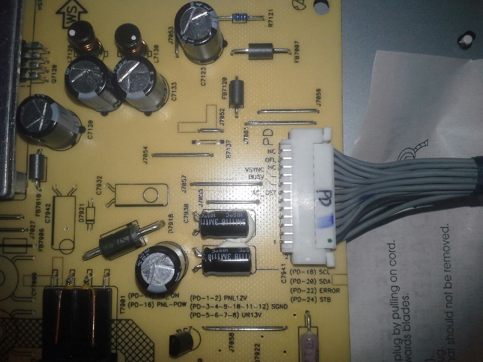

                        • ga70gto
                          • Oct 2014
                          • 61
                          Continuing on with voltage checks of connector PD of the power supply board "before" the tv begins to blink 2/5. This is just with the tv plugged in because it will begin to blink 2/5 without turning it on.
                          1. PNL12V 12.16v
                          2. PNL12V 12.16
                          3. SGND 0v
                          4. SGND 0v
                          5. UR13V 13.24v
                          6. UR13V 13.24v
                          7. UR13v 13.24v
                          8. UR13v 13.24v
                          9. SGND 0v
                          10. SGND 0v
                          11. SGND 0v
                          12. SGND 0v
                          13. AC_DET 3.30v
                          14. PS_ON 2.86v
                          15. BU5V 5.11v
                          16. PNL-POW 3.33v
                          17. VSYNC 0v
                          18. SCL 3.27v
                          19. NC 0v
                          20. SDA 3.27v
                          21. OFL 2.99v
                          22.ERROR 3.33v
                          23. NC 0v
                          24. STB 0v
                          I don't know if this helps anyone but i'm trying on this end.
                          thanks for your time and patience,
                          pete
