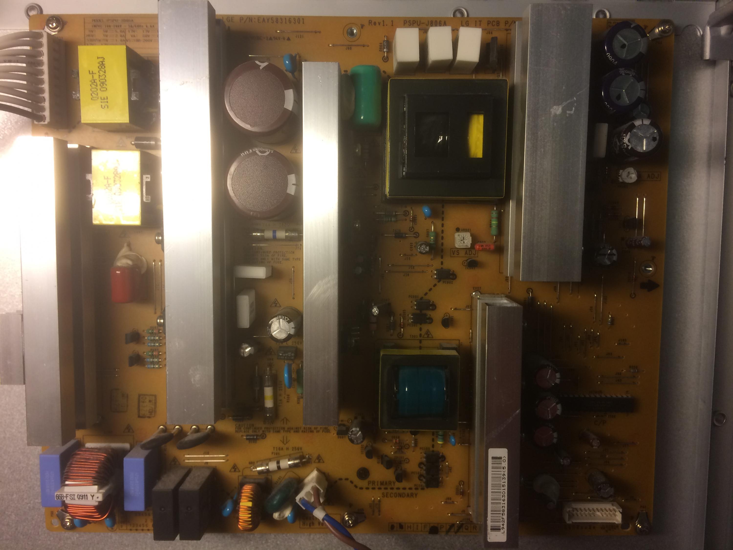

LG 50PQ3000 powersupply failure
  • PowerAmpFreak
    • 982
    • Sweden
    I repaired the standby (flyback) part of the supply after a blown STRW-6252.
    It works, but does not output standby voltage.
    The standby voltage is a switched output and does not come on.
    I have got it to start-up occasionally by starting the PSU with a variac, and slowly increase from zero to 100VAC.
    LG P/N EAY 58316301
    Does anyone have advice or perhaps a schematic?
  • PowerAmpFreak
    • 982
    • Sweden
    Re: LG 50PQ3000 powersupply failure
    Haha, the +5V standby voltage was switched from a hidden button under the set to fulfill energy star energy requirements.
    When I found this switch, the standby voltage came on and set works!
