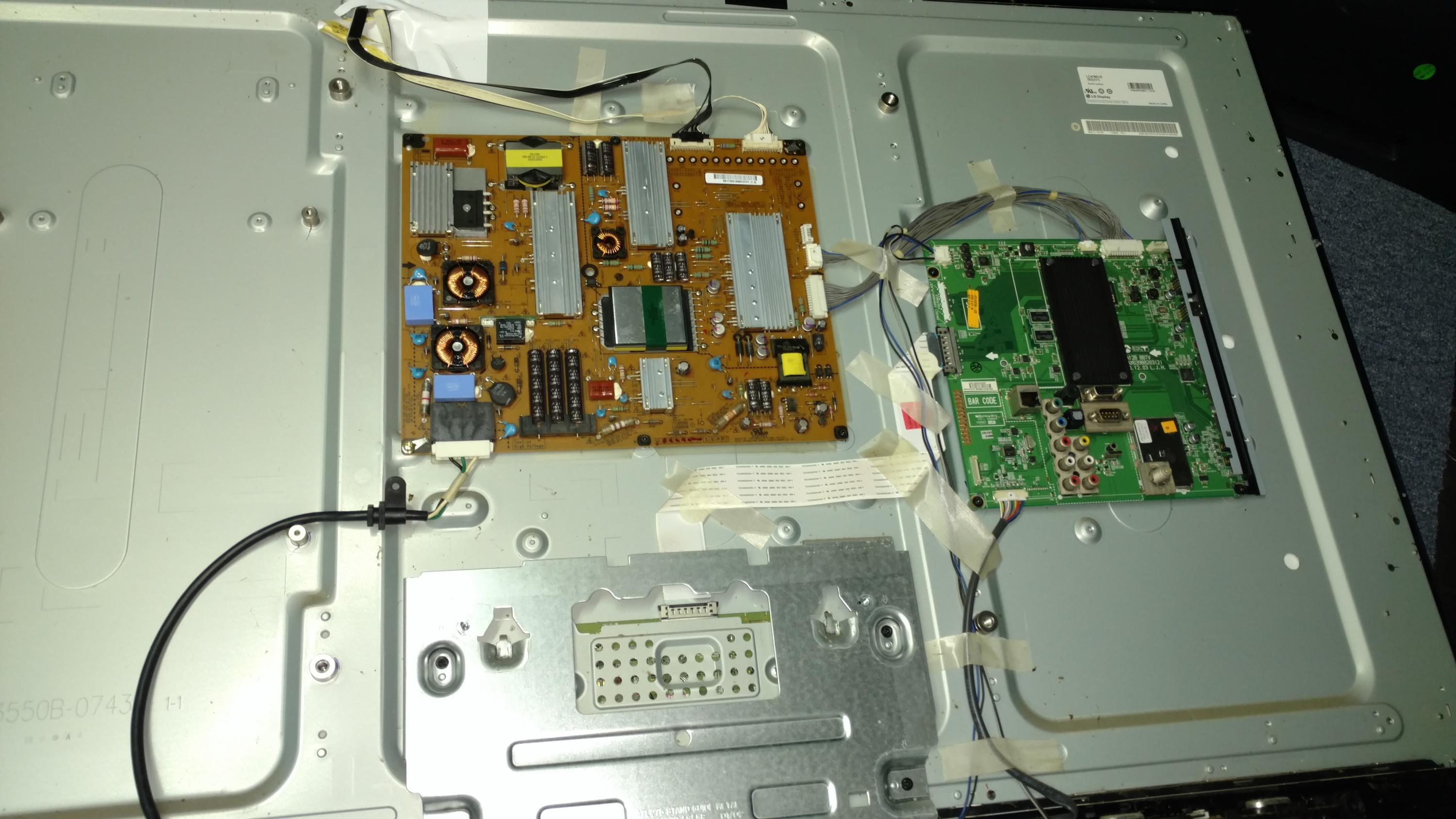

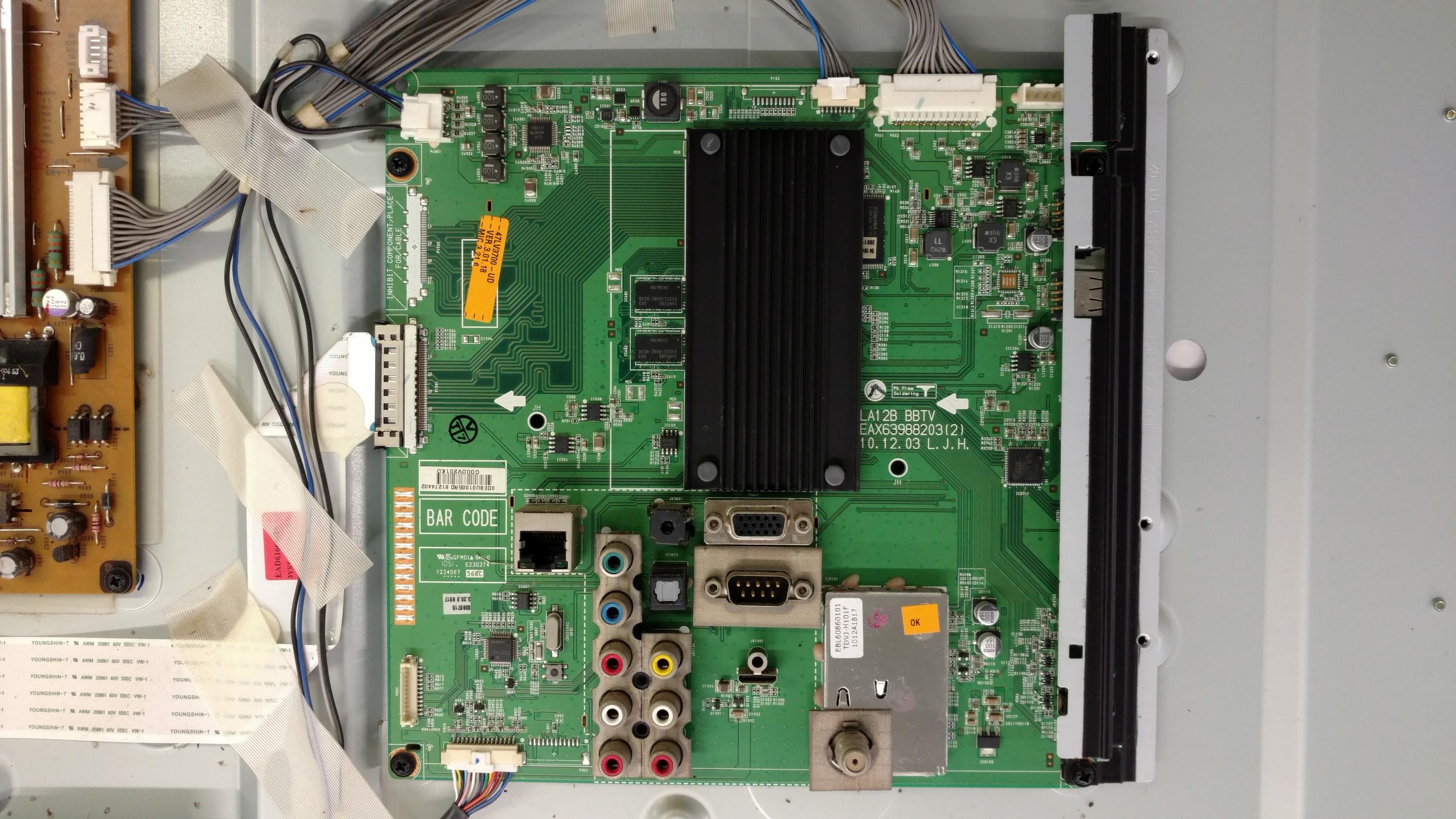

    The LG 47LV3700 I'm fixing seems to power on but I have no backlight, no picture. Power supply has 3.3, 12v, 24v and 36v at the LED. I used a LED tester and seemed to get the LED's to light up but not sure if each strip is working. When I try to power the set, the red standby light on the front of the TV flashes 3 times and then turns blue. Not sure how to proceed.
    Images are attached of the boards:

                                Re: Lg 47lv3700
                                Yep, no BL-ON.
                                Can we see the whole backside of the TV? Is there a cable between T-CON board and the power supply board?

                                  No cable from PS to TCON.
                                    Re: Lg 47lv3700
                                    Mainboard problem. Very common in LG LV##00 models.
                                    Look up how to reflow the mainboard.
                                      Re: Lg 47lv3700
                                      Tried baking the board today .... 385 for 8 minutes. Didn't power the tv but sure was filling for lunch lol.
                                        Re: Lg 47lv3700
                                        I sent this board off to a repair service and got it back today. It's still doing the same.
                                        I wanted to try and light the led's with the power supply using a jumper but wasn't sure whether this LG model needed a resister and also what voltage to supply.
