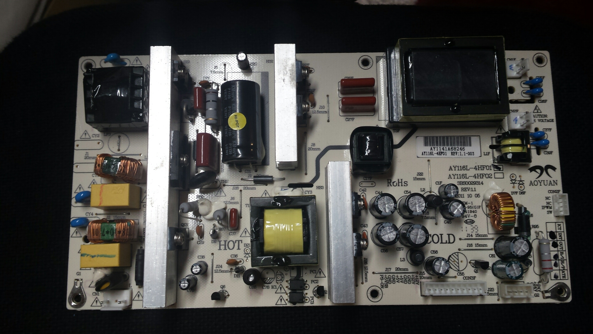

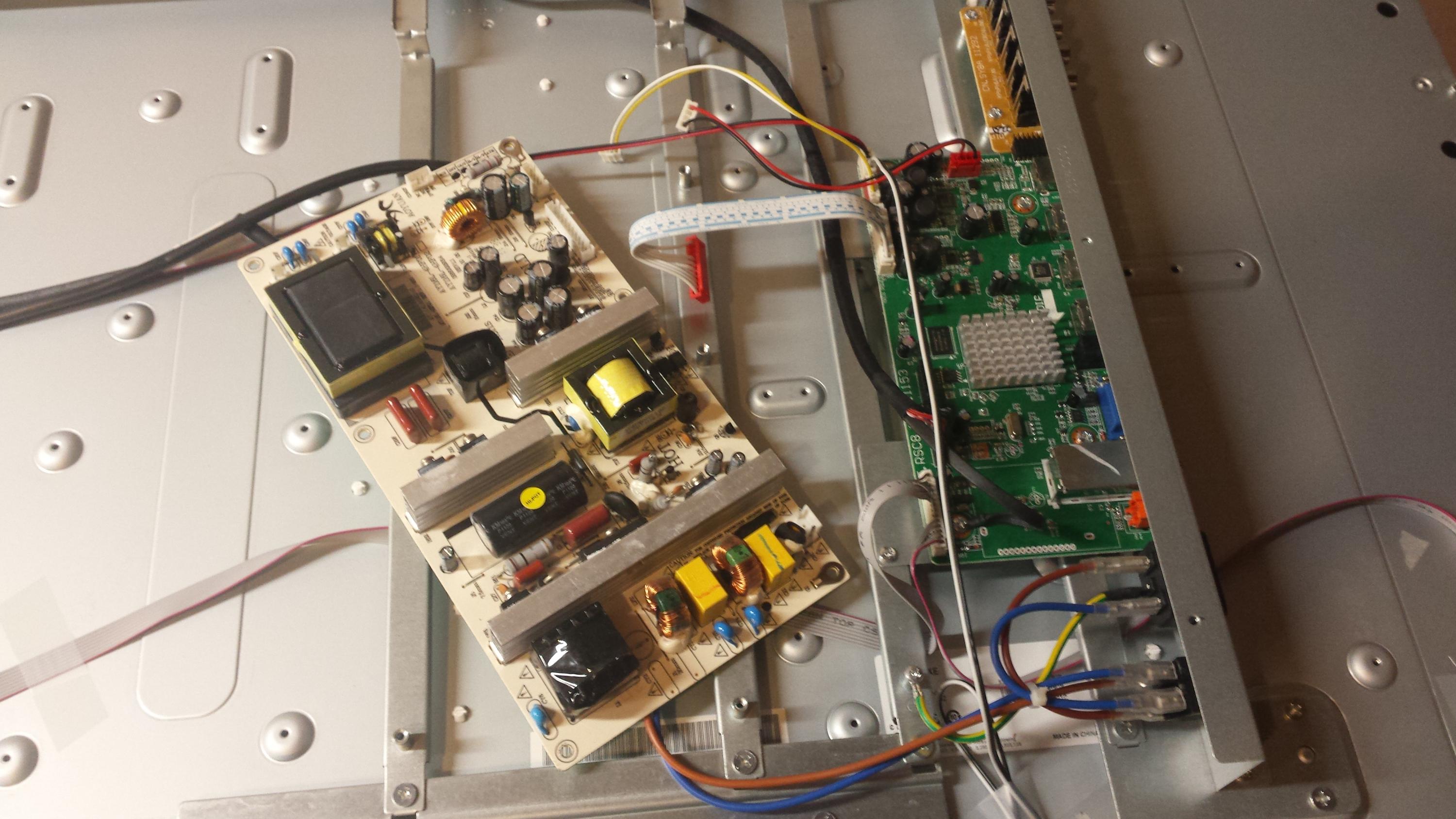

    Westinghouse VR-3710 stuck in standby
    This set gradually stopped powering on past standby. For a while it would come on with repeated attempts.
    Also, for most of the life of the set (2-3 years) it made a high-pitched whine during operation.
    The board is an AY116L-4HF01. I suspect bad caps, but there's no visual indication of them. I'm hoping someone can recommend some to change out, or some other course of action. Thanks!

    Re: Westinghouse VR-3710 stuck in standby
    Disconnect the mainboard from the power supply. Do you have +5VSB. If so connect a 1K resistor from +5VSB to PS_ON and check you have the +12V, +5V & +24V voltages.
    Also check what DC voltage you have across the two legs of C31 at that time.
      Seems to me e-caps on the Main Bd may need replacing. Check the PSU as dick barton suggested....but is that 6VSB stand-by I see on the label??
        Thanks for the responses. I was able to verify 5v standby, but I'll need to procure some jumpers and the correct resistor to continue troubleshooting. Unfortunately Radio Shack returned to their roots as a parts house, but then they promptly closed both stores in my community.
          All right, I've received my goodies and did as you suggested, dick_barton. Here are my results:
          5v: 4.98v (both pins)
          12v: 11.54v (both pins)
          24v: initial reading of ~18v, which dropped to nothing almost immediately, then ~11v to nothing, then zilch
          C31: initial reading ~18v, then nothing
          For what it's worth, I'm familiar with basic electronics theory and the common components, but I'm not versed in troubleshooting technique.
          Thanks again for your assistance.

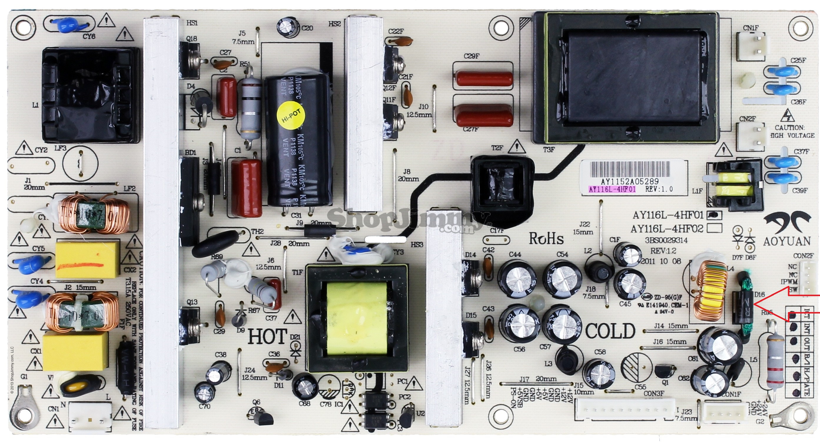

            Place your meter leads on each pin of C31. The voltage is high so be careful. Set your meter to DC volts with black lead on -ve pin of capacitor and red on +ve pin of capacitor.
            So just to confirm that all your voltages come up and are steady except for the 24V supply which initially comes up at approximately 18V DC and then drops towards 0V.
              With the set off check the diode with your meter set to diode mode.
                Right, the 5v and 12v pins maintained constant readings.
                C31 reads 381v.
                I did some reading on testing diodes, but I have low confidence in my results. One direction reads 001, and the other reads higher, up to around 020. It seemed to climb as I was testing. Help with that would be appreciated. I'm not sure which capacitors may need to be discharged.
                  With the set disconnected unsolder one end of the diode (or both, up to you) and lift up off the board and measure the diode with your meter set to diode mode. Should be around 0.6 - 0.3 one way and OL (no reading) when you swap your leads.
